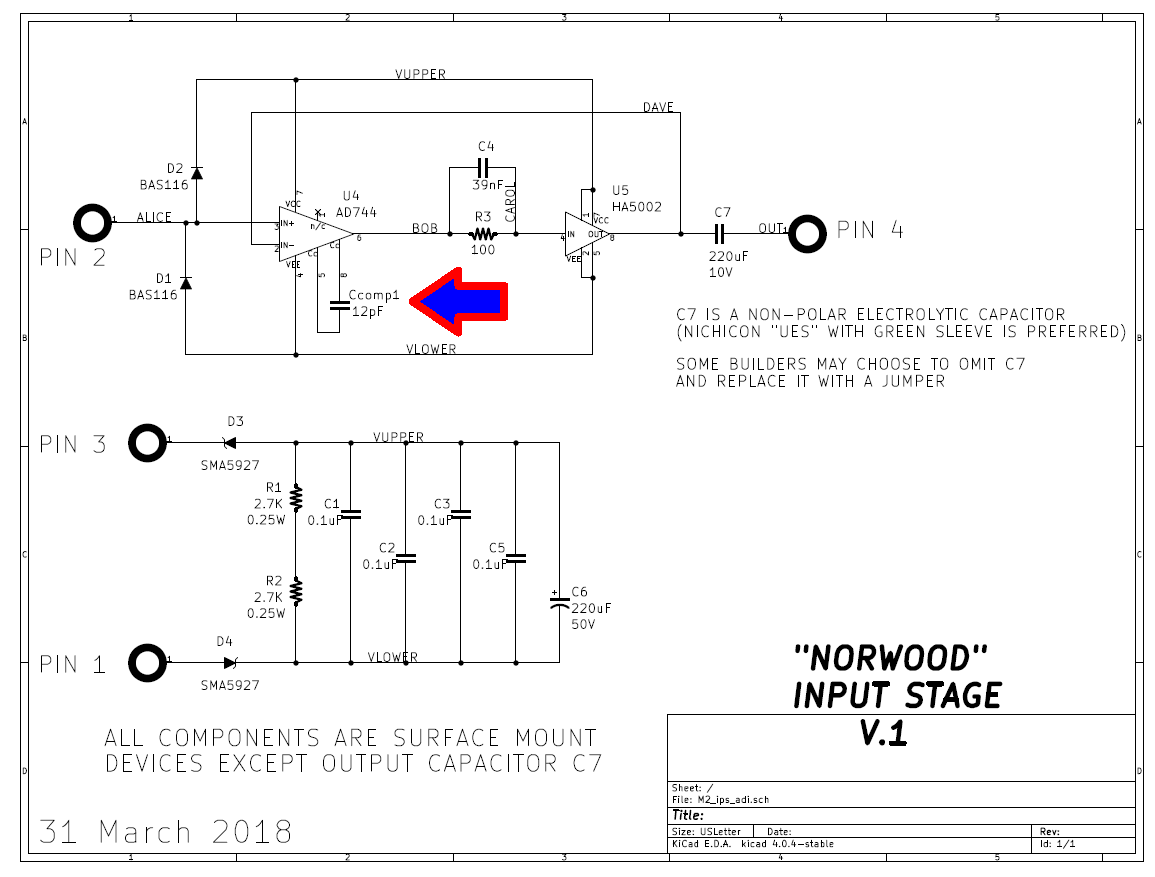

I am right that the Norwood cant work as buffer / follower only and must be a Gain-Norwood when used in F6 circuit because the feedback from transformer would cause stability problems?
You can feed the F6 with a buffer Norwood if you like, that will present no issues. Of course, buffer Norwood has no gain.
If you use gain Norwood the new (Norwood) PCB will have to reference ground and the rest of the layout as such with that in mind. Set it to whatever gain you wish.
If you [design a new inspired-by-Norwood PCB, it] will have to reference ground and the rest of the layout as such with that in mind. Set it to whatever gain you wish.
You will also have to introspect deeply into your soul! You will have to choose a range of Ccomp1 capacitance values to install in multiple prototype board (pairs), so that you can choose the optimum Ccomp1 value empirically, by listening evaluations. Change the gain, change the Ccomp1. As the night follows the day.

Thanks for bringing this up. The AD744 datasheet includes values for Ccomp for different gains and capacitive loads. These should be a start value for experimenting with.
Kind of yes, but not necessarily. You just need to have fewer ohms in general on that node, since you can't turn it down any further.

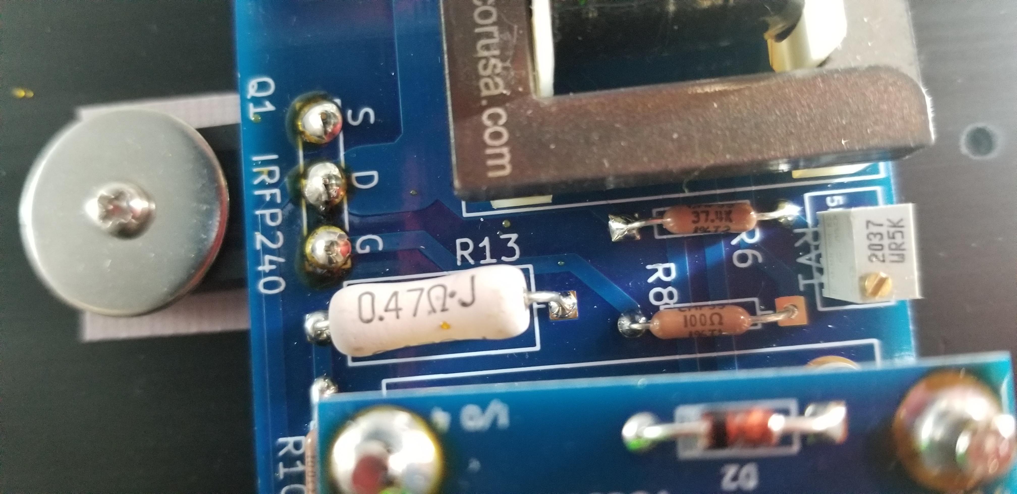

Ok, I think I know why the trimpot for A channel didn't work. I've researched but I'm still unsure if trimpots have polarity? If they do, then mine was the reverse of the A board as shown in #2 posting.
I have the 20K pots and plan to put them in tomorrow.
Appreciate the clarification.
You can look up in data sheet and check if center pin is the wiper which it usually is and if PCB layout also expects wiper to be the center pin then the only change by reverse the pot is which direction you need to turn to adjust the offset in a specific direction. E.g. look at this data sheet (which is for a Bourns type):

Pots have no polarity, fitting them this or that way only changes the direction that you have to turn the little screw on the top, CW or CCW.

Thanks. I did look at this data sheet, but I wasn't able to sort that out.
Hook it to a dmm, 1 outer to center leg
Measure resistance
Turn pot i any direction
Observe dmm.
