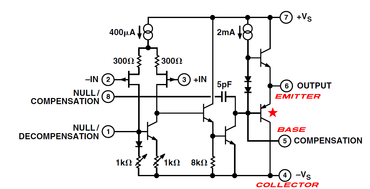

The AD744 has a unique feature: the output can be taken from compensation pin 5, bypassing the Class–AB output stage.
This is how the chip was used in the DAC960 project. Walt (Jung) informed me that pin 5 is capable of driving the high–impedance local feedback network in the new topology."
The person who designed the AD744 is still alive, and in fact is a member of this diyAudio website. When I discussed AD744+Norwood with him back in Jan 2018 [compare with the date of post #1 in this thread!], he nudged me to carefully look at the internal schematic of the chip, paying particular attention to the PNP transistor which drives the output pin.
It seems that a few nosebleed-performance ADI customers bought the AD744 and then connected a high performance (fT = 750 MHz, see datasheet Figure 8) discrete PNP in parallel with the internal PNP, using those pins. This gave vast improvement in opamp performance. However the particular discrete PNP they used, the PN4258, is no longer in mass production; today, non-counterfeit parts are difficult to find.
_
Very clever, thanks for the info.
Anyway, use pin 5 as an output and bypassing the Class–AB output stage AD744 also seems to be an interesting option.
