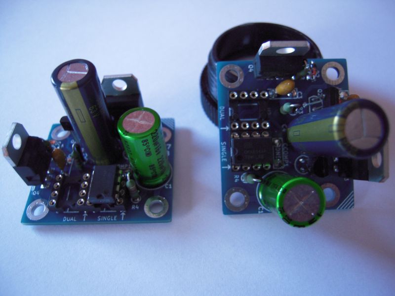

IPS6/IPS7 first listening
Hello M2X-builders,
I stuffed the IPS7- boards.
Put the IPS6- and IPS7-boards into the amp and gave them a first listening. 😀
First impression: they both sound really; really good! I think these boards are very 'unnoisy (compared to Mountainview)'. Seems this was one of the 'aims' of Mark? 😕
I think this is the reason why Mark has chosen the Zetex ZTX558 as a CCS on the IPS6 - board? 🙄 And it shows me again what a good job the J113s can do...
I have to listen more to give a real statement on the sound. Although these are 'buffers' and they shouldn't 'sound'. But they do....
Well done Mark! Thanks!
Greets
Dirk

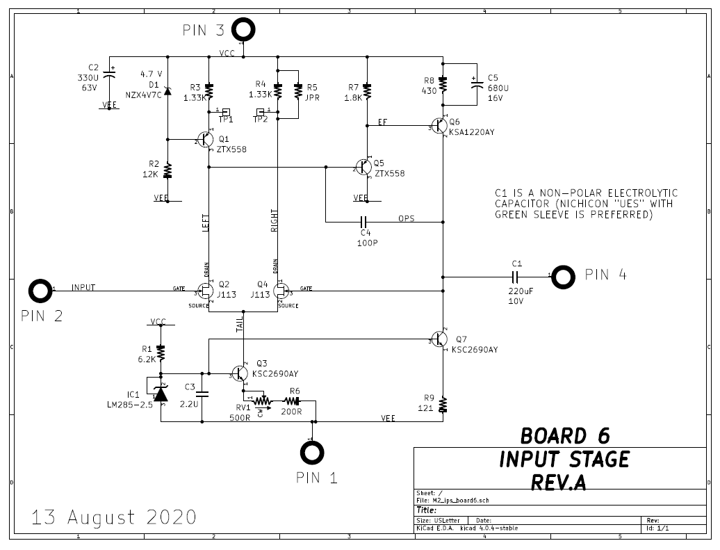

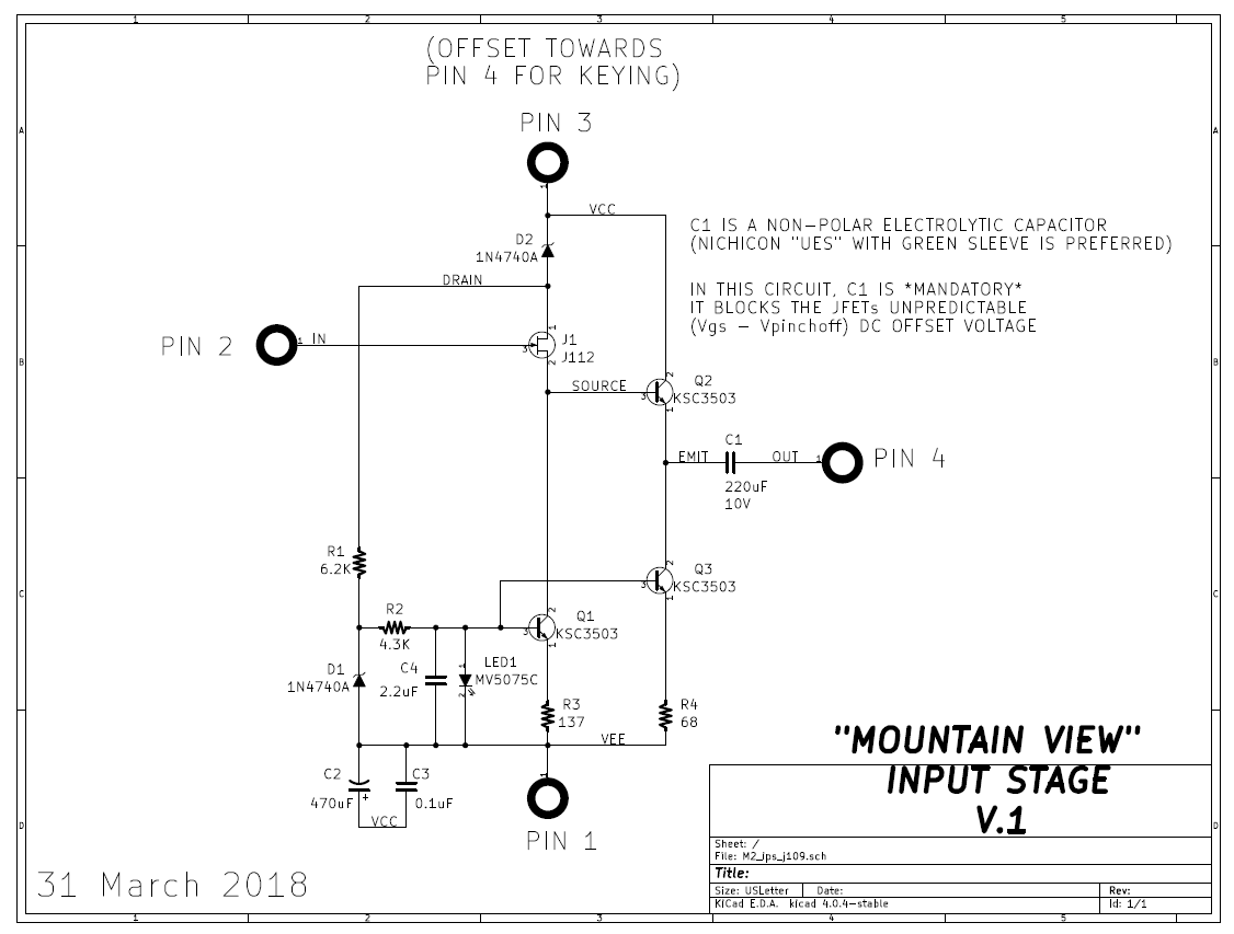

There are three constant current sources on the IPS6 schematic: Q1, Q3, and Q7.
Several factors were considered when choosing specific device types for each position, including the prevalence of counterfeit devices (if an unwise builder decides to save a dollar by purchasing transistors from eBay or Tayda instead of Mouser).
If you want to compare IPS6 to MountainViewIPS, let me call your attention to the bias networks at the lower left in each schematic diagram. MountainView has a double-regulated bias network: R1-D1 is the first regulator, and R2-LED1 is the second regulator. On the other hand, poor old IPS6 only has a single-regulated bias network: R1-IC1.
For those who prefer the sound of MountainView over the sound of IPS6, now you have a "reason" you can point to, triumphantly. Double regulated bias! Oh baby.
And for those who prefer the sound of IPS6 over the sound of MountainView: you'll just have to say "high output impedance transconductance amplifier driving transformer primary, gives excellent sonic results."

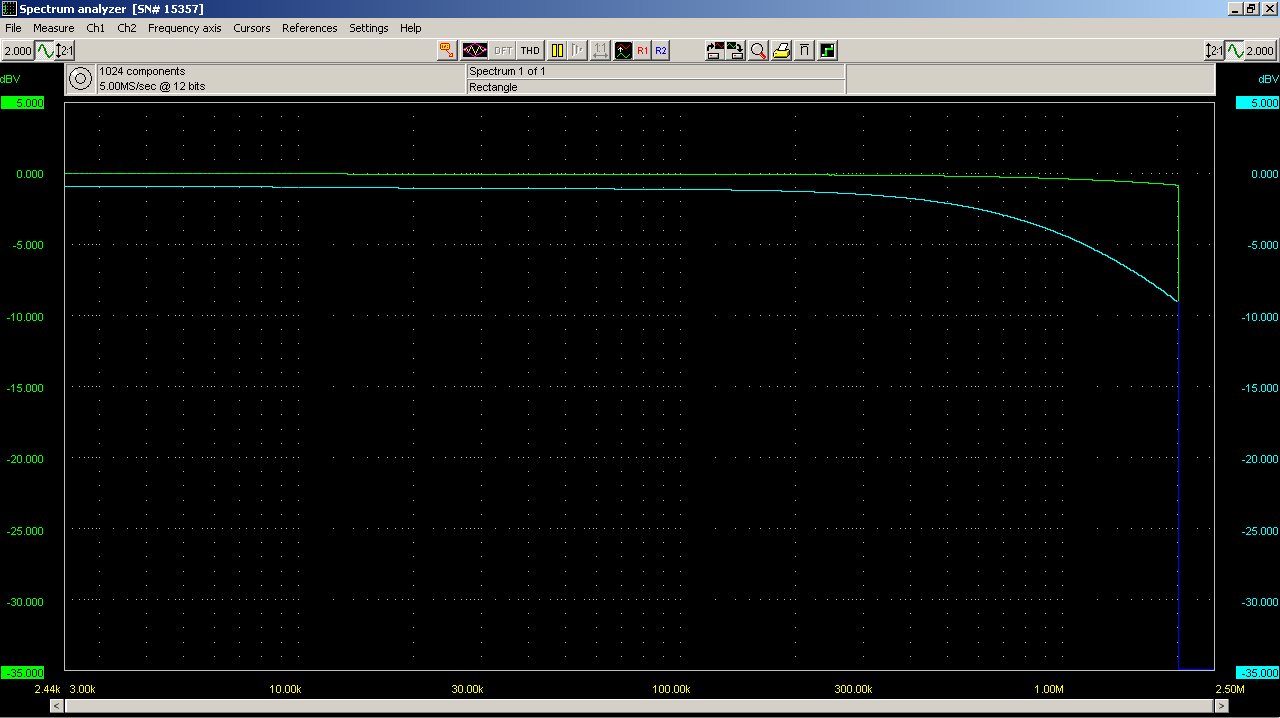

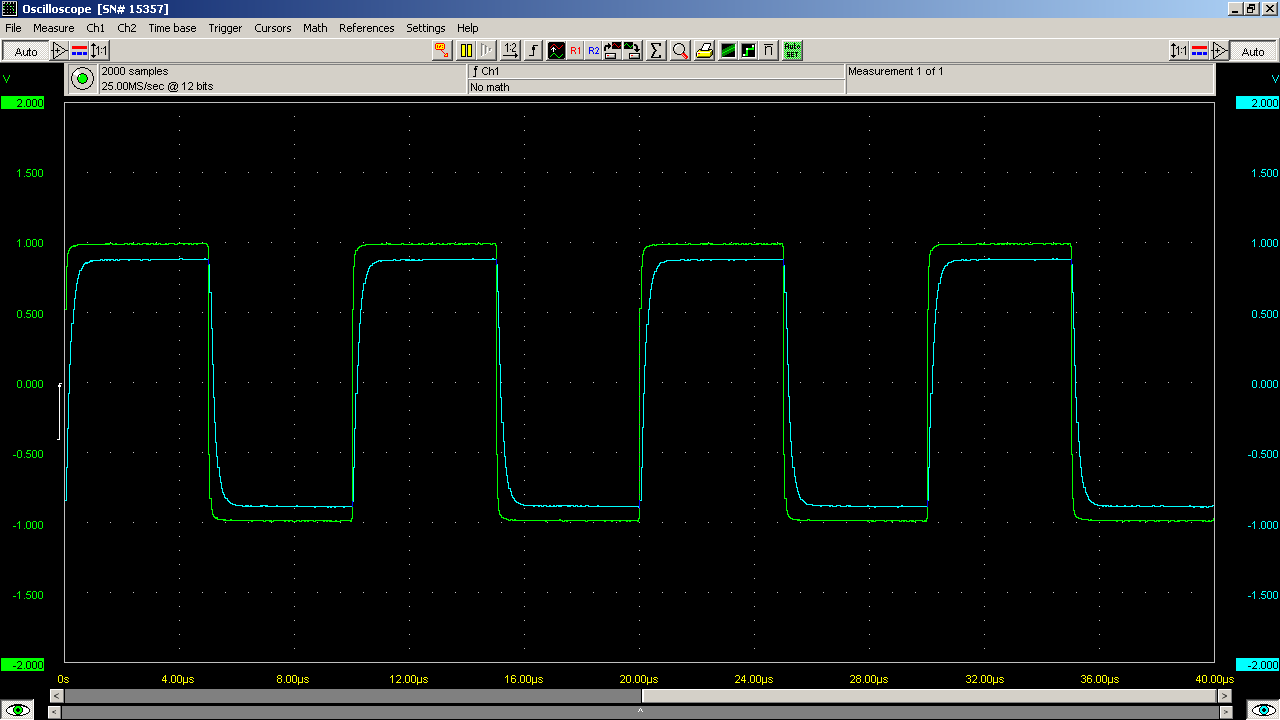

Black Forest Buffer Proto
Just for my own curiosity, I played around with the BFB proto further today.
Firstly, what happens without load ?
Nothing.
Both square wave and frequency response is the same as 600R load.
The bandwidth is determined by the input RF filter, and not by the buffer itself.
How about DC drift ?
On cold start, DC was +1.2mV. After 2 minutes it was -1.0mV.
After 5 minutes, it was 0.0mV +/-0.3mV.
I used nominal-value resistors throughout without any trimming (1% metal film).
JFETs Idss are 3.53mA & 3.51mA.
Hfe for the BJTs were 222 & 200, not perfectly matched.
Maybe just luck. 😉

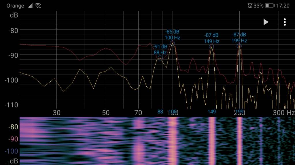

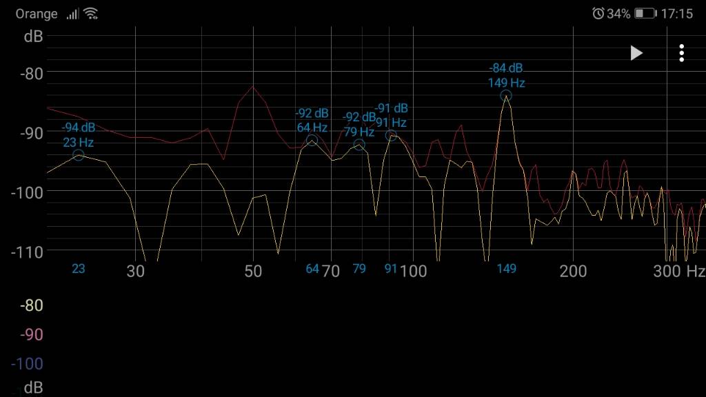

Further information ...
Maybe I'm exaggerating, because the noise can only be heard with the ear in the speaker, but I want to catch up with those who have silence in the speakers.
The amplifier connected to the preamplifier is ... quieter. Not much, but 100hz and 200hz have disappeared. 150hz remained at the same level.
Anyone have any ideas?

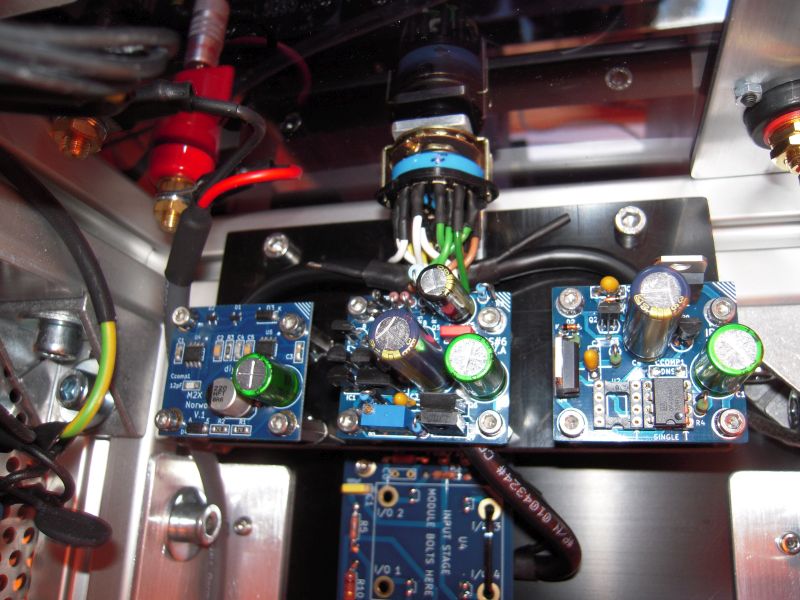

to Ryssen #4449
Hello Ake,
yes, I used a simple 4-pole / 3 position- switch. So I can switch between 3 buffer-boards.
Greets
Dirk
