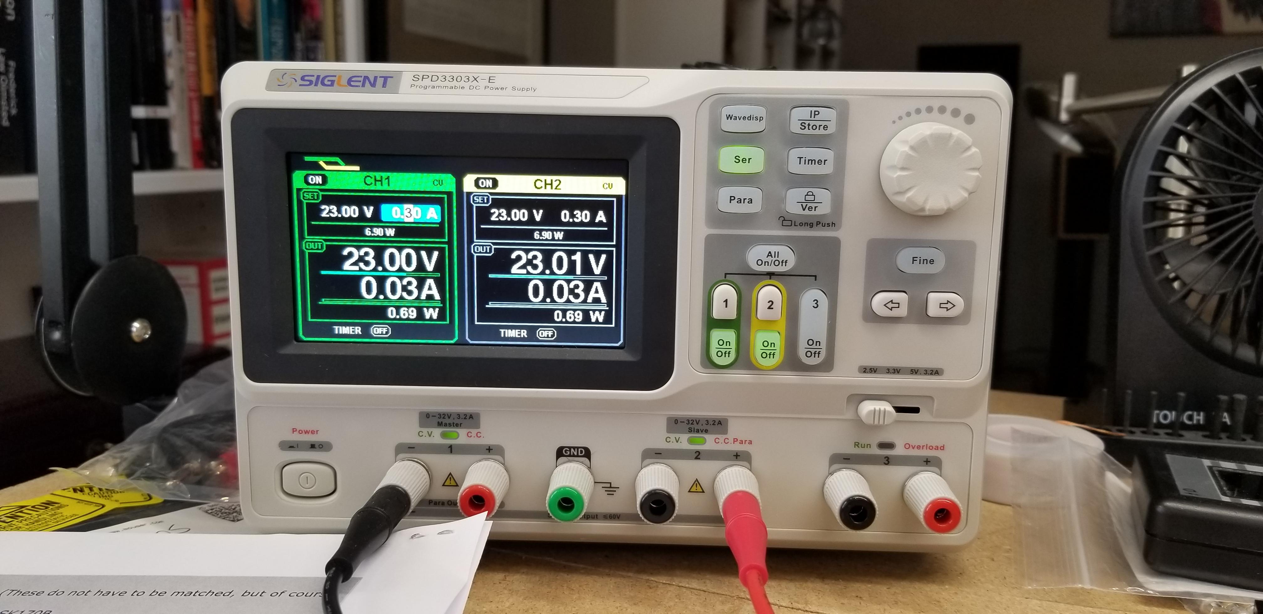

If I were you I would set my power supply for 46 volts and, if it has current limiting, set the current limit pretty low, like 40mA. Apply the positive lead to Pin3 (including the milliammeter) and the negative lead to Pin1. Read the current. I would leave the other pins open and floating.
Why 46 volts? Because the middle of the acceptable supply range for M2 and M2x, is +23V and -23V. Thus 46 volts end to end.
What should the milliammeter say for Norwood at 46 volts total? Somewhere between 8mA and 30mA. If you want to double check these numbers, the mfr datasheets for the two ICs each give a Supply Current specification (range), and you can calculate the current drawn by the bias resistors R1 and R2 using ordinary algebra.
I have a Siglent unit and I want to test a DB with your recommendation of 46 Volts and low amperage.
i've read the instructions a number of times. Is this right: To set a 46 V output, I put the Siglent into series mode and set to 23 volts and in series that generates 46 Volts? as I am drawing from the combination of Channels 1& 2.
