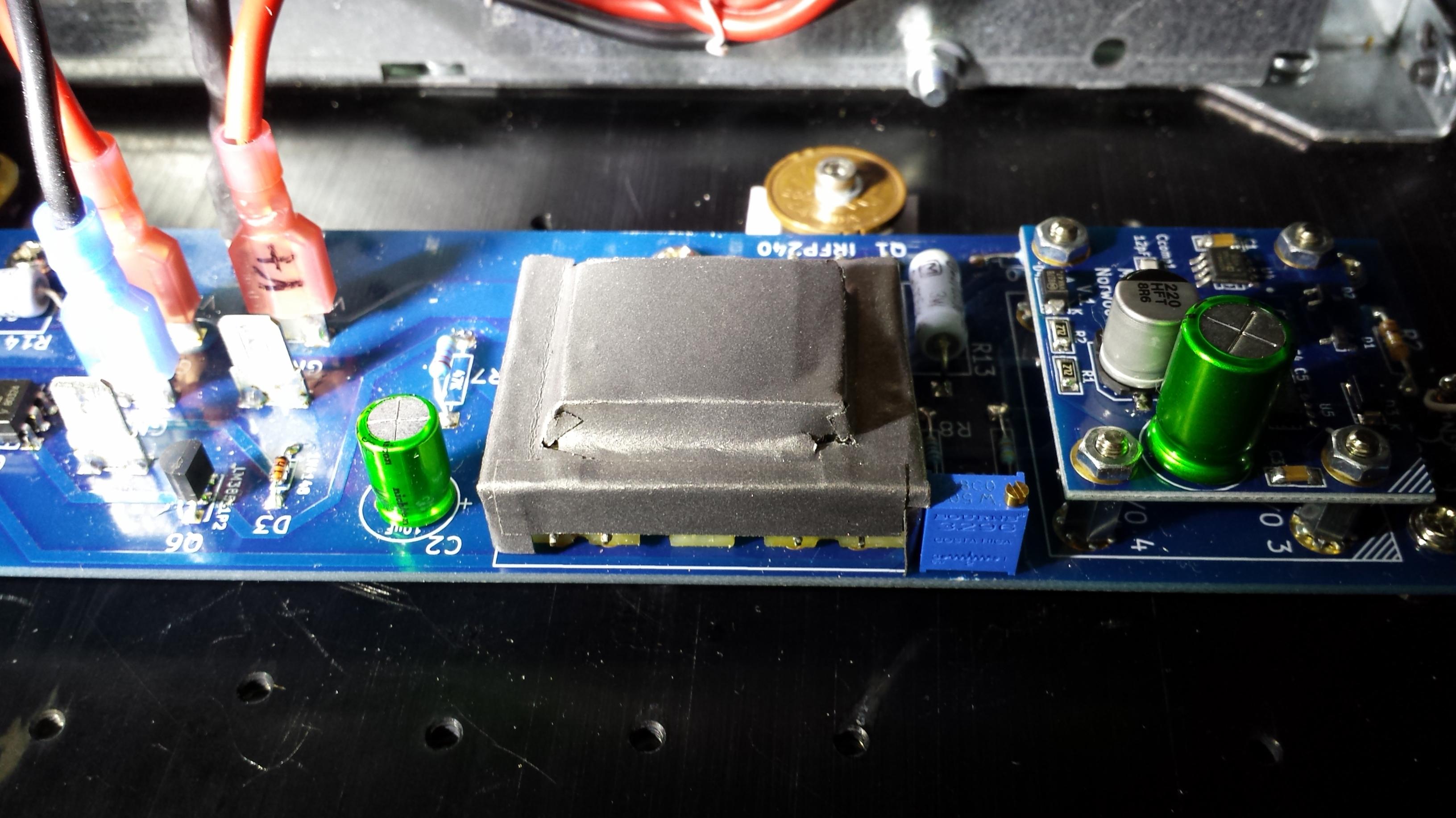

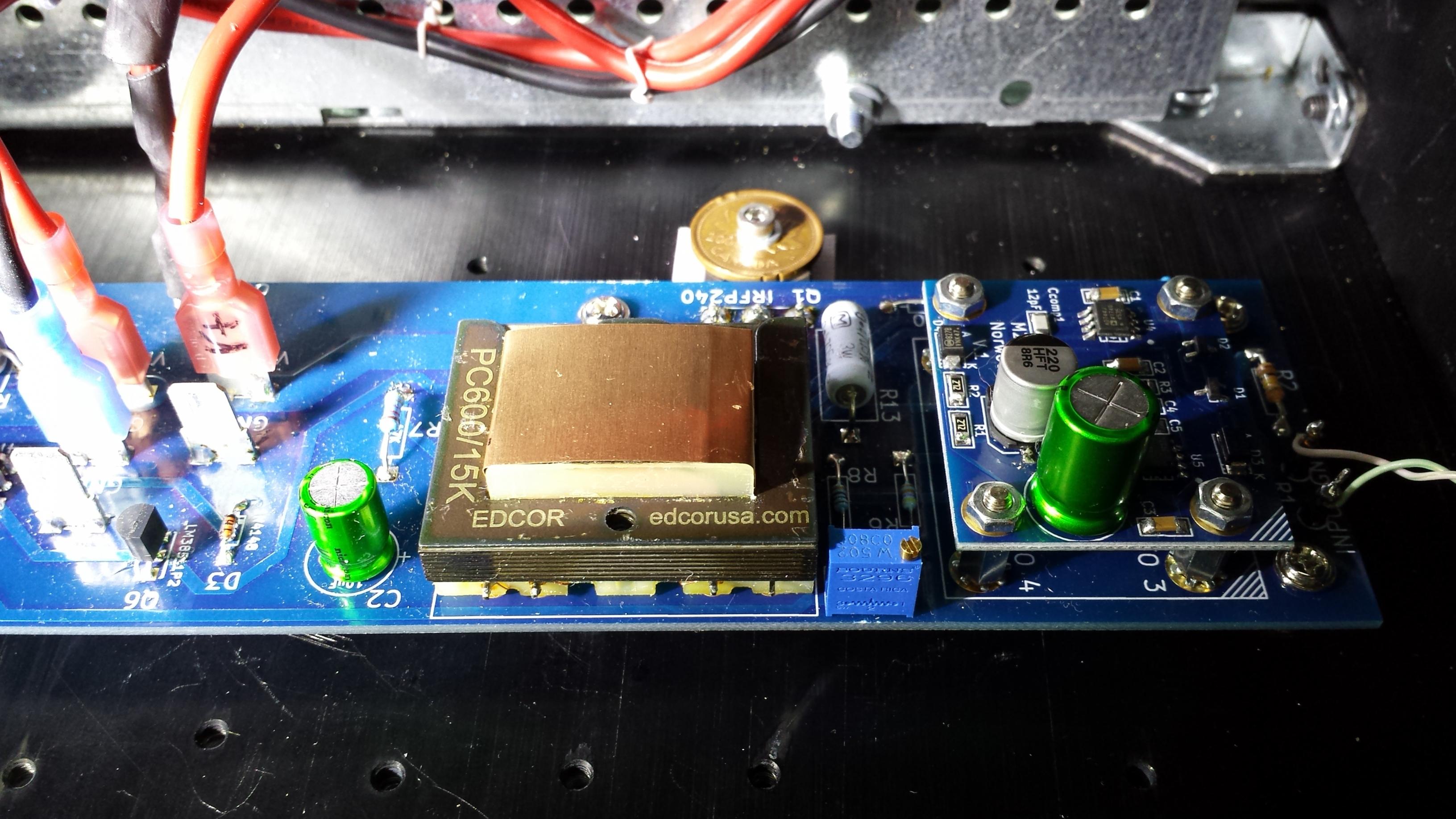

Hi,I have been listening to this fine amp and have noticed mine has a buzz through the speakers. I have tried many of the usual remedies have installed some copper on the small trans and a layer of EMI Shielding FF1 FLEX SHEET from Mouser . Nothing has changed in the sound or intensity.I do not have it with the Aleph J amp boards installed. So my question ,has anyone come across undamaged components on the pcb's that were adding to a noise issue like this? I don't have an oscilloscope . Thanks

Good point. Will also be aware of that issue now.I have it sitting on kitchen table inputs shorted and only one speaker attached to see if its same on both channels and it is buzz still there.I removed the transformer and moved it as far as possible put a can over it still no change. That's what has me thinking of something other than the edcor or it could still be it I don't know.... thanks for your input.

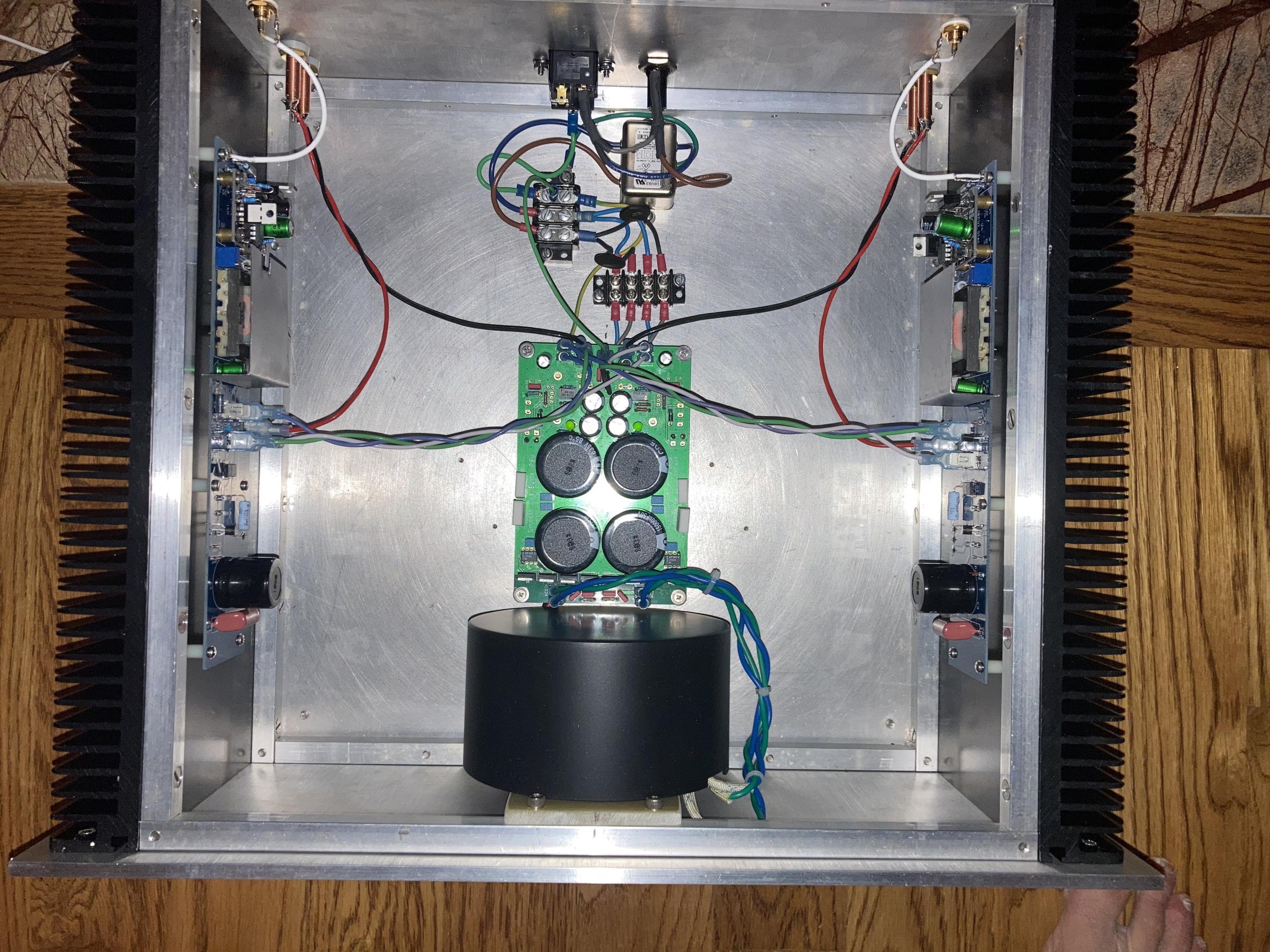

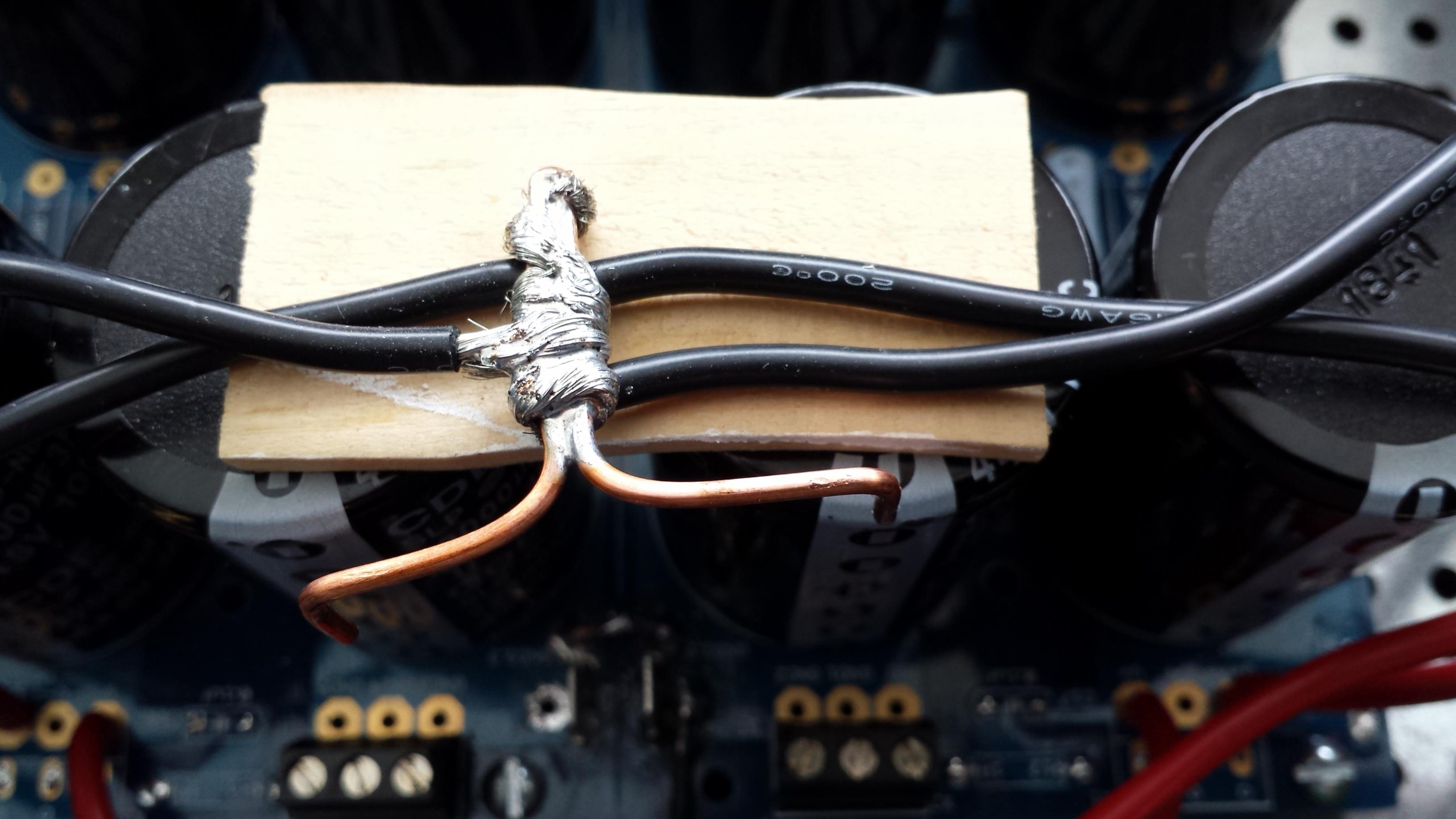

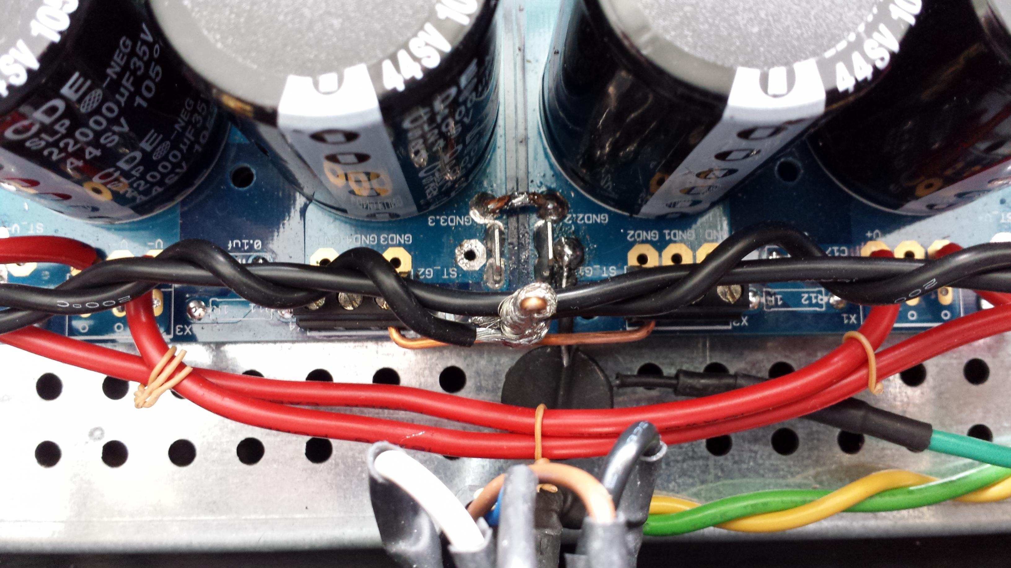

The power supply boards are from the diy store ,I played with the connections again today ,still same. Here's a couple of pics of my interpretation of the T grounding point . I have tried all positions from the original laid out in the build guide to this now.

Hard to comprehend the different results from basically the same set of boards. I see a copper bridge between G2 and G3 if I read correctly...why is that needed?

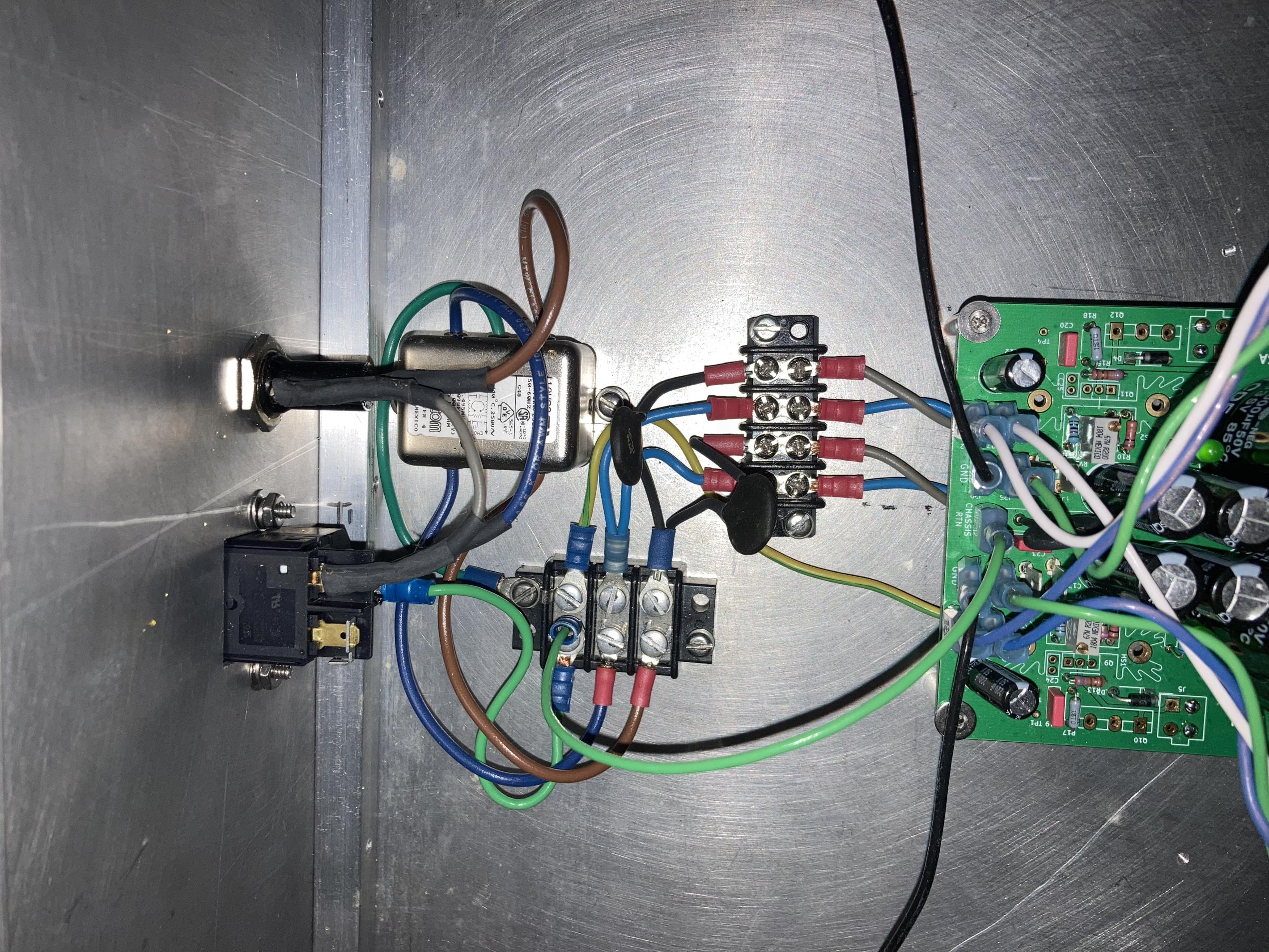

It's not much help but would suggest to rewire everything from scratch. Test wiring for hum one wiring step at a time. This are pics of my stupid simple wiring that is hum buzz-free. I used the SLB board but I am not using it as a CapMult but as a simple CRC for now. Best thing about the BLS board is that it reduces clutter since has on board mosfet rectification cool and low V drop. However, your results should be the same as mine.

I see. I am not sure why a new PS board would give a different result. Is it a hum or a buzz. They may have different causes. Did you try extending the transformer leads enough so that it is out of the case and rule it out as a source of interference? That maybe doable w/o cutting into the wiring too much.
