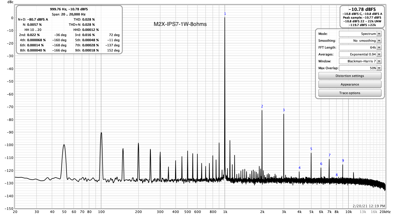

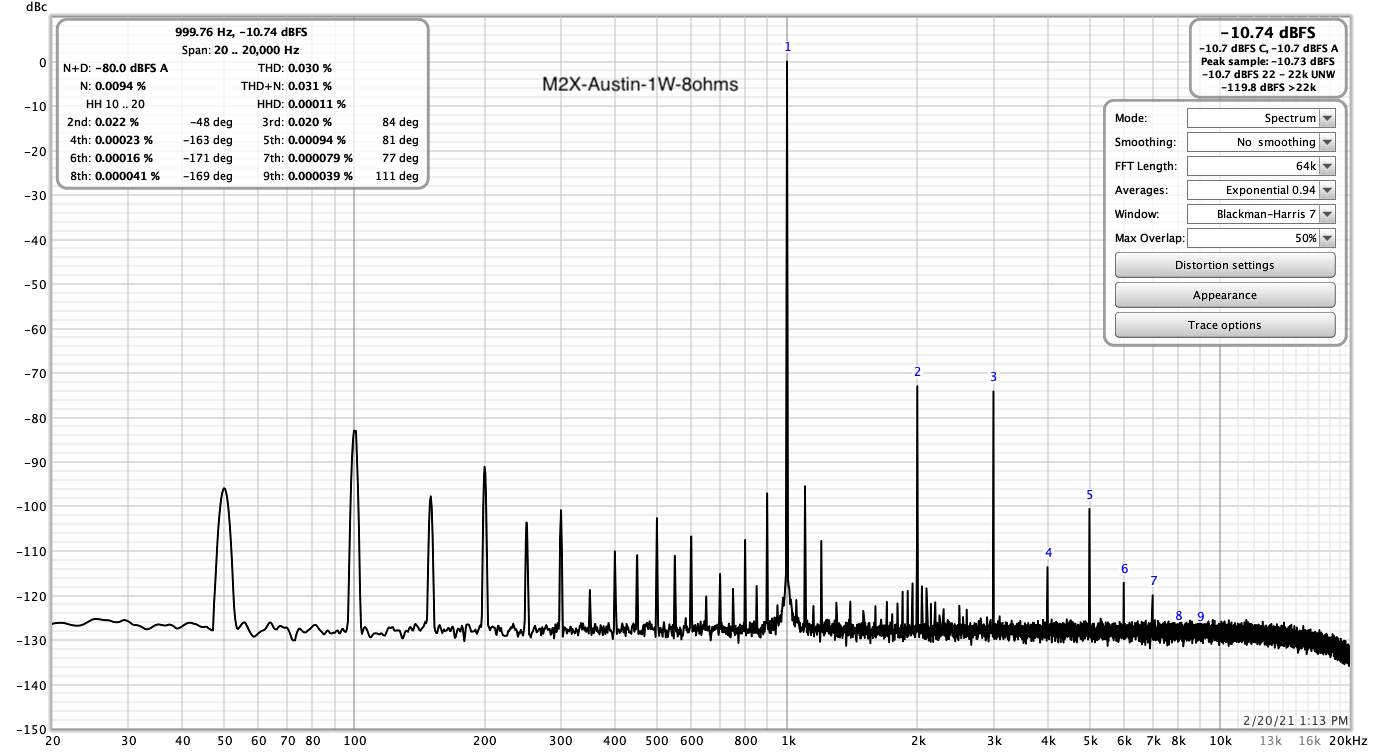

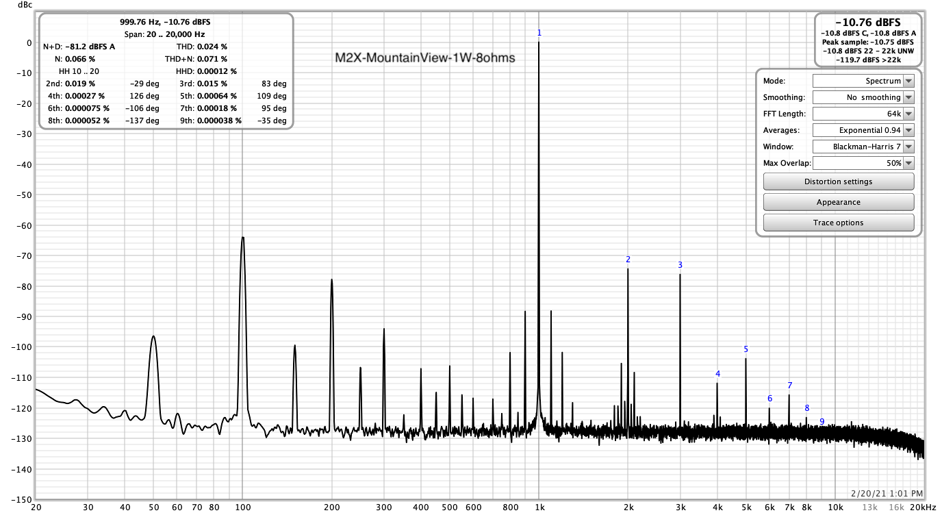

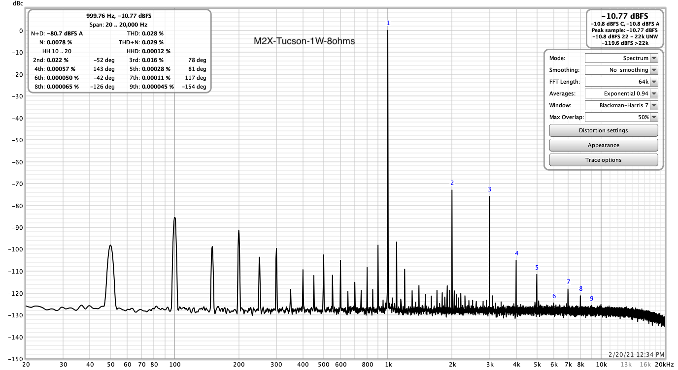

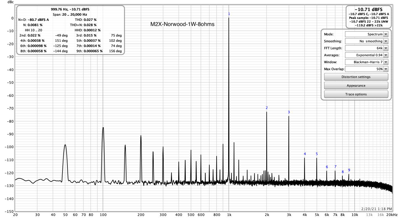

Concerning the differences of the buffer cards. I have made distortion measurements using Focusrite 2i2 with REW of my M2X with all the daugher cards I have (I do not have ..hm.. Ishikawa, IPS6 and Cedarburg).
Buffer being a buffer, I do not see any differences in the most important H2 and H3 between the daugher cards. Higher harmonics do differ a bit, but, being low, I am not sure if this could be just small variations in measuments, or if we could hear these small differences anyway.
What I found the cards differ in is how much they are prone to the hum and buzz from the power supply (at least in my M2X - I have transformer under a steel cover and Edcors covered by the mu-metal boxes without a lid from the heatsinks side).
My ears and my measurements tells me that Mountain View picks up the hum most easily. All other copes with that much better, with Norwood and IPS7 being my favourites in this aspect.
We all have our favorite cards. How much it is based on the sound and how much on other aspects like ideas of design, components used etc. - everyone can decide for himself.
I attach the pictures of my measurements if anybody is interested. I do not pretend these measurements are precise, but they are made with the same conditions, on the same channel of the amplifier, so I hope they are comparable between themselves.
Best regards
-Alvis
