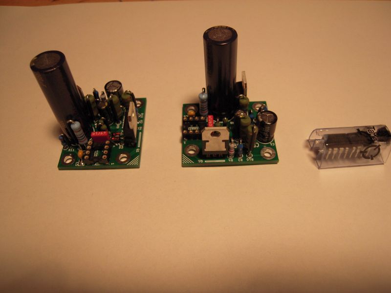

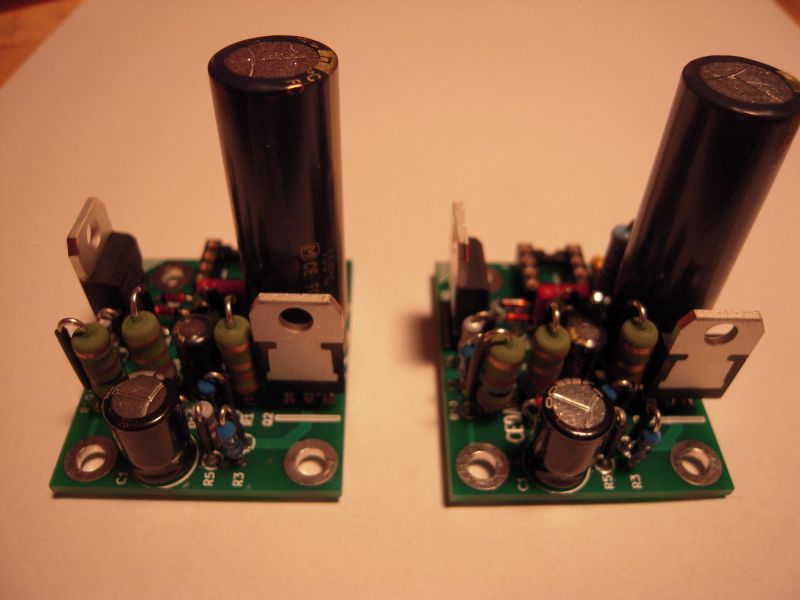

Hello M2X-builders,
I've got the last 2 parts to complete my Cedarburgs today.
I will have the first listening session tonight. :note:
Those 1000µF - Panasonic caps look like a skyscraper in Cedarburg....🙄
Cheers
Dirk :drink:

M2X-Cedarburg
Yep,
Cedarburg sounds really great.
The first impression is very detailed and 'accurate'.
I understand why the AD797 is suggested for preamps; microphone preamps,...
Chet Baker was breathing and pressing the air into his trumpet....
Kinga Glyk played the bass and you could hear her striking the strings and how they sustained - long and clear.
Very good show!
But also with rock music I had fun.
Dirk
