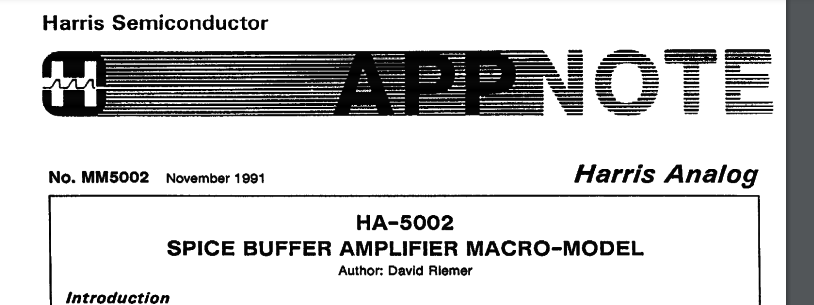

There are video buffer ICs available today, which viciously kick asszs upon the ancient HA-5002 used in Norwood. SPICE model in 1991 means first production in 1990. The thing is over 30 years old, no surprise that others have caught up and surpassed it by a wide margin.
Flop out two or three PCBs with two or three newer video buffer chips, and experiment with TurboNorwood V.1 and V.2 and V.3 . You'll have smashing great fun. Be sure to provide Moderator 6L6 with progress reports and listening evaluations. He really, really likes line level circuits which include video buffer ICs. He even loved the Azul HPA @ Burning Amp 2019, which used extremely ancient LH0033 video buffers to drive headphones. Gulp!
