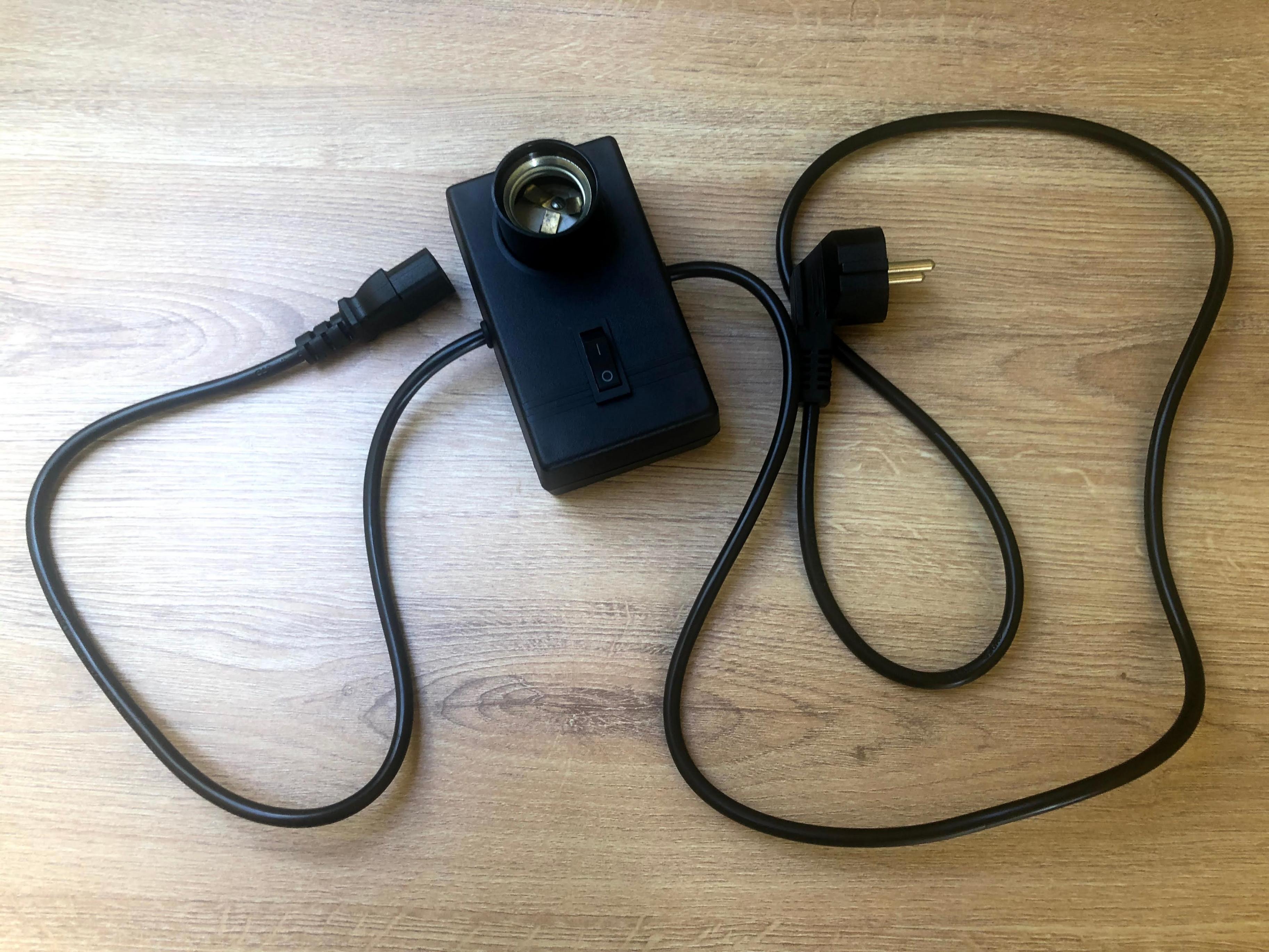

Yes, I did build the very nice Light Bulb Tester (see picture), and I used it when first time powering the transformer without the PSU board yet connected. The bulb did not even flash (made me a bit suspicious). Then I connected the PSU and tested again. No flash. Very suspicious. Anyway, measured the output voltage nicely at + and - 24V DC, so I connected the amp boards and there was to smoke - as we all expect, because we are careful builders, aren't we? Only then I tried it with the bulb tester again. As the was no flash of light, I decided to carefully check some points on the tester itself. And it measured weirdly. Then I shorted the L and N on the output cord of the tester - and the bulb did not glow anyway. Only then I found out that the bulb holder contacts were not touching the bulb... So - test your tester before using it on your precious creation.

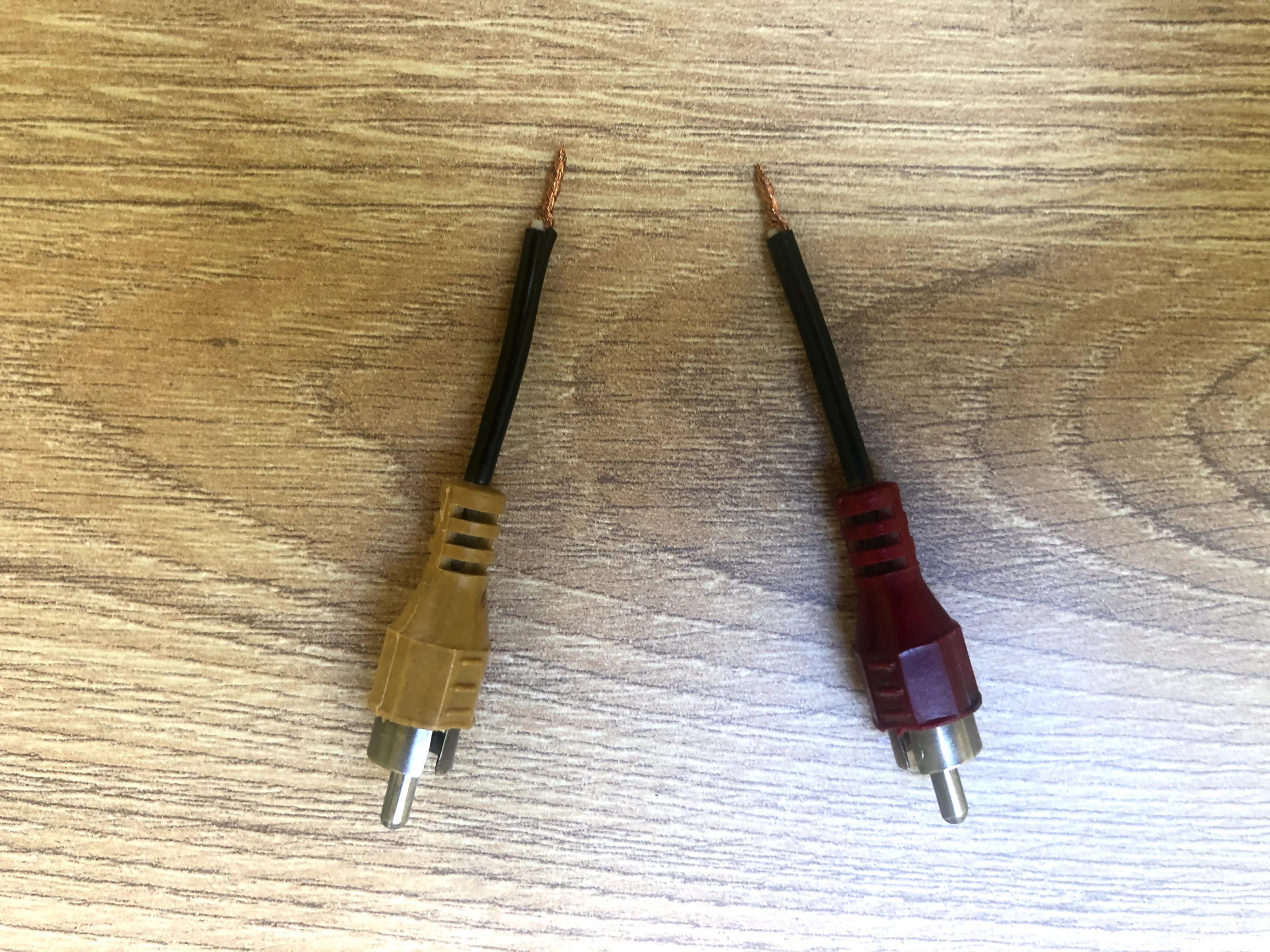

Next. Adjustment process. As everything looked fine, I shorted the inputs (had to Google how this has to be done - short the signal pin with the ground sleeve of each input terminal making a special plug for that - I sacrified an old RCA cable for this (see picture) - not shorting the left and right input terminals with the cable as I initialy imagined - well, I "was" a total noob, you know). Then I connected the multi-meter on the output and started to adjust the RV1. I was surprised it was not making any difference on the voltage I saw. Well, I shruged my shoulders and connected the loudspeakers. It played music nicely. And only then I resorted to reading and found these posts:

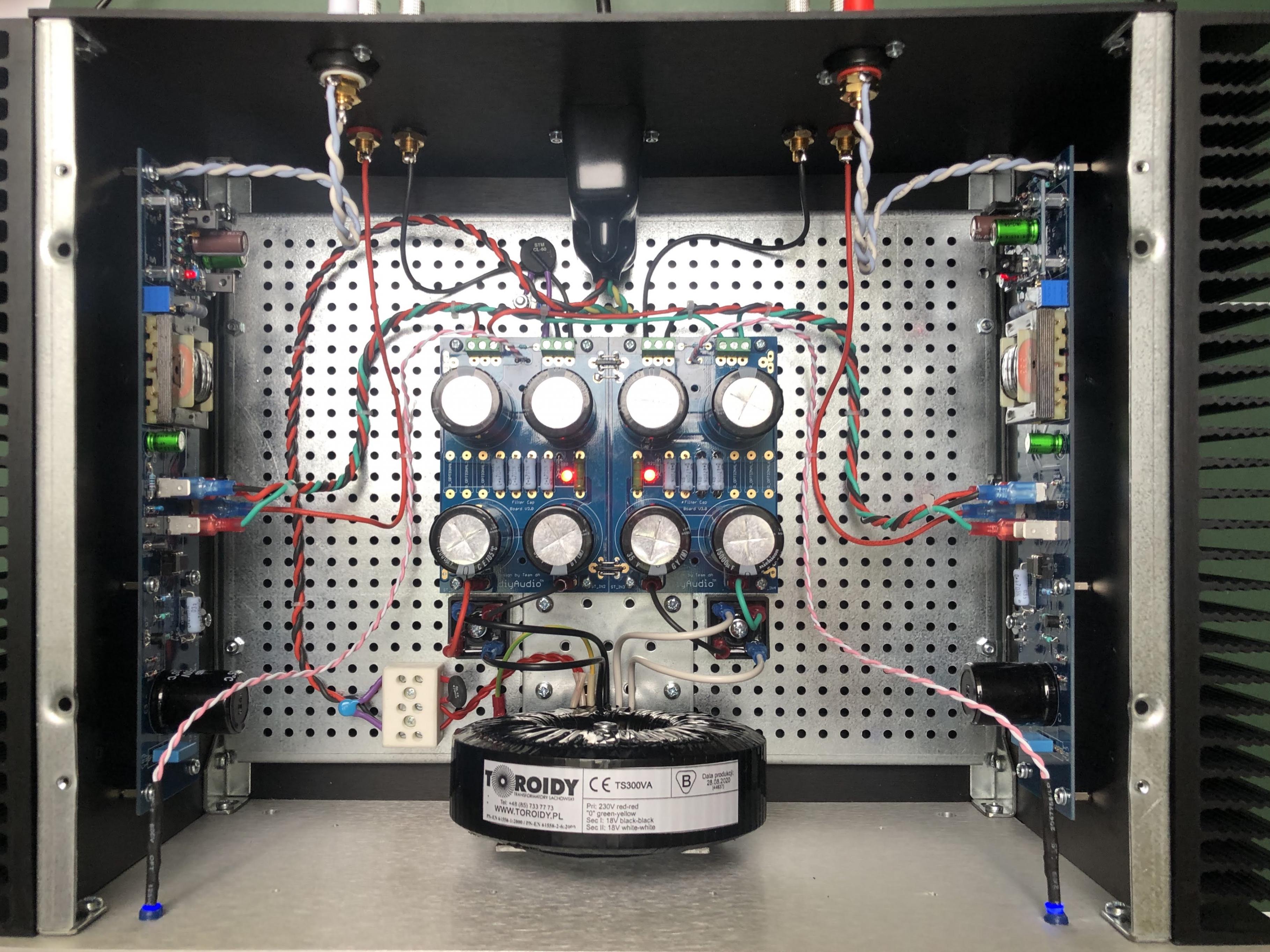

I enjoy listening to my M2X, but there is one small (and common, I suppose) problem - small hum. It is very small, but still a little bit audible even about a meter away from my very small low sensitivity DIY Overnight Sensations desktop speakers. It's really minor (for my understanding), but I would still want to get rid of it.
I do not have an osciloscope, but even with my privitive mobile phone app spectrometer I can see that the hum is 50Hz and harmonics (100Hz, 150Hz) (see picture). Does it help to identify the source of hum? Is it from not ideal grounding scheme? Or is it from the toroid EMI? Or could 50Hz be because of both reasons? Or other reasons?
Neither my toroid (audio grade from Toroidy) nor Edcors are shielded.
My output ground goes directly to the star ground on the PSU.
Star ground is "lifted" from the safety ground by the CL60.
I am going to experiment, but first I would like to identify the source and the reason of the hum, if this could be told from the frequency itsetf. Could anyone be kind to share their thoughts?

You may want to try connecting the loudspeaker output grounds to the dedicated PCB connection points instead of the power supply.
Shielding the input transformers has helped several builders. As has shielding the power transformer.
Your wiring is functional, and esthetically pleasing. I try to minimize the lengths of my input wires, and bend them as far away from the AC carrying wires. Less important, to me are the output wires, but it still can help to move then away from AC currents.
I am currently in favor of grounding speaker out to the star ground, but my opinion carries very little weight.
I did shield the input transformer with copper tape and mu metal. I do adjust wiring to avoid input/output to be near AC. I have just a minimal hum with ears close to my 95db speakers. I can't hear it a foot away, and certainly can't when music is playing.
I have shielded Toroidy transformers on order.

Thanks Bones13 and avdesignguru.
I made the input wires a bit shorter and rewired output ground from PSU to the amplifier boards. Nothing changed - same small hum. It's really small and barely hearable in one meter from the speakers, so I will live with it for now. Next step would be isolation of the toroid and/or Edcors, and I am not so much into this as the hum is not big.

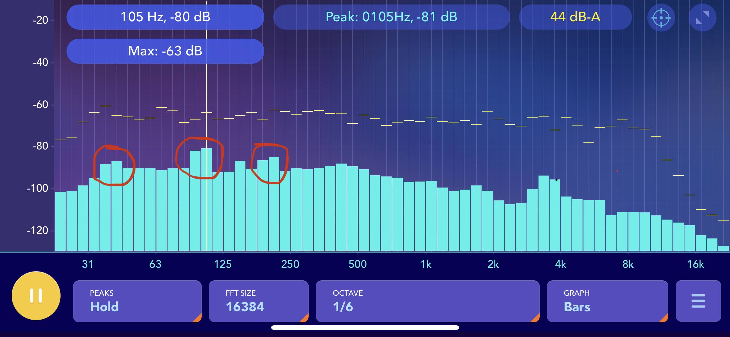

@amandarae, yes, the hum is still there when pre-amp is disconnected.
Also, I made some measurements with my mobile phone Spectrum app (the best I can do, so please take these numbers for what they worth). When pre-amp is connected and is on, or when it's dissconnected, the hum level next to the speaker is:
50Hz -95dB, 100Hz -85dB, 200Hz -95dB
Actually, the ambient noise in the room measured at the level of about:
50Hz -95dB, 100Hz -98dB, 200Hz -99dB
So, the only problem I see is on the 100Hz. And in 1m distance, the hum is on the ambient level when measured on the phone, though ears can still hear that the amp is on.
Interestingly, when pre-amp is connected but is off, this adds quite loud noice at 50Hz (on the level of -81dB, very audible). But when you turn the pre-amp on, this disappears. The pre-amp is Shiit Magni 3+.

@pfarrell, I changed MV to Tucson. Wow, it made instant difference with the hum!
The hum on 100Hz went down from -85dB with MV to -91dB with Tucson!
What a difference! That means the hum almost disappeared!
So, I definitely confirm that the daughter board makes a difference on the 100Hz hum.
