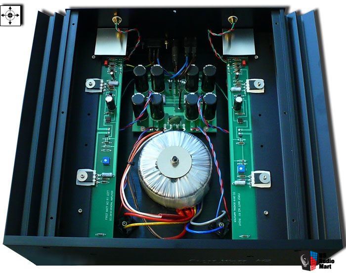

I was under the distinct impression that the FW amps did in fact have shielded edcors (see pic). Maybe someone can 100% confirm this—pictures may lie? It was actually the basis of importance to try it for me—plus education and exploration—but of all the things I did—it made the most significant difference.
Papa mentioned mu metal shield in post #1893 here:
https://www.diyaudio.com/forums/pass-labs/281520-official-m2-schematic-190.html#post5090644

Denis, thank you for the reference to the fact that Edcors were shielded in the original FW. That way it is part of the NP design and should really be followed for the best results.

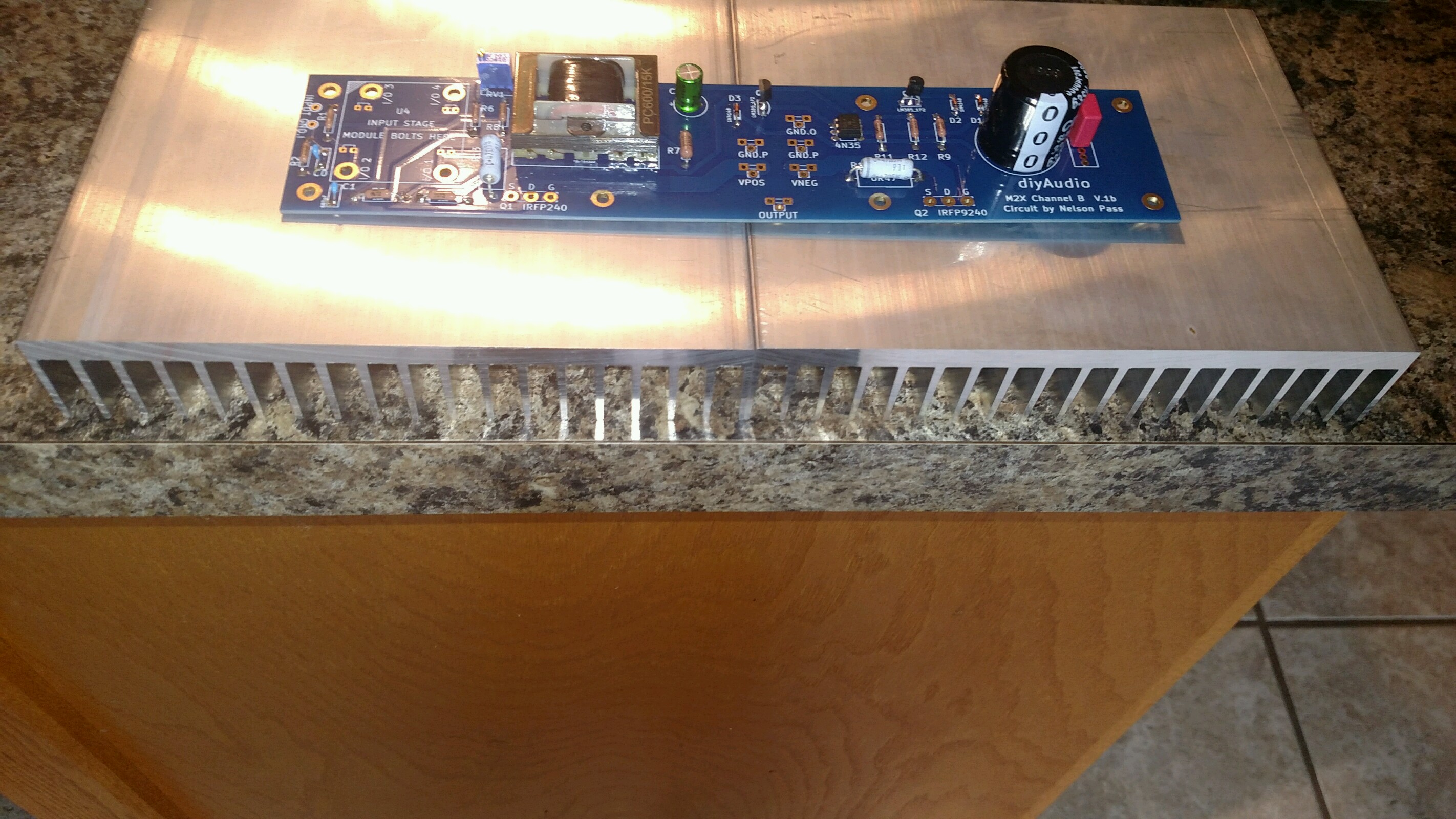

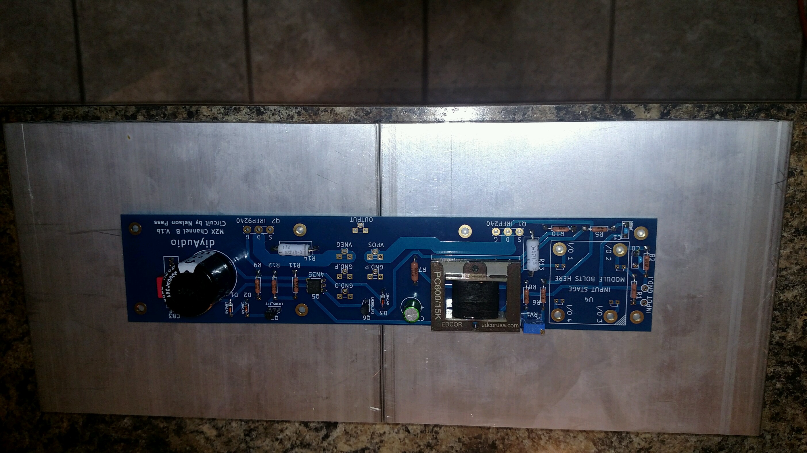

Have a lot of work ahead of me, got to start somewhere.
Heat sinks are 6" x 7.25", so 6"x 14.5 inches per board.
My plan is to build each case 10" wide x 14.5" deep.
Which leaves my with 9.7" by 14.5" to stuff things into.
Looks good on paper anyway.

Have the Mu metal ordered for the Edcores

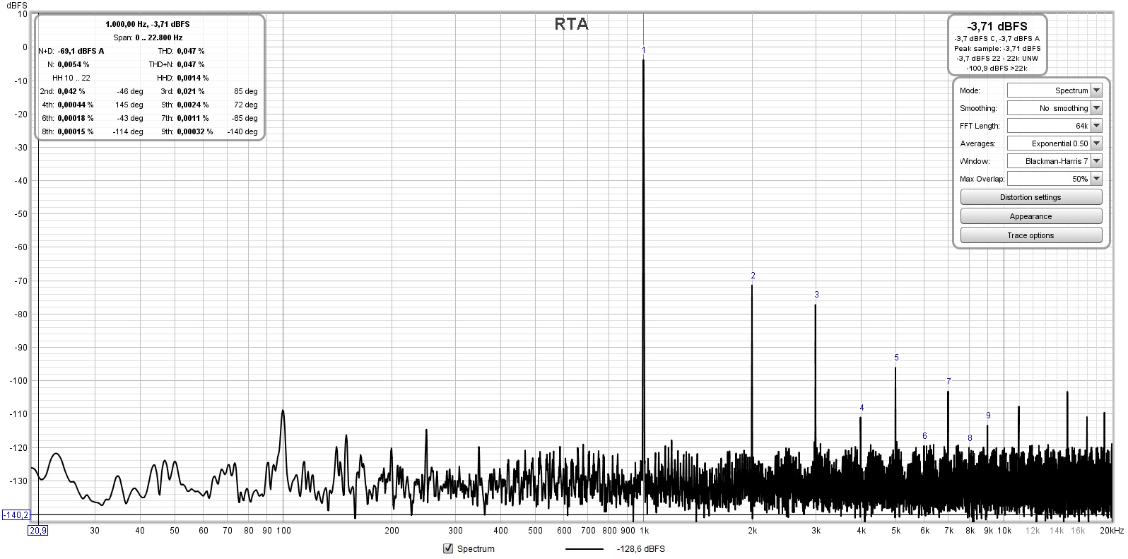

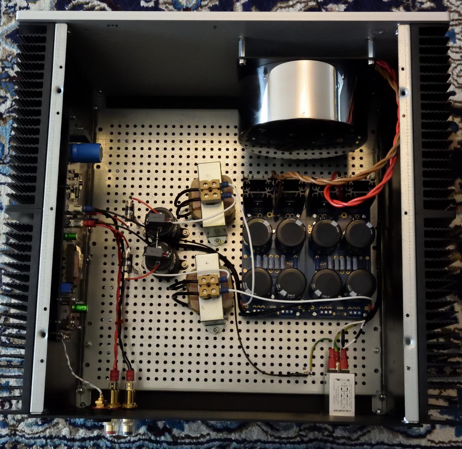

I have upgraded my M2X mono blocks with new silent toroid's. The old had some mechanical hum that got me frustrated. Then I also added an IEC with filter (2A type). I made REW distortion measurement to check if new transformer had any influence on distortion pattern. What was most obvious was that 50Hz peak had disappeared and rest look about the same as with old toroid. Before I had a 50Hz peak that was almost 10dB higher than 100Hz peak (but that was still quite low and not audible). So shielding of power transformer works and also shielding of Edcor. 100Hz peak is more than 105dB down which is very low I think. I also think all other harmonics than 2nd and 3rd are down at a level that you can consider them almost "non existing"?
The amp outputs 4.7V RMS into a 6.8R load during measurement (1 kHz). That is a lot more than I usually play. Toroid is also 100% mechanical silent now. If I put ear down to it I can hear very little if I concentrate on hearing it and there is no other noise in the room. So I think operation was successful.
It also shows that M2X can be extremely silent with no hum at all (mechanical and electrical).
