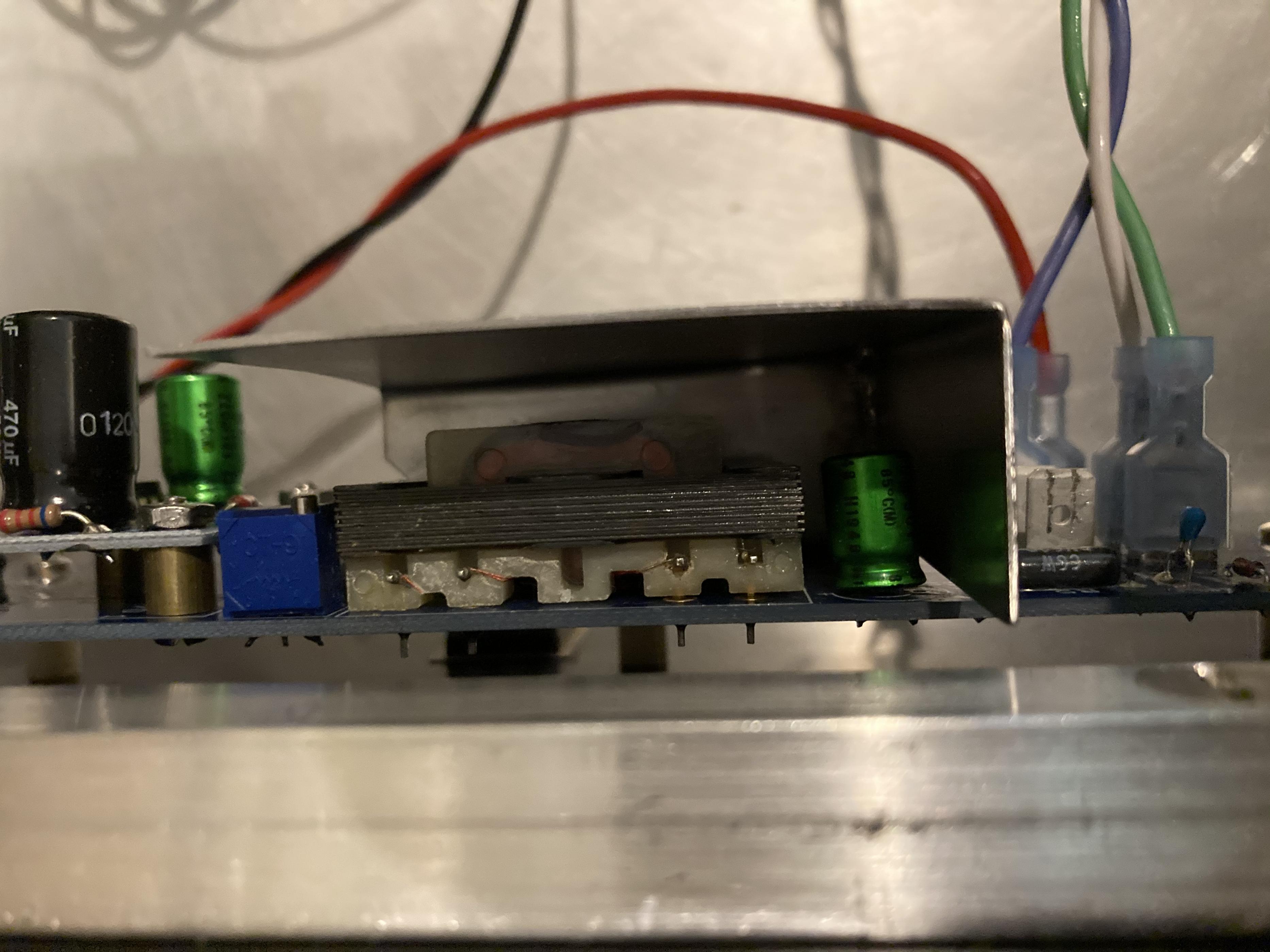

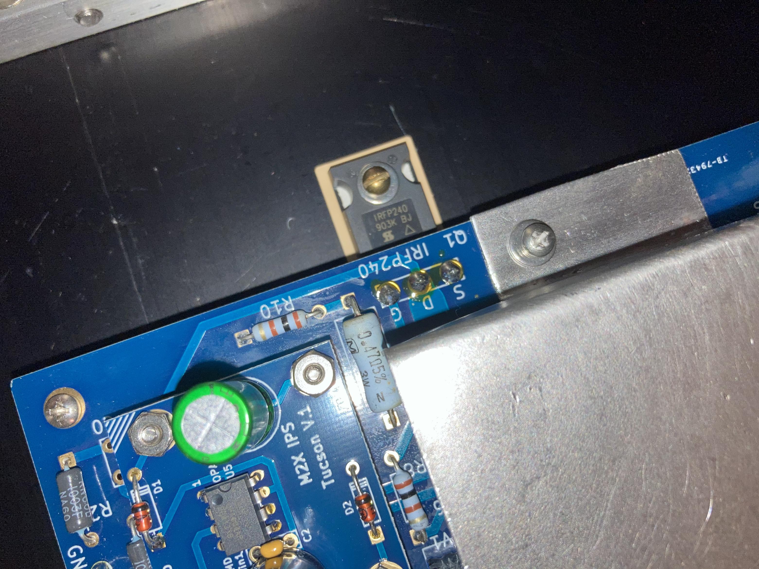

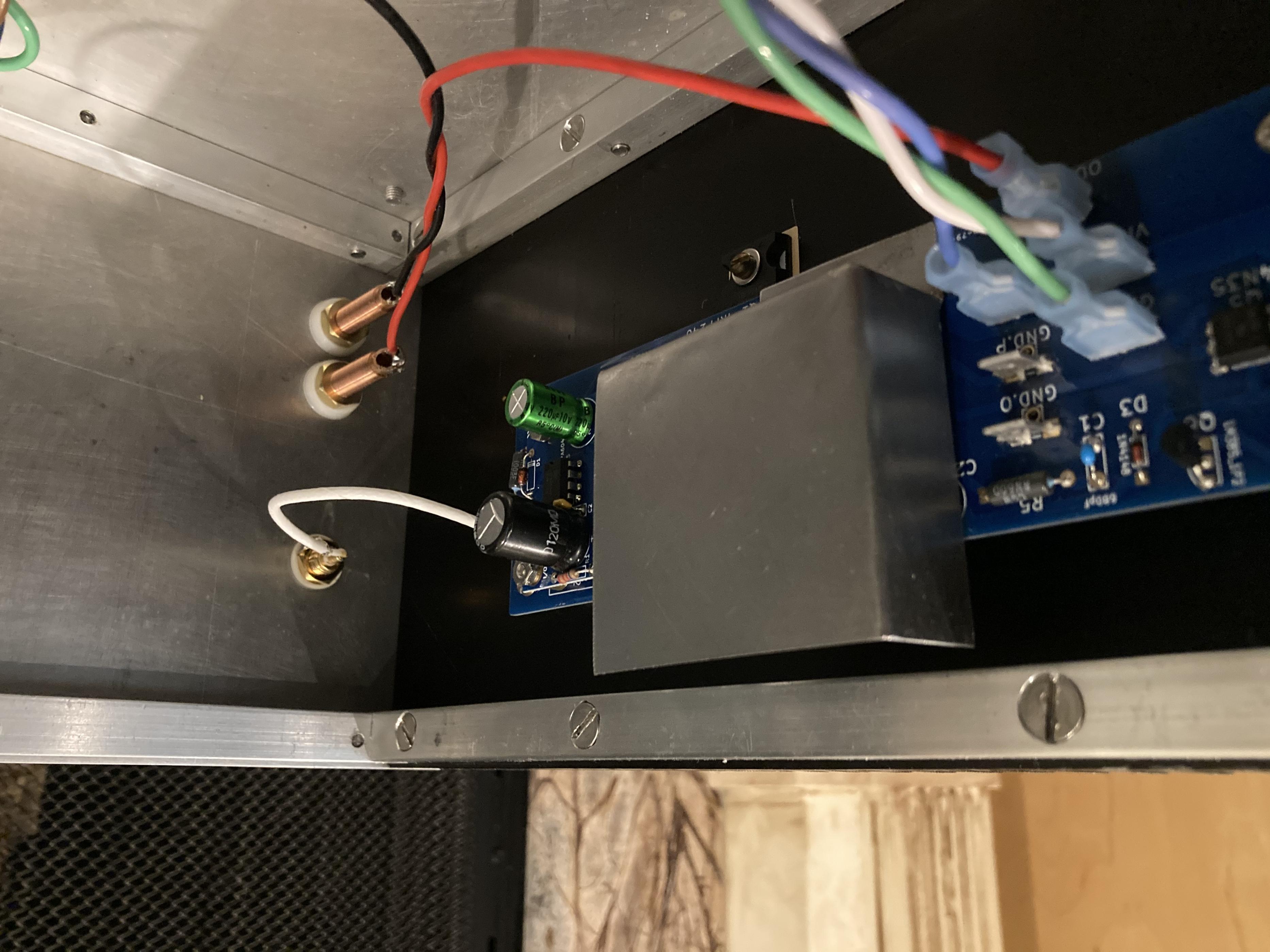

this is the one that did not make any difference. I had virtually no noise to begin with. This is 22 ga steel super simple and it does not hug the edcor quite so much.
Only way to test this is to remove the toroid case and see what the effect is. Installing that made a HUGE difference in sound quality. That is also 2mm steel case from antek.

@grataku, did I understand correctly that putting the power toroid in steel case made a huge difference for you, and after that a small steel case around the Edcor did not make any difference that you could hear?

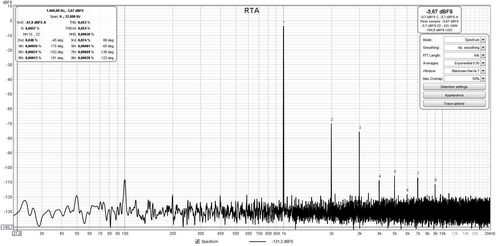

When you do these experiments with shielding it is a big help to have distortion measurement running (e.g. Focusrite (sound card), REW, M2X) in a closed loop. Then you can see exactly which effect your shielding has on distortion / noise.
yes

I have no hum at all, and do not have the Edcor shielded. It wasn't luck though as I gave a lot of thought to layout because of all your input here. I'm from the the KISS school, if you can prevent something from happening in the first place, you don't have to patch it later. I have some pretty good gear for testing now, but haven't even plugged it in and learned how to use it lol. This winter, I shall do so, but with not to get perfect forms or this or that value. "perfect." I'm going to use it to learn what those values look like on amplifiers, speakers, chain that appeal to me. I could give a damn if it's something that others scoff at. It's all about you and your reaction to what you hear.

I like to measure everything. I also feel confident when both M2X channels measures equal has has exact same distortion profile.

What I experienced with the transformer case was a completely different high frequency response and sound like going from a regular driver to a compression loaded driver. Quite amazing difference and totally unexpected suggesting that the mains transformer was somehow coupling to the EDCOR and distorting/attenuating it's mid/hi response...but I am talking nonsense..🙄😱

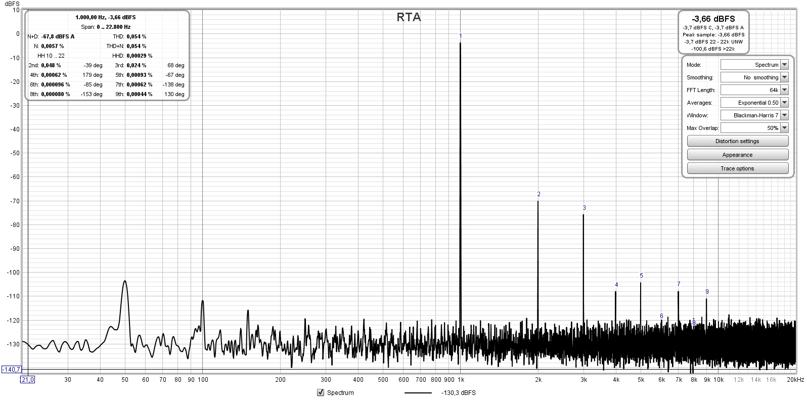

My DMM has a 0.1 mV resolution in AC mode. So if it shows 0.0 mV I assume that I have less than 50uV of noise. Also my DMM is a true RMS DMM. In your case a distortion measurement will be best like the image attached of one channel of my M2X. Oscilloscopes exists that has 100 uV pr. div. sensitivity but most normal is 1-2 mV / div. if you use a x1 probe. And you should be able to see "something". It is never easy to measure these weak signals and be sure you measure the amp and not something from environment. For my distortion measurement I made an interface box that goes from banana plugs to a 6.8R power resistor and from there to RCA with a divider network so signal fits to the Focusrite sound card input level. Then I can measure amp when it delivers like say 1-4 Watts.
To show how tricky noise measurements can be I have attached both L and R channel measurements. I have mono blocks and I have tried to make an exact mirror of the mono blocks. But not all components is "mirrored" like IEC and PSU print and also M2X PCB is not an exact mirror of the other. Input board is not mirrored also and Edcor's. So it can't be a 100% mirror. Also the toroid transformers may not have exact same hum field distribution.
So one channel shows more 50 Hz noise and a bit less 100 Hz noise than the other. But levels are still quite low and I am happy with that distortion profile looks about equal on both channels. Also total THD and N is quite equal. So all in all I am happy with my build. The amps outputs 4.7V RMS into 6.8R in these measurements.
What I think I noticed was that with small signal levels the amp is slightly 3rd harmonic and shift to slightly 2nd harmonic when amp delivers more power. But I did not spend time on low level measurements which I should probably do also. Also a check how amp performs at high frequency could be interesting.
