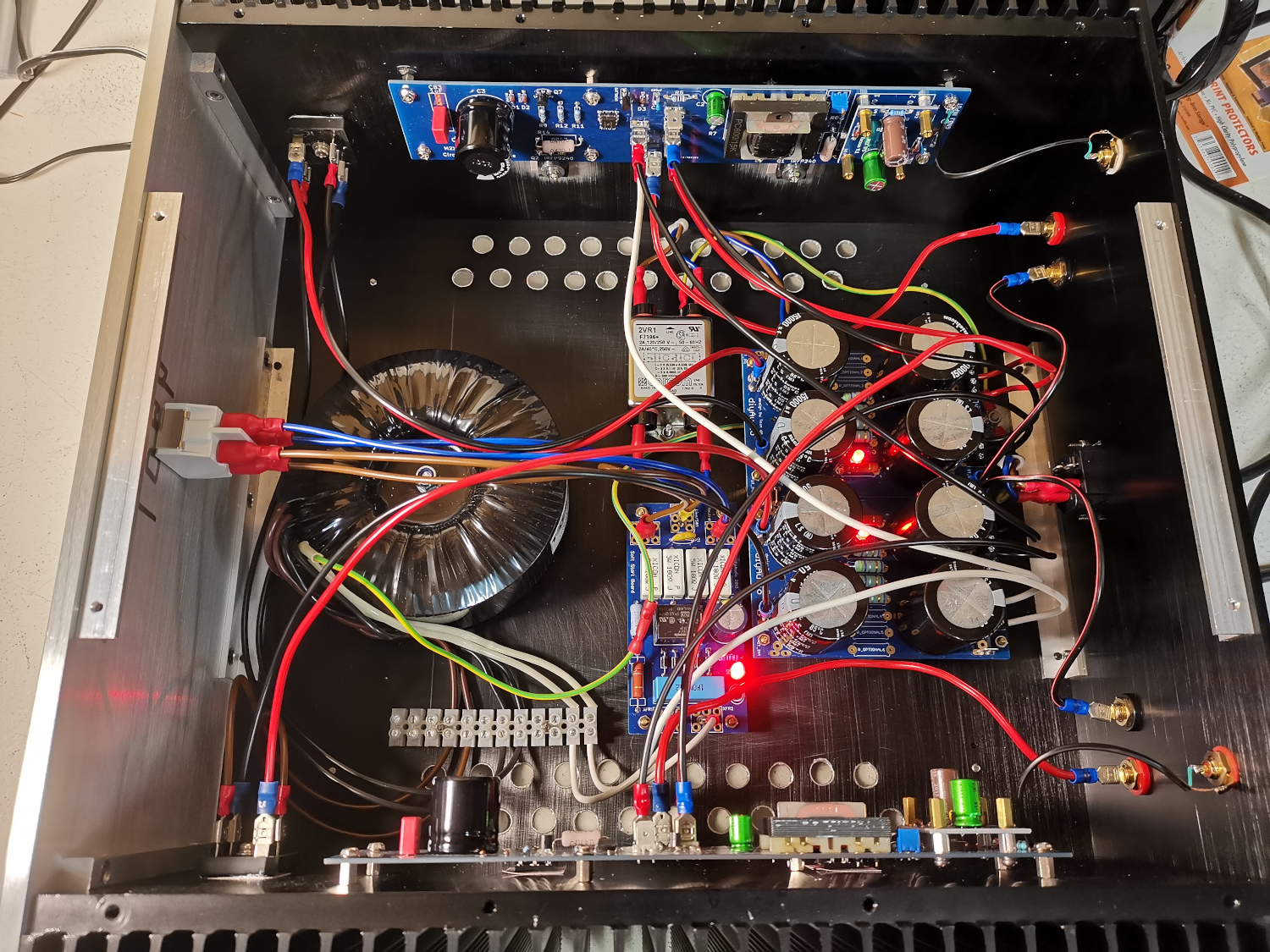

What do you use to properly mount a toroid in a vertical position to the chassis? Is anything suitable available on Mouser, or should I better check my local hardware store?
I cut out a piece of G10 I had around, mounted it vertically and drilled a hole for the toroidal in it as shown in pics. Since I have the transformer in the ferrous shielding the base material should be non magnetic to avoid closing the magnetic circuit around the transformer and creating all kinds of tranformer issues.
Given the difference in sound it made I think shielding the power transformer or the edcors or both is a must. The CA case from antek work like a charm. I am working on the the edcor shielding now I bought some steel sheet yesterday.

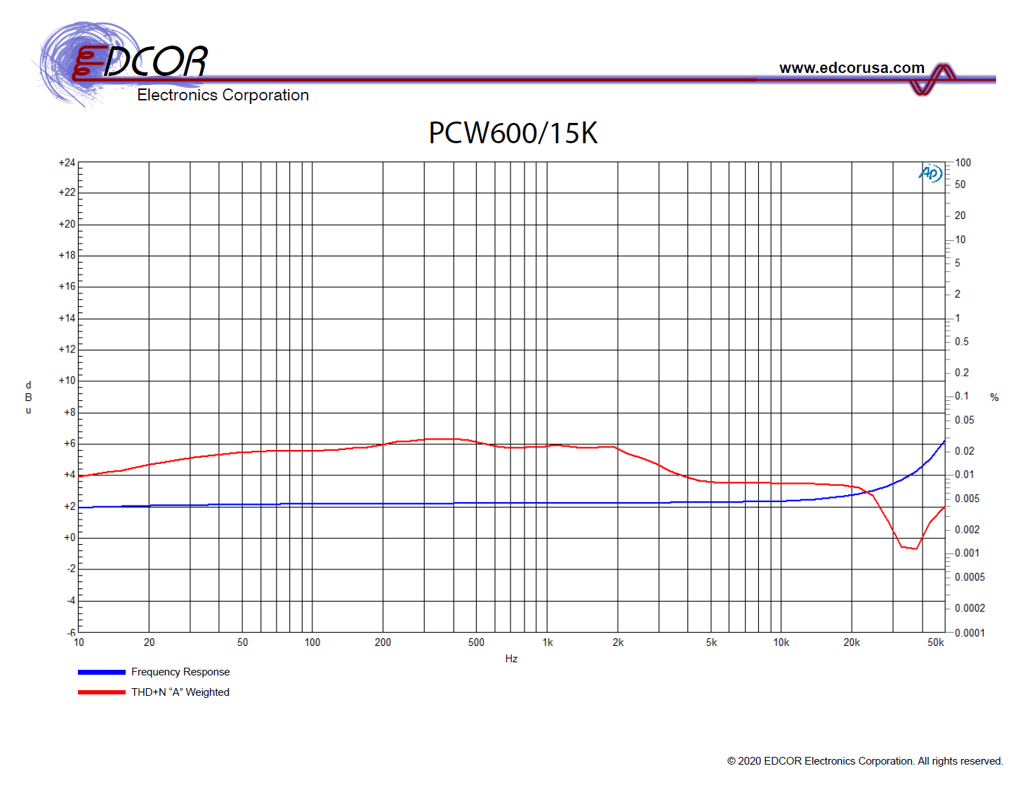

The frequency sweep/THD plot for the 1/2 watt PCW variant isn't on Edcor's website, so I thought I'd post it here. I'm not sure how helpful the data is at only +2dBu, but here it is.
See here and here for some data on the PC600-15k.
  • PCW600-15K.pdf
    PCW600-15K.pdf

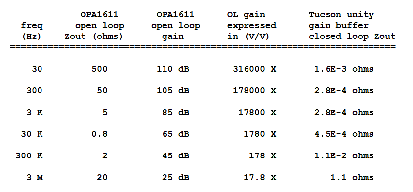

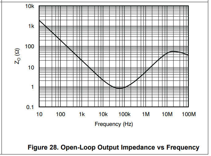

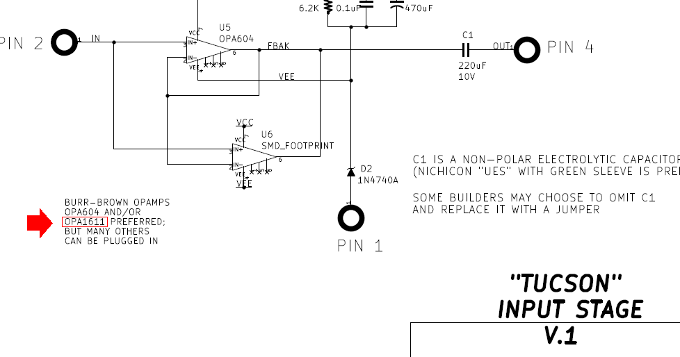

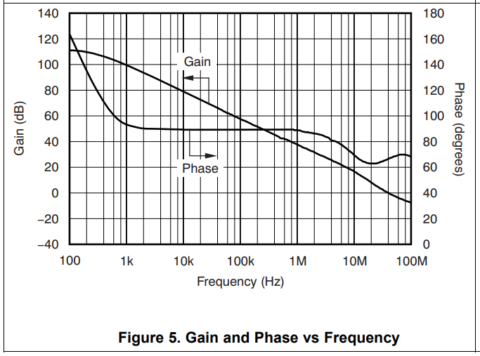

Norwood may not be the only input stage daughter card with extremely low output impedance. Attachments below.
_

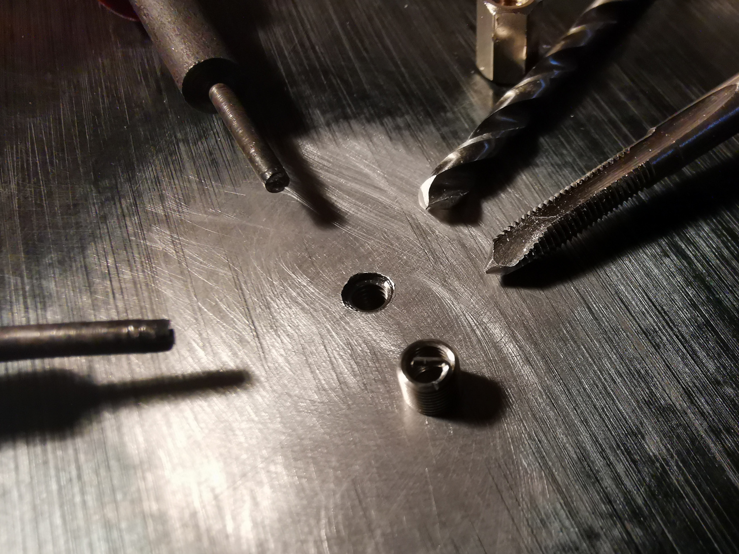

My M2X is close to completion, but I managed to damage a thread on one of the heat sinks during tapping. But I discovered that there is a solution when accidents like that happen. I acquired a M3 thread repair kit and installed new steel threads. Luckily very easy to do!

A solution could also be to fill up with chemical metal and try to tap again. I can see you use a "machine tap"? and not "hand taps" which is usually a set of three taps. They cuts more gently as they cut little by little. Also special taps exists that are made for tapping when it is not a "through hole".
Chemical metal is something to try next time! I didn't know there are different taps for through hole and not through holes. I was wondering about that, since the taps I have didn't cut all the way down.
The tap in the photo is part of the repair kit. Before installing the threads the old threads has to be drilled out with a 3.1 mm drill bit, and then one has to tap the hole with the tap supplied in the kit. When that is done, the new threads are screwed in with a special tool.

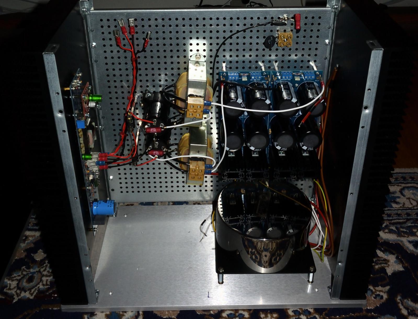

My M2X's are under slight reconstruction. I mount new toriods that should be mechanical noise free. The old had some mechanical humming. To mount the transformer I cut 4 new 4mm threads in the front panel. For that I just used normal hand taps (set of three) and after each I cleaned the hole for metal. "Blind hole" taps could off course be nice. My upgrade of the amp also includes Schurter connector with noise filter. I have some 2A types (these has much more effective filter than e.g. 10A type). To mount these the square hole in the back panel needs to be filed at bit. Therefor back panel has been removed to do this.
