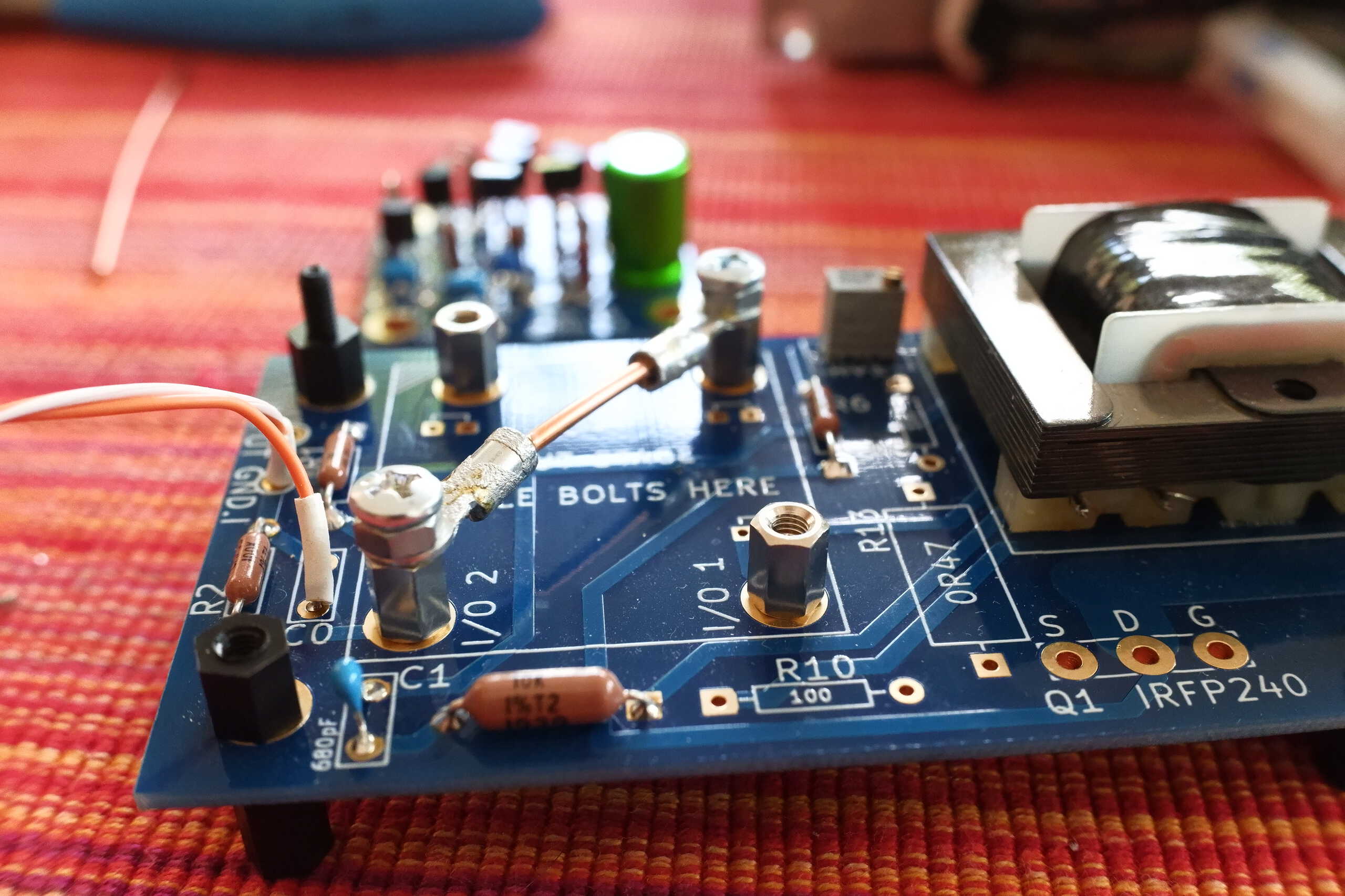

You might consider finding a way to temporarily short out resistor R1 on the M2x main amplifier board, when you experiment with straight-wire-bypass of the input stage daughter card. The impedance looking into the primary of the Edcor transformer is 600 to 700 ohms, and that impedance includes a reactive component thanks to the giant capacitive load on the secondary, reflected back to the primary. So you'd like to drive it with as low an impedance as possible. {which some people feel is the reason why Norwood sounds so good: it has a stupendously low output impedance}. Putting R1 = 1 kilohms in series with the output of your upstream audio gear, guarantees that your Edcor transformer will NOT be driven by a low impedance.
With preamps like Whammy and BA2018 linestage (with large output transistors) these should be able to drive Edcor directly. Then I was thinking of an input board which only has the green coupling cap to protect Edcor against DC. Would that work?
Maybe a Tucson board could be modified for that purpose......I have several.
I can confirm that works just fine. I'm doing it driving the M2X directly from a B1-type buffer pre-amp (Mesmerize DCB1). It didn't need a coupling cap, either.
However, make sure the M2X input voltage divider (R1/R2) does not bring down the signal too much -- make R1 something small (or 0R0, if you dare).

Yes, R1 has to be a "short". I think I have 6-7 ohm source resistors on Whammy output stage. BA 2018 linestage I use 15 ohm resistors as far as I remember.....but I now see the advantage of Norwoods that has direct output to Edcor with only a coupling cap to prevent DC.
I put mine on solder tails/DIP sockets. I can switch out according to whatever type of pre I'm using at the time. Easy-peasy.
Ok, that is a nice solution.
If only the green cap is mounted on Tucson board and then a jumber from pin 3 to 6 then Tucson can be used just as DC-blocking passive board?
Even if preamp is almost DC-free when it is up to temp then during warm-up some DC may occur that can "damage" the Edcor. Think I prefer a DC-block cap in front of Edcor. Then input boards could also be moved out of M2X and used as preamp with its own regulated low noise PSU. So no other preamp than the input boards. M2X has enough gain for my use.

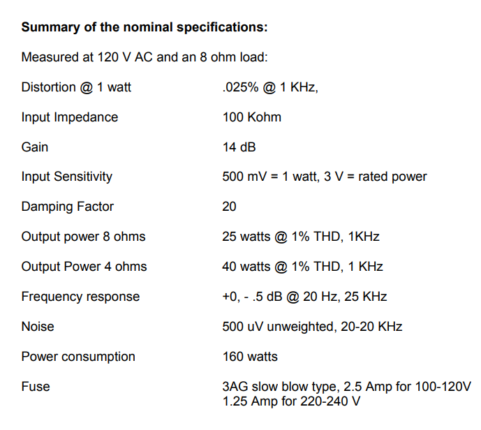

I found this datasheet which contains thermal resistance specifications for the bridge rectifier package "GBPC" as is commonly used in power supplies for First Watt amp clones. It's what I used in my M2x for example.
Maybe someone can put together the math which predicts the junction temperature and case temperature of the GBPC bridge rectifier. Two of these bridges are used (one for DC Vpos, another for DC Vneg), in a Class A power amplifier that draws 160 watts from the AC mains when delivering ± 23 volts DC.
_
Mark,
how did you get the 160W power?
