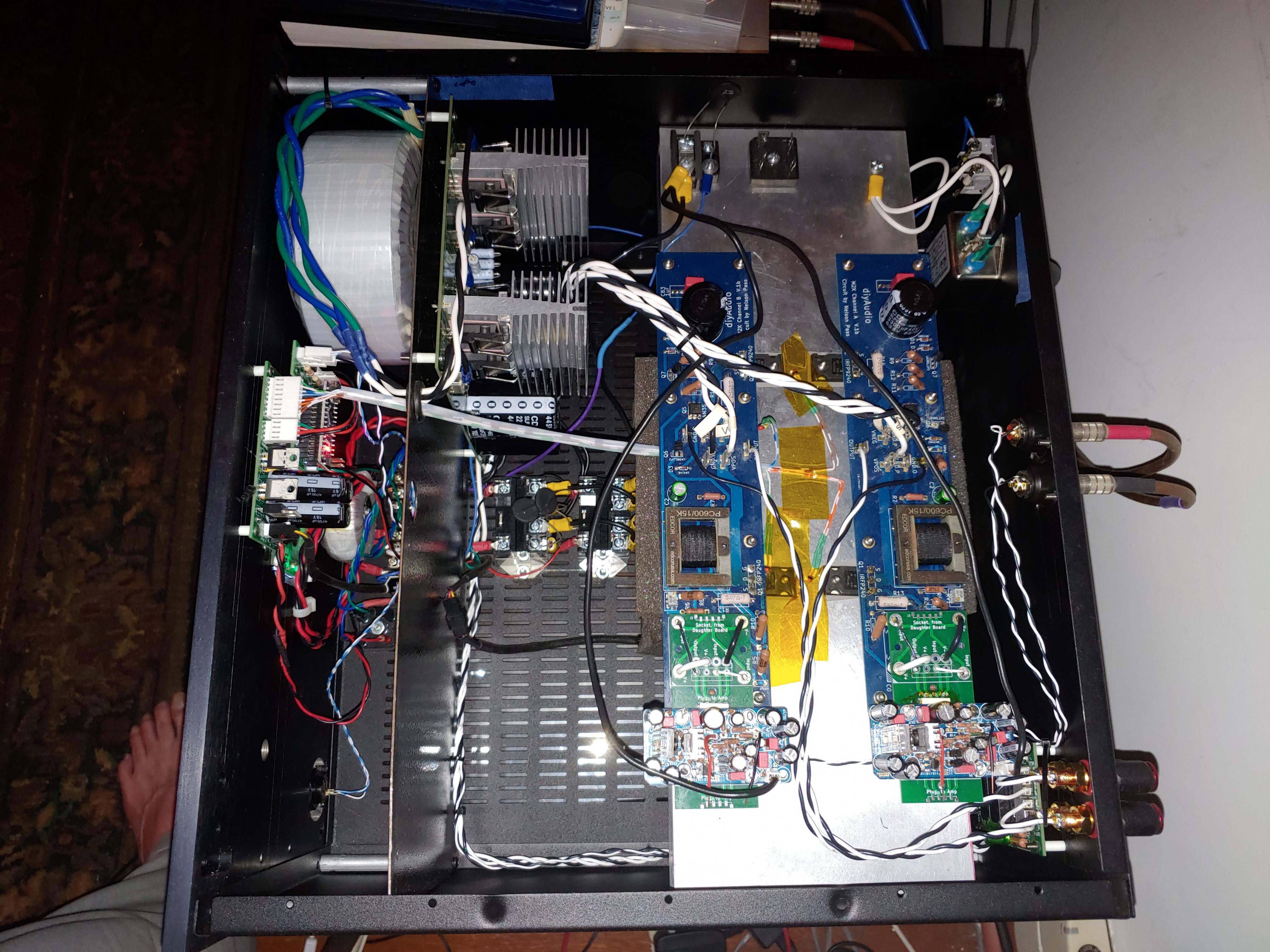

I use an Antek 400VA in mine. I have zero hum on 102dB sensitive speakers.
I have a 5U chassis, the toroid is mounted vertically on the front, and the boards are mounted on an internal fan cooled heatsink near the back. I also placed an iron sheet that spans the chassis side to side just behind the toroid. I designed my own PS board, and it mounts to that sheet.
I regard shielding between the Edcors and the toroid pretty important, but I also believe that over sized transformers are a very good idea.
A second small toroid powers a the circuit board on the inside of the front panel. This circuit board has an Arduino to monitor temps. A single 120mm Noctua fan runs silently at full speed (I do not use PWM) when any of the transistors reach 60C, the heat sink takes about 30 minutes to fully soak and stabilizes at about 58C. The Arduino also runs the display, and controls a pair of relays. The first relay runs through a C-60 thermister and the second relay bypasses that after 1 minute. It also prevents quick cycling the amp (which will blow the fuse), and shuts down the amp in the event of a DC fault.
I made mounting boards for the daughter board to get rid of the awful screw mounts. They now plug into headers, and can be swapped in a moment with no fuss.
All in all a very fun project and an amazing amp.
I still have a few details to tidy up, but it has been pretty much all done for months.
-Josh

Your amp looks great. I would have to hear that 'zero hum' for myself though particularly since you are running a fan. I found that what other people consider as 'zero'-something or in 'as new conditions' is not so for me... LOL
I would venture the iron shield panel goes a long way in your enclosure. However, I don't believe the M2 needs more than a 200VA trafo. I use an antek AS-2220.
The 4u deluxe chassis has enough cooling surface for a M2x, you certainly could entertain ways to shield your power transformer. I am using separate 4u deluxe chassis for my monoblocks.
I wrapped the coils of my signal transformers with a band of copper tape, then mu metal. As my power transformer is in the front of the box, yet centered, it is the same distance to either back corner. No hum.

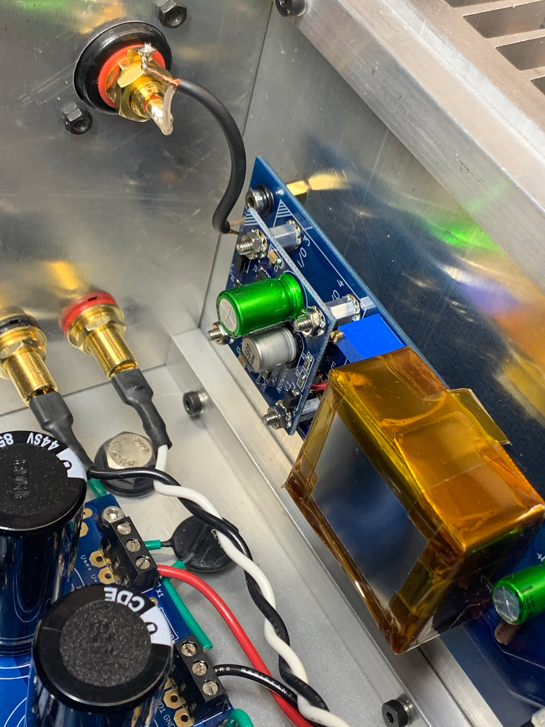

Here's a pattern for an Edcor shield (rev. 5 or something =). I used .01" sheet mumetal—standoff and bolt are nylon where I attached the shield. Annealed or not—I can say beyond doubt that it makes a difference—under diagnosis with a pair of headphones. Details are in my post on this thread. #2938
My monoblocks do not have shielded transfos...but the next set will, why not?
And yes, ItsAllInMyHead's post, linked above, is required reading for anyone who's building these tasty amps. (You can see in the pics I fully support his notion of ceramic isolators on the mosfets.)
Also added MJ's sweet sweet ACPR power management boards since these pics were taken (I sleep better at night now).
