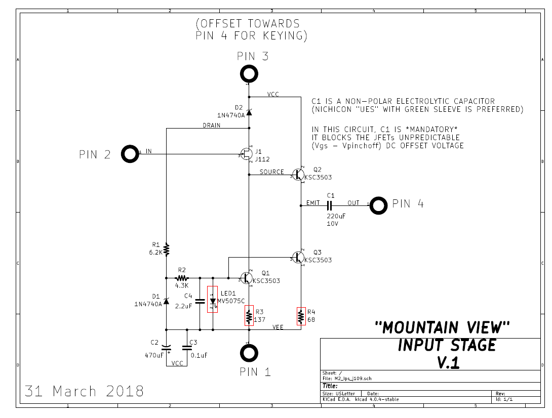

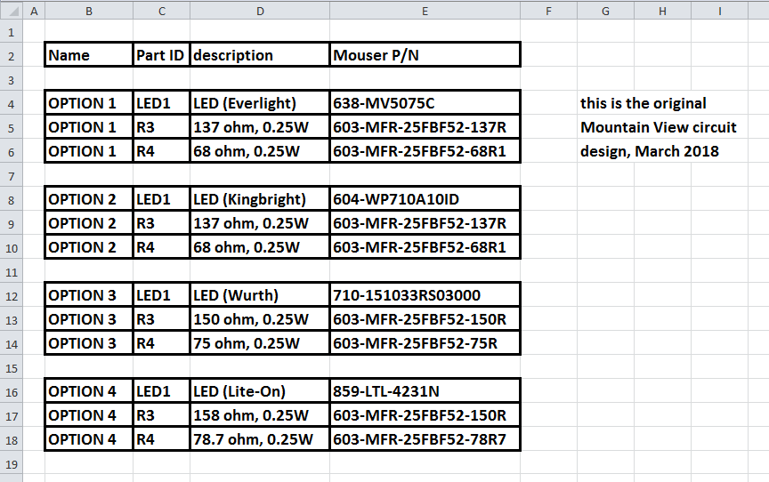

The LED used in the M2x "Mountain View" input stage daughter card, has been annoying M2x builders for quite a while. It just got even worse, after Mouser decided to stop selling individual units of that LED; now their minimum order quantity is 4000 pieces! Digi-Key still sells it in quantity=1, but diyAudio members seem to strongly prefer buying from Mouser.
So I bought a bunch of different LEDs from Mouser, made by several top-tier manufacturers, and tested them in Mountain View. The good news is that three of them are quite acceptable and give excellent performance in Mountain View. The not so good news is, the new LED requires slightly different resistor values. It all works in the existing PCB; you just have to buy a matching trio of parts: (an LED ; an R3 resistor ; an R4 resistor). Same board, same schematic, new component values. Have a look at the schematic attached below.
The trio of coordinated parts is (LED1 + R3 + R4). Consult the table of options, attached below, and choose a trio. Then purchase those parts values and install them in your Mountain View boards. Easy! The table of options is presented twice; first as a screen capture image (for easy viewing on the Forum), and also as an Excel spreadsheet inside a .zip archive (for easy copy and paste of cumbersome part-numbers). The component values shown are the results of my lab measurements on Mountain View cards and the three new LEDs.
With three different LED possibilities, there's a MUCH greater chance that your Mouser in your country, will have at least one of them in stock and on the shelf, ready for dispatch. I just checked each of them at Mouser locations which previously were "difficult" (Mouser Finland, Ecuador, Portugal), and these LEDs are in stock & available in quantity=1, today. Nice!
I should mention that the LED and resistors R3 and R4 are not in the signal path of Mountain View; they are simply bias components whose only job is to set the operating currents of signal-handling devices J1 and Q2. Changing the LED has no effect upon the sonic signature of Mountain View. Which I am sure is an assertion that several people will decide to verify or refute, for themselves 🙂
I will work with Forum Moderators to get this information integrated into the official Bill Of Materials for Mountain View.

Appart from the LED and resistors options above, were there any changes in the BOM of the amp board itself and all the buffer boards? Is the BOM attached to the post #1 of this thread up to date?
Mark,
This is very helpful. Thank you so much!
For some strange reason Mouser would not ship the original part to Canada (and
possibly some other countries as well) but it looks like I can order all the substitutes.
