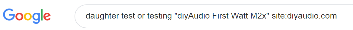

Try the google search shown below. It found lots of "hits" including post #2054 in this thread, a message which appears to fall smack in the middle of a discussion about testing M2x daughter cards. Some of the other google search hits might be even more helpful but I didn't read them carefully; only eyeballed them very quickly just now.

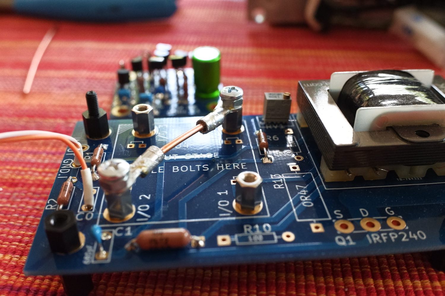

I did something decidedly low-tech today, and replaced the Austin IPS with my "own design", see picture 🙂
I'm basically back where I started, minimizing parts count. This IPS does have a great large signal slew rate though, even for VERY large signals (although I haven't measured it) 😀
But seriously, I did like the Austin IPS a lot, but this sounds great, too!
I think it sounds so good because I'm feeding directly from the output buffer of my Korg B1, so Nelson's Korg tube design effectively makes a wonderful input buffer for the M2X!
BTW, Salas' Mesmerize DCB1 works great in this configuration, too!
Did anybody else try this? Comments?

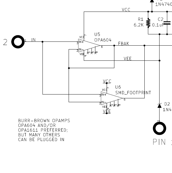

Hello guys, need a little tutoring here. I was looking at the Burson Opamps (V6 Vivid Single Opamp) Burson says that the Single is directly replaceable with the OPA604, like we use in our M2x Tuscon, but when I look at the specs is would seem that we would be a good deal outside the spec on the Burosn +-16.5 vs +- 24V on the OPA604.
Educate please. 🙂
Educate please. 🙂
Do you have Tucson built and installed? Measure the voltage at Vcc and Vee.
Also look up 1N4740.
The official Tucson schematic recommends the OPA1611 and/or the OPA604 for use on the Tucson input stage daughter card. Both part numbers are printed right there on the schematic.

Given that we have made a point of trying different types of unity gain buffers for the M2x input stage, perhaps it is not so surprising that some would want to try different op amps. The Burson units do take a different approach, and I would expect some to be able to tell the difference.
The Tucson board has provision for reducing the power rails to the opamp by 10 Volts on each side. So if one is starting from +/– 23V rails, then the opamp will receive +/– 13V.
