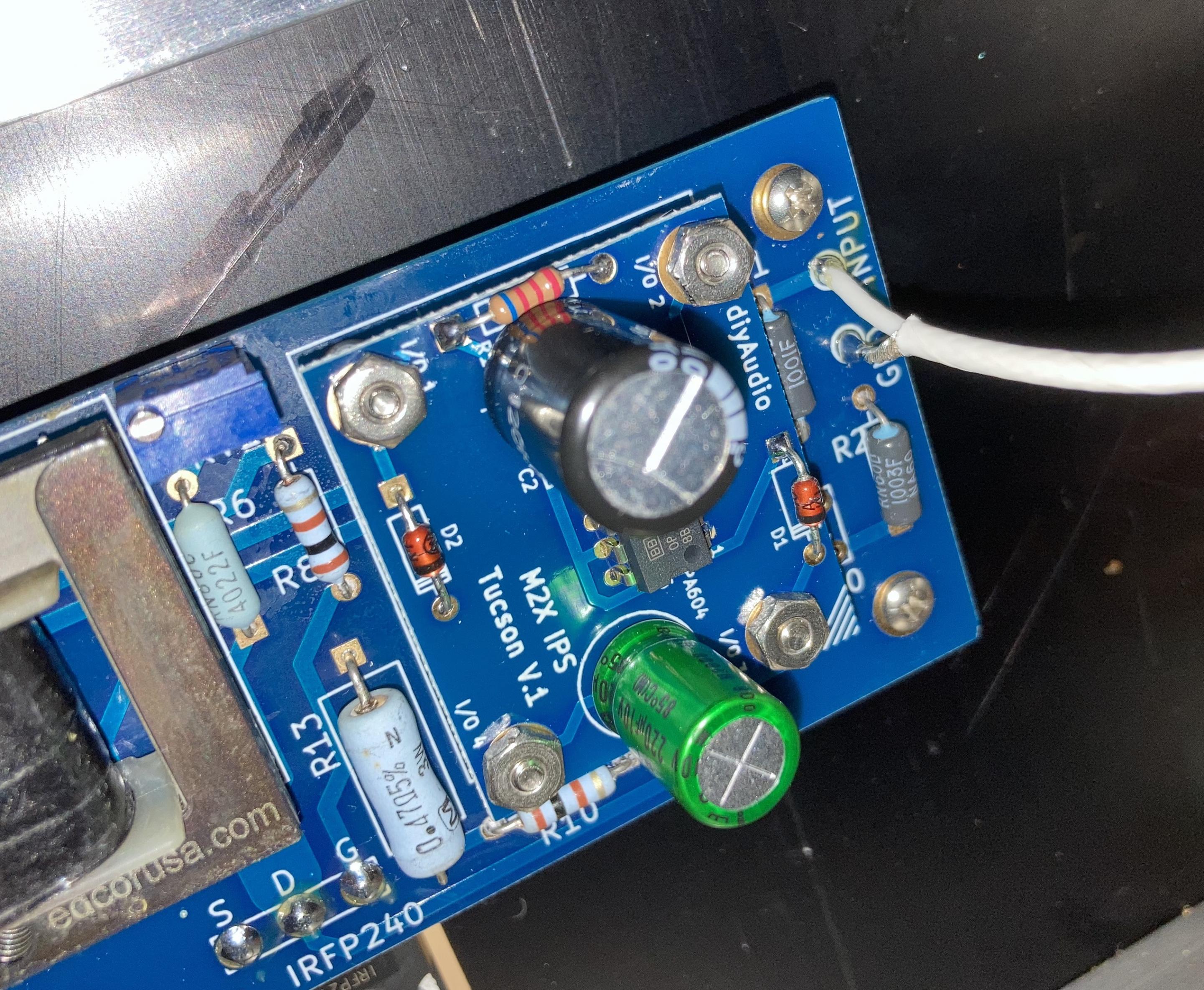

tucson M2x -'unbuttered' is live!
Overall the easiest build ever. Bias is a rock 1.33A per channel. dc offset was already 2mV I adjusted it to 0.000V. If one can believe the 20 dollar voltmeter.
The trafo is 18-0-18 and the rail2rail s 43.5 VDC + to - a bit too low.
The sound is already great! I do need to finish the ac line power cable etc.. Now is going off a variac and its fuse...

Thanks! I switched the variac to the 140V side and fed the trafo a little more Vs to bring up the rail to 24-0-24V after CRC and the sound gets alot cleaner & more detailed. Still, case temp is well under control. Heatsinks at 45C after hours. The hottest part are the Rs in the CRC at 50C and the transformer mounting plate. I guess it's ferromagnetic and it's affected by the flux but that's a heatsource I want to try to eliminate. The mosfets in the active rectifier stay cool.

I am liking the Tucson the best because that's what took me 1 hr to bolt in and I am enjoying the sound too much to change it. 😀
Someone was too busy with limericks and forgot to add M3 screws in the BOM so I had to improvise. 😉

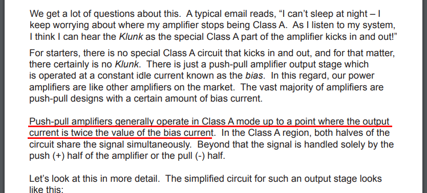

Ok folks quick question (and I googled for this left and right all afternoon):
what should the m2x board current draw? I have seen values such as 1.5-2A from Zen Mod, the power consumption of 160W from First Watt but what should this value be with the M2x board with std components and the prescribed optocoupler?
My amp draws 1.33A at -/+ 24VDC which is 64-something W/channel, which is low: whats' the deal?

The optocoupler circuit will bias the amp right around 1.3 Amps regardless of the rail voltage. Mine runs at 1.31A.
Higher bias may happen with a different optocoupler, or changes to the values of the source resistors.

That's what I thought but isn't 1.3A is only good for 14W in classA? Far cry from 25W! What am I missing?

I think you will enjoy reading Nelson Pass's article called Leaving Class A. It's on the First Watt website under the tab "Articles". Scroll down to 2008 and there it is.
A quick review of the M2 / M2x schematic shows that it is a Class A amplifier with a Push Pull output stage: a Pchannel MOSFET source follower actively pulls up the output, and an Nchannel MOSFET source follower actively pulls down the output. Thus Mr. Pass's statements underlined in red are applicable to M2 / M2x.
