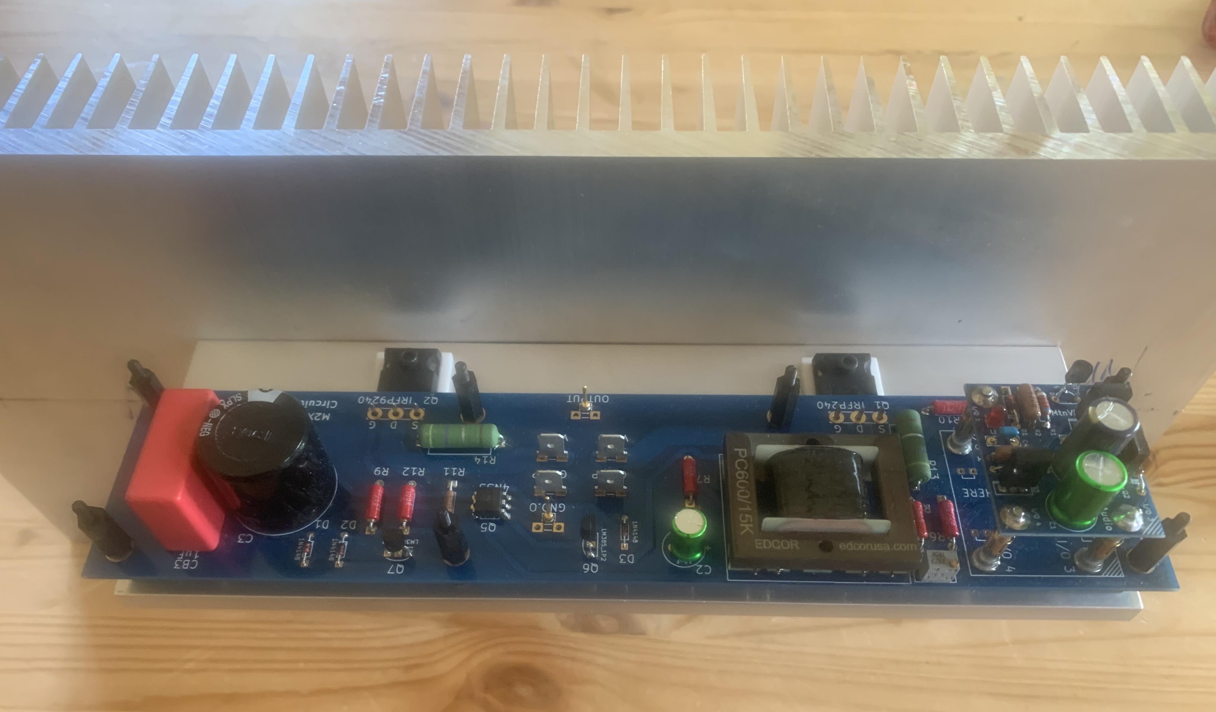

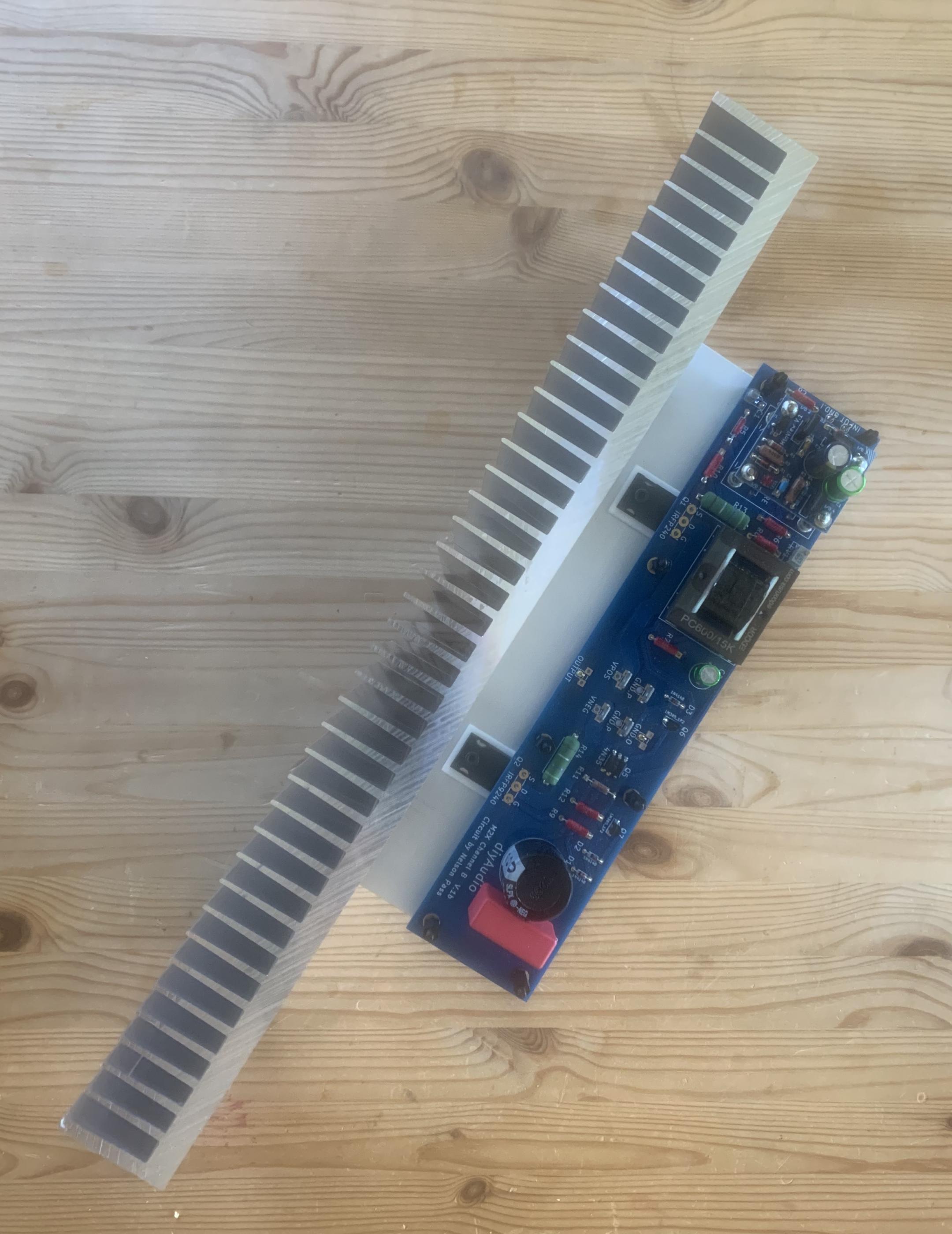

We will see how it works- while there are no published thermal resistance figures for these, the LATB experiments strongly suggest that they are more than adequate, sink per MOSFET, and actively cooled, it is clearly sufficient to use one per pair of MOSFETs.
You should be fine passive as with one per, providing you orient them for convection. In fact, with one per you might get away without that as well. I have the fans on the lowest speed and Max is 32C.
My M2x used somewhat smaller heatsinks than the typical build around here. The chassis was basically 2.5U x 400mm deep. With the recommended 18V secondaries on the power transformer, rail voltage was initially 22.4V, given the FEP30 diodes used for rectification. When I switched to LT4320 based rectification, the rail voltage increased a little to 23.2V. Either way, bias current was a steady 1.31 Amps and the heatsinks were just warm.

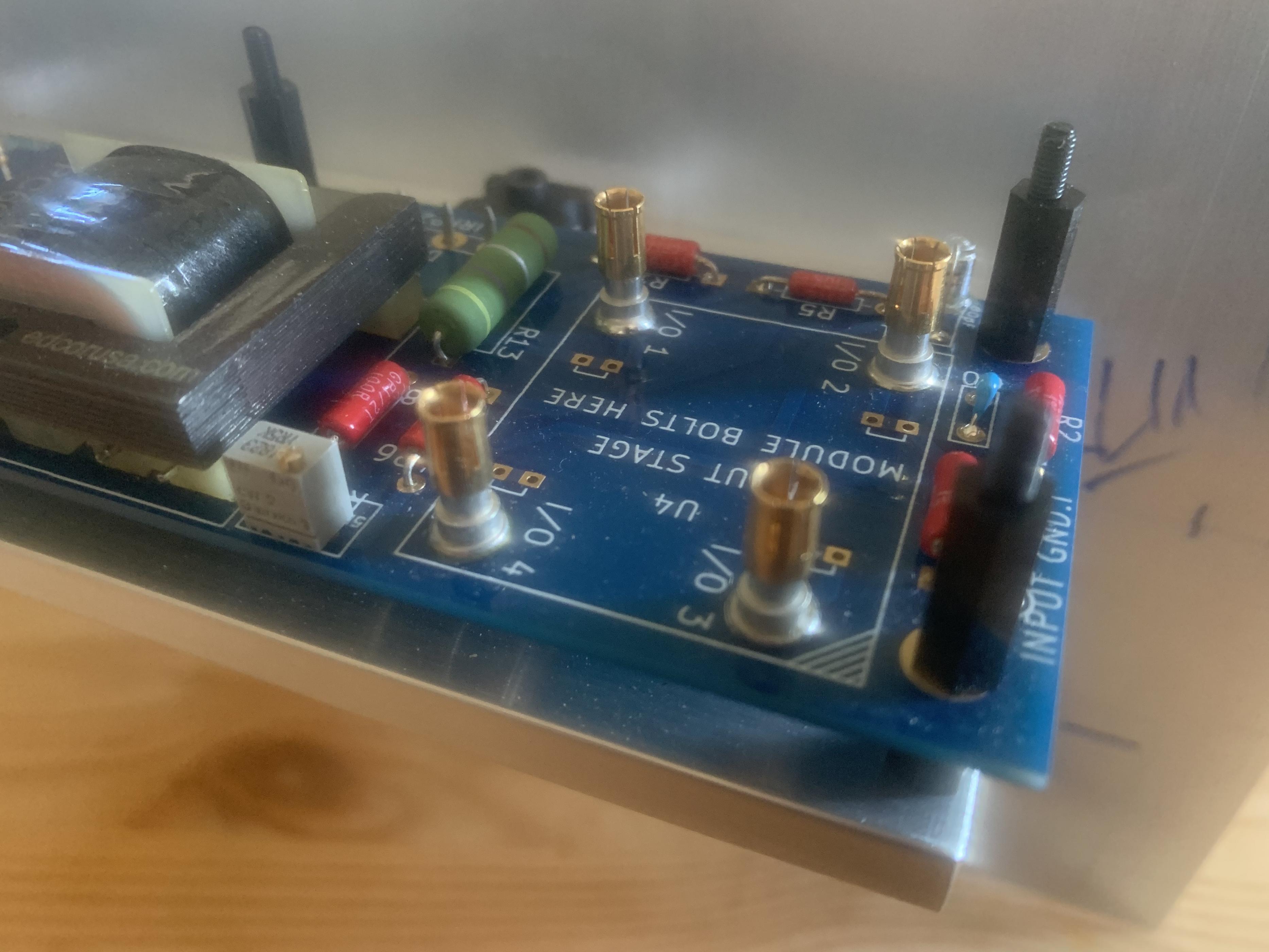

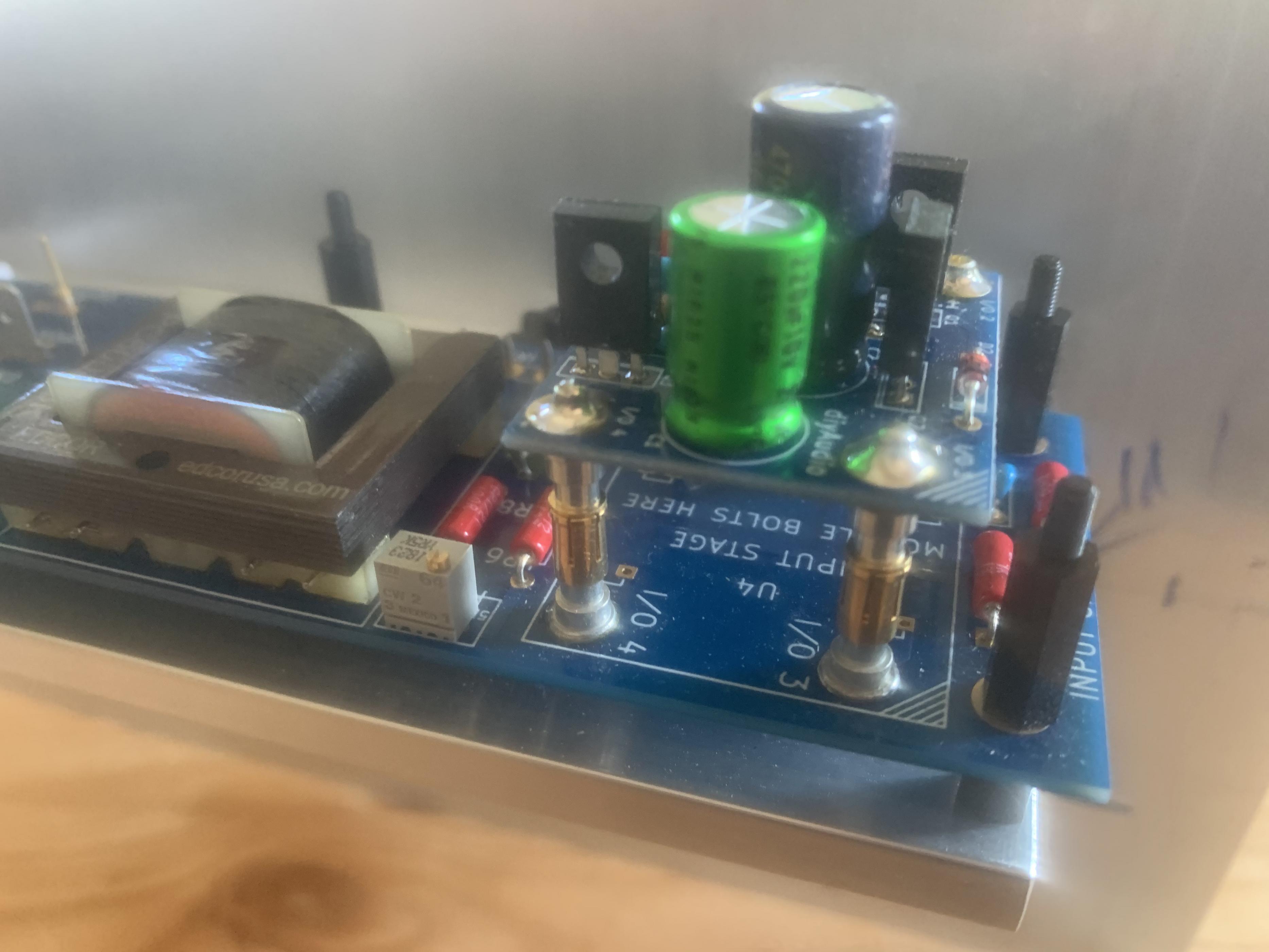

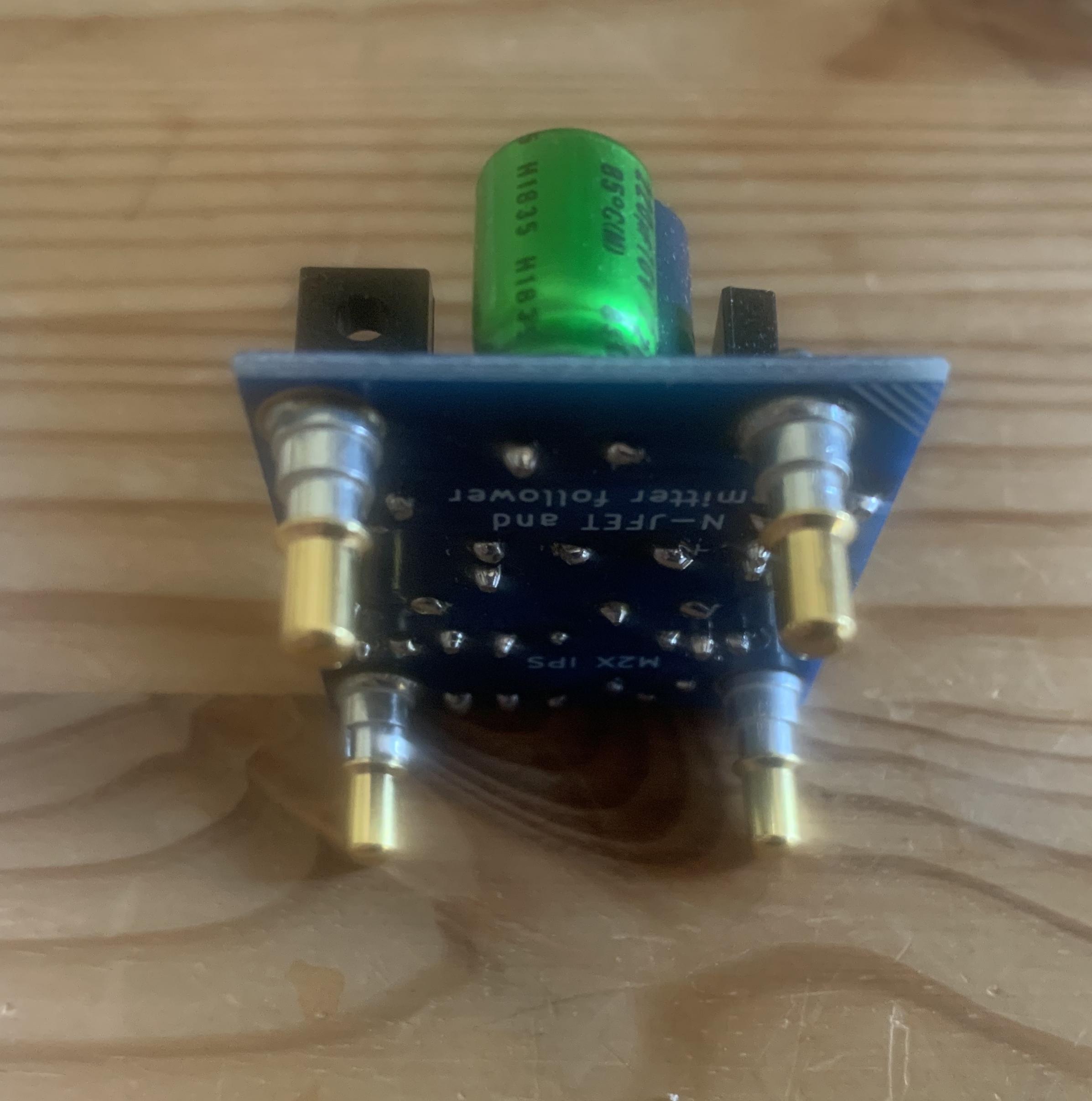

plugs
Thank you
the plug connections are high-voltage contacts from Connect.
I have here the link to the German electronic distributor Reichelt. .
The contacts are used in D-Sub connectors
the soldering points fit exactly and the plugs can be soldered well.

Thank you

Very nice build!
Those plug and socket bits are fabulous!
I would imagine you may be fitting them together first, and then setting them in place on the main board, followed by the input board, and THEN soldering them in place?
Subsequent input boards can then be done similarly by placing the posts into the sockets, and putting the input board in place on them, and THEN soldering?
I would imagine a procedure such as this would ensure reliable fitment of all input boards to a given amp board.
Perhaps the clearances are good enough that such a procedure is not required...
Nice! I will find those somewhere on this side of the pond...
Be careful to devise a procedure which allows either of your two Ishikawa daughter cards to fit and correctly operate in the Right amplifier channel board; AND allows either of your two Ishikawa daughter cards to fit and correctly operate in the Left amplifier channel board.
I think you probably want to avoid the situation where one of your Ishikawas is marked "LEFT CHANNEL ONLY" and the other is marked "RIGHT CHANNEL ONLY" .
I also think you probably want to avoid the situation where it's cumbersome to assemble a new pair of daughter cards nine months from now, and add them to your M2x. Hypothetically suppose that in Feb 2021, you learn that your daughter's boyfriend is an absolute Wizard at SMD soldering. So you offer to buy him 3 liters of soda and 3 large pizzas if he will please solder some (SMD!) Norwood input stage cards for you. Now must you disconnect your M2x from the audio system, haul it over to the soldering bench, and use its pegs as alignment tools to solder the mating sockets on the new Norwood boards? Ugh!
I have soldered all daughterboards with the plugs first,
and in such a way that all are the same!
there are no right or left boards, they fit everywhere!
we make an effort in the selection of the components, these resistors, this capacitor,
and do we pass our signal via a standard screw made of steel? not my thing!
