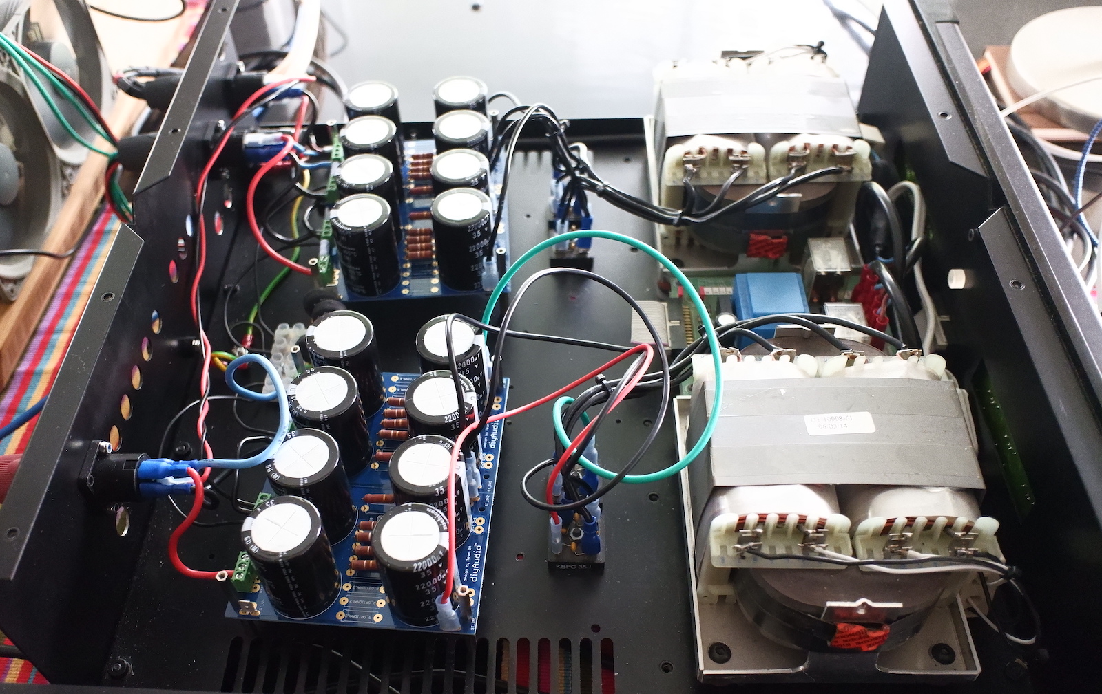

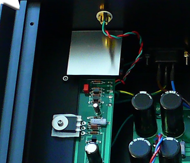

I wrapped Edcor with tinned cupper tape and on top of that I wrapped with mu-metal. Doing this Edcor is shielded 360 degree (RF and magnetic shielded). I have very low noise which can be seen from the measurement. 50 Hz is more than 100 dB down. I have seen much worse from "normal" amps. With 94-95 dB speakers I can't hear any hum with ears as close as possible to the speaker units when amp just idles. M2X can be made very quiet.

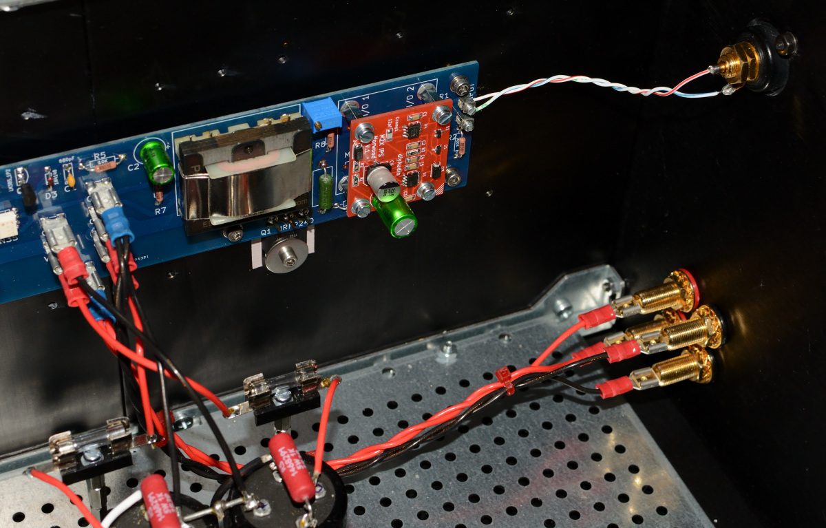

Quick question regarding Ishikawa JFETs...
From building the F5 previously, I suspect the JFETs are supposed to be thermally coupled to each other (e.g. zip tied). But searching a quarter of the way through the thread for photos and doing some text searching I haven't come up with any actual evidence.
Assuming they are supposed to be touching, I wonder how many have been built without the JFETs in contact?

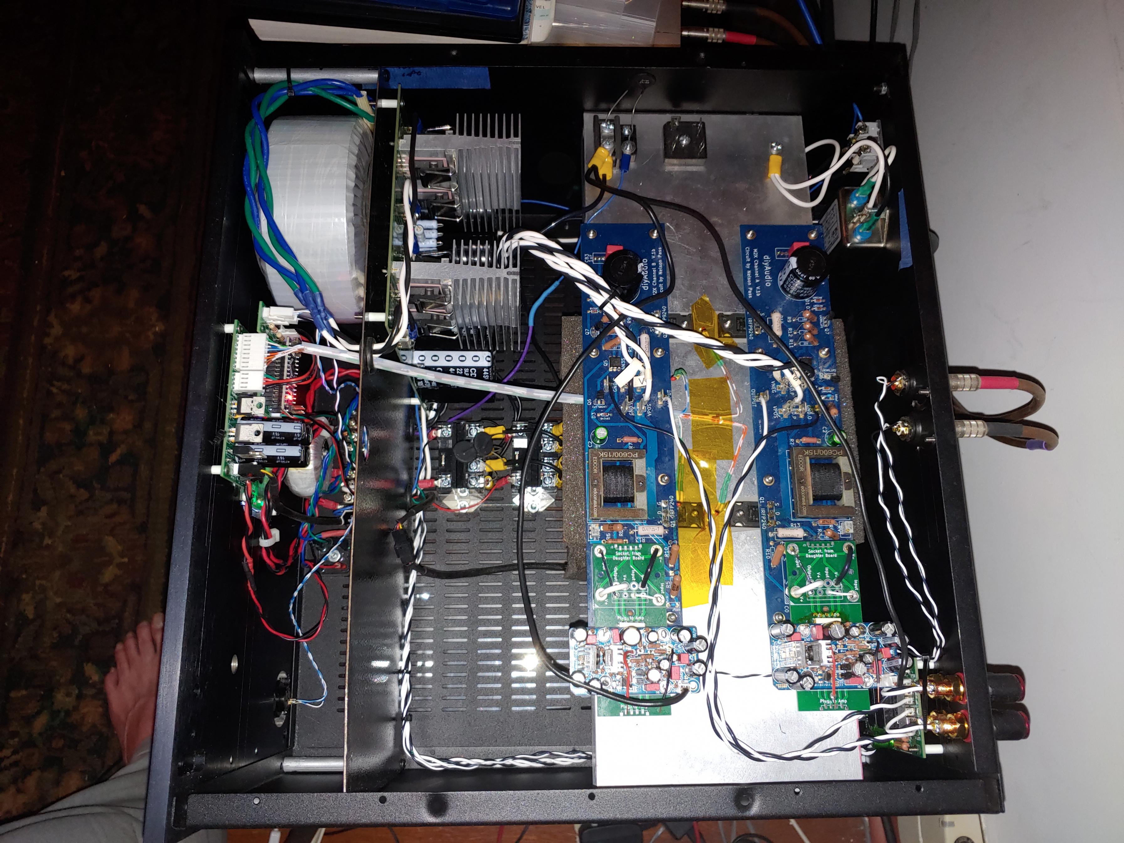

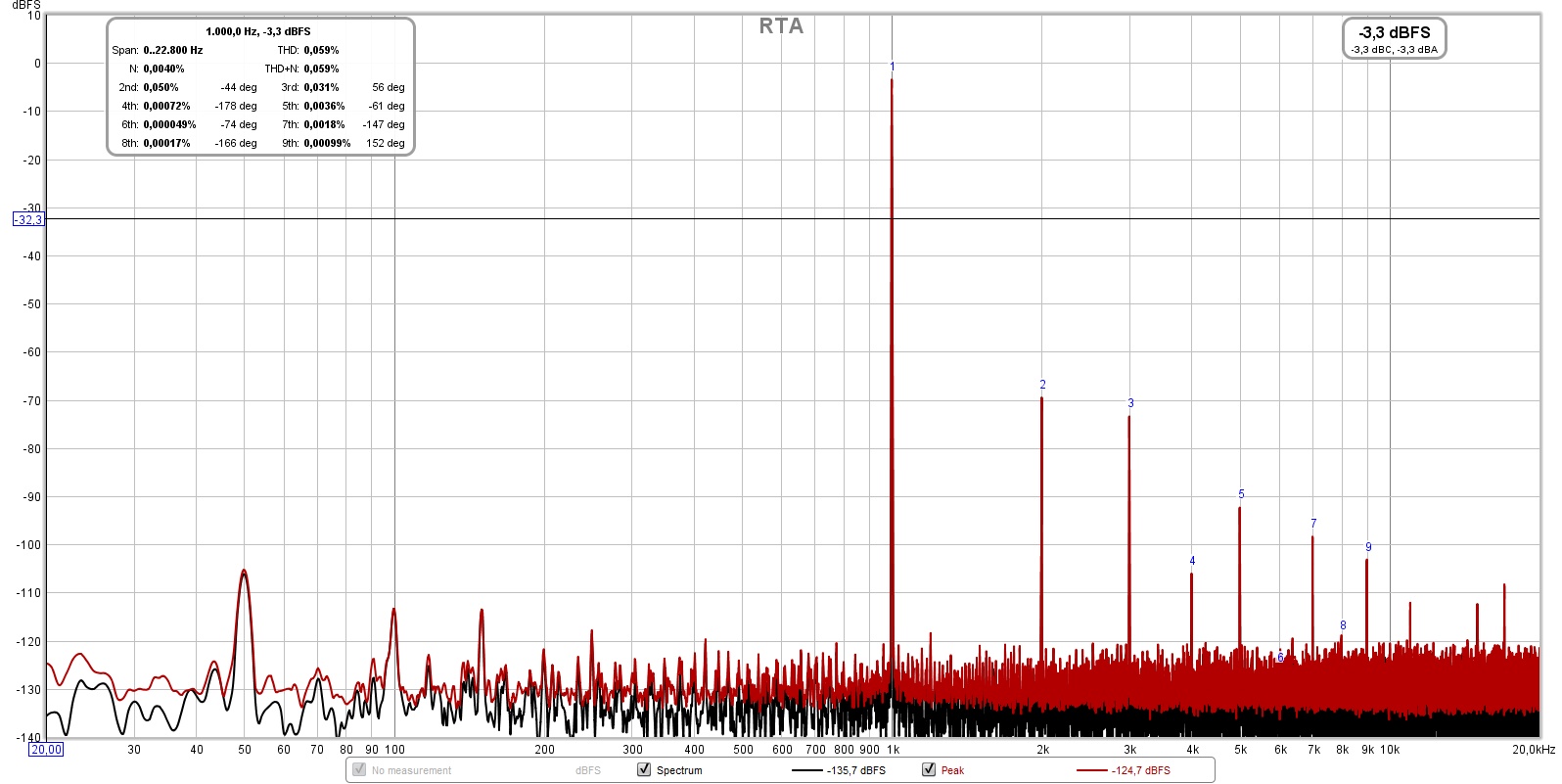

@Joshua
Your amp looks great. I would have to hear that 'zero hum' for myself though particularly since you are running a fan. I found that what other people consider as 'zero'-something or in 'as new conditions' is not so for me... LOL
I would venture the iron shield panel goes a long way in your enclosure. However, I don't believe the M2 needs more than a 200VA trafo. I use an antek AS-2220.
I understand what you mean.
When I say zero hum, I mean full volume and my head stuck inside the horn.
Distance is the biggest effect since the fields drop at the square of the distance. Orientation of the transformers with respect to each other and the iron sheet minimize the rest.
Nelson's original layout puts the Edcors at the edge of the magnetic fields. He used mumetal, which I think is a very good idea for that.

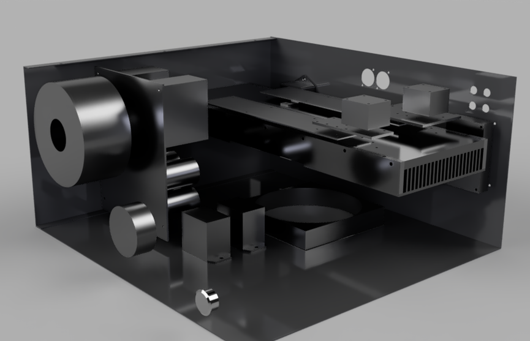

Hi Josh, your build looks awesome! Would you mind sharing a couple more pics showing your cooling arrangements, it sounds very interesting!
I thought I had taken pics during assembly, but I cleaned out my phone a while back and can't find them.

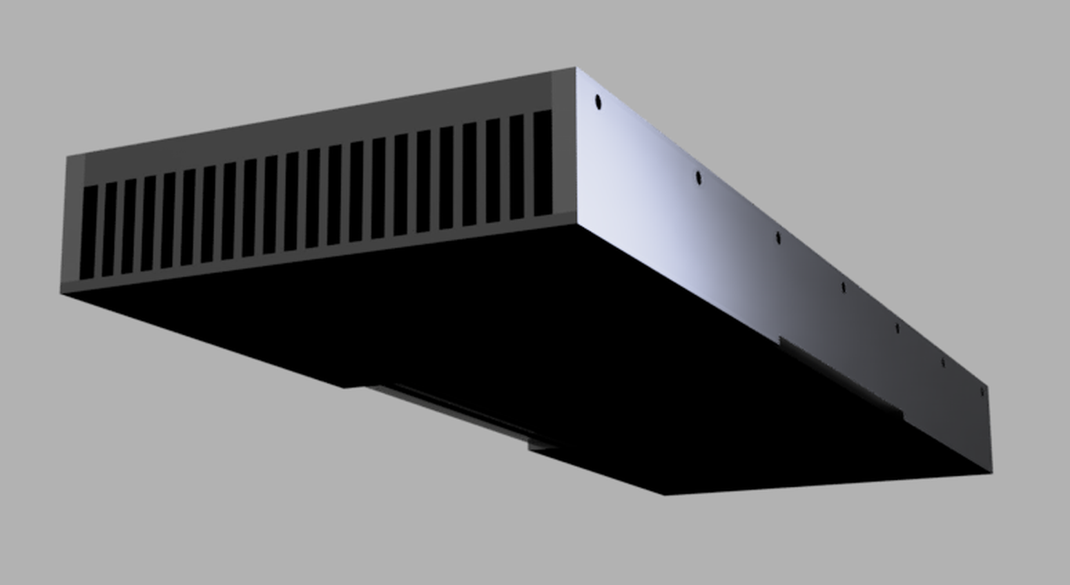

So I made a render of the CAD model, which actually shows everything more clearly, and took a pic looking into the amp obliquely.
The render shows all the major parts except the controller, the display, and the iron divider.
Some details:

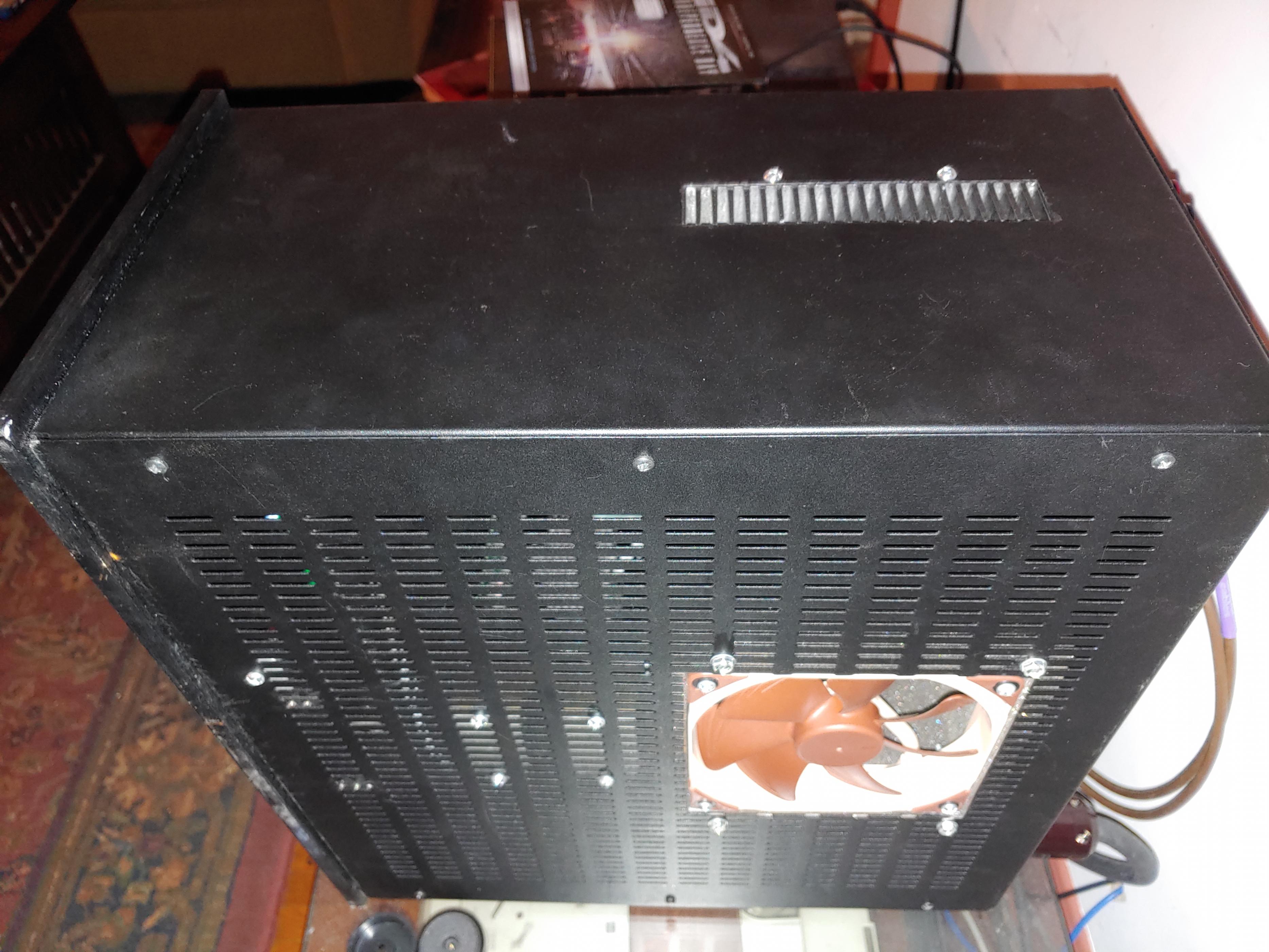

When I started the design, I was trying to avoid the high cost of a heatsinked chassis. My original intention was to make the chassis from wood, but I just could not convince myself the fire hazard was worth it. There is also the issue of making a large wooden box remain stable when it has a big heater inside of it. In the end, I used a Pessante 5U 400mm chassis from the store, I saved some money over the cost of a Deluxe, but not a ton.
The heat sink was about $20.00 on Ebay, the aluminum to make the sides and bottom for the heatsink are another $20.00ish, and the fan was something like $25.00. Which is about half the cost difference between the Pessante and Deluxe. I got the material for the divider from an Eppendorf fluid handling robot that got upgraded in the lab next to me. The material is meant for electromagnetic isolation. It is magnetic, but looks like cast aluminum when you cut it with shears.
Designing the heat sink was not hard, I did some math and verified my results with online calculators. I came out about 5% off expected temperature difference.
Still I was not convinced it would work as expected, so I breadboarded up an Arduino with thermocouples to monitor temps while the whole mess was screwed to some MDF scrap.
Putting as much distance between the Edcors and the toroid were at the top my design considerations. After that, I was most concerned with a DC fault circuit and being able to bypass entirely the C-60 thermister used for soft start. At that point, it made sense to stick with Arduino control and engage in some feature creep. I also wanted (if possible) to mount the boards horizontally to make daughter board swaps easier.
The power supply for the amp is essentially the DIYAudio store board, but space is used more effectively since it is designed to only used discrete rectifiers. I copied and slightly modified the circuit the published by Elliot Sound for the DC protection circuit. By default, the relays in the DC protection circuit are closed so the coils are not energized during use. In the event of a fault, the relays open the amp, and take the speakers to ground. It also sends a signal to the Arduino which will then open the relays that power the amp shutting it down. This essentially means the amp is left to it's own devices in a fault. I have single drivers in my speakers that cost more than this entire project, the amp can catch on fire at this point as far as I am concerned 🙂
When the rear switch is closed, the small toroid gets power and it powers a controller board. The controller board has a 5V regulated supply for the thermistors and display, and a 12V supply for the fan and Arduino. When the front switch is closed, the Arduino ensure the amp is not in cool down (turning the amp off then on again too soon will blow the fuse), too hot, or not in DC fault, then closes the relay with the soft start. After 60 sec, it closes a second relay that bypasses the soft start entirely.
When the amp reaches 60C, the fan is turned on and runs at full speed until the amp cools to 40C. It stabilizes at about 58C. I do not, and see no reason to use PWM. I do not really care what temp it runs at, only that it runs with in an acceptable temp range. I can use a resistor to slow the fan if I want it to run hotter.

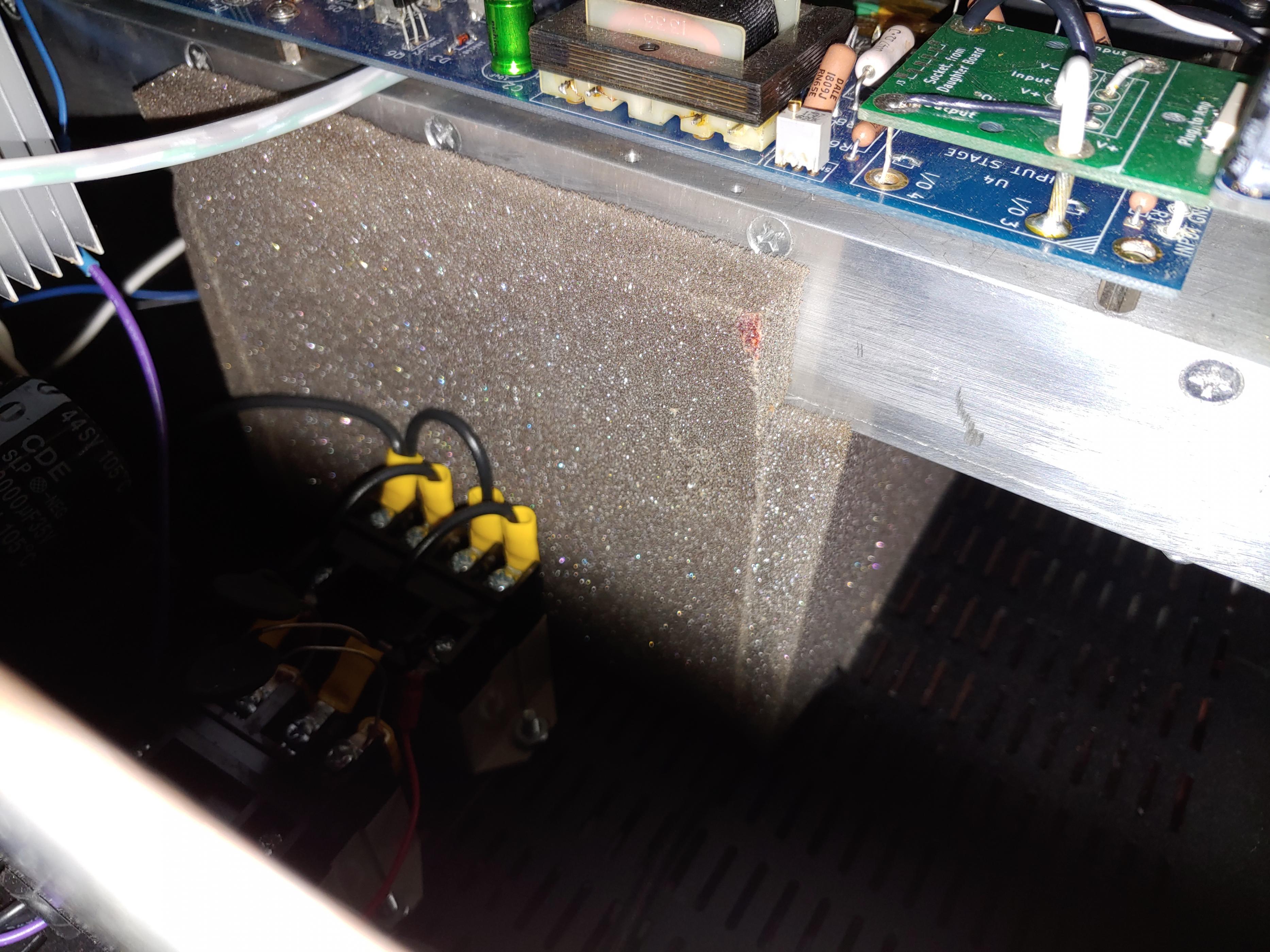

The fan itself is mounted to a bracket I made from bent sheet steel on the floor of the chassis.
There are several reasons for adding this complication:
The fan can be removed for service or replacement with out taking anything apart - it is inevitable the blades will get dusty and run out of balance.
Putting distance between the fan and the heatsink substantially reduces flow noise at the fins.
A fan make a round column of air with a hole in the middle where the motor is. Putting distance between the fan and sink allows the air to fill the space better, reduce some of the swirl, and allow the air to enter the sink more evenly.
Not affixing the fan to the heatsink means no vibration is transmitted into the amp board itself.
I made a square tube from closed pore foam to bridge the distance between the fan and sink.
Even at 1:00am when the world is silent, I can't convince myself I can hear the fan run. You can barely hear these big slow Noctua fans running on the desk.
The added time spent putting it all together is offset by 10 second daughter board swaps with out having to fumble with little fasteners in the dark.
I expect this was more than you asked for 🙂
-Josh

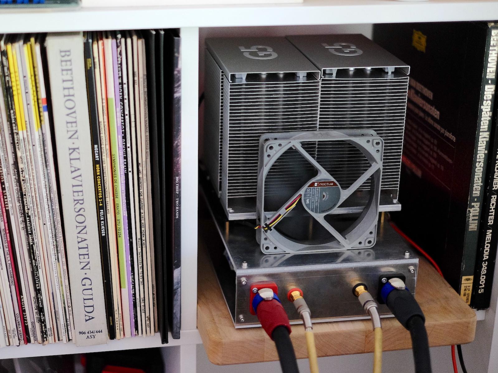

Thank you Josh, this is great! BTW, love that you did a 3D model!
My experience with the Noctua fans is the same, from my listening position I can not really convince myself I can hear it, even if nothing is playing and the house is completely quiet. Not having to rely on passive cooling and huge heat sinks allows a lot more creativity with the setup. To wit, here's my M2X. It even fits into a small shelf space...
I'm using the Noctua NF-S12B redux-700 (no PWM) and also the redux-1200 PWM. The 700 just needs 12V, and its only noise is a faint shush from the slight breeze it creates -- but you gotta put your ear next to the fan to hear it, so don't do that and you'll be fine...
The Noctua NF-S12B 1200 PWM is equally quiet once regulated down, but can produce a lot of airflow when called upon. I agree that PWM is really not needed, except that you can run it at low RPM normally, then turn it up when it's getting hot for some reason, for safety. A little Arduino is taking care of that for me.

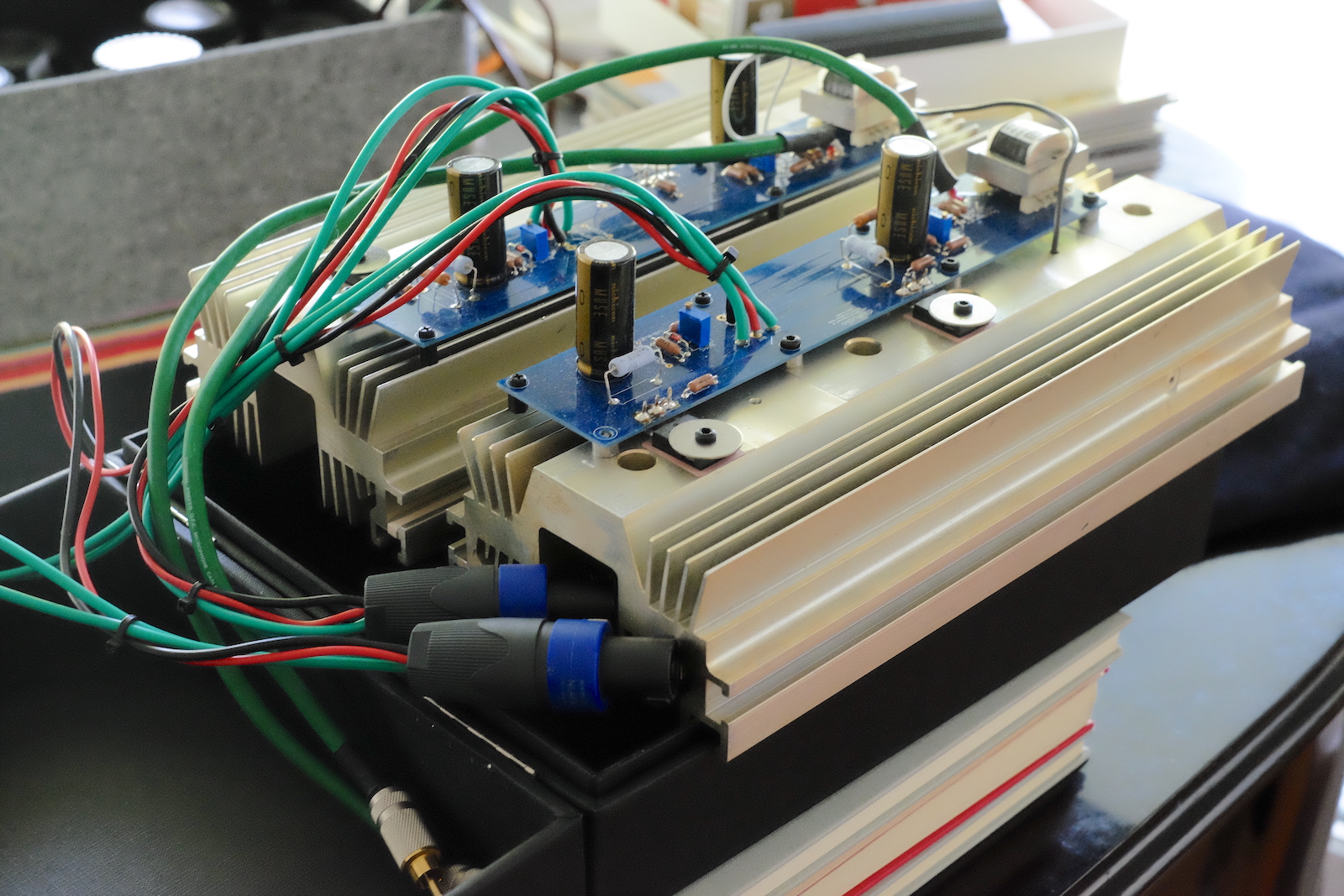

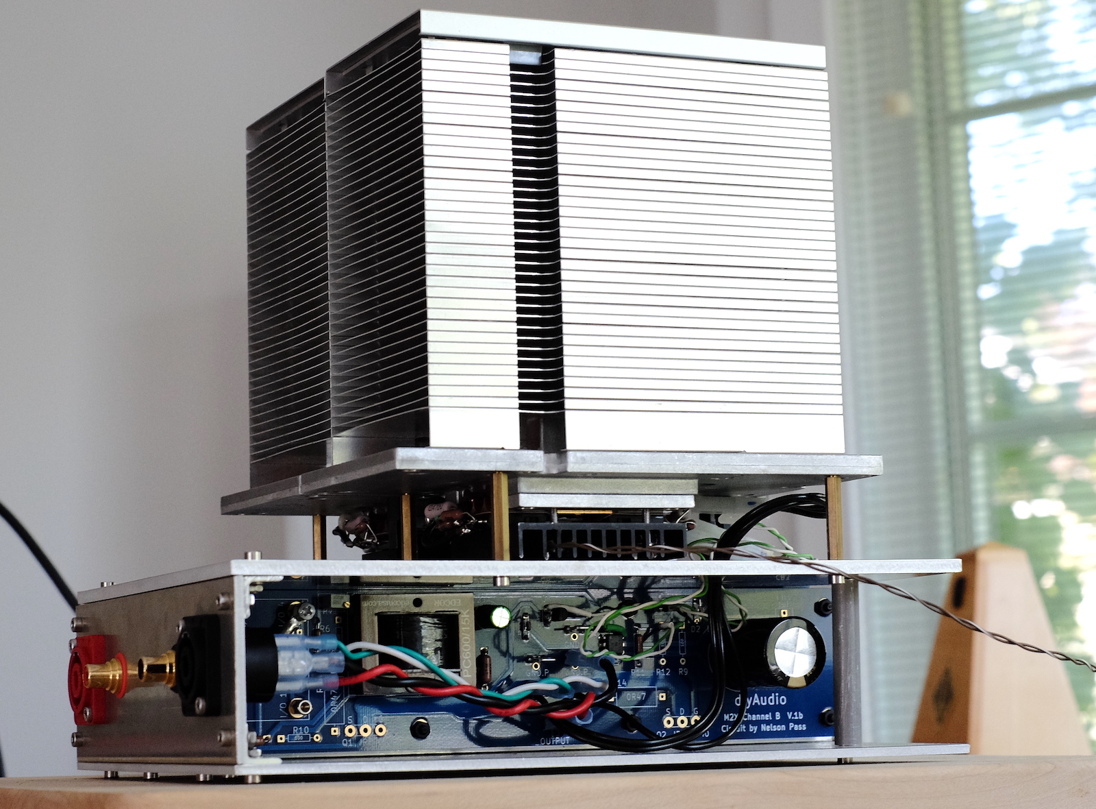

In case you were wondering, the power supply is in a separate box out of the way, each channel connected with a 14/4 cable (V+, V-, OUT, GND), and the speakers plug into the PSU box. There's also a F6, ready to be plugged into the same PSU when the mood calls for it (which it does quite often, this is a lovely amp, too!), and soon there'll also be an Aleph J.

That is a great set up yo have there. I love that huge heatsink. Looks like it came off an old school server.
Have to agree with all you say as well.
I like the idea of external power supplies, they are often the most expensive part of the amp. I decided I would confuse myself after a couple of years and blow something up 🙂
