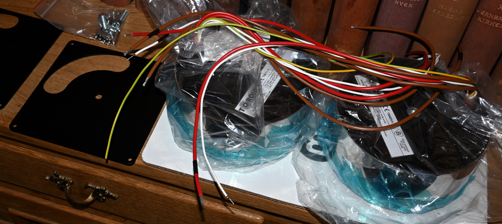

I have two 400VA Toroidy's waiting to be installed in my M2X mono blocks. The standard toriods was starting to make some slight mechanical hum from time to time which was very annoying. So I took the decision to use the "big hammer" and get two of "these". I was promised that they are "dead silent".
I noticed that they have the yellow/green PG wire. Probably connected to the steel cap.....but I don't know yet.

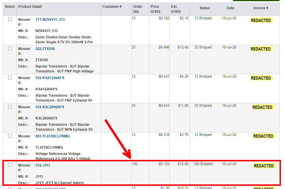

Anyway, I decided to spend a modest amount of money, attempting to get several pairs of decently matched JFETs for my differential amps. And by "decently matched" I mean, "much better than picking two JFETs at random out of a bag".
So I placed a Mouser order, see Figure 1 below. I bought qty=100 pieces of the J113 and spent thirteen USD.

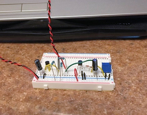

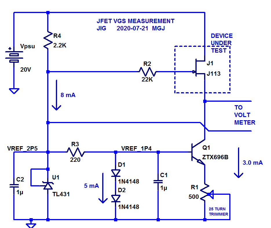

I slapped together a little test jig on my solderless breadboard (which I got very cheaply at Amazon (link)), see Figure 2 below. The circuit schematic is shown in Figure 3 below.
Each of the two J113s in the differential pair operates with 3.0 milliamps of DC bias current, so the test jig sets the JFET current to 3 mA. {how? By dialling the 25 turn trimmer until an ammeter says 3.000mA}. I set my adjustable DC power supply to 20 volts for these tests, which gives the JFET about the same VDS in testing, that it will see in actual operation. Then VGS is measured with a 4.5 digit voltmeter.
VGS sloooowly converges and I didn't feel like waiting forever, so I decided to record the measured value exactly 15 seconds after powering up the D.U.T. This may or may not be unwise, but it felt good at the time and I'm still glad I did it this way. My results are shown in Figure 4 below. It's a fairly high-res image and if you zoom in you can read my handwriting.

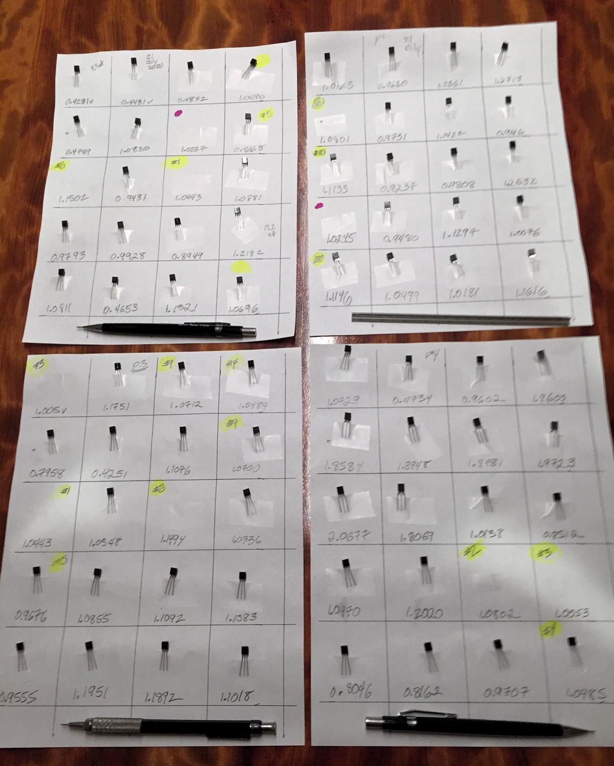

There are four "pages" of devices, 20 devices per page. So I "only" measured 80 parts, of the 100 I bought. $2.50 wasted, I suppose.
I knew I wanted to get a sorted list of measured VGS, and then look for adjacent measurements that were very very similar (or identical!). No doubt there are dozens of ways that can achieve this, some of them easier than others. I decided to use a spreadsheet, Microsoft Excel, because sorting numerical values is especially easy in a spreadsheet. Then I told Excel to subtract adjacent values, giving the delta-VGS for each pair of JFETs.
I'm very pleased to report that: For the 100 JFETs that I happened to buy, and the subset of 80 that I happened to test, and the test jig and test protocol I used,
  • I was able to find ten pairs of devices whose VGS @ 3.0mA were within 5 millivolts. The absolute value of (VGS_A - VGS_B) was below 0.005 volts, for ten different (A,B) pairs.
