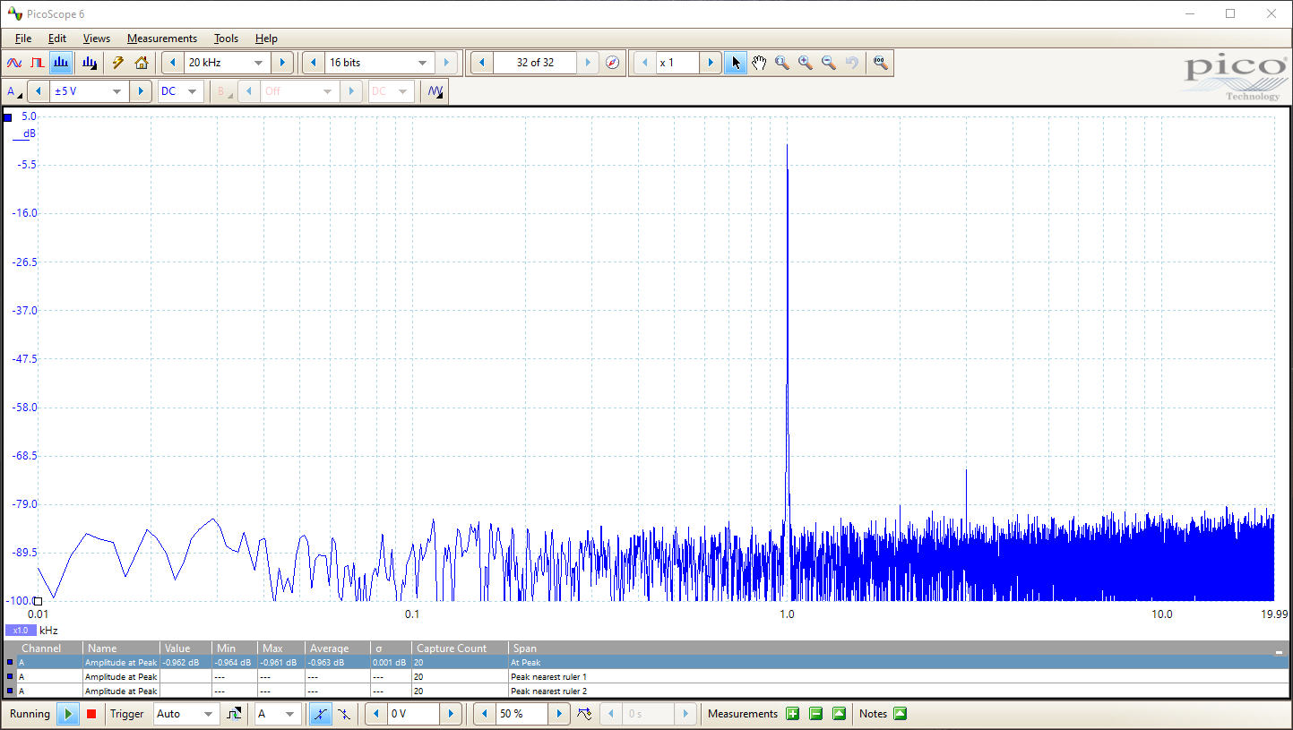

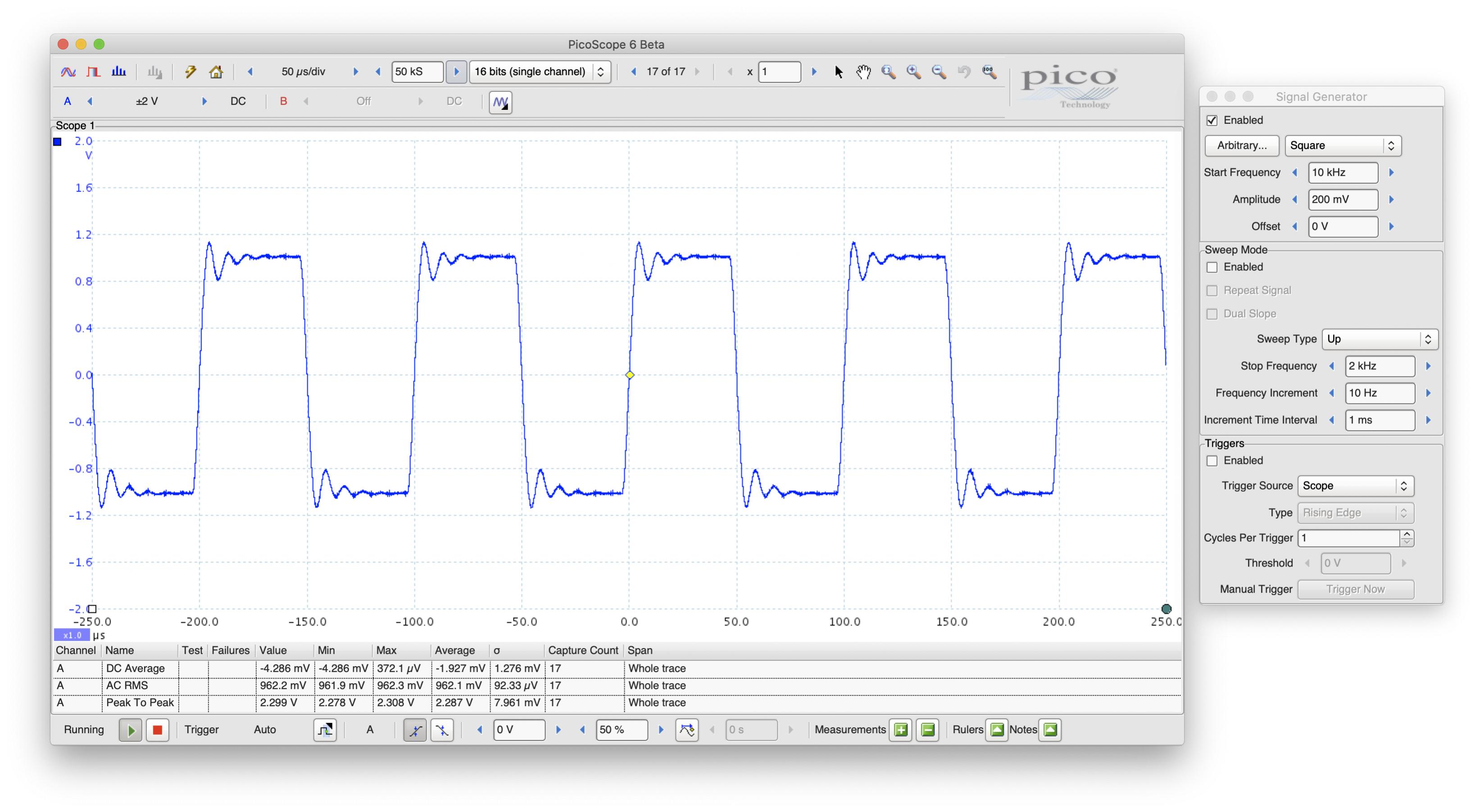

10kHz square wave: ringing at transitions. Normal?

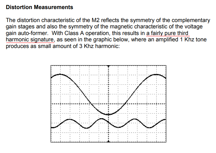

1kHz 1W 8ohm spectrum: seems 3rd harmonic @ -73dB is higher than 2nd harmonic. How can I get the "nicer" 2nd harmonic?
Have a chat with member xrk971, who measures lots and lots of 2nd harmonic on his M2x. Nelson Pass, on the other hand, saw "a fairly pure third harmonic signature", as he stated in the M2 owner's manual (figure copied below)
_
Regarding M2 distortion: the actual measurements that I have made plus several others that I have seen now show a significant amount of 2nd order and 3rd order. Not purely 3rd order - despite the the differential O-scope image from the manual.
Have you tried Quasimodo? Snubbers might reduce ringing.
Quasimodo
Quasimodo results

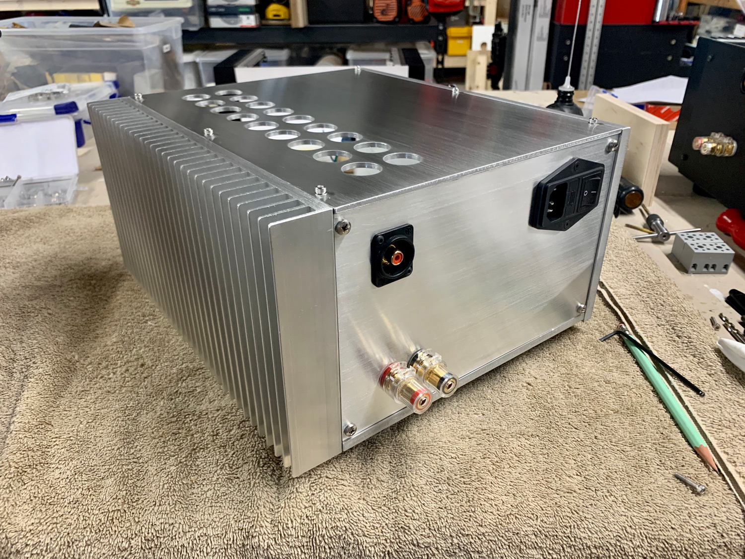

😀 Birthing of another M2X—So far—wow what an amp! LOVE.
I haven't put it into the main system—but I did grab a pair of cheap test speaks to use on the bench—and it sounds awesome (thanks 6L6! ...again...). I was most excited to try some particular boards—and am VERY reluctant at the moment to remove them to at least make sure the others work.—Well Mountain Views light up—they were my bulb test subjects with the LEDs. Also, haven't built Austin yet—have all the parts though.
AMP sounds freaking fantastic. BIGTIME.

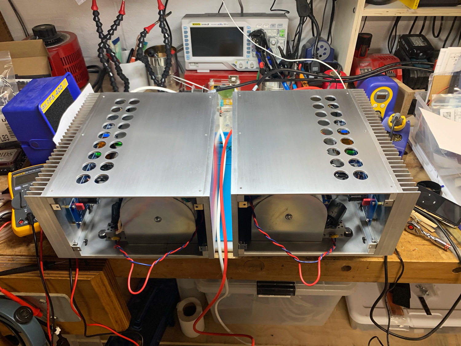

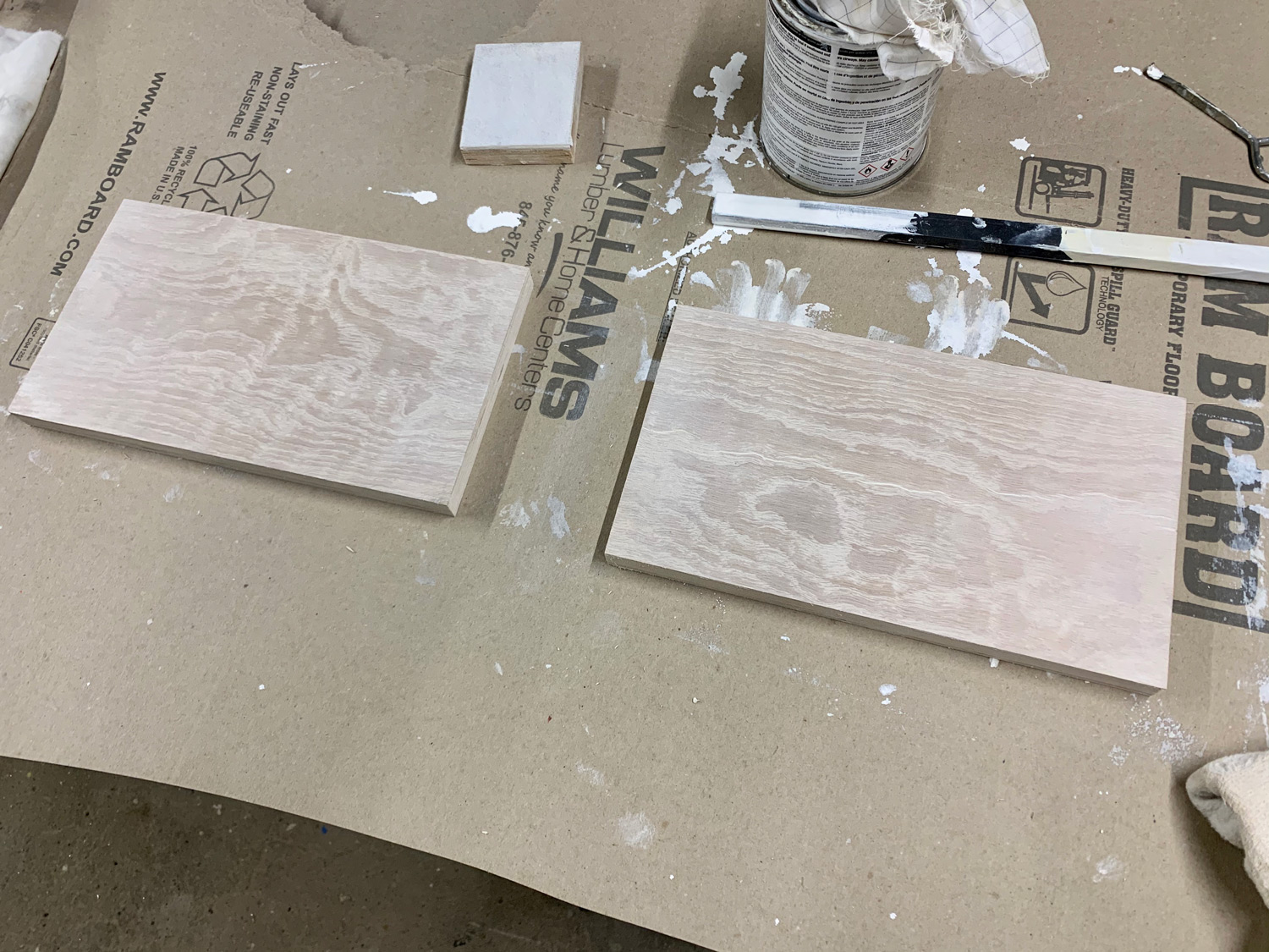

Still have to finish the fronts. Making these cases was pretty time consuming. I'm definitely approaching tap-master status though. And making them from absolute nothingness was pretty rewarding.

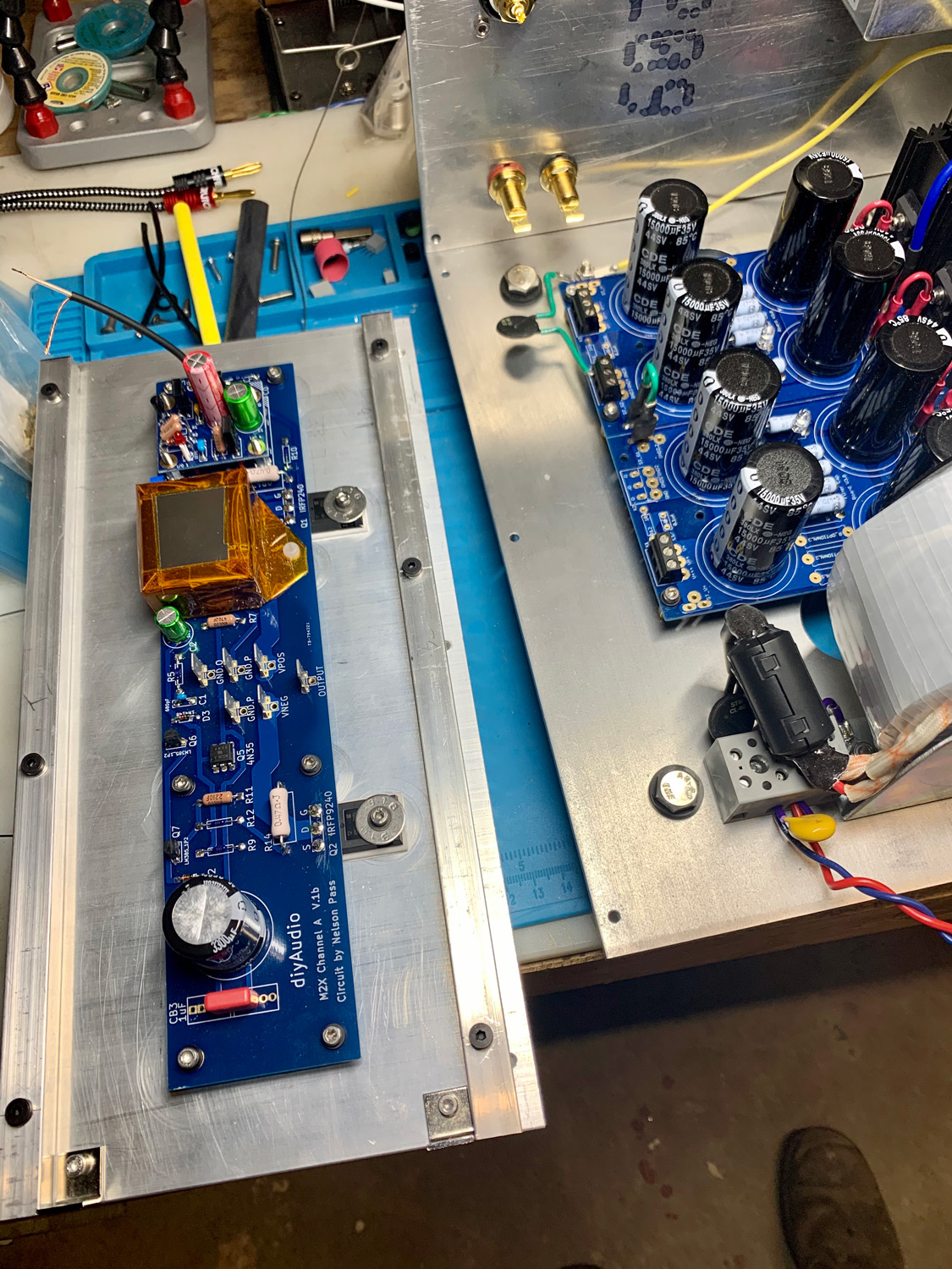

Had a little drama which 6L6 (again... What would we do without him???) noticed where I had 37R instead of 37K for R6—well we kinda noticed at the same time really.... That was some nice DC offset! Easy fix and they biased right up. Er zeroed.

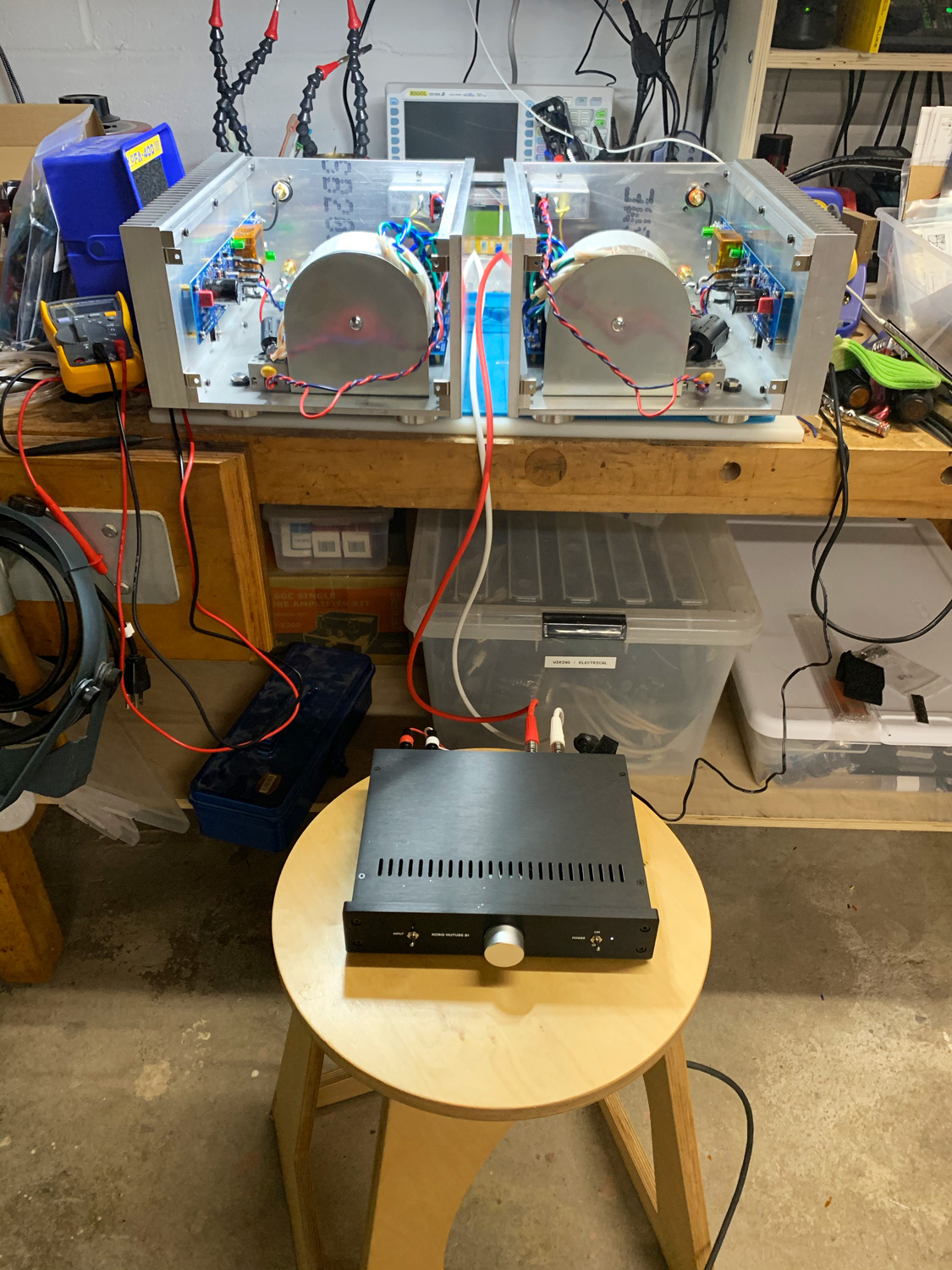

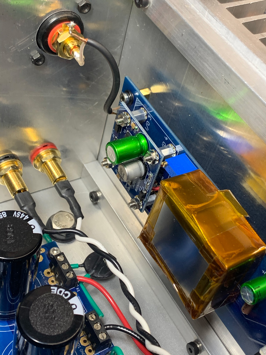

So with this build I decided to try something I read in the bonsai article and attached some crappy earphones directly to the speaker outs (input shorted, used an RCA Y to mini jack). If you try this, don't have them on ears when turning amp on and off. Ask me how I know!—and it was an accident—because I knew not to do that. WOW this was a serious learning experience... Three things that were/are? facts for this build:
1. Rotating toroid 100% affects hum/noise—there's a sweet spot with minimum noise—actually I learned this while building Aleph J.
2. Shielding the autoformer is absolutely worth it. HALF the noise when covered. Used mu metal.
3. Ferrite core around primaries did something—but not as much as 1 and 2. But it was an audible difference.
I would suspect that having the donut in a can would also be a no-brainer—but I was risking it trying to keep the boxes as small as possible. I did pass copper, aluminum, and mu metal sheets in front of the toroid and couldn't hear any differences... perhaps total encasement is the secret? Or perhaps my tuning of the transfo position was 90% of the cure?
Also was able to hear differences between input boards. With the only 2 I tried so far one was twice the "noise" as the other.
I have no idea if "silence" is an attainable goal under these listening conditions—first time I've tried it. What I can say is that I can't hear anything at all in between tracks when playing music or volume maxed. Speaks are 89db. Main system speakers are 98db... so we shall see.

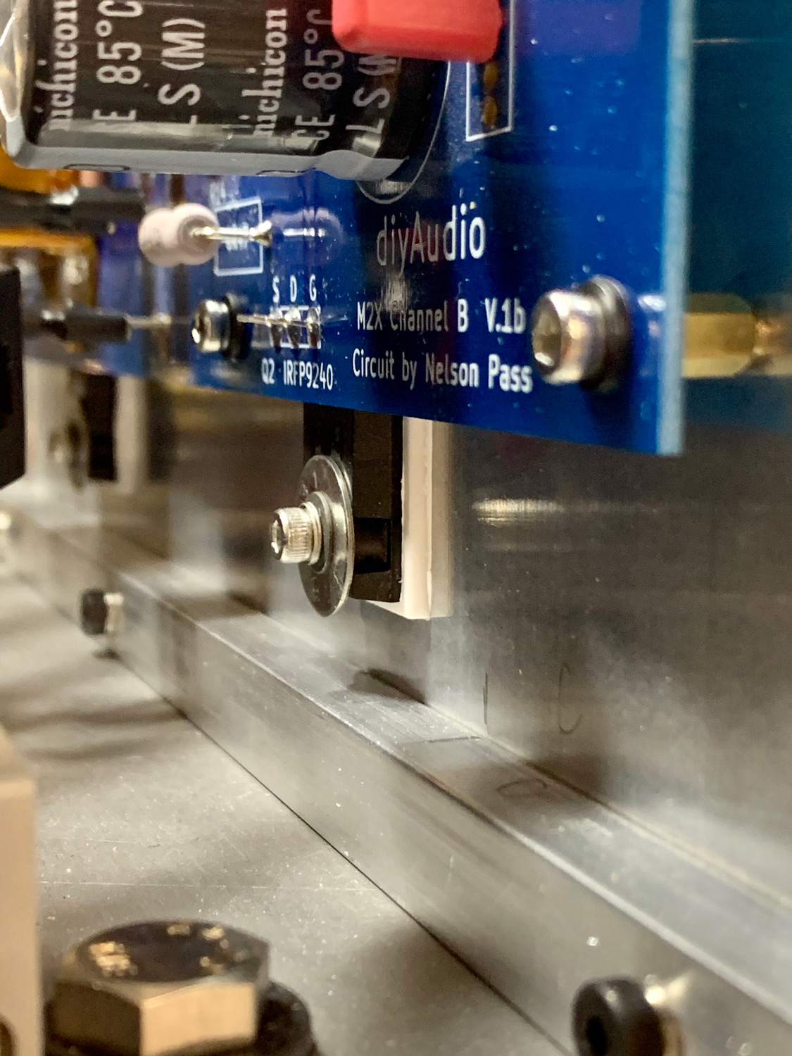

Definitely a fan of the ceramic pads for the mosfets. Sinks get warm, not hot.... Bias is perfect—(6L6 again—OMG 😀)

Spectacular build! The monobloc chassis look gefrigginge awesome with a heatsink on only one side and with asymmetric vent holes. I'm sure the "antique white wood" faceplates will be killer gorgeous too. Give some thought to pairing them with a blue LED that rhythmically "breathes" -- drop dead awesome.
