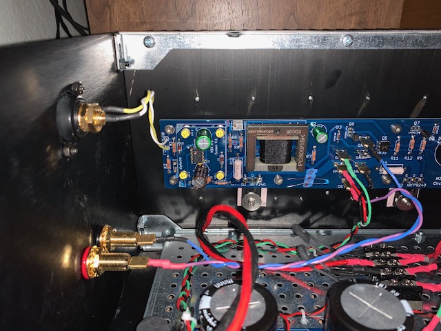

@delboy,
You should be seeing close to rail voltage on the daughter card two will read almost rail and two ground.
Unplug from the amp board from the supply and check the supply alone, what are your rail voltages? Plug the supply back into the amp and check the rails again at the power supply. For instance I get + - 30volts unloaded and about +- 27-28V plugged into the board. When I test the standoffs to the daughter (Ishikawa) I get slightly less than the rail.
If your rail voltages look okay, then it's time to break out the schematic and go back through everything. Also, I always fire up one side at a time. That way if you hosed something, you don't smoke everything.
If the rail voltages are still good, let us know what you have on the legs of Q1 and Q2
Here are some number off mine to help ya out.
Q1
Gate 5.16V
Drain=Rail or in my case about 28V
Source 738mV
Q2 should be very close to what Q1 is only Neg instead of Pos
Thanks for the help. I just measured the amp. Unloaded rail voltages are about +/- 23.4V. Loaded becomes +/- 21.1V to 21.4V.
Left
Q1 D +21.3V
G +5.07V
S +616mV
Q2 D -21.4V
G -5.14V
S -632mV
Right
Q1 D +21.1V
G +5.06V
S +619mV
Q2 D -21.1V
G -5.11V
S -612mV
It seems the main amp board is working? Next I think I should disconnect the Ishikawa daughter board and
- measure the Edcor; hope I have not mis-installed them
- put a signal directly on PIN4 and see if anything gets amplified
Will get back with further results...

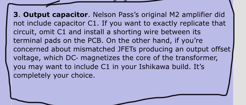

Just a thought regarding the Ishikawa Input boards. Did you instal C1? If you chose not to did you install a jumper as per 6L6’s instructions at the beginning of the thread? I thought I understood, and I may be wrong, that without this jumper you wouldn’t get any sound passing through the daughter board.
@JSA That Sir, is a great question, he did post some images of the daughter card and C1 is populated, but still a great idea.
JT
Yes you are correct, when I initially looked at the pic it was on my mobile phone and wasn't able to see the pics well. :O

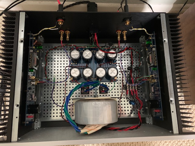

delboy123 - from a couple of your images you are using a cap in C0. Are you sure it’s good? Not shorting the input to the daughter board?
Thanks for the suggestion. I tested with a DMM... input impedance is about 100kohm on both channels. So seems right.
I am still scratching my head on my amp. Still doing a bunch of tests. I must have done something really silly.....

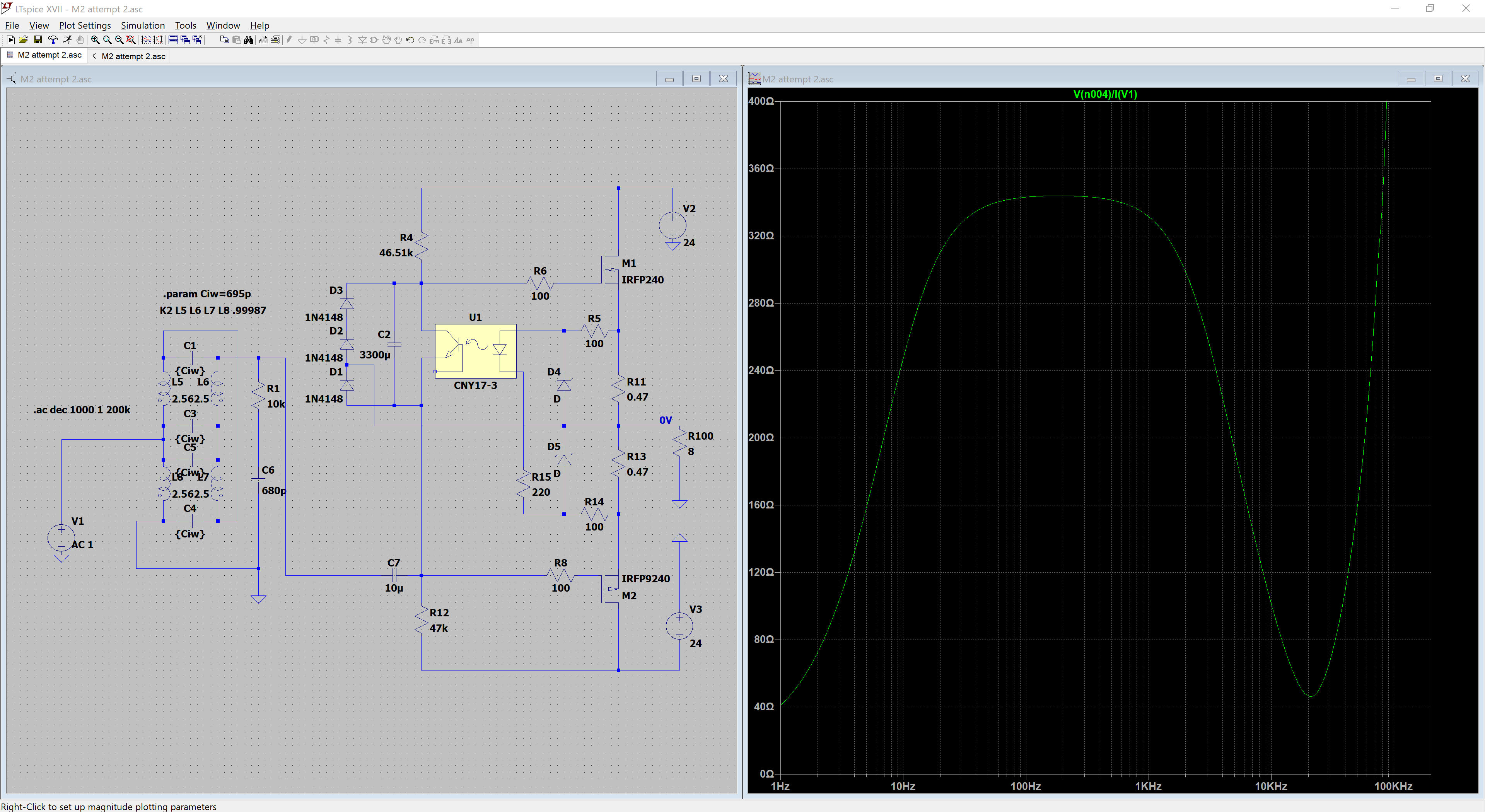

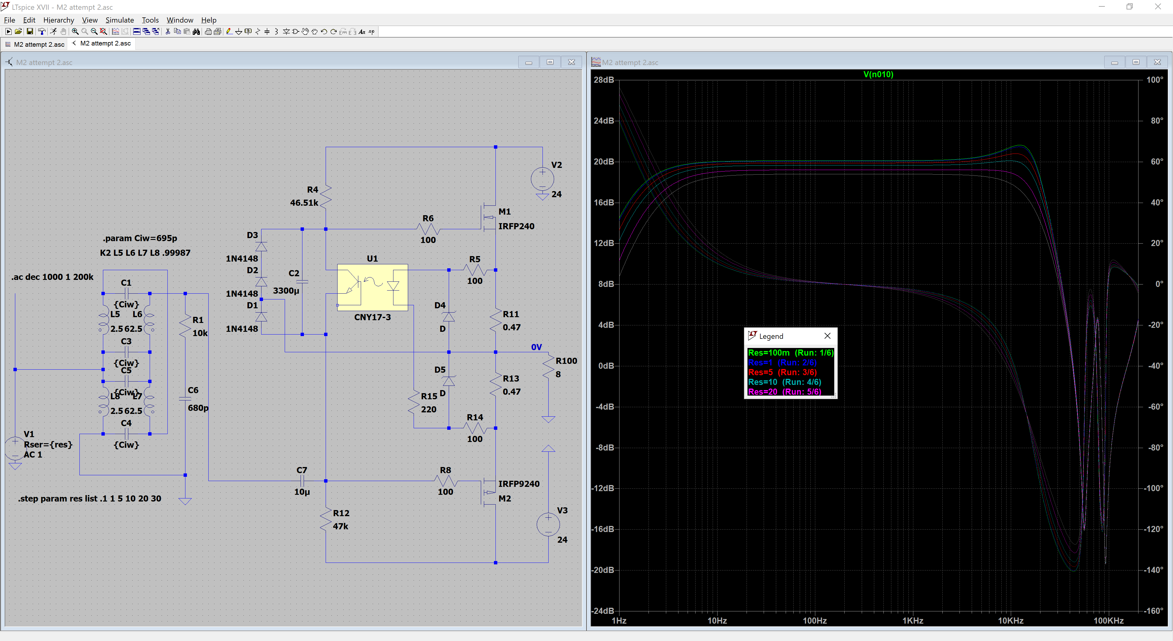

I'm interested in an M2-style amp with more gain to avoid having to use a separate gain stage. Scott's proposed solution looks good, and gives about 21dB gain with the same inexpensive Edcor.
The extra drive requirement of the high-gain arrangement seems to present a special challenge. The input impedance in the high-gain orientation drops to around 40 Ohm near 20 kHz (see 1st picture). The Norwoods will likely be needed. With the Norwoods, however, come a decreased output impedance of the buffer stage. This complicates matters, since the Edcor's 20kHz peak is naturally suppressed in the original design both by the RC damper (using Jensen's language) and the relatively high output impedance of the original buffer.
While the the audibility of the Norwood's impact to the 20kHz peak has been questioned before, the output impedance of the input buffer can make a substantial difference in simulation (see 2nd picture).
If the Norwood's lower output impedance brings the peak back, that can be adjusted with the RC damper (which appears more sensitive to the capacitance) (see 3rd picture).
None of this is new - see here and here for some great data on the Edcor. This data is consistent with the general trends observed in the simulations, but it actually looks better than simulated.
I don't have any experience with these circuits in the real world. What sort of downsides am I looking at when I increase the C in the RC? The bandwidth drops some with the earlier roll-off. While I can (probably) measure AC frequency response with a multimeter and sinusoidal .wav files, is there any practical way to select C without a scope and function generator to check the square wave response?
Surprisingly both 15dB and 21dB auto-transformer modes match sim vs measurement fairly well, with the biggest difference being less peaking at 20kHz or so. An appropriate R/C damping network could probably make both very flat at the top end.
