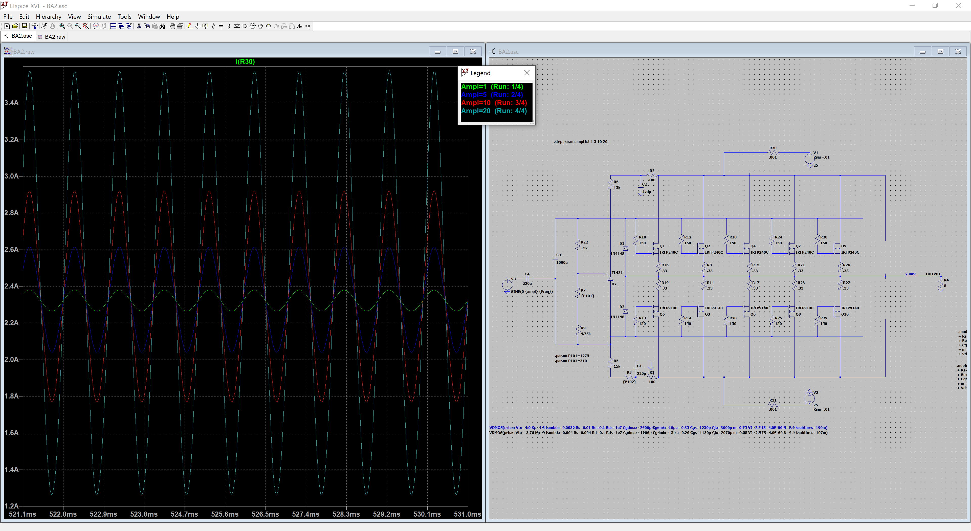

spice test
Here's a quick test with LTSpice I ran with a BA-2 output stage, which should correlate to the M2. "Ampl" is the input to the OS in volts, and the waveform is the current drawn from the positive rail. Looking at the waveform through the source resistors, it remains in class A (the FETs pass a clean sine wave without flattening).
Nelson's comment makes sense - in a balanced amplifier, the out-of-phase variations would cancel, presenting a relatively constant load.

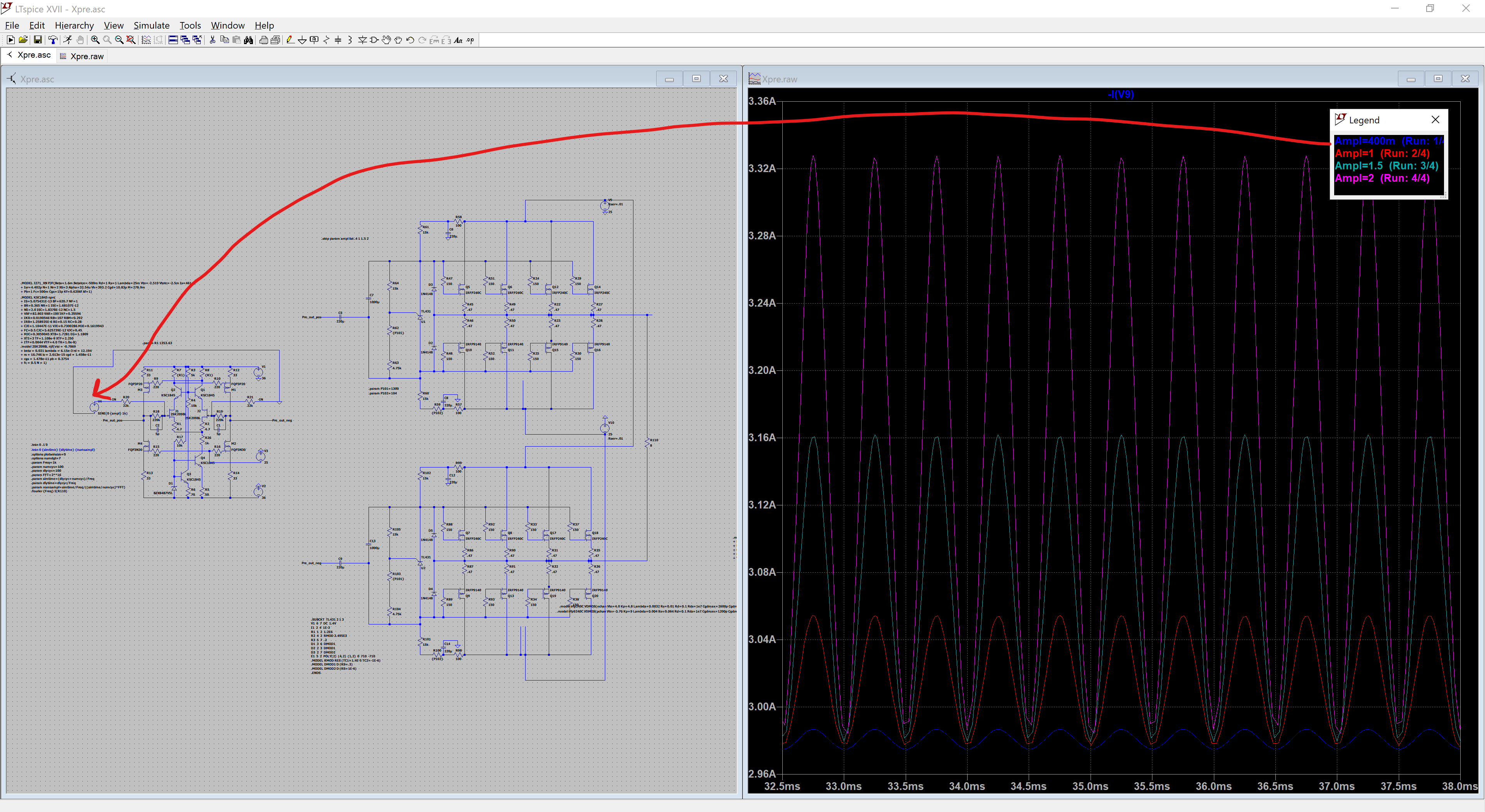

EDIT: Balanced sim added just for fun. "Ampl" is input to the front end this time. The current through the positive rail has much less variation.
