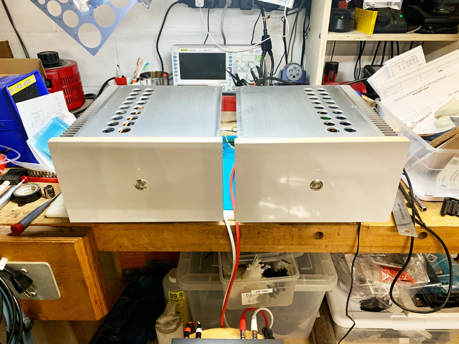

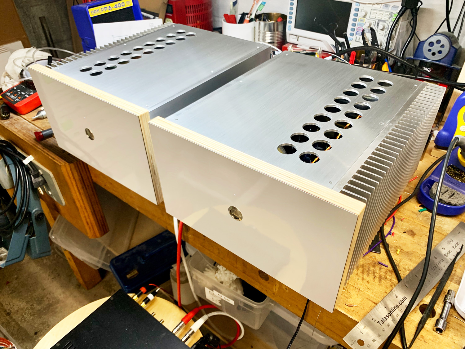

Great look, love the bare alloy and wood face. The best thing about mono blocks are 2 foot long speaker cables.
PF - Holy cow, man!!!! Spectacular. Thanks so much for the stellar pictures and the great information.

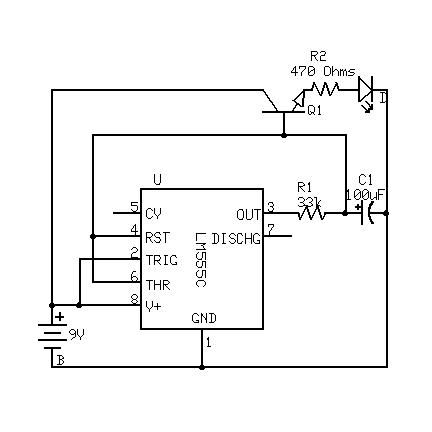

"Breathing" LED? How? Was thinking RED for some reason...
?? --> How to Make an Led Pulse Circuit : 3 Steps - Instructables
??? --> Building the TARDIS - (Pulsating LED Circuit) : 11 Steps (with Pictures) - Instructables

Spectacular build! The monobloc chassis look gefrigginge awesome with a heatsink on only one side and with asymmetric vent holes. I'm sure the "antique white wood" faceplates will be killer gorgeous too. Give some thought to pairing them with a blue LED that rhythmically "breathes" -- drop dead awesome.

Here's the heart throb LED schematic Mark Johnson. Will have to drop the voltage since I have like 24.5 on the rails and it looks like the timer won't like that... but I could make a couple of these! Already learned a bit about voltage dropping with an Iron Pre add on.

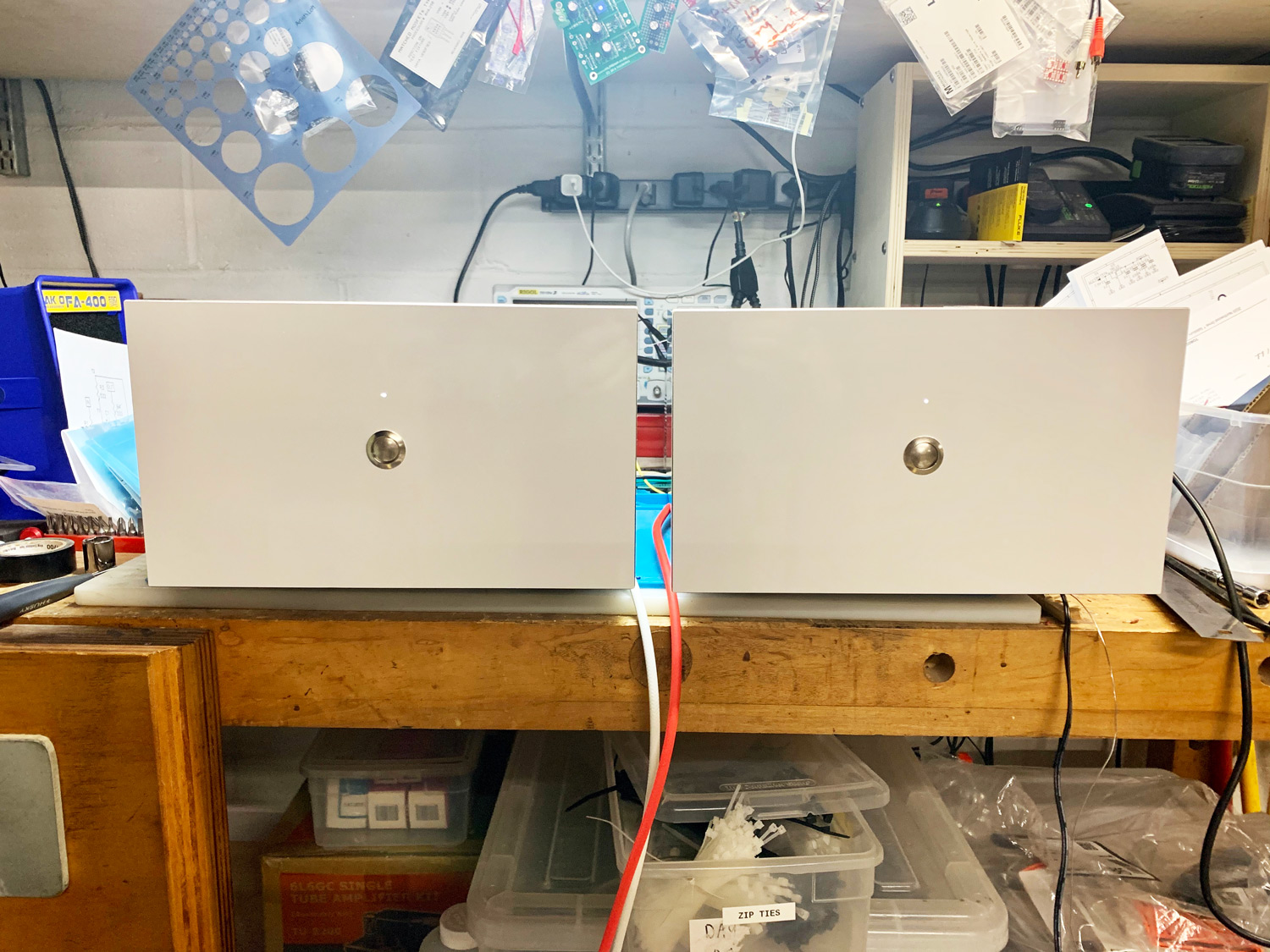

So here's how the fronts happened in the end—ditched the old wood thing—wasn't right for this...multiply is a good transition from aluminum. I'll put them in the main system tomorrow—with Ishikawa—so I can get a sense of NP original intent before messing about.
I'm pretty happy with how they came out—lot of work though..... VERY solid. I tried a red LED and it completely got lost visually on the white...So white it is...
(I have all the parts to make a throbbing LED)

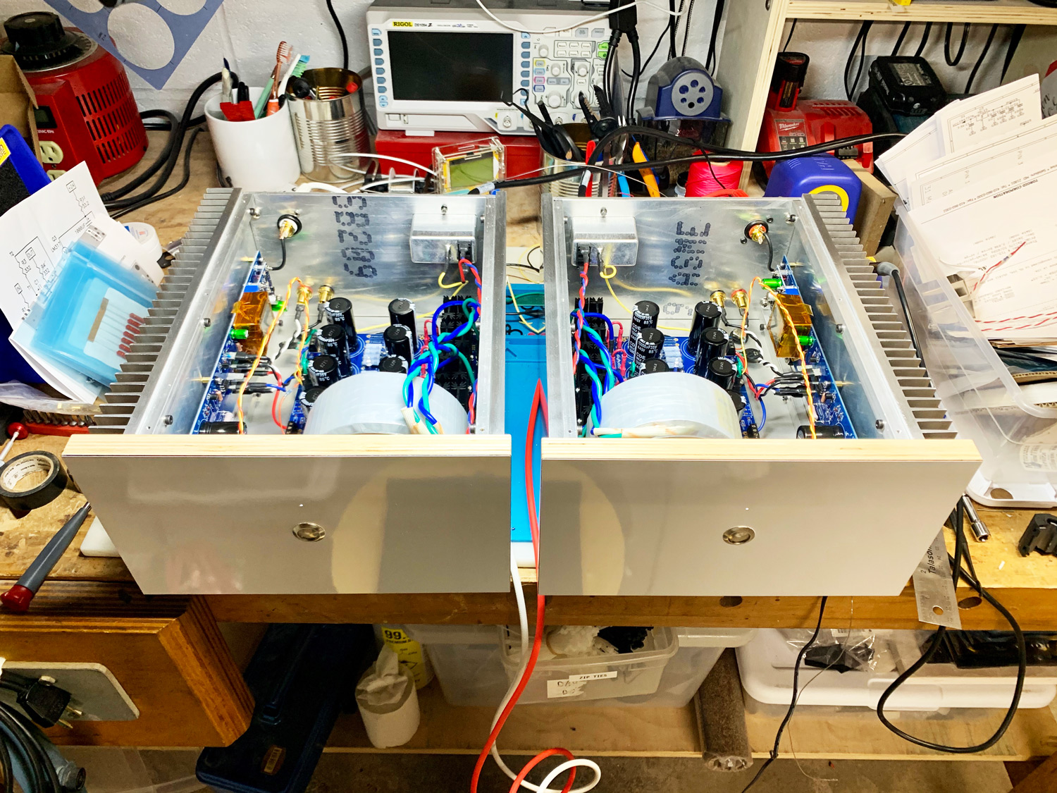

Well done! That is one impressive build!

Can you please provide the dimensions of the cabinet including the heat sink fins as I am also planning for the same for my USSA-5 amp.
Those cabinets look gorgeous 🙂
Thanks!

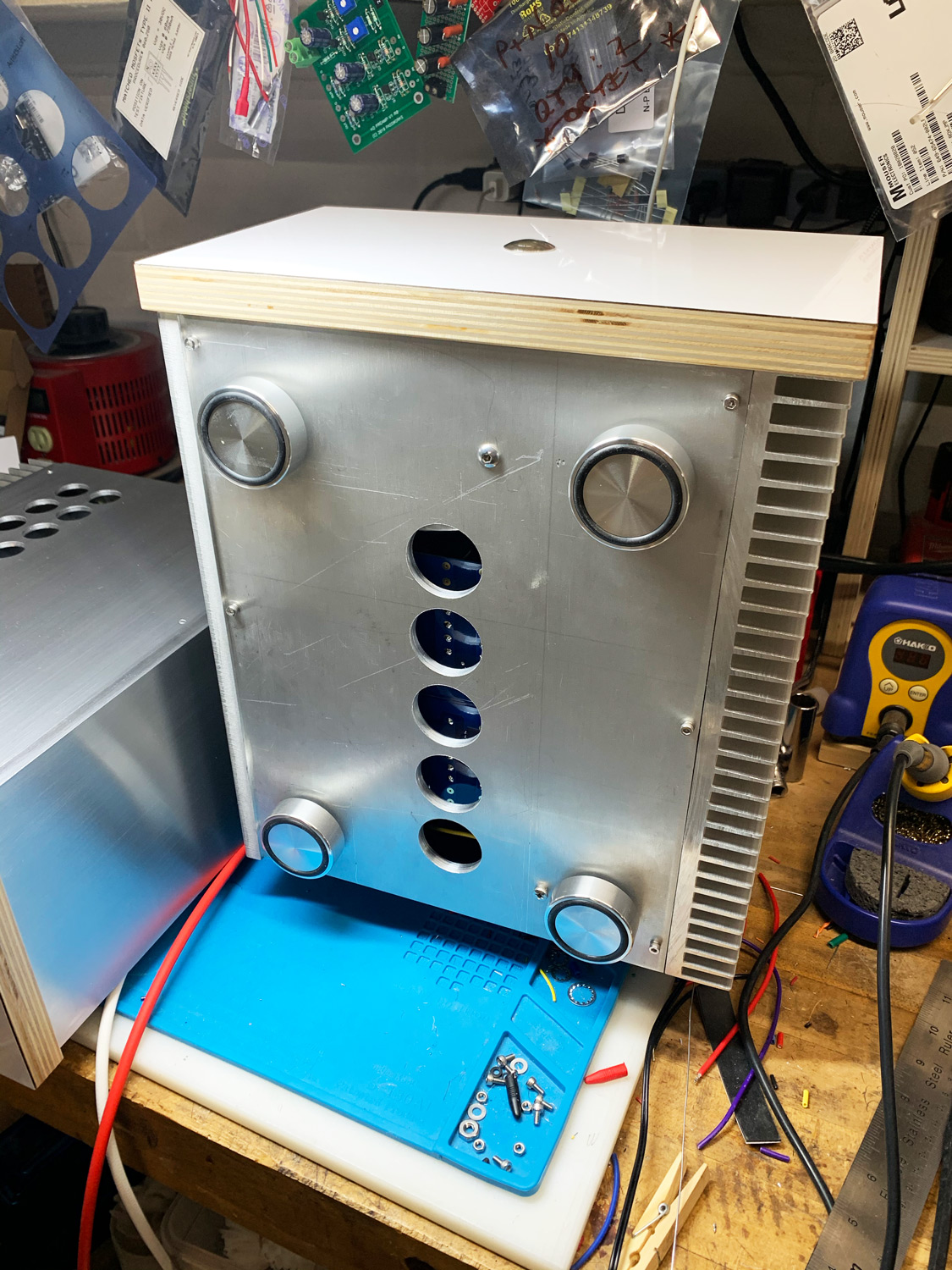

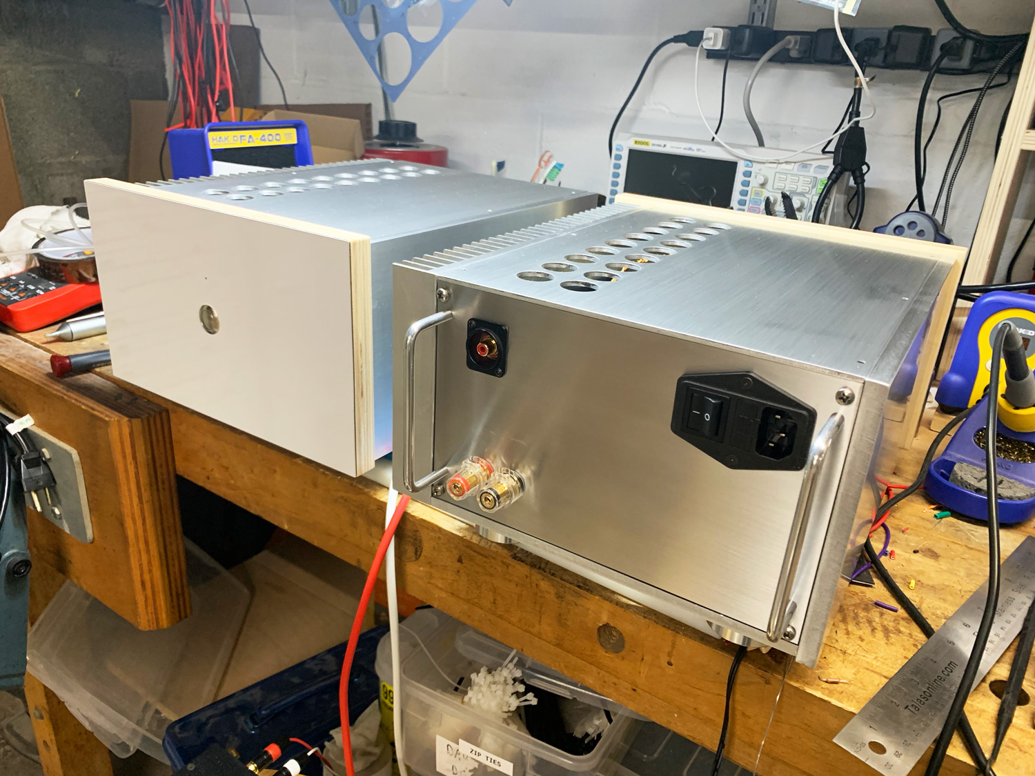

10.75"W x 12"D x 6"H Overall dimensions not including ply front or D handles.
Or basically based off the heatsink dimensions (heatsinkusa.com) which are 1.3125" x 12" x 6". They barely get warm, probably could have gone with a shorter extrusion, say 5" and sourced a smaller 200VA donut. But I think the front proportions are nice.
The baseplate is .25" aluminum and is 9" x 12". The panels opposite the heatsinks are .375" thick. All other other plates are .125" thick. 6061 aluminum, though recently I used some 5052 aluminum for the Cordell gain clone amp and it seems to finish easier? The alloys are very similar though....
