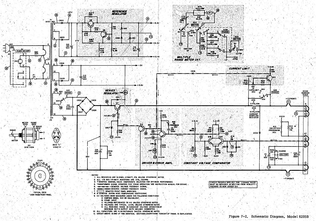

Wow - I'm genuinely impressed at the HP engineer so may years ago who designed that PSU to gracefully operate whilst being hooked up inside-out like that. (I have one of those, BTW, they are awesome... 🙂 )
Please attach your green wire to the INSIDE + and -, take your output from the outside + and -, and attach your ground wire to either of those inside posts with the green wire. Leave both of the posts marked GND alone, as you already are doing.
Thanks - it's producing + and - 28v, can you explain the difference?
I'll take a stab at this. (Someone will no doubt correct me if I've got the wrong end of the stick.)
If the two power supplies are truly floating (ie: they use separate transformers or separate secondaries on a single transformer) then it won't make any difference. However, if they're not (ie: they use a split secondary), then the middle -/+ are already connected and connecting the outsides will short out the secondaries.
Always doing it the way 6L6 suggests means that you don't have to know which it is.
All my supplies are fully floating, but I can't remember if I specifically looked for that when I bought them or not. (Or maybe non-floating were more common "back in the day"?)
Well the unit seems happy either way, but it's now connected per 6L6 recommendation. Using this until I get around to a more permanent solution.
Edit - I just looked at the schematic and it shows only one side, with a note at the bottom saying everything to the right of the transformer is identical.
Ha! Great example.
The secondaries are centre-tapped, but to select different voltage ranges rather than for the two sides of the power supply. Each side has its own (centre-tapped) secondary. 😉
