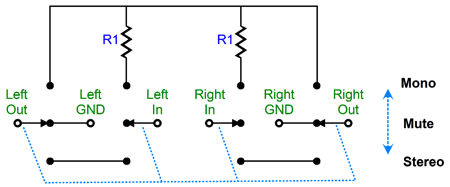

The BA-3 as preamp build guide

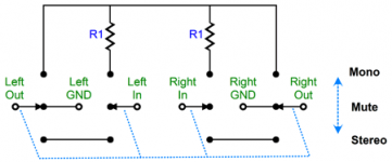

Here's another picture of my finished BA-3. Even though the F5 seems quiet, should I be inspecting there too? Both amplifiers have safety and signal grounds bolted directly to the chassis at different points. No NTCs or other components in the ground plain, in the event that's helpful.

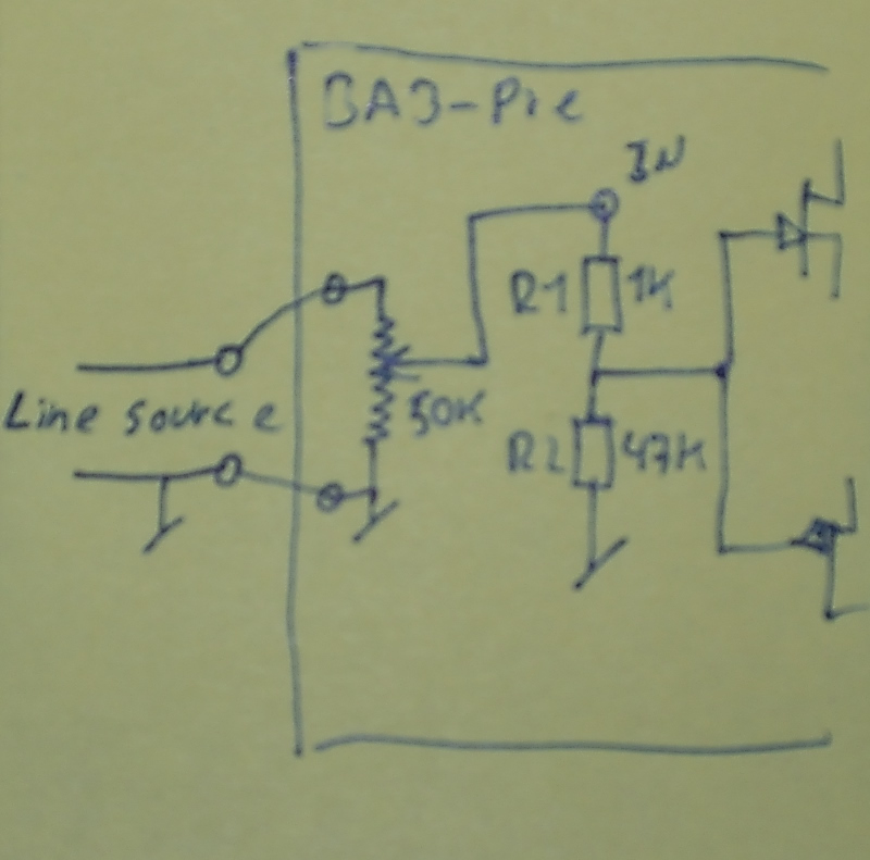

Is there a schematic somewhere which includes an e.g. 50k pot/attenuator for vol. control? …...I want to see how it interacts with R1 and R2.....just to be sure. I can probably see it from the way 6L6 wire it in the start of the thread but just to be 100% sure I do it right when time comes…….
