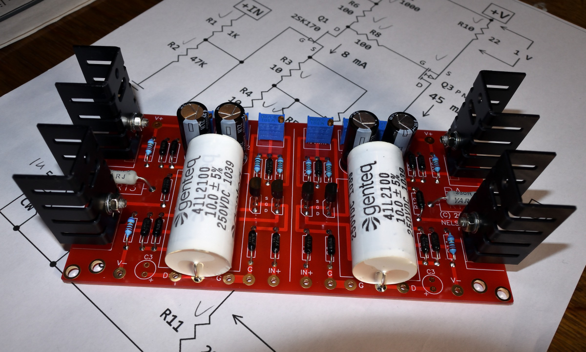

Now one step closer…...PSUs are ready and now also the BA-3 pre PCB. I noticed that you has the pot screw to the left while I have it to the right. I am quite sure I have mounted the Bourns pots according to schematic with CW and wiper connected to each other. CW is pin 3 (left on picture) on a 3296 (102) Bourns pot. I use Fairchild mosfet so 1k pots. Jfets are a Toshiba quad which I got from the ebay seller with the "funny" name…...
