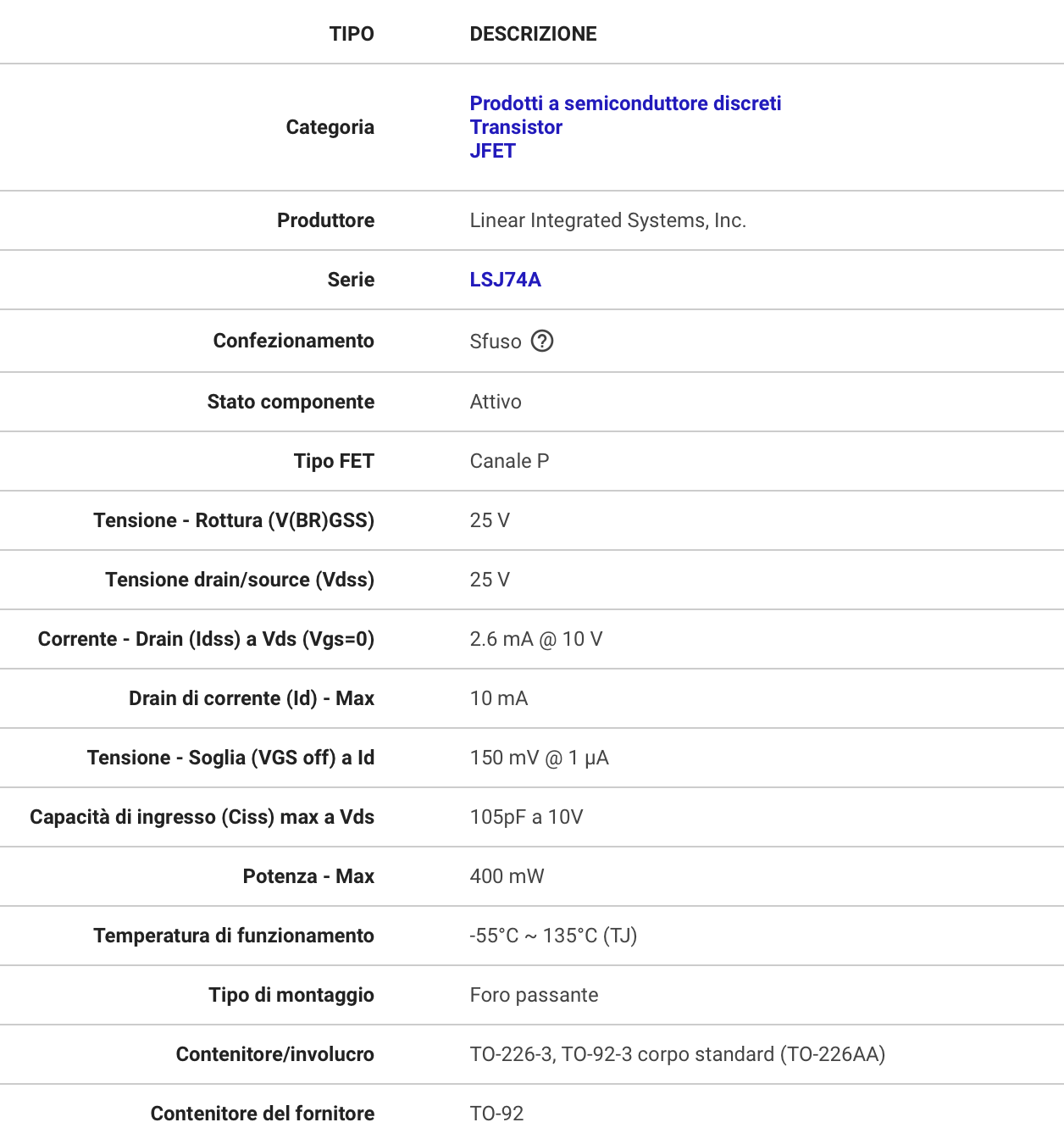

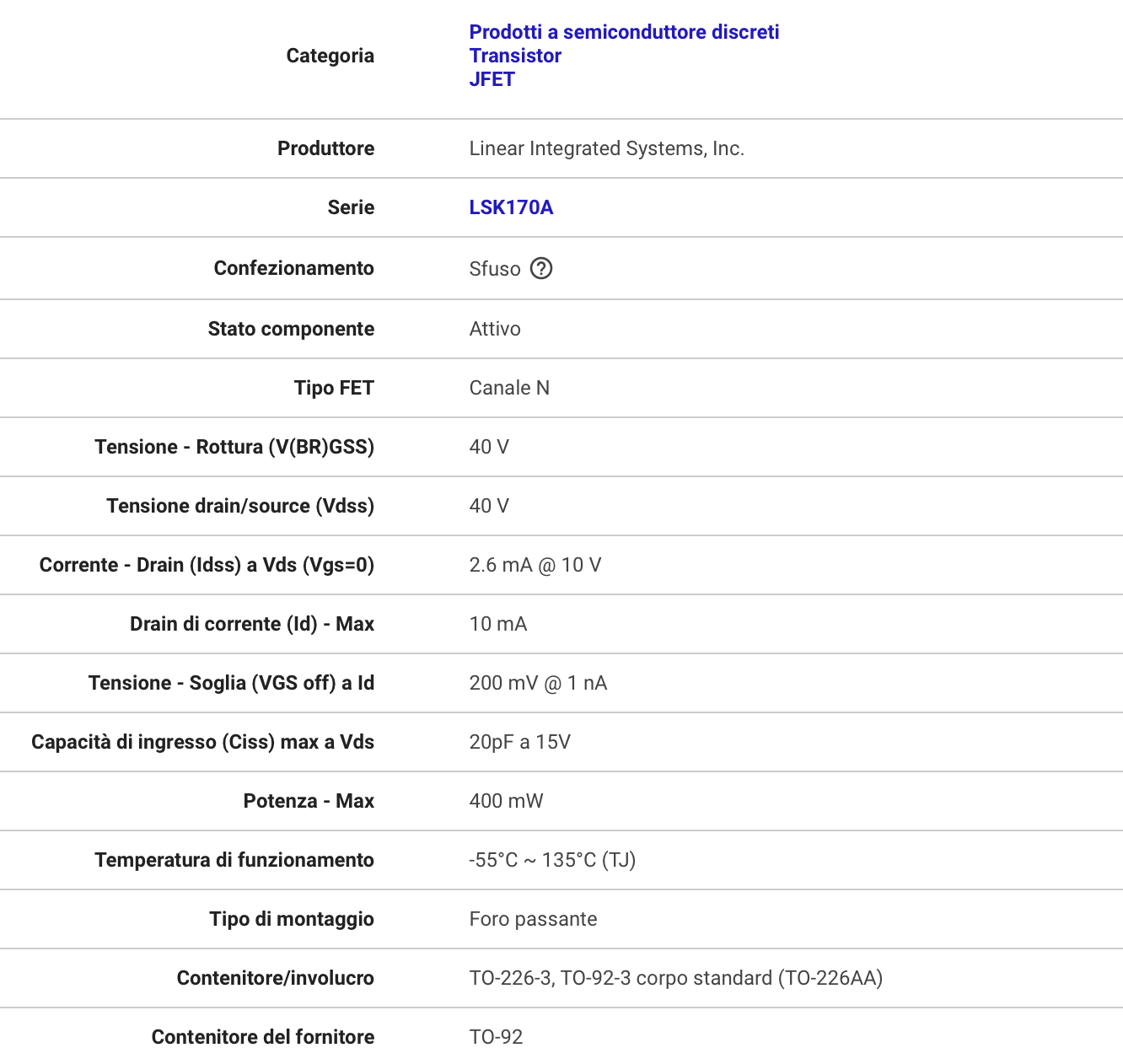

Are these attached gonna work to populate a second BA3 board to make of mine a balanced one?
The actual board been populated with the Toshiba ones
Grazie
Grazie
