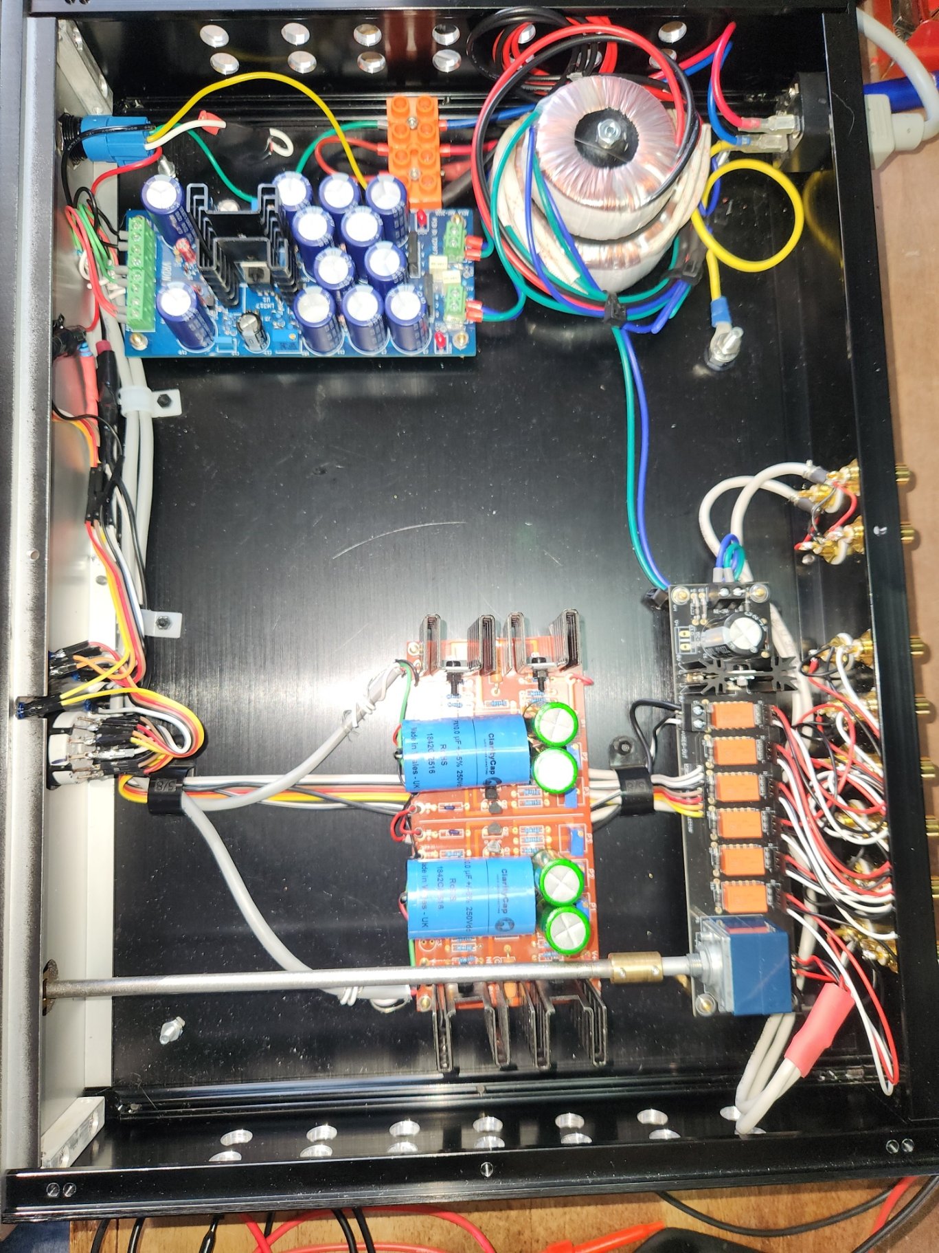

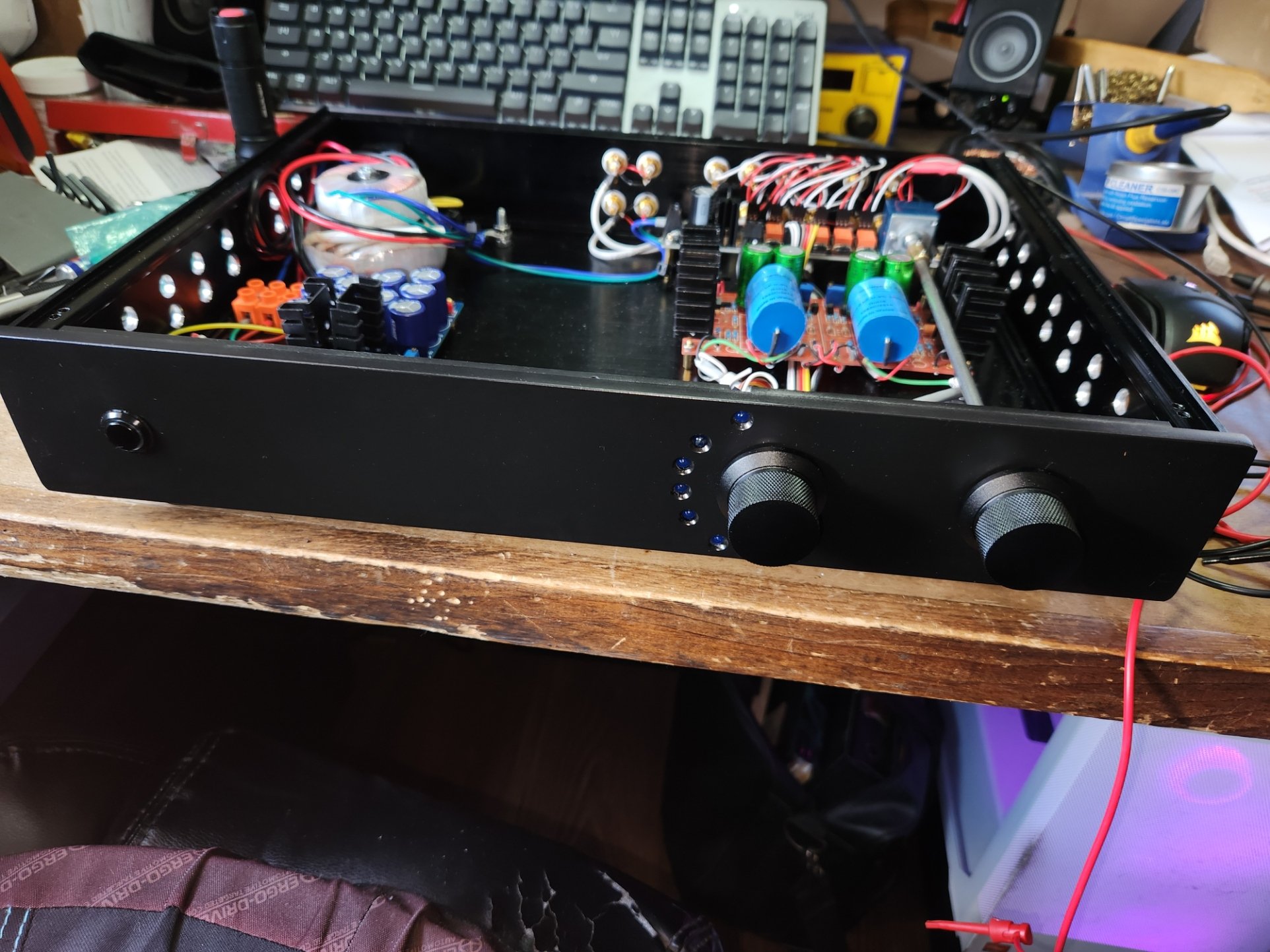

I just (finally) finished a BA3 Pre, partially finished it sat for a few years. I was using Wayne's pre, quite a different sound between the two, both are great, but very different! The BA3, seems more forward? in the mids, and the bass does seem bumped up. Hooked up to an F6, pretty happy, now i need to build an M2X and run two systems, will need a bigger house though .
Thank you, coming from you it really means something to me. The parts testing, placement, and soldering, I really enjoy, the hard part is after that. The arranging, marking, drilling, and trying to keep it neat can be a dog. There is always a moment I should walk away, but sometimes I don't know it at the time, and that's when I goof, and then have to fix it. That happened here a few times, I didn't take pictures of the goofs though! Thank you for all of your build guides btw, life saving(I really mean that), a picture truly is worth a thousand words sometimes.
