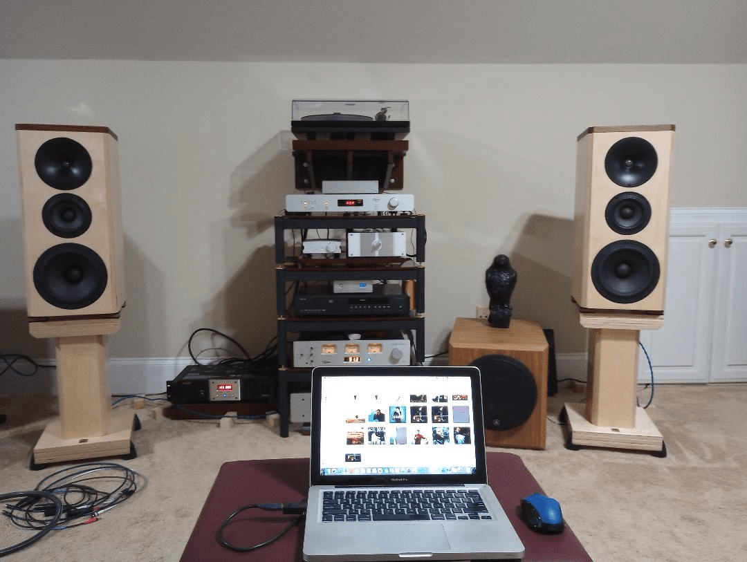

Completed the preamp and installed it in the system. The final bias voltages for both channels were in the .985-.995 volt range. Offset for the right channel hit a range of .oooV to -.000V (got lucky in final settings). The left channel ended up at .002V to .004V. In my system the gain was still too high, and I would rarely increase volume beyond a quarter turn. I am thinking of adding the 330-ohm resistor I have in parallel with the installed 200-ohm resistor reducing overall resistance for R13 to about 125 ohms. I raised those resistors slightly off the board making axis to attach the extra resistors a breeze vs removing the board to pull the existing resistor and install new ones. Any issues with that approach? Other suggestions?
I am really pleased with the sound and my first impression was an improvement in the sound stage, both depth, width and placement of musicians and vocals. In addition, definition has improved with better focus. The example I will site is back-up singers were always there but now they are better defined as unique vocalists. Thanks to everyone beginning with Papa, 6L6 and all who had gone before me and shared their experiences for me to learn from and those who responded to my questions along the journey. The image below is the system with the preamp on the second shelf right side.

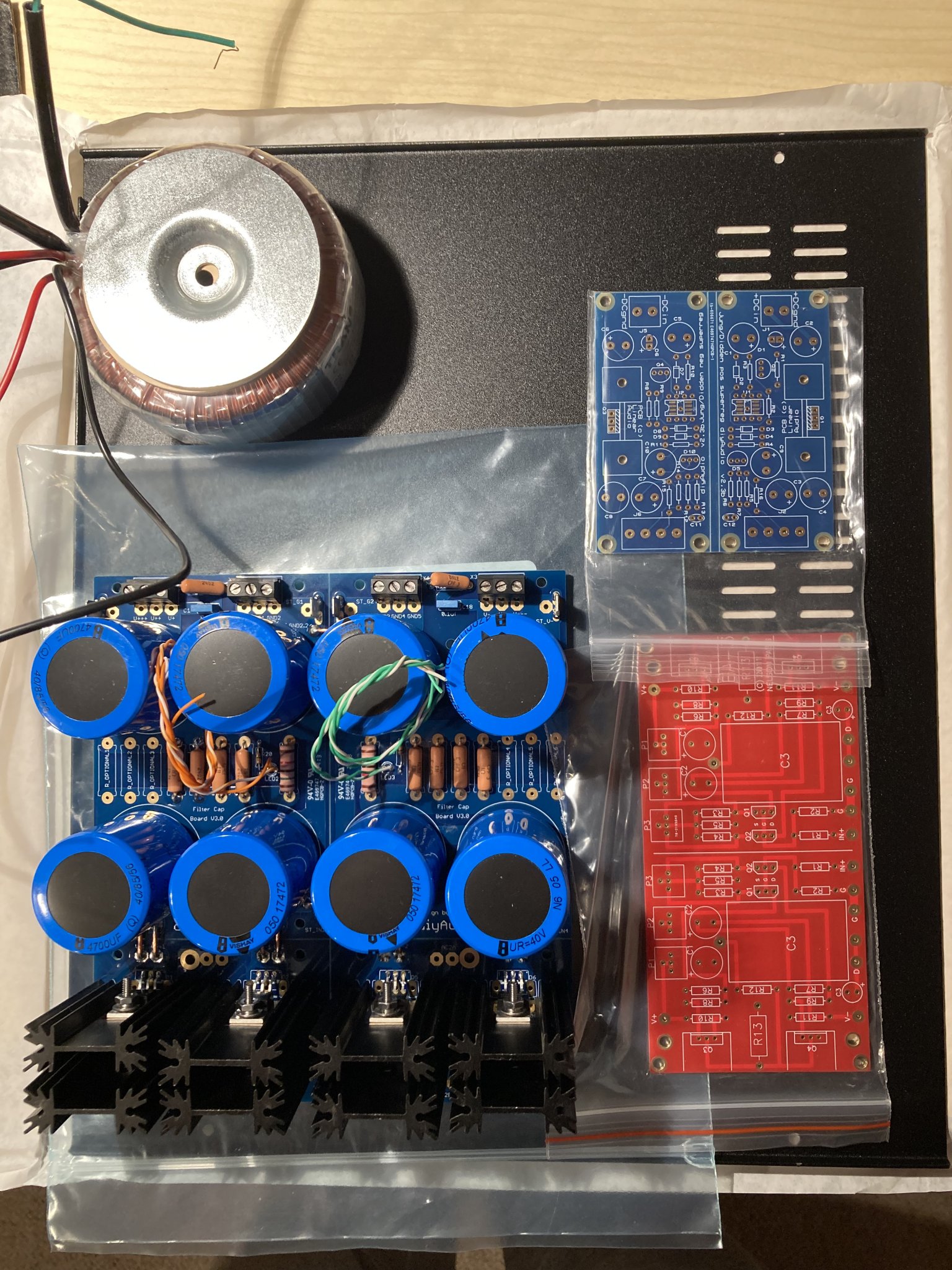

After several month`s as a quiet reader I've started today to build a BA3 preamp. I'll use 22 VAC and a psu which might be a little bit too much. After the psu one needs to use a superreg, so will I. 😉 Will use 24 V rails, a DACT attenuator and a Elma source switch. Altogether will be housed in a Galaxy chassis. Of course one needs porn, here are the first pics I made from the progress I made today. It`s a lot of fun to build my own audio equipment based on such a huge knowledge base as can be found in this forum. What a great place! Cheers!
