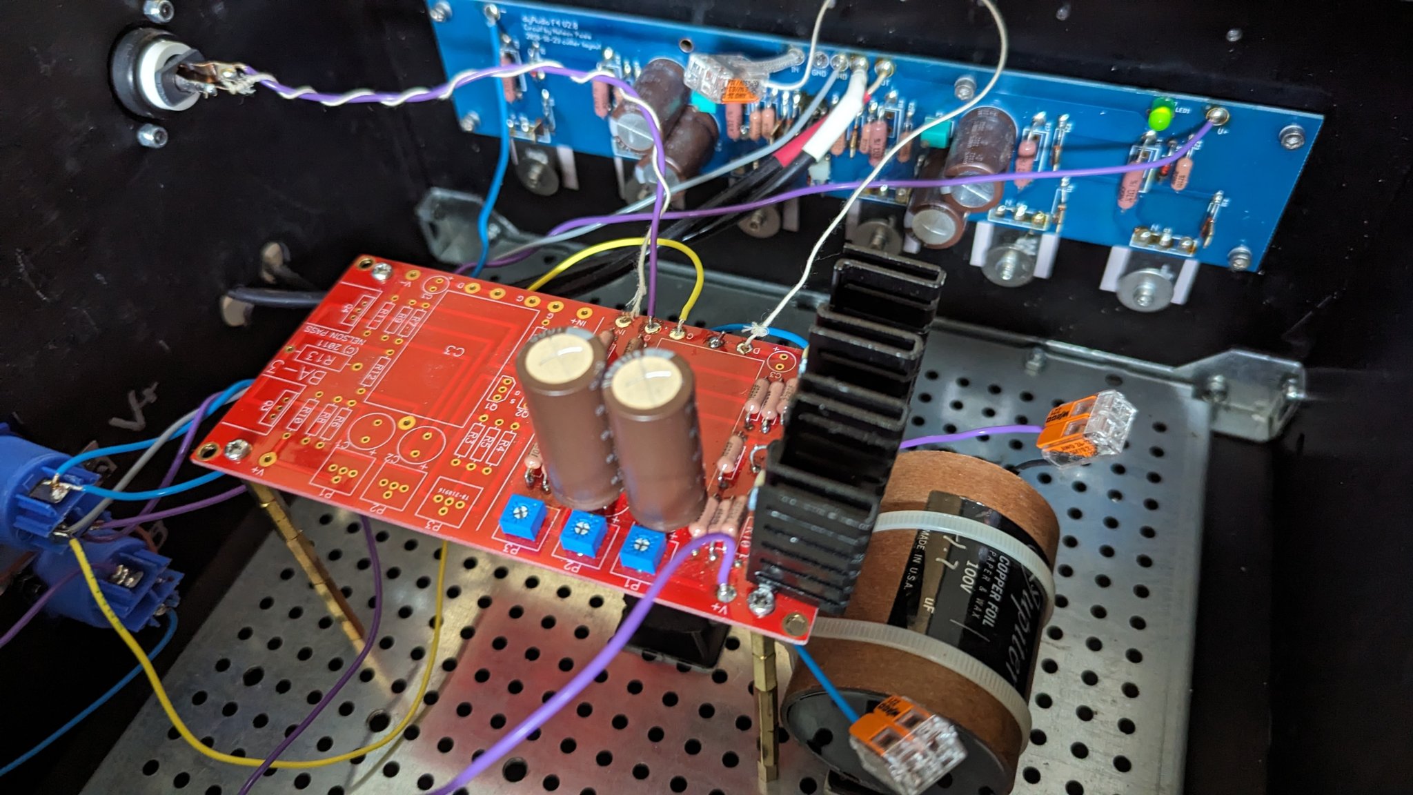

Unrelatedly, yesterday I put in leads and wire clips so I could switch out output caps quickly for A/B testing. They really affect the sound a lot in my system. I tried three different caps that I had around and could immediately hear the differences between each (Mundorf MCap Supreme EVO Oil, Mundorf MCap Supreme MKP, and Jupiter Copper-Foil Paper & Wax). The Jupiters were around from an old tweeter crossover project, but really sound sublime. Obviously they're prohibitively expensive for many, but I think regardless the take home lesson is that it's worth it to try a few different caps and invest in what you can in that location.

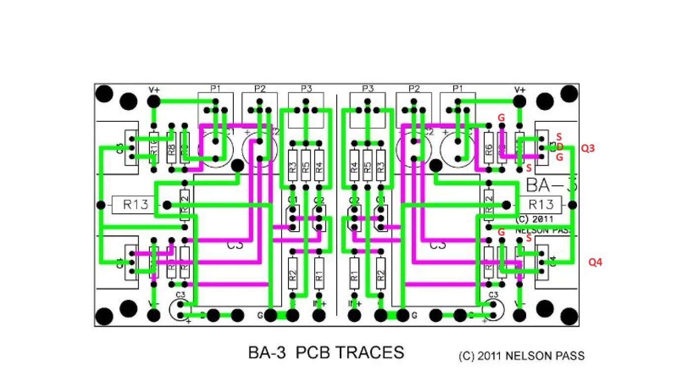

One of my boards is passing a signal, but not amplifying. Everything looks fine (i.e., no smoke or charred parts) and I the biasing process works normally, but I only get a very weak signal at output. A working board was outputting 5.53V with a 1k test signal out of ARTA, but I only got .5 something volts with this board.
Any ideas on what I need to test to identify the problem? Given that the circuit is working normally, I'm guessing it's the MOSFETS?

R3=0mV, looks like Q1 2SK170 is bad, as no current is passing through. Another check of that is the voltage drop across R6. 0V drop across R6 would also indicate that Q1 is bad, and not conducting
So, you'd recommend that I use a matched pair and replace both Q1 and Q2, right?
I've got a pair of old F4 boards I'm not using with matched toshibas in them, so it's not too hard of a task.
Thanks for the help!
R3=0mV, looks like Q1 2SK170 is bad, as no current is passing through. Another check of that is the voltage drop across R6. 0V drop across R6 would also indicate that Q1 is bad, and not conducting.
I replaced Q1 and Q2 with my other pair from an F4 board. Unfortunately the circuit remains as before. It biased up as normal, but isn't amplifying the signal and I've still got 0mV at R3 and R6.
I guess I'll try replacing the MOSFETS tomorrow.
It is strange that the mosfets bias up normal but Q1 and attached resistors pass no current. What is the measured voltage at Q3 between its source and gate pins?
If no current passes, that could because of a break, such as a bad solder joint, in the circuit or a faulty component. Check to make sure voltage is getting to the JFET. Check for voltage at R6 relative to Gro
Post some clear pictures of the top and bottom of the board. Perhaps there is something that can be seen.
You can also test the JFET that you removed to see if it good or bad.

You were right about the bad component. After replacing the jfets and mosfets, the problem remained the same. In the end I fixed the circuit by replacing R10 & R11. I think I had both a bad solder joint and a bad resistor in one of those locations.

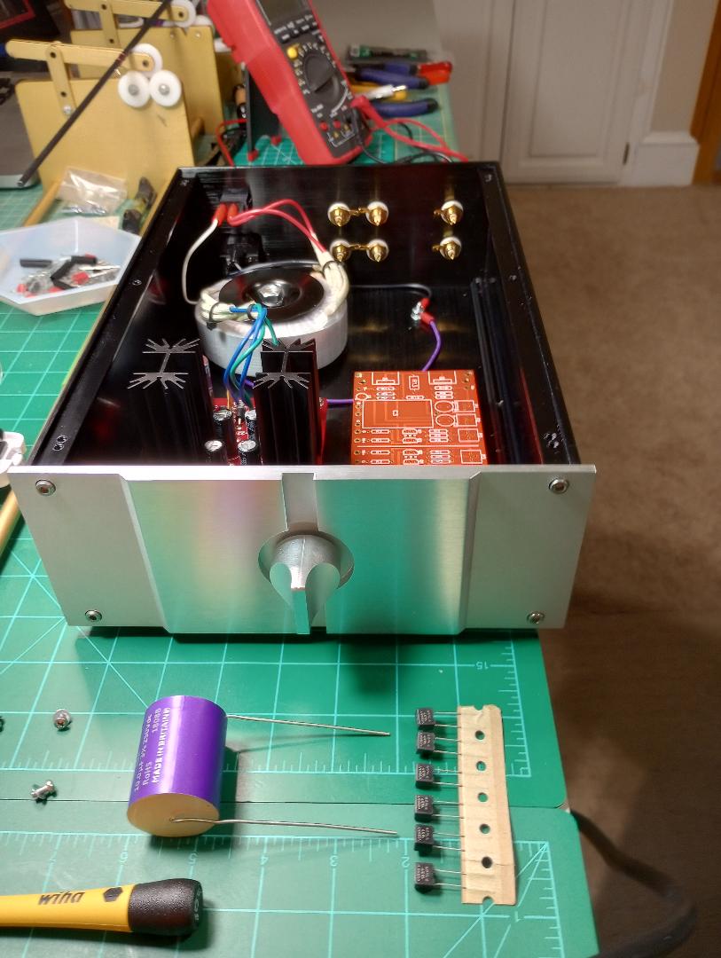

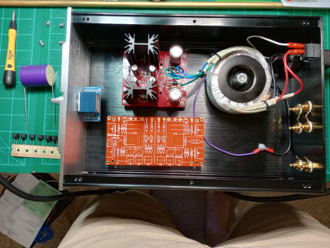

Guys, this might be a long one as I am finally getting my sh--t together and building this preamp. As a set-up I started gathering the BOM back in 2018. I am using Toshiba jfets and mosfets purchased from punkydawg and prakit. I also have the antek 20V dual secondary transformer, PS-22 (24v from glassware) power supply with the case ready to go. My progress so far is getting the case ready (pictured below) mounting the transformer (tested the dual secondaries), completed, mounted, and tested the PS-22 (both rails a touch over 24v). Next step is the preamp board where I have three questions that tie in my system which includes a single ended, 3 stage jfet, zero feedback design MM phono preamp with 50db of gain that I just completed. I plan to drive my McCormack DNA 125 power amp (100k input impedance, 30db of gain and input sensitivity of 1v rms) as well as an O Audio Bash 500 sub amp. This is why I have two sets of RCA output jacks. Now that the summary of where I'm at is completed, my questions:
1.) I ordered my P1 and P2 pots before I sourced the Toshiba mosfets and bought the 1k versions. Any reason I should resource 500-ohm versions?
2.) I know everyone is tired of gain questions but, as I have reread all of them and based on my planned system I think I should reduce the stock gain by inserting a 200ohm resistor for R13. I originally bought both the 330 and 200 based on reading dialog long ago. Thoughts from you guys?
3.) Last question I think is another topic that has been discussed to death but, my plan is to use ClarityCap CSA 10uf for C3 and my question is around adding a bypass capacitor, specifically Vishay 1837 .01uf 160v in the secondary location on the board. I seem to remember in my reviews here that Zen Mod recommended an option but, I could not find it so I'm interested in what's been done so far and has worked well.
Thanks for reading the long-winded overview and I appreciate any input the team here can provide.
Chris

Wow, 6L6 thanks for the quick reply. On the film cap bypass, it was kind of a rage on loudspeaker passive crossovers and some combinations of capacitors enhanced or were synergistic to the final sound. Maybe my 70-year-old mind is failing me in thinking I read discussions on this thread. Your feedback is much appreciated.
