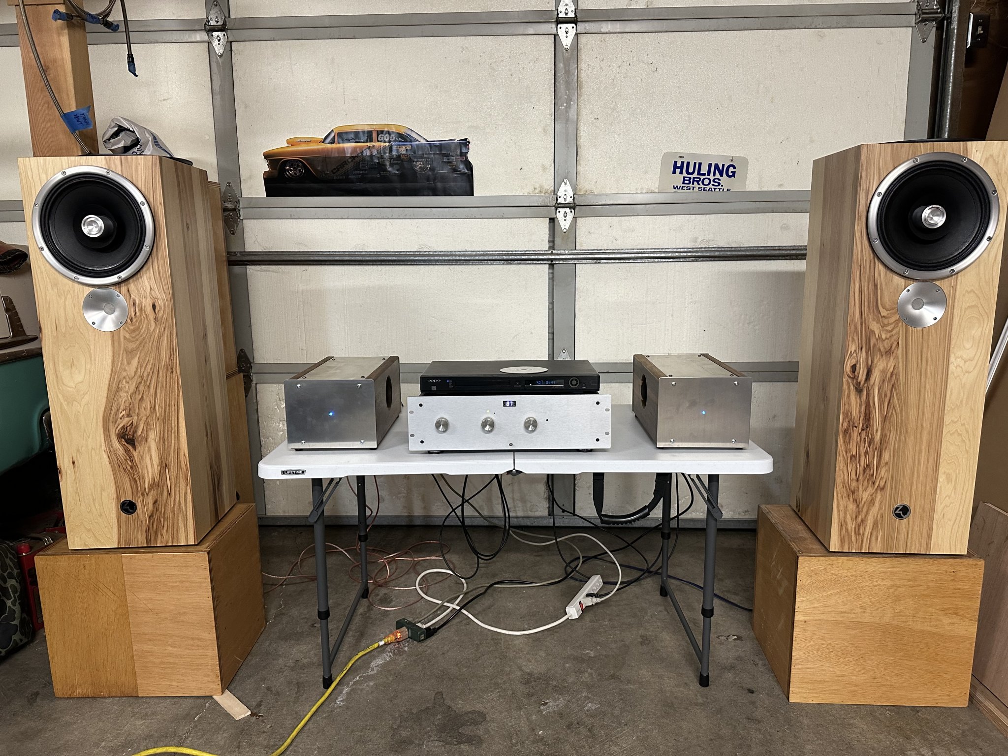

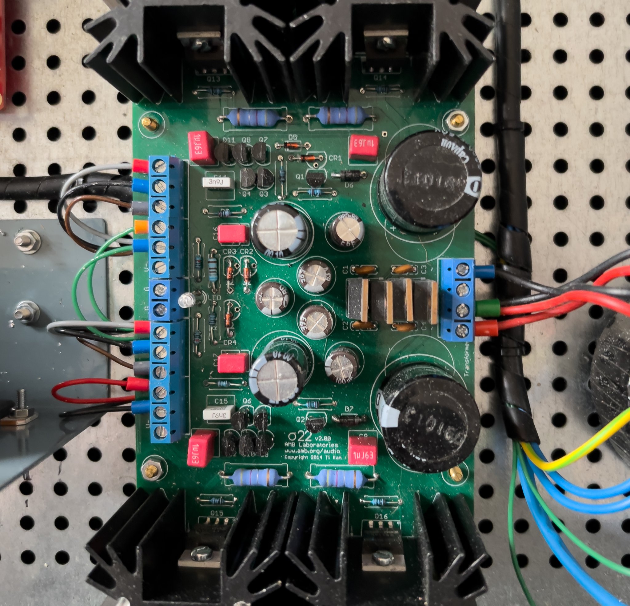

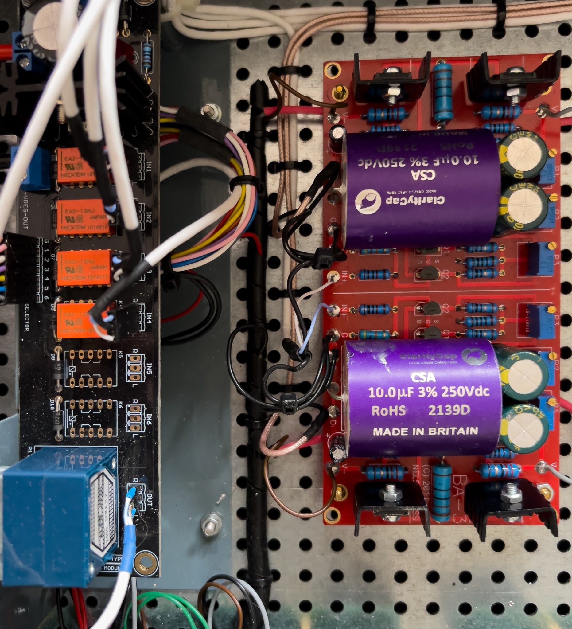

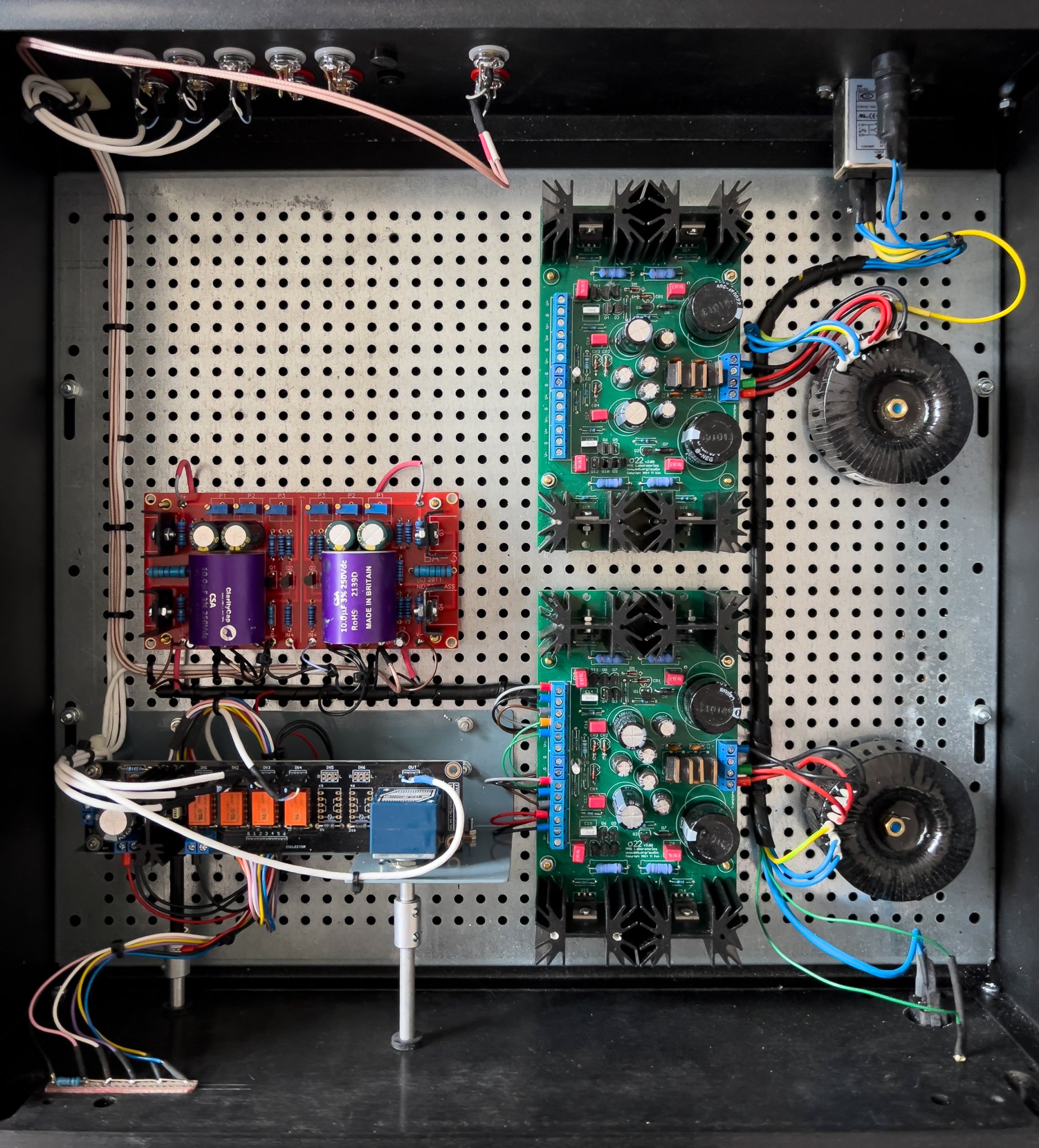

Well it only took me 12 years to build the BA3PRE but it is well worth it! Thanks to Mr Pass & all the FAB DIY’ers that came before me.
If you ever would like to build anything in this “club” all you have to do is read the threads…it’s all there.
I even found the Toshiba's!
Dual mono of course with Sigma 22’s. First time with Acadamy Audio VCX volume control…works wonderfully. I went with the VRDN supply for this.
I-Select for inputs.
Took a few hours to bias/offset adjust….but steadied at 1V/1.2mv…breathing was optional!
So far dead silent driving a pair of MOFO’s.
Now to “burn-in” for a few days…but it sounds good at the beginning…smooth with good bass.
You folks have a great Christmas!!!
Brian in Seattle
