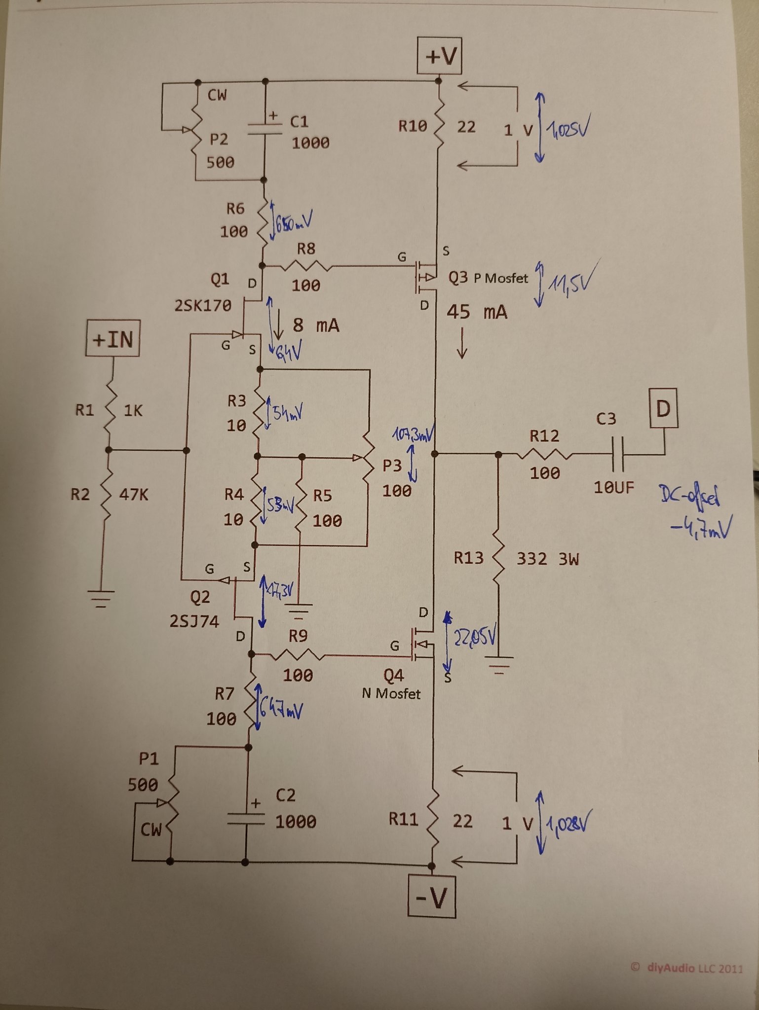

setting procedure is - observe voltage across R10 to set your desired Iq, second DVM across R13 to set as close to possible to 0mV
during setup procedure ignore measuring anything else, especially do not look at R11
start with P3 preset in mid position
again, parameters are Iq and DC Offset across R13, not symmetry of voltages across R10 and R11

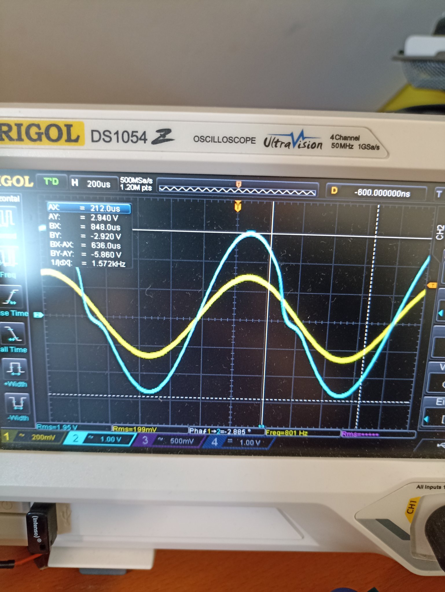

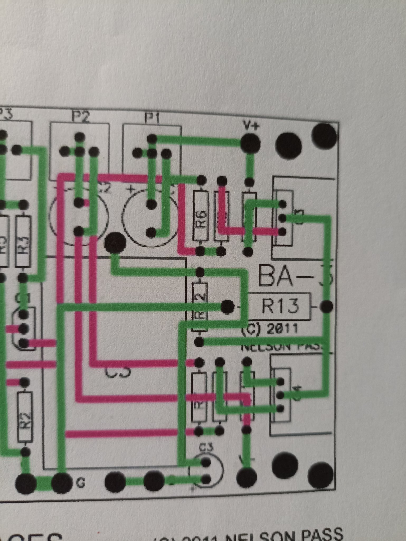

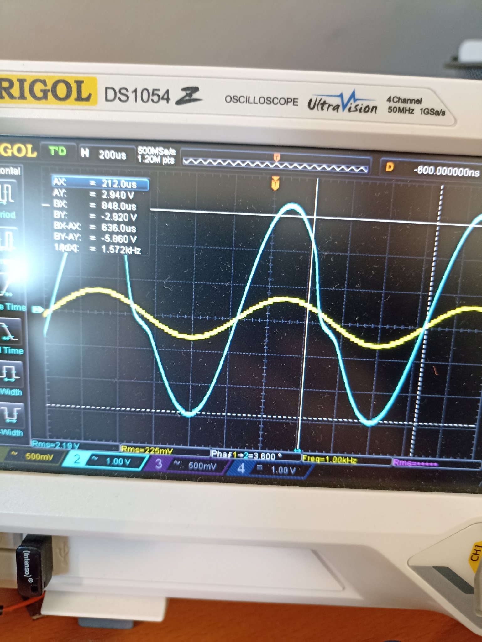

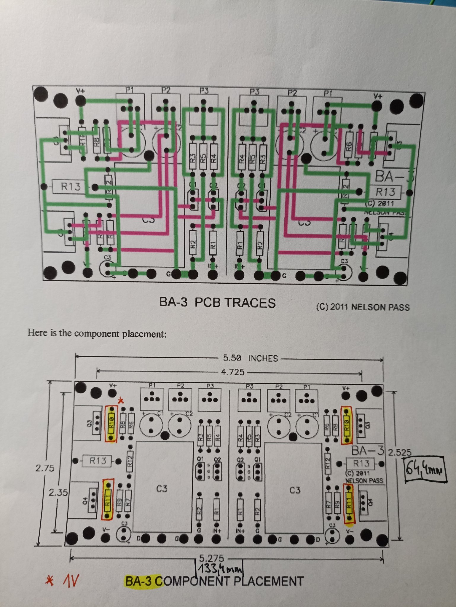

if you have problem, better not listening to it
power it off, inspect once more do you have all components with right values in right positions
if both channels are behaving same wrong, you made some systematic error
I mean - circuit is very simple per se, what's tricky (somewhat) is setting procedure, if you want to pursue some specific THD Spectra
so, usual drill - confirm proper rails, proper parts positioning, proper soldering job....
