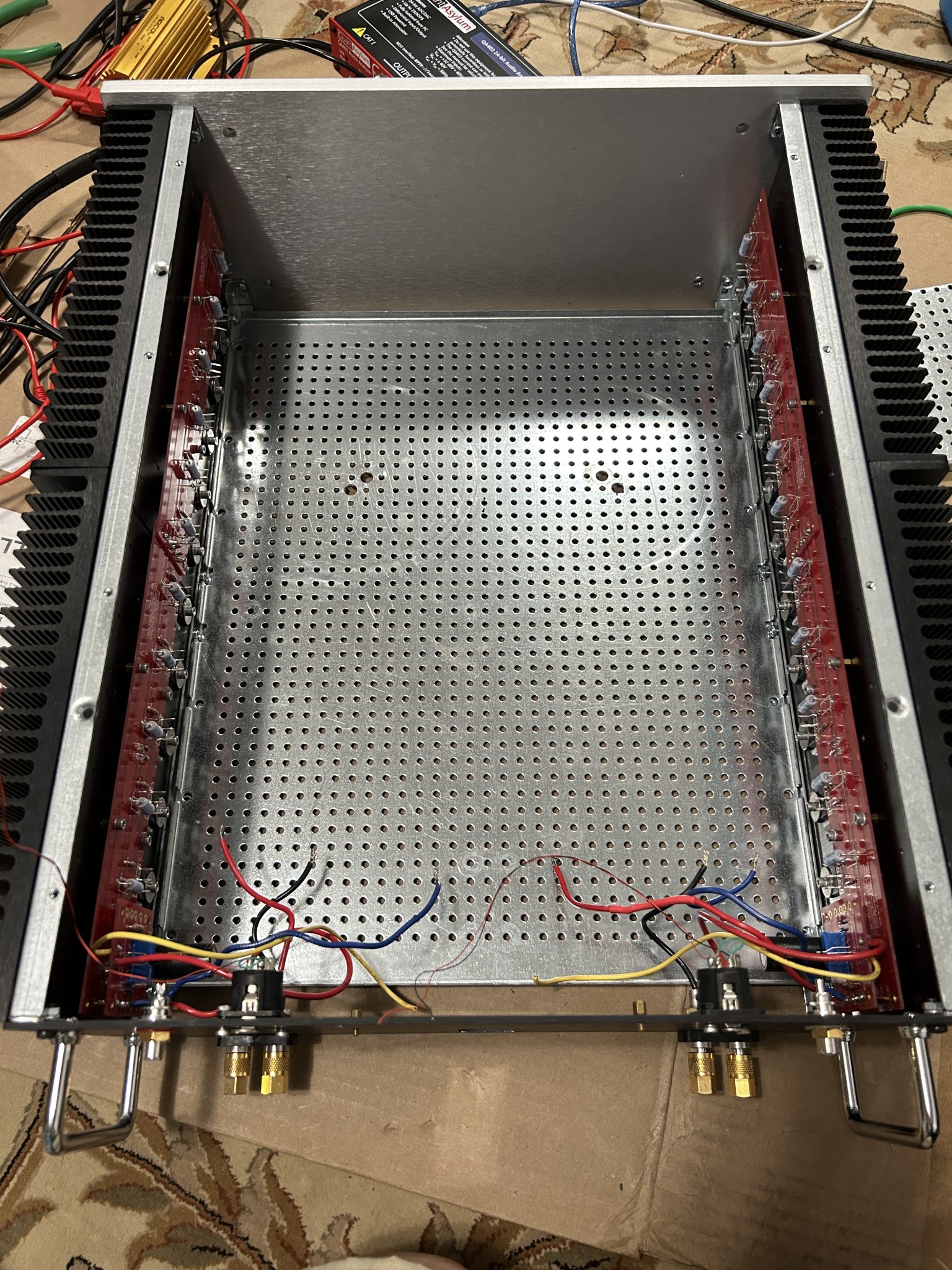

I was originally going to just 'mod' my BA-3 for use with a new power supply that I had built, but then I wanted to take it a little further. It broke my heart to disassemble it, but I think it will be 'better' when I get it how I want it. I still want to build the SE output stage.

This is the current state of the poor thing...
