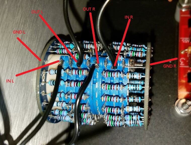

Now I'm trying to get sound out of it and I don't think I have the stepped pot right. I bought this one:
4pole 24 Step Attenuator Volume Control Pot Log A 25K 25KA Stereo Potentiometer | eBay
and it doesn't have a ground connection like the Glassware one in Jim's, and I just bypassed the ground signal wire. Do I need to connect ground to the pot?

Yes Mark, you need Input, Output (wiper on a normal pot) and GND connection for each channel. The ebay seller should be able to supply you with a drawing or photo with clearly shown connection details for each of the 6 connections for stereo operation.
What would be the 24th hole on the outer ring is clearly marked ground (GND). You could try connecting there.
You can also see the GND point on the other ring in the other photo, but it will also be wise to check the connections for input and output. A DMM will help work that out as well. One lead of the DMM on resistance scale applied to the GND point and the other lead on where you think you have the input wire should read a constant 25000 ohms, then moving that lead to the output connection and turning the shaft should then show a varying resistance from zero ohms at the minimum shaft position up to 25000 ohms at the maximum shaft position - you wont get a constant resistance reading as you switch from one position to the next due to the logarithmic affect of the resistance array.

Here you go.......
most likely as attached
in worst case , you'll need to swap IN and OUT leads
anyway , IN points are shorted to GND when switch is all the way CCW
