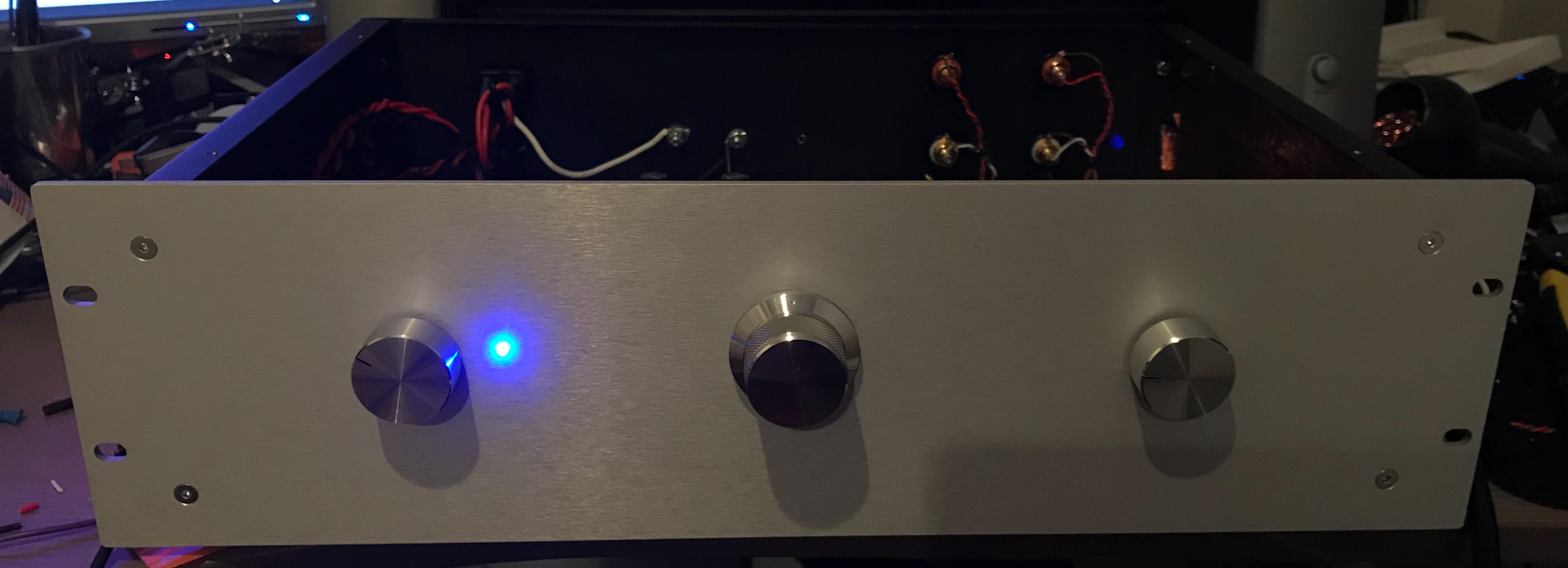

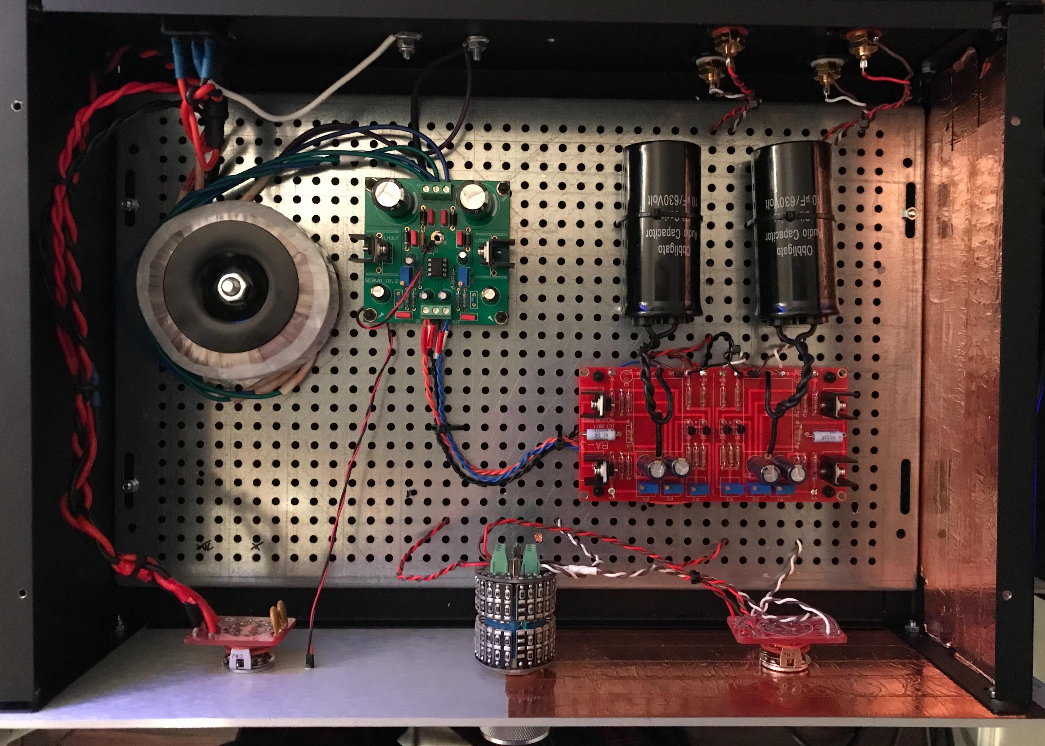

This one’s in the books. Thanks for the outstanding build guide and support throughout this thread. Won’t be able to render an opinion on sound until I build my F5 (next project) but a quick listen on some computer monitors sounded great. Biased at ~9-12mv DC offset on each channel. I’ll drive myself crazy trying to get it any closer to zero than that.
Regulated PSU is a generic 317/337. Transformer is the Antek AS-0520. 24/-24 into the amp board.
Stepped attenuator is a 10K sold by Allo. Because I was building in a Pesante 3U, C3 size wasn’t an issue. I decided to try out these giant Obbligatos, which I thought would be fun at ~$12 a pop. JFETs are LS Matched BL from the DIY Audio Store. Switches are the ones that 6L6 used in this build guide. I only need one set of inputs for this project, but I have the option of adding some more this way.

Look this🙂 Coupling Capacitor Calculator by V-Cap
Interesting, using an F5 with an input impedance of 100,000 ohms the calculator says I need an output cap at .8uf.
