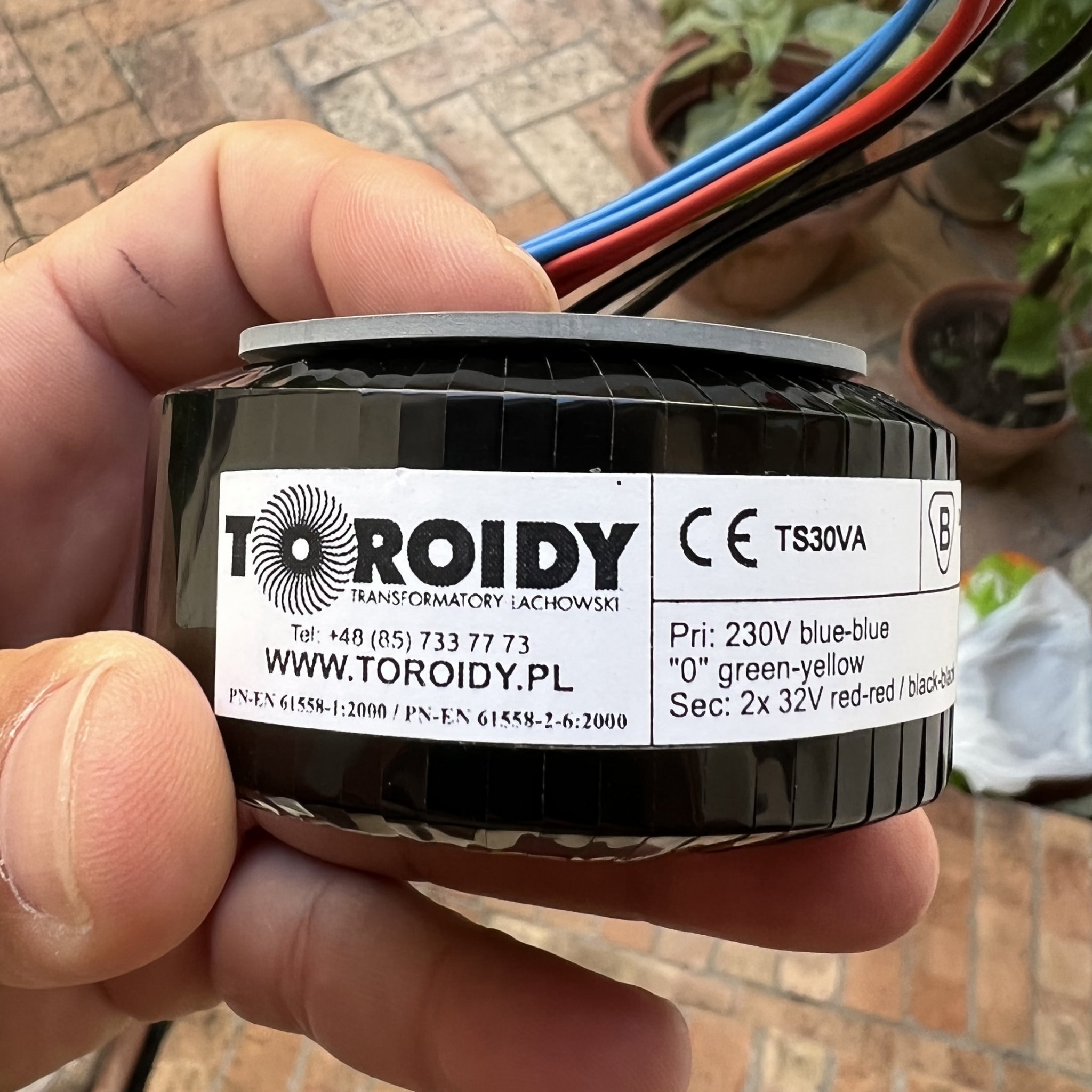

The transformers finally made it to destination, next piece of shopping the case but I think I am set there with your advise, since I have a friend coming off the US I was thinking about getting the volume pot if I can find a better deal there but still need you to advise value (50k or 100k), brand and which would better fit considering the construction (dual mono, I-select board and Sigma22 PSUs).

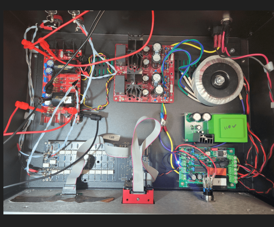

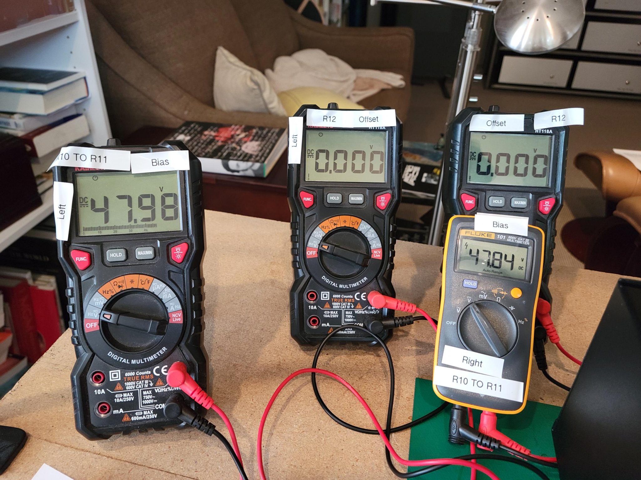

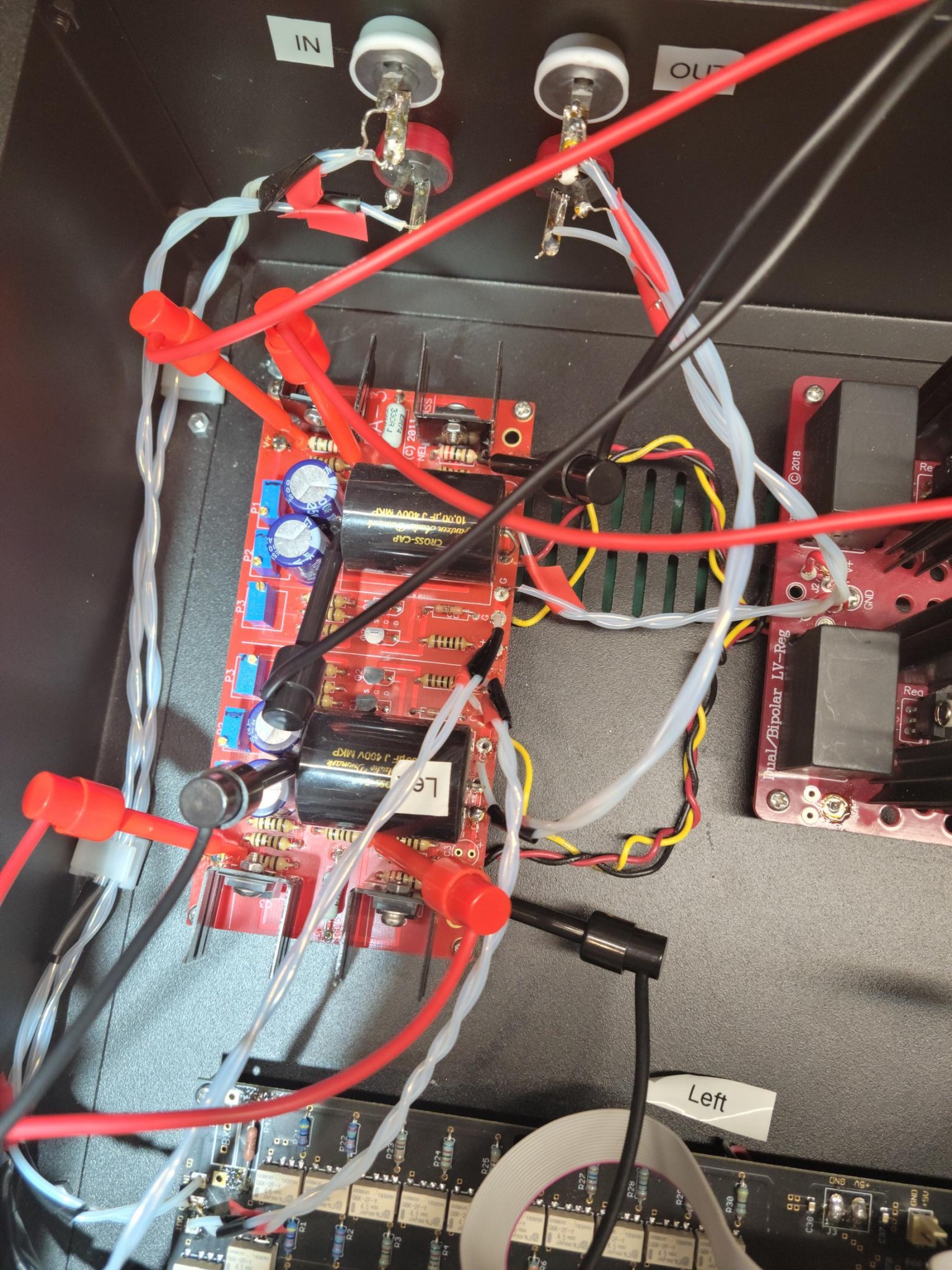

Well, this isn't good.
I have been using my 2nd BA-3 preamp for about six months.
I started to notice that the right channel was weaker than the left. Confirmed that on multiple FW amps.
I opened it up and checked the bias/offset settings for both channels.
Bias for both was 48DCV and offset was ~ 0. That's not good. Bias = 1DCV is the goal.
I unplugged and rolled back the trim pots to 0.
Took new readings and got the same results.
If I move both P1's nothing changes with the bias.
The PSU is delivering 24 DCV. + / -.
No parts looks fried, but something must be.
I appreciate any guidance.

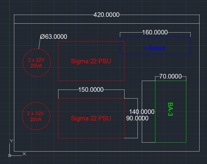

Yes I saw it, I am actually debating on the depth of the case, either 300mm or 400mm, not much of a price difference but footprint and empty space, my guess is that 2x toroids on the left side, the iSelect on the bottom, 2x Sigma22 in the middle and the BA-3 should have plenty space even within 300mm, maybe I should arrange a quick CAD prototype to find out.

So far, by a quick sketch, it seems 300mm depth won't fit it comfortably, I might have done something wrong but:
  • 2 x toroids 63mm diameter
  • 2 x Sigma22 boards 150 x 89mm
  • 1 x BA-3 board 140 x 70mm
  • 1 x I-Select board 160 x 49mm
Of course matter of laying it all out but I wonder if I should go for the extra 10cm depth case...
Move second Sigma for 90 degres and done!
