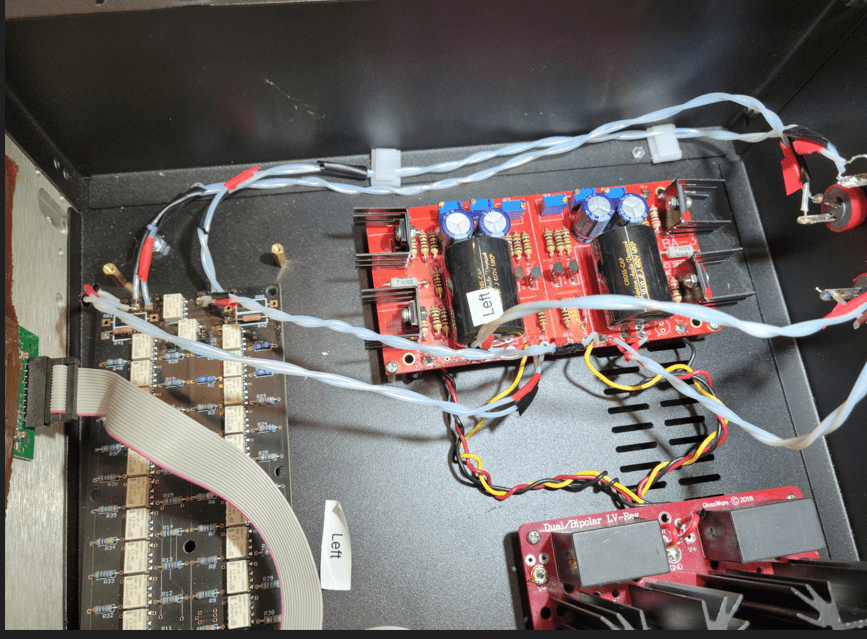

I tried playing thru a M2X amp instead of my ANK EL34 integrated amp, which has a preamp in it, and I clearly hear the weak right channel. Also hear it when I reverse the speaker connections.
My bias setting is holding., that doesn't appear to be the cause.
Something else on the amp board?
I'm wondering if my Khozmo attenuator is the source?
Issue with the Khozmo 5V PSU?
Issue on the Khozmo CB? Doesn't seem very likely.
I have a 2nd amp board built and could swap it in, but I'd appreciate all ideas, in case I'm missing something.
Thanks,
Can you flip the Khozmo channels to the ba-3? If the weak channel flips, then the Khozmos channel is weak.
Also when testing with the amplifier, switch preamp to amplifier, not flip speakers. Flipping speakers does not tell anything about the preamp. If you swap preamp interconnects to amplifier, if the weak channel follows the switch then the preamp channel is weak. If the weak channel stays, then the amplifier channel is weak.

I still hear a dominate left channel.
Guess it's not the Khozmo board.
What part(s) would fail and cause this issue?
Time to swap out the amp board for a new one?

I'm not absolutely sure what else you have done. But here are all the tests I would do:
- Swap the outputs from the preamp to the amp. So pre L goes to amp R. Leave everything else alone. If the problem swaps, then the problem is in the preamp. If not, then put that back the way it was and...
- Swap the speaker outputs from the amp. If that changes, then the problem is in the amp.
And if switching chans doesn’t help, review all your resistors - correct value in correct spot. Also, center your P3’s, and please confirm the JFETs are genuine and matched as they should.
You are not the first with this issue on a BA-3 board, though the solution escapes me right now.
Also check the interconnect between the preamp and amp. For example, if originally IC1 connects preamp left-out to amp left-in and IC2 connects preamp right-out to amp right-in then switch the interconnects so that IC1 connects preamp right-out to amp right-in and IC2 connects preamp left-out to amp left-in.
I did not change the interconnects from the pre to the amp earlier today. Duh!Also check the interconnect between the preamp and amp. For example, if originally IC1 connects preamp left-out to amp left-in and IC2 connects preamp right-out to amp right-in then switch the interconnects so that IC1 connects preamp right-out to amp right-in and IC2 connects preamp left-out to amp left-in.
I just did, and now the weaker side is on the left, not the right.
That would now suggest a problem with the Khozmo board?
Any other possibility before I reach out to Arek at Khozmo?
And thanks for all the help.

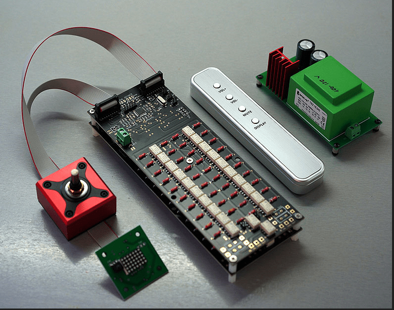

The only difference between the 2 BA's is the 2nd one with issues uses the Khozmo with remote as shown above.
The 1st BA uses a Khozmo attenuator volume control. No remote.

How about doing some measurements to isolate the component where the issue occurs? Do this just on the preamp.
Get a (stereo) sine wave, say 60Hz, close to full range if you can so the signal is fairly strong, play it through both channels. Now
measure and compare the AC voltages for both channels at every 'connection' point, starting from RCA in, volume board in,
volume board out, BA3 in, BA3 out, RCA out . Write them down and that should help you pinpoint where things go funny...

I appear to have solved my channel imbalance issue.Always up for a new challenge. I've been searching for sine wave files that I can play on my digital music player and feed into the RCA inputs on the BA.
So far, no go. I found Audacity, but that doesn't appear to be a quick on ramp for where I want to go.
I'm looking for a download of a 60Hz stereo sine wave full range in FLAC or Mp3 format.
Turns out it was a poorly installed RCA socket.
In the midst of all my surgery attempts to sort it out, I somehow intuited that was the problem.
Often it is the simplest of possibilities….My mind usually goes to the worst-case situation.
Anyway, happy ending.
