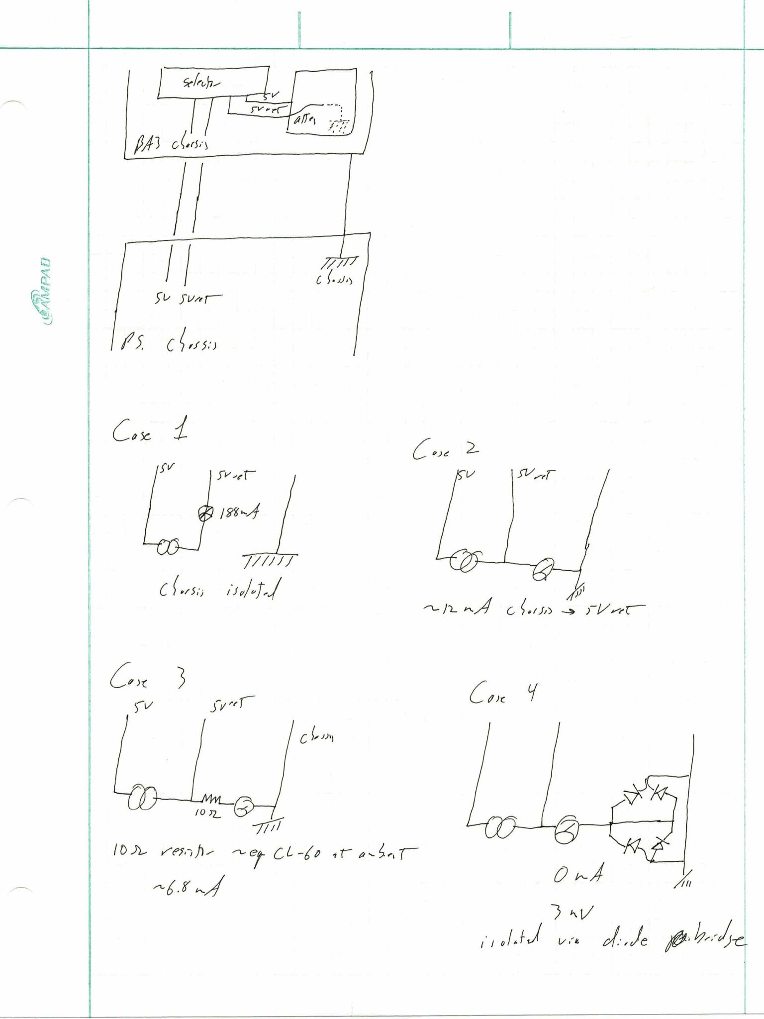

I made some measurements today. You can see a sketch of the test configuration in the attached. Current I is measured at the lab supply output.
Case 1: Isolated 5V and 5V return, I = 188mA, I(chassis) = 0
Case 2: 5V return hard connected to chassis, I = 187mA, I(chassis) = 12mA
Case 3: 5V return connected to chassis through CL-60 (~10Ohm), I = 186mA, I(chassis) = 6.8mA
Case 4: 5V return connected to chassis through diode bridge, I = 188μΑ, Ι(chassis) =0, 5V return to chassis ~3mV.
I plan on using two diode bridges, one for the selector and attenuator return to chassis and the second for the analog (BA3 and Pearl) returns to chassis. I think a few mV from 5V return to chassis will be OK, and a small price to pay for having no current return through the chassis. I did they a few things, but was not able to reduce the offset further. I also did a quick check with the scope and didn't see any egregious AC running around.

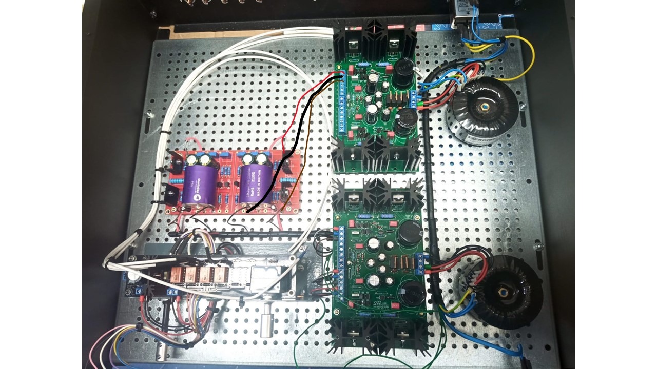

This is how my BA-3 is being assembled, the iSElect will allow for 3 switchable inputs, the builder said he'll do it all with one PSU and that's where I have my doubt as I wanted this to be a dual mono to match the dual mono build of the F4 power amp, what do you think about it?
Edit: I asked about to have twin output connections but my guy pointed correctly out that impedance would half, what would that cause in real life should I want one day to run biamp?
The picture shows two bipolar supplies, with only one connected. When everything works, you can simply connect the 2nd supply for dual mono and judge, if you can hear a difference.

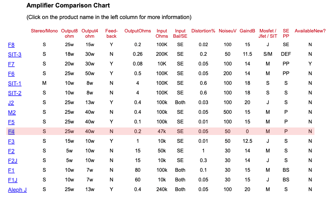

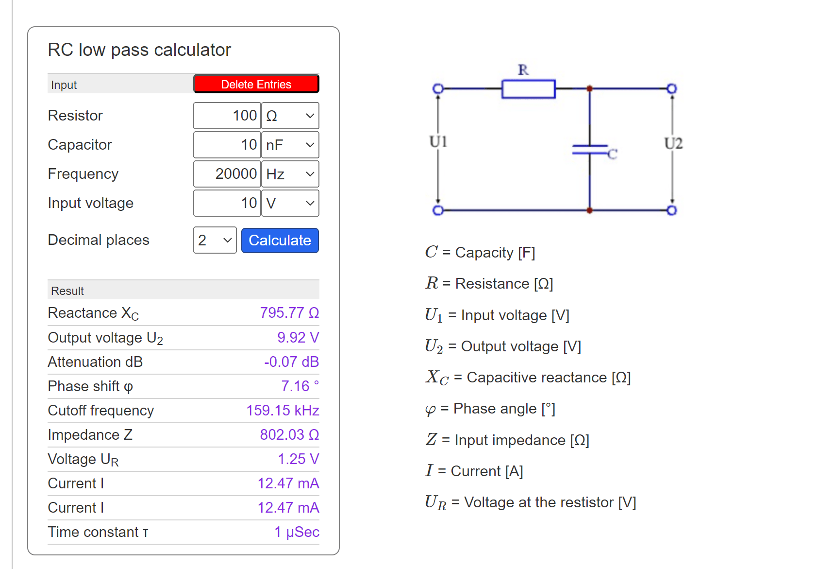

The output impedance seems to be around 100R for the BA-3, so you would have to use a really low input impedance on the amps and a really high cable capacitance to experience HF-roll off. Given a normal input impedance of above 47k on the amps and normal XLR or RCA interconnect I'd say you can easily hook up 10 amps or more in parallel. There are online calculators available that also show you if the phase shift, that comes before the roll off, would be an issue for the perfectionist. a calculator
My Aleph P with up to 2k output impedance works fine with 10 meter (admitttedly low impedance) cables into 48k.
In short: no worries hook 'em up

- and also about twin output to, some day, drive a biamp or two mono amps, impedance splitting into half, the amp am gonna use has 47K input impedance (if not wrong also the other amp I am using now, a push pull of KT88 tubes has the same input impedance), could that be a problem or is there something to implement in the preamp to smoothly use twin output?

- before it is done and tuned, what does it mean to drive the board with just (...) one PSU rather than both
Both channels left and right are fed by one PSU as shown in your picture.
For dual mono each channel has its own PSU for greater channel separation and whatnot. Since you already have both PSUs in the chassis, just ask him to hook it up in dual mono. Why pay for a V8 and only drive on 4 cylinders?
Just ask for 2 RCA or XLR outputs wired in parallel so you have the possibility to connect the amps. You could lower the output impedance of the BA-3 by changing a resistor, which I would only do, if I had to. Use a short and or low capacitance cable to hook up your power amps and be happy. Disregarding inductive effects you can have 10 nF of total cable capacitance and still only have 7° phase shift or so. A good cable has 100 pF/m or so, which allows you torun 10 times 10 meters of cable in parallel to reach that 10 nF value.

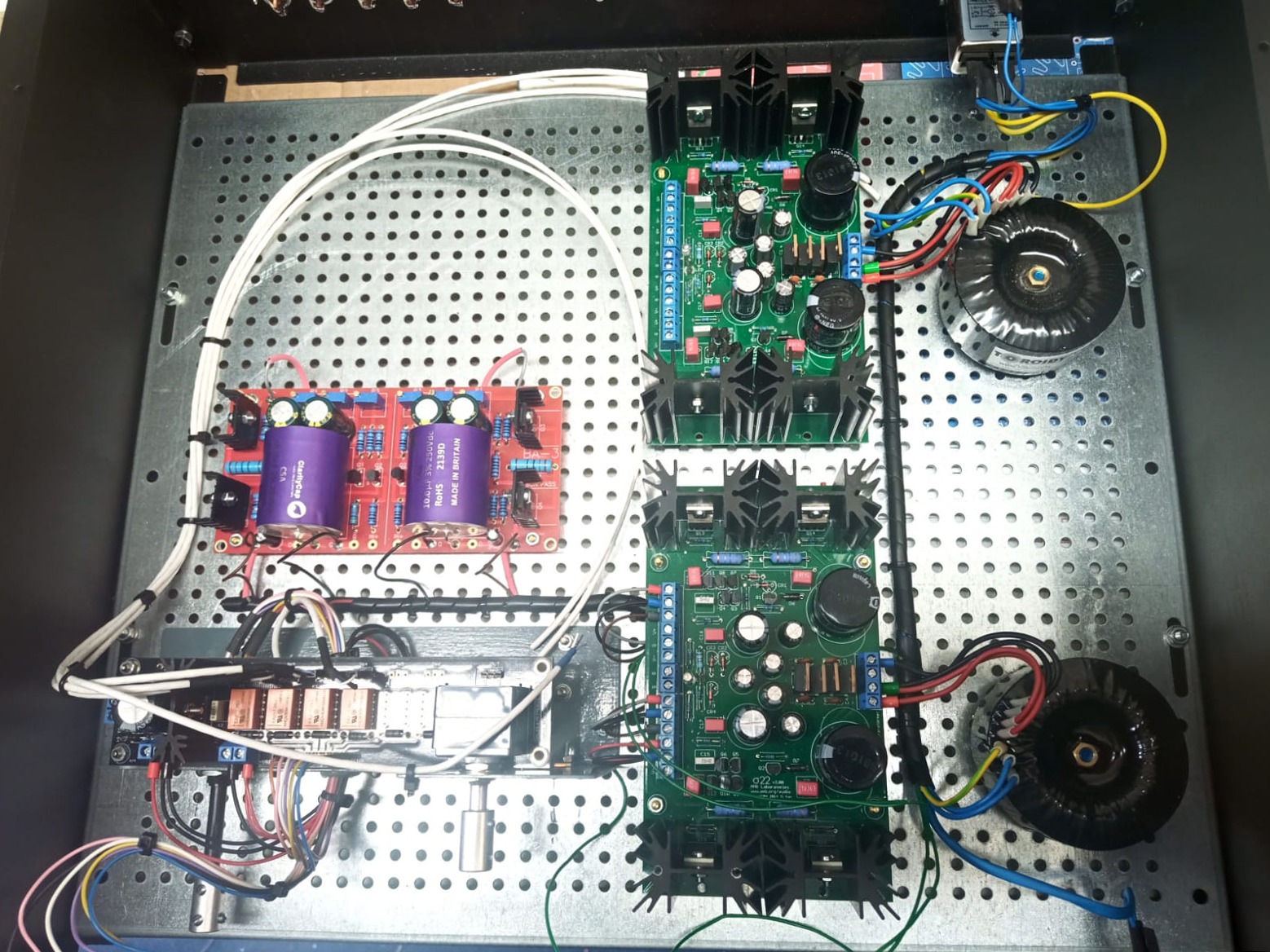

Sorry if I ask stupid questions, I am not onto the project since a while and almost forgot the whole thing so here they come the questions:
to wire the other PSU means, as by the draft, to just connect the three wires from the unused PSU to the BA-3 board as indicated in the above photo or does it take to also work on the other PSU?
In real life, if adding a second output by paralleling the RCA (balanced is not in the plans), given cables connecting the power amp(s) won't be longer than 3' or so, gonna be an issue?
Both the PSUs are wired and working, my friend told me there is enough juice to power it all with just one, I told him I want it as dual mono so next time we meet I will ask him to wire the second board and he sure knows how to do that but for my knowledge I won't mind some of you to waste a few minutes to explain what to change into wiring and what happens by using the two separate PSUs for each channel.
Grazie
You know the old saying, there are no stupid questions, but surely there are stupid answers. But I am not afraid of exposing my stupidity in public. :deerman:
Yes with the addition (which lazy me did not draw) of removing the already made connections from that channel to the old PSU. Each channel then has its own +29V Gnd and -29V and the channels can hardly influence each others supply voltages.
In my humble opinion absolutely not. You can make those cables even much longer and still be good. I have my amps close to the speakers so the interconnects are long but the speaker cables can be short as there are more issues to be had with the speaker cables and my crossovers.
