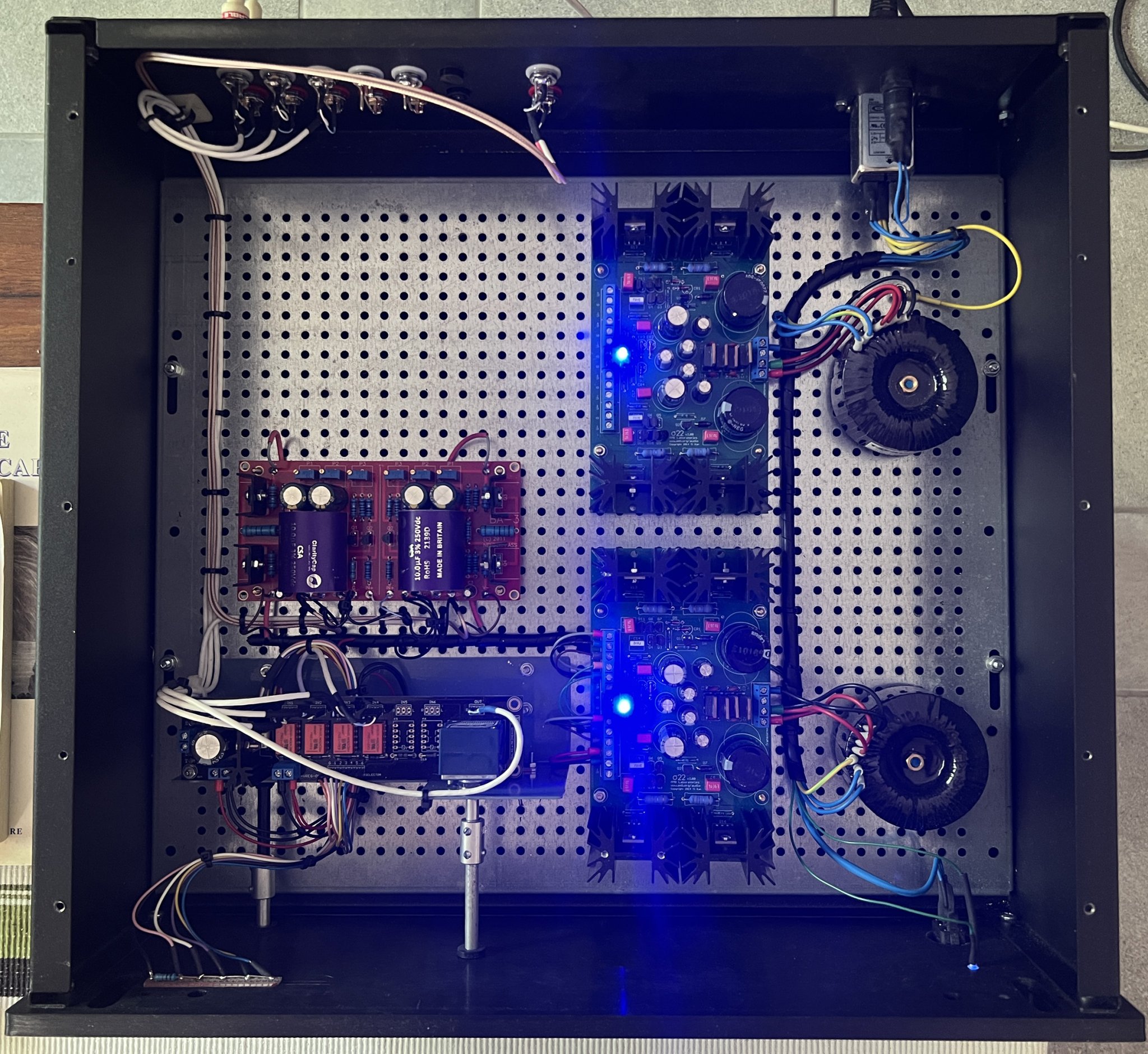

Good day, here we go again, I put the BA3 on the side waiting for the hum being addressed and using the AR SP9 in the meantime, today, encouraged by @Zen Mod and by being forcedly off of work, took a mini jack to RCA cable and output a 1Khz sine wave signal from my MacBookAir, max sound output, to my AR SP9 and then checked AC on the output to measure 4.1VAC and then same test with the BA3 and the result been a mere 4.2VAC where I expected a way bigger gain, something must be wrong with either measuring, the BA3 or both...
p.s. I have about 0.4VAC out of the MBAir sound output

A couple options:
1. Find or make a test disc with a 1kHz signal then perform the same measurement.
2. Hook it up in the system, play your favourite disc and see if full volume satisfies the ear test.
Poking around for a test disc. post in a bit with results unless someone beats me to it.
^ Note.. if your SP9MKII is the same as other SP9MKIIs ... Don't use the CD player input if you use a CD player. Make sure you keep the input constant. CD input to main output should only have 9dB of gain, which can skew results / cause more confusion than even my posts ... 😉

The schematic shows 53mA per channel. So round up to 60mA to allow for some current consumed by a regulated power supply.
I would say 20VA minimum would be conservative and even enough if you go for the +/-32V supply, and includes a few Volts dropped by a regulated power supply.
Muahaha it LIVES!
Had to rebuild with a new board; salt air near the beach absolutely destroys electronics, including my ten-year old Panasonic plasma (sniff).
I'm going to let the board cook for a bit. I'm only getting 350mV bias (across R10 only) with no offset. I've noticed that they both creep up with time, so I'll give it an hour and play some more.
