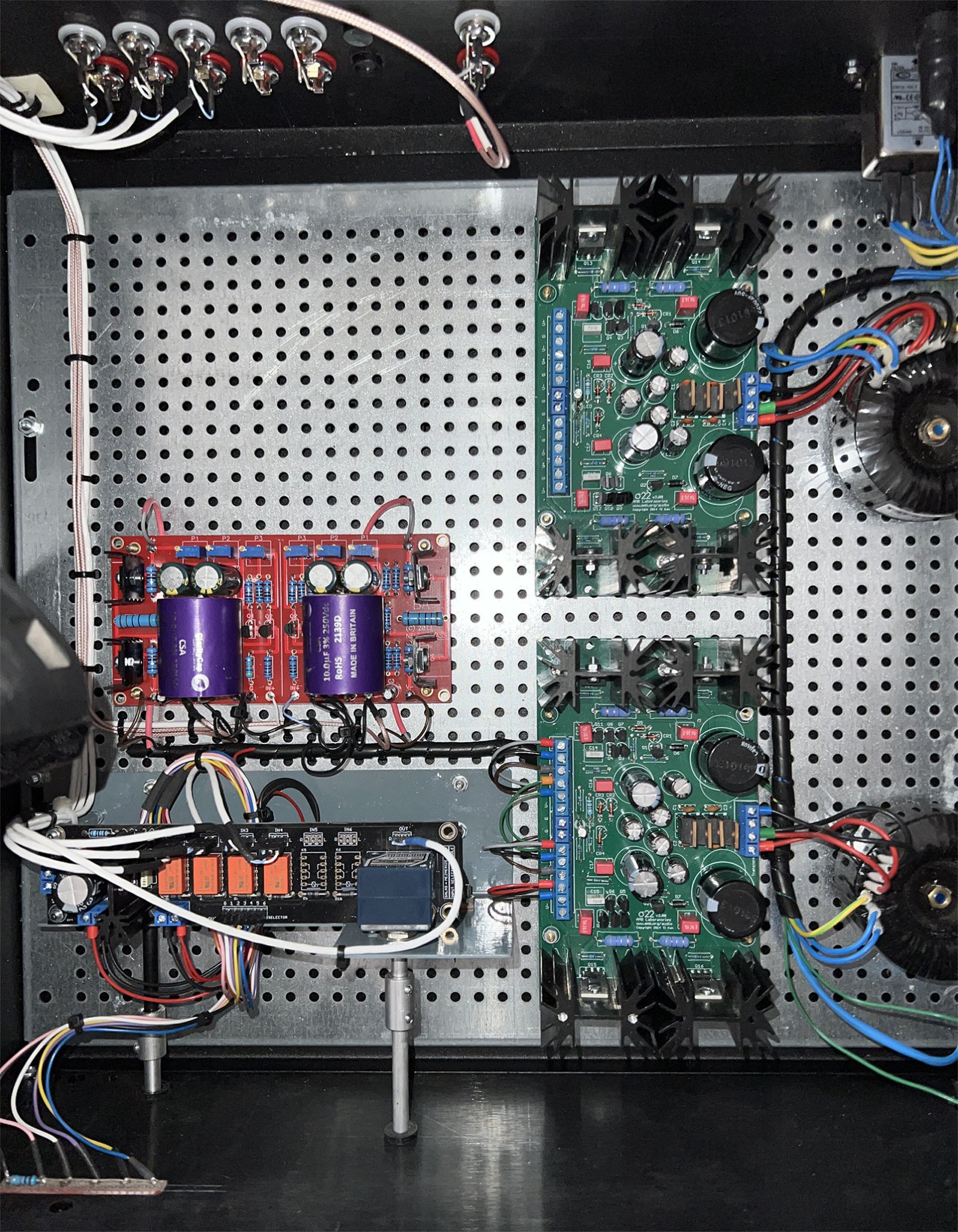

Short answer, the F4 with the SP9 doesn't hum, only the BA-3 does.
I opened it to try and disconnect the BT power supply but can't manage, it takes my friend to come and check himself but before he does I have another doubt, I asked him to hook both PSUs to the BA-3 board but he only wired one for both channels of the preamp, how does this affect output?
How difficult is it to wire the second powered but unwired PSU to the board? A few posts earlier somebody showed me which wires need to be unsoldered and which to wire but I better check twice to avoid mistakes, photo attached (if I don't forget to...)

The expert builder friend should be able to troubleshoot and fix the hum issue. "Bad out of box" sounds like a warranty claim..
Dual mono is great, I do that all the time. But not required for excellent sound quality. It's maybe 2% better, just throwing a number out. Shame not to go ahead and use the 2nd supply, it's sitting there ready to go. BUT, fix the noise problem first before you worry about the dual mono supply thing.

I‘d suggest you try to make a schematic drawing of ths set. (Make several attempts, try to make it as clear/nice as you can).
I mean it’s just me (I am a greenhorn), I admit I’m having troubles to identify the wires, and where they go…
The build btw. is very nice, although I ‚d have put the i-select near the inputs for the sake of shorter wires. But as far as I know that’s more an OCD-thing than anything technical. 😁

I wonder if the dual power supplies were connected but there was even more hum or distortion.
That's the only thing I can think for the present setup.
My own BA3 with dual power supplies in the same arrangement (different make though)
Is silent.

Good morning, I made the test with the DMM on the preamp output and measured about 4.7Vdc out, what should I expect to see considering, if I recall correct, my DAC outputs about 1.4V?
Is this what the BA-3 with 30V PSU is supposed to output?

edit: my friend asked me to remove a wire to make a test, the wire is actually connected to the iSelect switch board and I guess it also powers the BT module, the hum disappeared.
It bothers me to ask him to wire the other PSU to the BA-3 board but like that it's useless, if he has to take it back to the workshop I'd ask him to to that

You need to measure the AC voltages at the input into your BA3 preamp and at the output and compare them.
You should give the preamp back to your friend for him to fix the hum. He should make sure it does not hum before he returns it to you.
You should also ask your friend to connect the other power supply. There is no technical issue for him to not connect it. It is your preamp and if you want it to be dual mono, it should be dual mono. 🙂

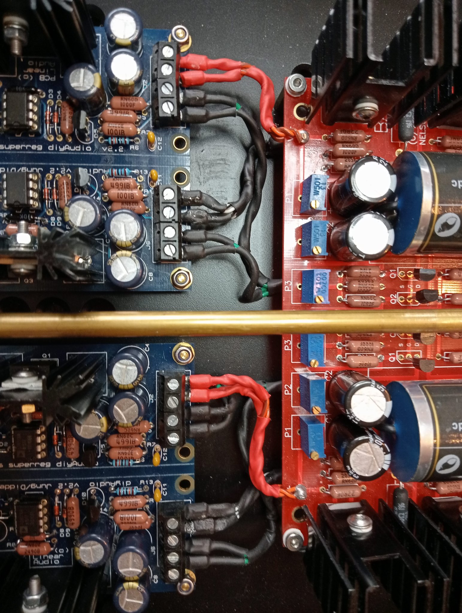

Connected DVM's, started the bias procedure and nothing !. I had 500ohm trim pots fitted (started this project a long time ago, so earlier BOM). will purchase some 1k on Monday and try again.
Hello esprit,
at 99% the value of the trimpots wil be the culprit...
Report back.
Nice dual-mono-build of the BA-3 frontend!
You will like the sound - I am pretty sure.

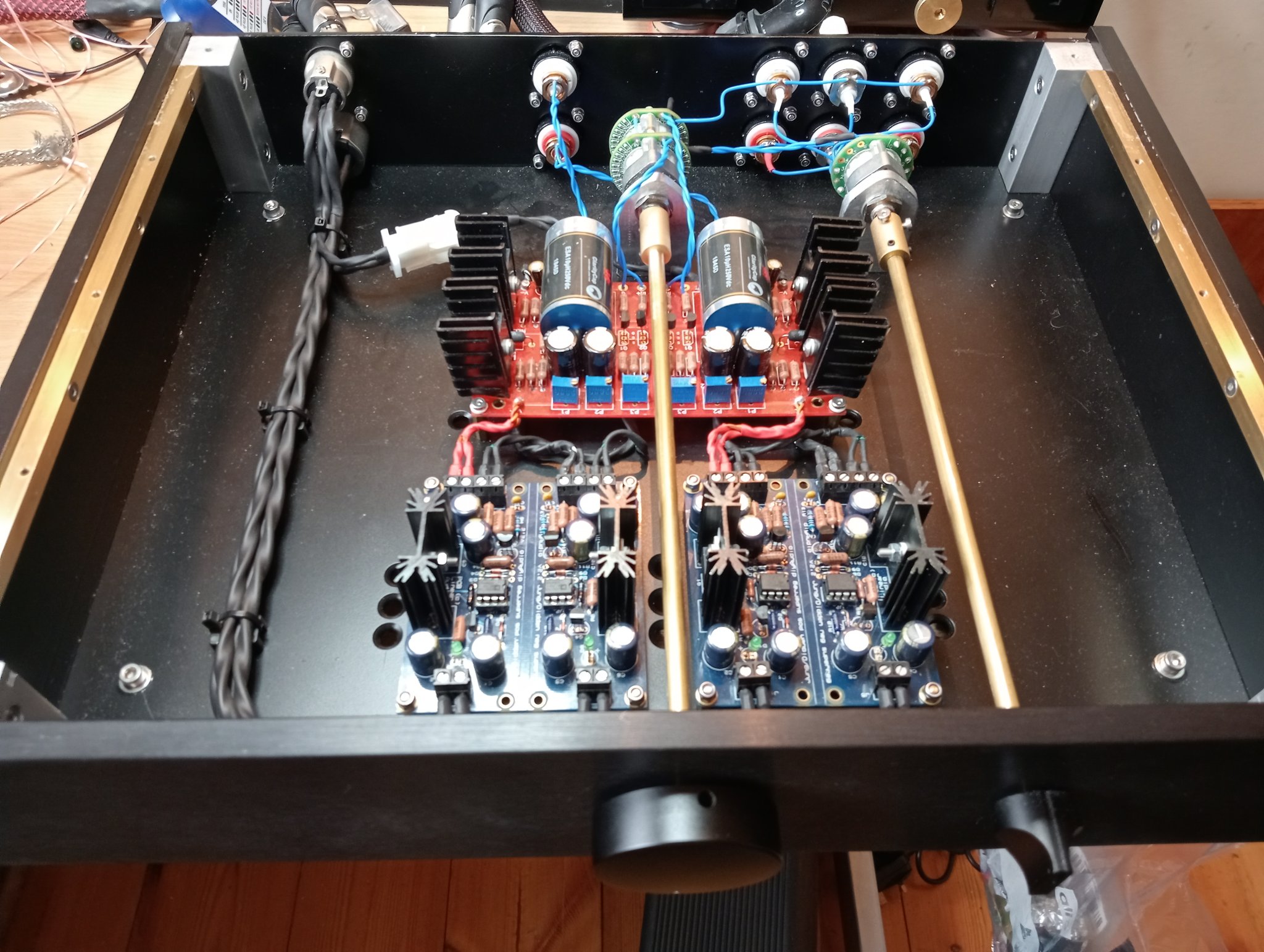

While still waiting for the BA3 being fixed I was wondering what's the purpose of such a big (and empty) case, what if in the future I get a smaller footprint one and remove the extra PSU-transformer and make it a "simple" stereo preamp and not a fancy, and as far as I understand, useless dual mono which only rips more space, I might save the transformer and PSU for another project or yet another BA3 for a second setup?
