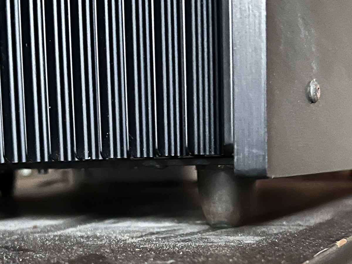

Any suggestion for some nice wide and low feet for both the preamp and the already made F4 whose rubber feet I don't like at all?

https://www.audiogears.it/category.php~idx~~~55~~FEET+AND+SPIKES~.htmlAny suggestion for some nice wide and low feet
Be aware that the lower the chassis is, the less airflow you get…
(Could be an issue with f4)
There will be no issue with your F4 as long as your sinks are still as benignely tempered as before.I understand sitting low can limit air flow but the feet it came with are no Tour Eiffel either and they look plain ugly... View attachment 1088828
