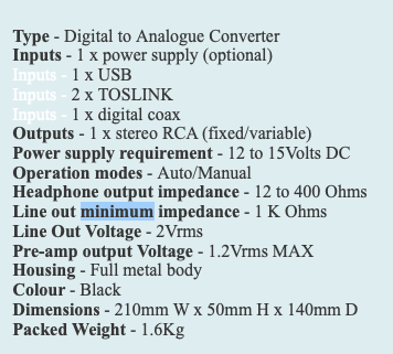

I used 50K in mine, but the lower the value the lower the input noise, so people often use 10K.
It also depends on your source output impedance. The ratio should be at least 1:10, but better 1:100.

Uhm, this is out of my (very) limited knowledge, the BA-3 would feed a FW F4 and as main source a DAC (cheapo Beresford to begin with whose output impedance should be as per attached screenshot:

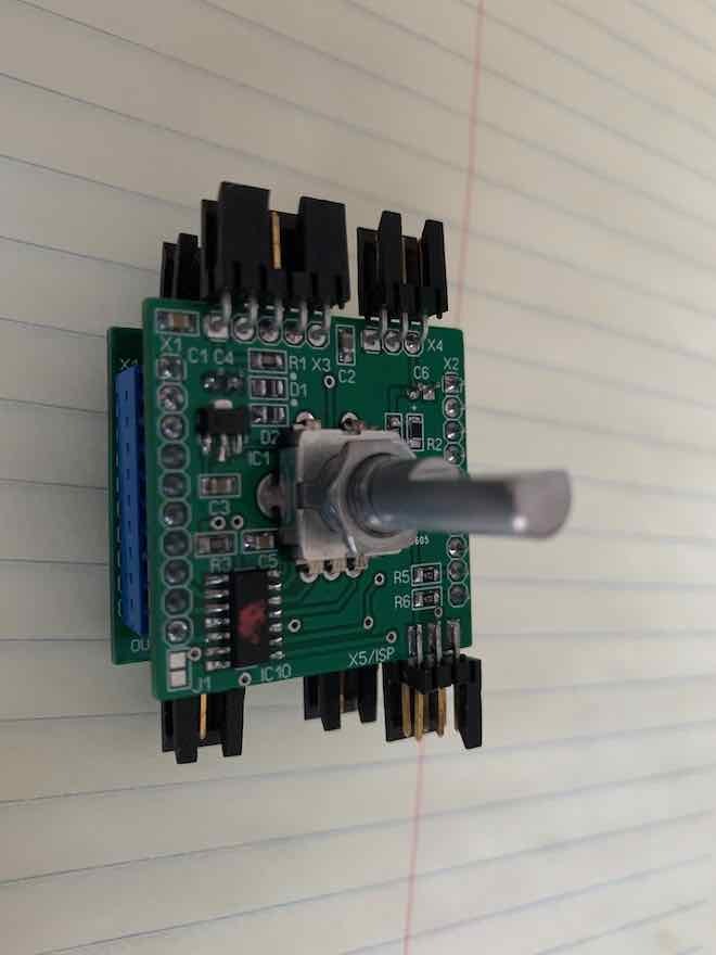

They sound good for the price and It fits right onto the I-select. I just installed an I-select in my preamp. My objective in going was to take an advantage of the somewhat sealed relays etc. I skipped using the connectors on the inputs and outputs as I didn't want a mechanical connection in the signal path that could get dirty. I used double pole switches before and they didn't take long to start giving me trouble. I need to look into the crimping tool for those little connectors on the I-select though for the channel selector control. Right now I just have input 1 jumped.

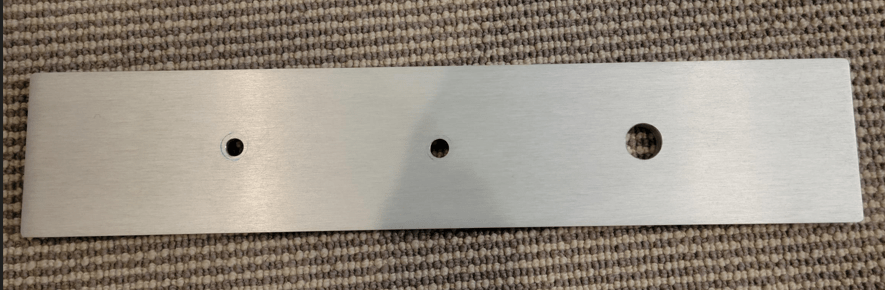

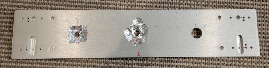

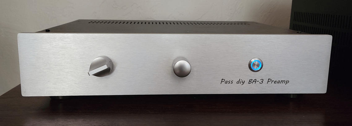

I have a 3U aluminum faceplate to offer for $10.00 to cover shipping.
There are 3 holes left to right: 9.6MM, 10MM and 19MM.
The back side is not pretty but both the selector and Khozmo volume pot were securely fit to my crude aluminum shaping work.
Having learned my lesson, I had a local machine shop do the final panel.
Send me a PM if interested.

under condition that Rin of following stage is higher enough than resulting Rout of pot itself, then value of pot is having nothing with following stage and having everything with Rout of sources (preceding stages)
in ideal world ratio of Rout to following Rin is 100*
in less ideal world 50* is good and 20* is still OK, if Rout is bellow 100R
