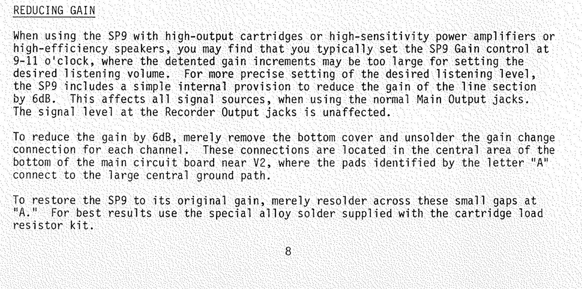

Question being, the FW F4 finally made it home, it's an amazing build, it's huge but... there is a BIG BUT, the output level is low, 25W not enough for my JBL L220, I read my Audio Research SP9 delivers 21db to the output and the volume knob all the way to the max still feels "poor", would the extra gain of driving the BA-3 with 30+ volts give it some punch???

disconnect RCA cable from preamp output, so no power amp involved
play 0db (digital level) sine wave 1KHz, set preamp at full volume, measure at preamp output wit DVM set to Vac

I unplugged the power amp, removed the preamp, waiting for it to become operative, will feed it a 1Khz sine wave in mp3 and measure DC with a DVM on an output channel, let me see... we are in the 0,00x realm, I must be doing something wrong
Output level is very low. Was your preamp set at full volume? Was your digital signal 0dB?
0dB signal in is 1V. SP9 with 21dB gain is 11.2x so output should be 11.2V.
The F4 has no gain. Needs to be fed by a preamp capable of swinging voltage.
"Virtually all active line stages achieve adequate gain and voltage swing to drive the above combination. Basically you need a linestage with about 12+ dB gain and 10+ volt maximum output."

Reading the owner's manual, there appears to be a 6dB cut option internal to the preamp.
Page 8. Requires soldering.
Wonder if someone exercised that option.
https://audioresearch.com/wp-content/uploads/2021/08/SP9_Manual.pdf

Almost, you should measure ac not dcp.s. to measure DAC output I use the same routine, play the 1Khz tune and measure DC output?
Ok, now you gotta tell me how did you get there, an AR aficionado, you own one...? You guys never end to positively surprise me, I am amazed at knowledge and patience.
I switched from the SP9 to the GFP345 and this latter one has a little more gain, playing music from the laptop to the pre straight away as to eliminate a source of doubt, playing youtube and I am quite amazed at detail of this thing.
So if I get it right the SP9 is set by default with a 6db limiter on all the outputs besides the tape outs, have to remove the bottom plate and figure it out then ask a skilled friend to do it for me.
