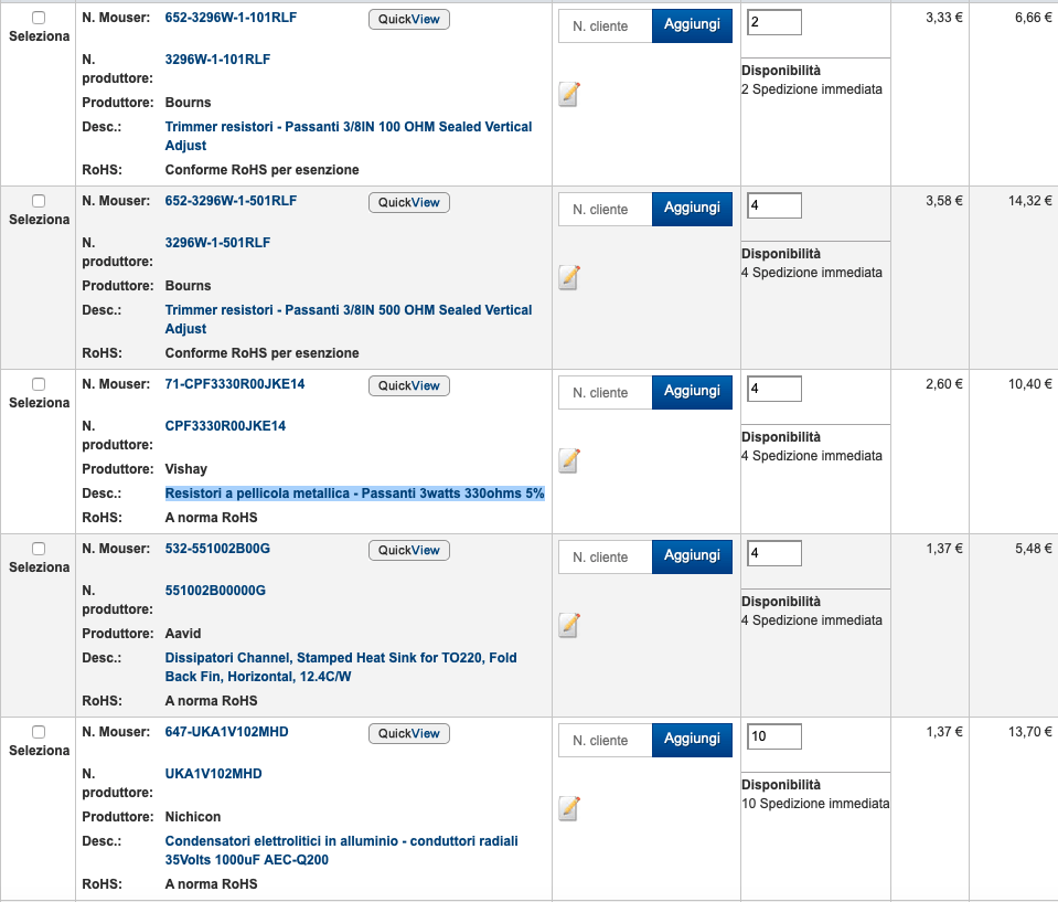

Very clear Andy, not a deal breaker to go from 35V to 50V, will add these to the BOM and thank you for also clarifying about C3 🙌50v is safer than 35. people here use different margins. I use 25v for a 24v PSU, and guess I am assessed an idiot for doing so. I also used 25v ones in my BA-3 with 32v rails, without blowups. But probably quite unwise.
Voltage for big C3’s is nothing to worry about. They are all immensely overrated.
the small C3 pads are there if you choose to use small caps instead of biguns, for example Silmics. Papa sez you can populate with both big and small ones at the same time, but this may affect low end rollof so I guess that means some calculations are needed.
if using small ones instead of biguns, some bypass these with film caps in the big caps position. 6L6 did this in the BA-3 poweramp build guide.
Edit, unfortunately noting in 50V flavour available, wait to hear about staying safe with 35V or look elsewhere for 50V ones
Giovanni look this https://www.nichiconcapacitors.com/...ree=50v&submitcustom=Search&post_type=productVery clear Andy, not a deal breaker to go from 35V to 50V, will add these to the BOM and thank you for also clarifying about C3 🙌
@Gricko unfortunately, at least on the Italian Mouser, 50VDC ones are due to be stocked in quite a while, 35VDC are available but not too many of them so I rather go for 35VDC ones and have all the parts to then eventually upgrade when time for welding comes, thanks for pointing them out.

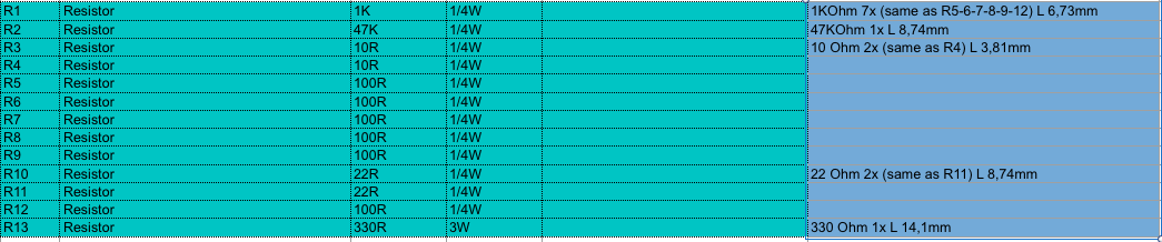

I went through the BA-3 BOM and the one I arranged onto Mouser, let's go through it again and sorry for ripping so much space and time for these basic issues; I did measure the space resistors take on the board, hole to hole about 13mm except R13 which allows 20mm, I pulled down the measures of the ones I picked on Mouser:
R1 1x 6,73mm
R2 1x 8,74mm
R3-4 2x 3,81mm (!!!)
R5-6-7-8-9-12 6x ??? isn't the same as R1? I got confused as on the BOM is either indicated 1K value or 100R one...
R10-11 2x 8,74mm
R13 1x 14,1mm
All the Resistors in my BOM are Vishay and 1% tolerance besides R13, what did I do wrong?

There's nothing wrong with the parts you have chosen. There are simply a lot of variations in part sizes.
If you want a pick a uniform series to use, you might consider the Vishay CMF55 or RN55 resistors. I like them because the values are printed on the parts as opposed to the use of colour code.

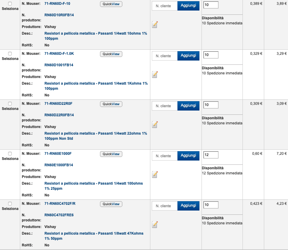

Ok I made a mess with values, series, sizes...
This is the updated BOM, all resistors should be correct now, Vishay RN series, 1% tolerance for them all besides the 330 Ohm, all same 8,74mm size, please give it another check and hopefully I can move on with this

Grazie Patrick,@Giovanni1968The printed values make things much easier to troubleshoot should the need arise. Be sure to install them with the values visible if you choose these. As Dennis noted, there are a few different types in the BoM I sent you. That's just what I happened to have in my stash and/or were in stock at the supplier when I bought them. They all fit nicely. I built 4 with those parts, and they all happily sing. It would be more uniform to choose only one style, but I'm not that picky.
I used CMF vs. RN in my latest build. If you're looking for substitutes, the only ones I would avoid are the 0.1% tolerance parts, if only because they are much more expensive and not needed. As Dennis mentioned earlier any 1% parts are just fine. No need to over-think it.
I did a recheck and hopefully done with BA3 BOM besides C3, all resistors from Vishay and RN series which should comfortably fit, will get a few more than necessary even tho the friend who's gonna help me put it all together has tons of stuff, better a couple more than one less...
I didn't check all the values against the schematic. I assume you've done that correctly. The only thing that jumped out to me was that your 47K resistor is a 0.1% part. Check the cost against the 1% part and make your choice. Saves you a few pennies if you go with the 1%.
71-RN60C4702F/R is a good example. There's at least one more, but it's showing very low stock on my end.

This is the shopping cart, as suggested to buy ten is slightly more expensive than even 4 per part
Way too cheapWhat about the jewellery now, would these be a good choice for C3?
otherwise OK.
I think they will just about fit. But you should measure the boards /C3 position first, to be sure. Some use oversized caps. I prefer some that actually fit 🙂
