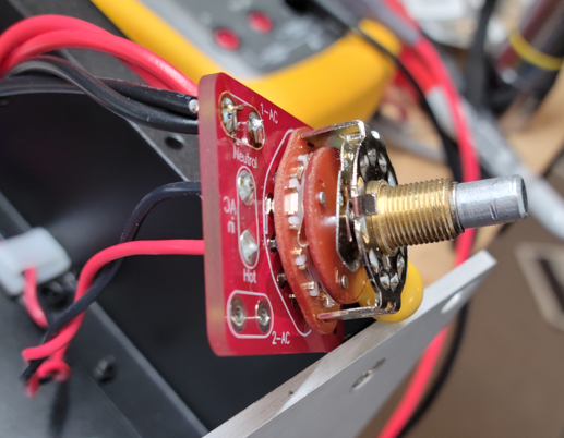

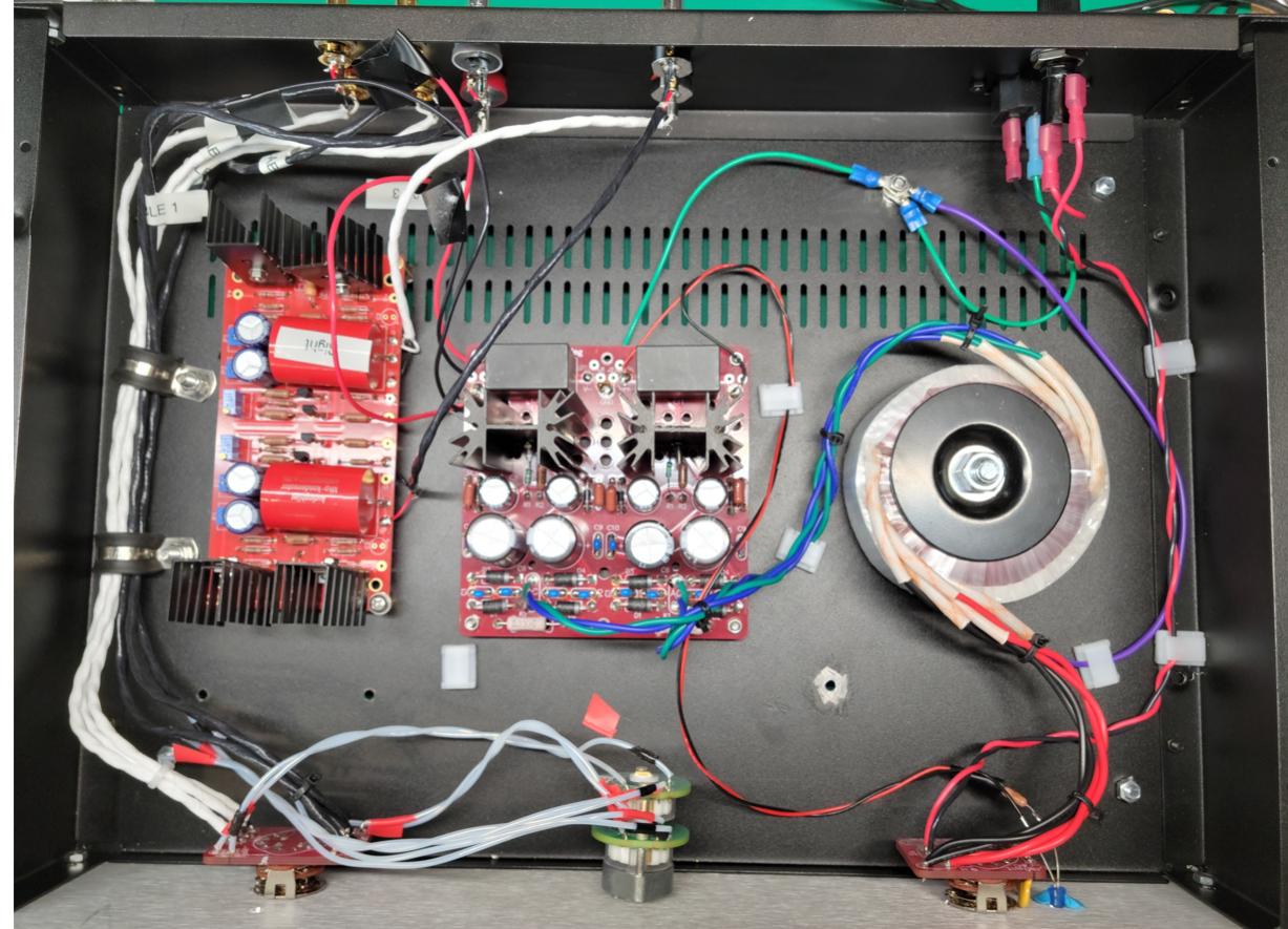

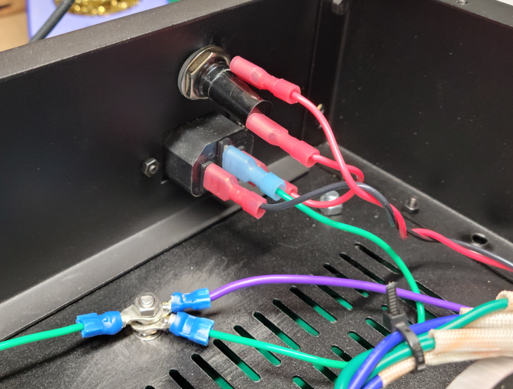

I was doing my first dim bulb test. With everything on, the bulb never brightened, but the back of the switch started smoking pretty good. Whew, that is an acrid smell.
Appreciate any help on sorting this out.

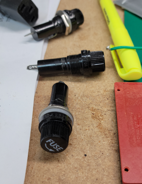

Using a F1AL250V 6X30MM 1A Fast Blow Fuse 1 Amp 250V F1AL Glass. The fuse did not blow.

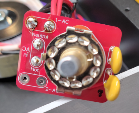

You have a short in your switch.
Measure resistance between AC positive and neutral solder joint on the switch, and I think you will find your culprit.
Edit: I would think you have a short in/at the switch. The board traces are unknown to me, but I think you’ll solve it through a bit of troubleshooting ivo the switch.

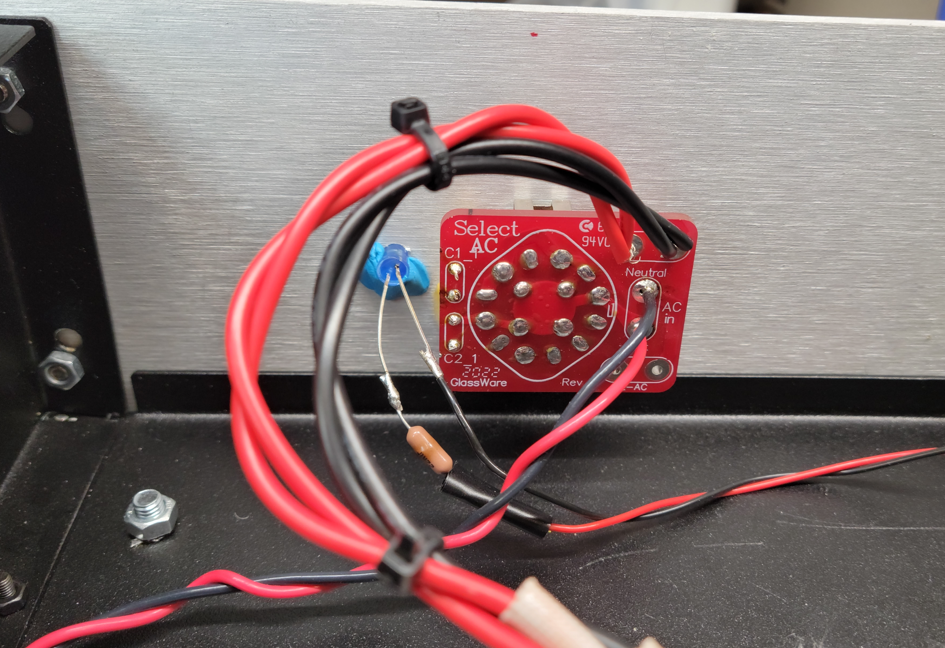

I use the same switch. Here is my connection. I use a wire terminal block to terminate transformer leads to than run single wires to switch.
Not disagreeing with Andy, but with a short at the mains switch (or neutral directly shorted to hot either from your IEC or on the transformer primaries), the fuse likely would have blown, and/or your bulb likely would have glowed brightly.

Beep test (power off) from IEC through to the transformer primaries with the switch in all 3 positions. I can't be sure, but my guess is that you also only need one of those caps on the switch board. Doubtful that it'll hurt anything having the 2nd, but just mentioning.
With what I'm using now it's hard to see your wiring, but I think I see the secondaries hooked to your PSU board, but no V+ / V- connections to your BA-3 board, correct?
If so, if your beep testing goes well / matches the schematic, and if you have a Variac (or similar) you can slowly ramp up the mains AC voltage while measuring the voltage at the secondaries. You can do it with the DBT in place.
If you don't have a Variac, I'd disconnect the PSU from the secondaries. Then check AC voltage at the secondaries. If you get past that, then put them back.

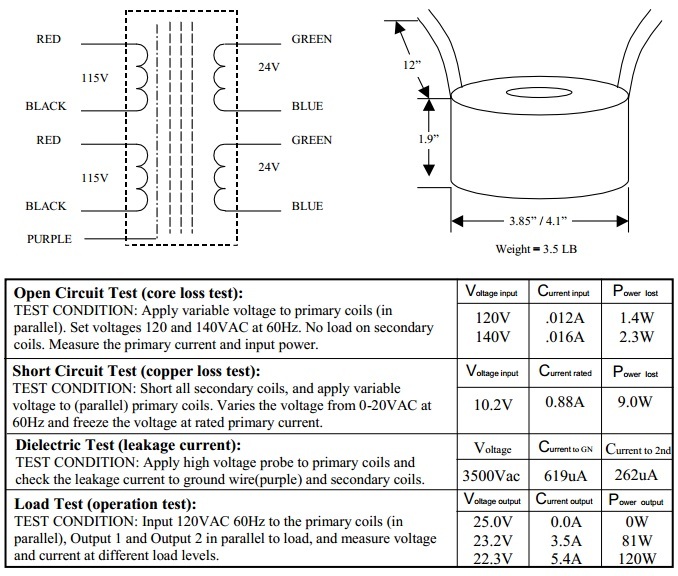

The switch is rated for 120VAC and 0A6, so if you use a ~60W bulb (or less) in your DBT, you likely won't melt your switch even if you mis-beeped and do actually have a short in your switch. I typically use a 20W bulb or even a little candle shaped 5W bulb for a quick heart-saving DBT check on a PSU with no load.
I don't know the current draw under normal operation or the VA of the transformer you're using, but a 1A fuse seems too high to me for this circuit... again, not root cause, but just mentioning.

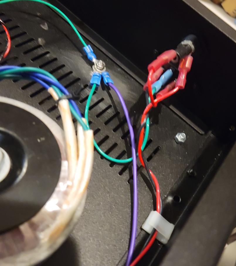

I don't quite follow what you are describing, even with the photo. I don't see your terminal block in the photo. I think you are saying you use a block to run both red or black leads to combine and have just one wire connect to the switch?

re: fuse values. I don't know the actual expected current draw of the circuit (I just suspect that it's well below 1A). Also the transformer doesn't look power-amp huge based on relative size, so...
You can read back in the thread to find the expected current draw or use the transformer VA / Mains voltage rule of thumb. I go with the highest, and pick the closest fuse value.

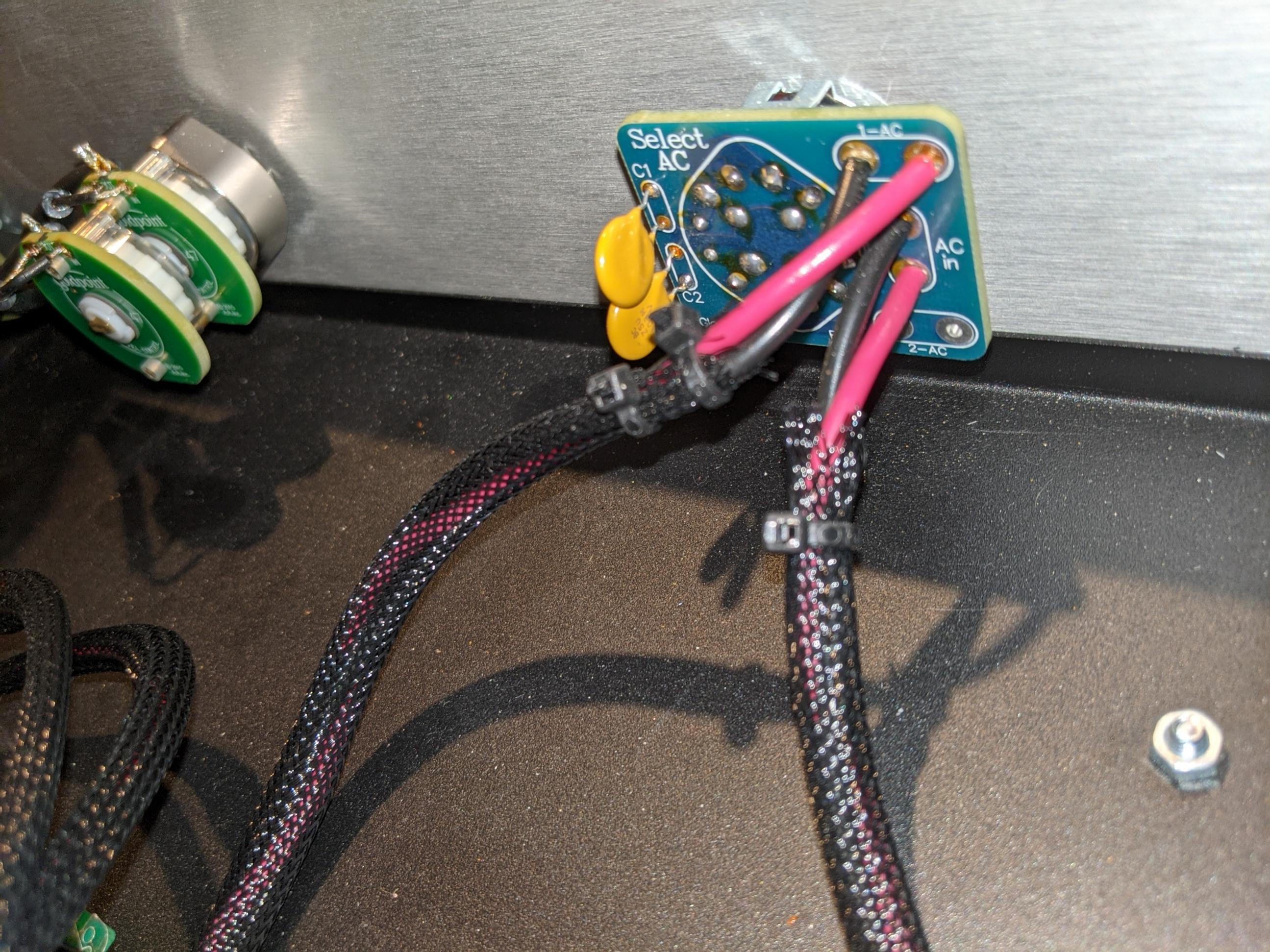

I read OL when testing the switch at input and output with no power and testing the 3 switch positions.
I was using a 100W bulb. Now will use a 25W.

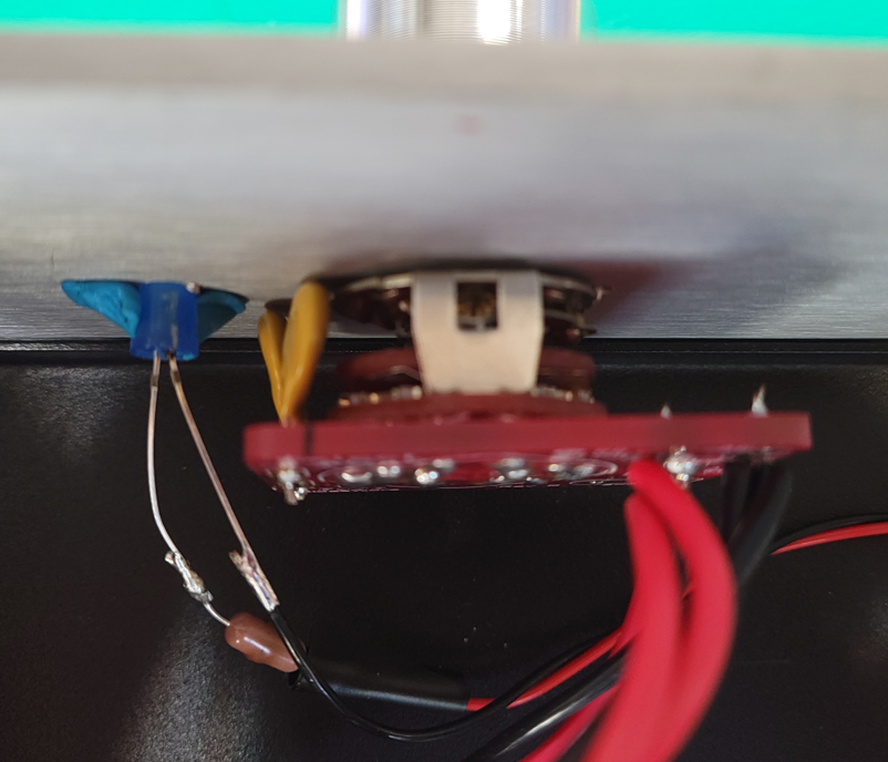

The photos suggest the switch didn't short, but I saw the smoke coming from it yesterday, which gives me pause.
I guess I can try a new DBT with the 25W and be ready to turn it off if it smokes?

I went with the AC switch from Glassware as I had seen other's use it.

The Glassware Audio switch I used is rated: offers a 125Vac and 0.6A rating.
So doesn't look like a good choice for a mains switch.
I have enormous respect for Broskie's work and brain, but that switch used for mains is simply dangerous
