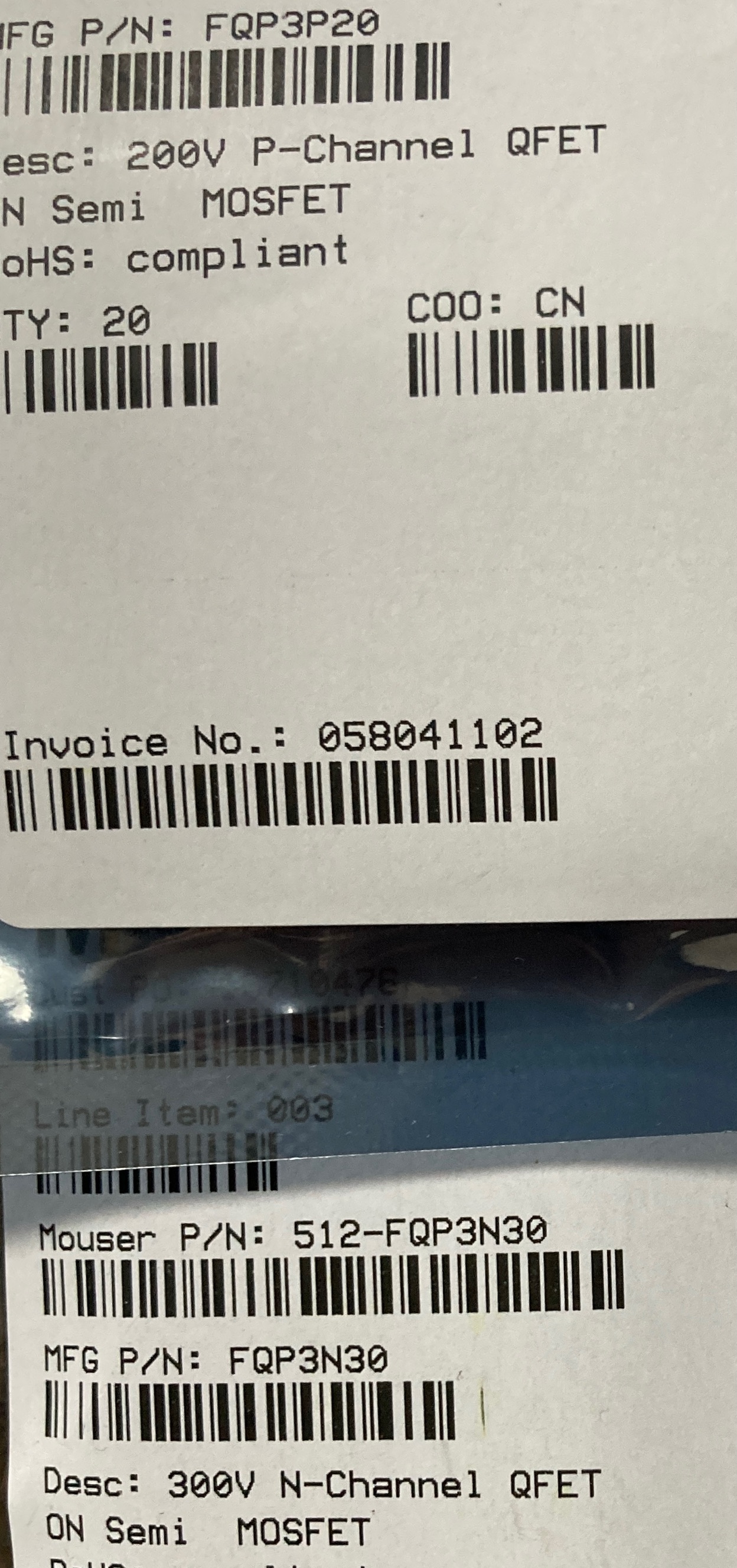

Good day, Plott
Here’s what I could offer:
On semi FQP3P20 / FQP3N30…
How many would you need?
(In exchange, I would be very grateful for a d esscription / illustration of how to set up a matching jig… the various schematics, as simple as they are, do invoke a vogel-strauss-effekt (ostrich’s-reflex))
You can try the setup in Fig 12 here: https://firstwatt.com/pdf/art_matching.pdf
With R1=220R, you get about 50mA.
Note that matching is not a requirement since you aren't running the mosfets in
parallel. That said, a simple Vgs measurement ensures the parts are operational
and you might pick pairs to use in the two channels.

Thanks Dennis!
Lazy as I am, I was hoping for a pic to copy. Schematics… kinda scare me. Yes I see it is dead-simple
And I took on these to match for doing my first step into these realms, knowing that it’s not crucial (not even important)…

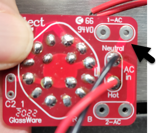

Ok. I've worked my way thru forum, made some progress pulling things together.
I've mapped out the wiring for power and I'm hoping I have it sorted correctly.
Appreciate a review and comments.
Do I have Hot selected correctly?
I chose left as negative from in is linked to the right solder point.
Chiptech,
It is not positive or negative. These are AC connections, so it is hot or neutral. The incoming AC is connected to where you currently have the wires soldered in your picture. The primaries for the power transfer is wired to each of the two AC-1 and AC-2. If your power transformer only has one primary than you just need to wire it to either AC-1 or AC-2.
