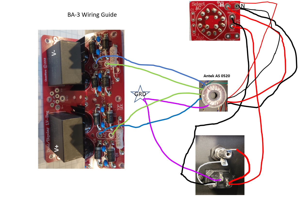

I am not familiar with the boards so I cannot comment on their connections.

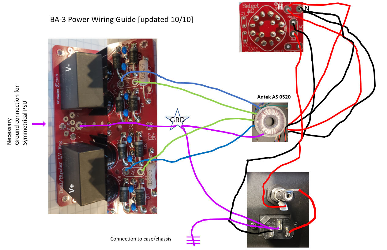

However your fuse is wired incorrectly. You have it parallel to the AC. It should be in series.
Wire should be from hot pin of AC socket to end of fuse holder. Then another wire from side pin of fuse holder to AC power switch. No part of the fuse should be connected to the neutral pin of the AC socket.

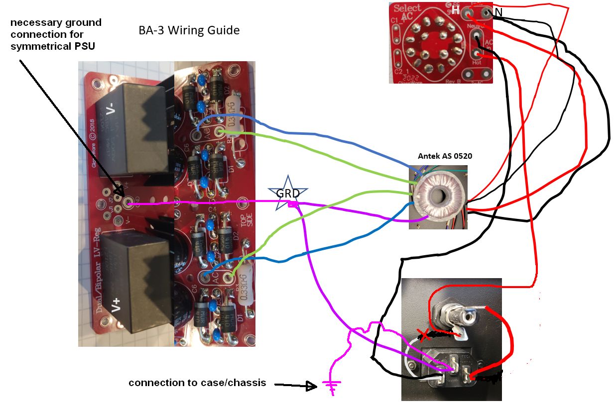

to Chiptech #2202
Hello Chiptech;
i made some corrections:
-always conect Earth in to your chassis/case of the amp!
-in your drawing hot and neutral at the AC-inlet are connected over the fuse - don't do that please!
-your hot at the AC-inlet should go to the fuse and from the other contact at the fuseholder to the AC-switch
-you also need a contact from the ground of your symmetrical PSU to your star ground/ earthground
This is what I saw immediately. Perhaps others can chime in and throw a second or third pair of eyes on it.
Cheers
Dirk

Ben,
Thanks for the clarification/correction. This is the first time I've used a separate fuse and though I searched for explanations, I was unable to unravel it myself. But I did try.

Dirk,
Thanks very much for the corrections. I have undated my chart. You indicate that I need two places where I ground to the chassis - I'm not clear on that?
thanks,
Better to be safe.

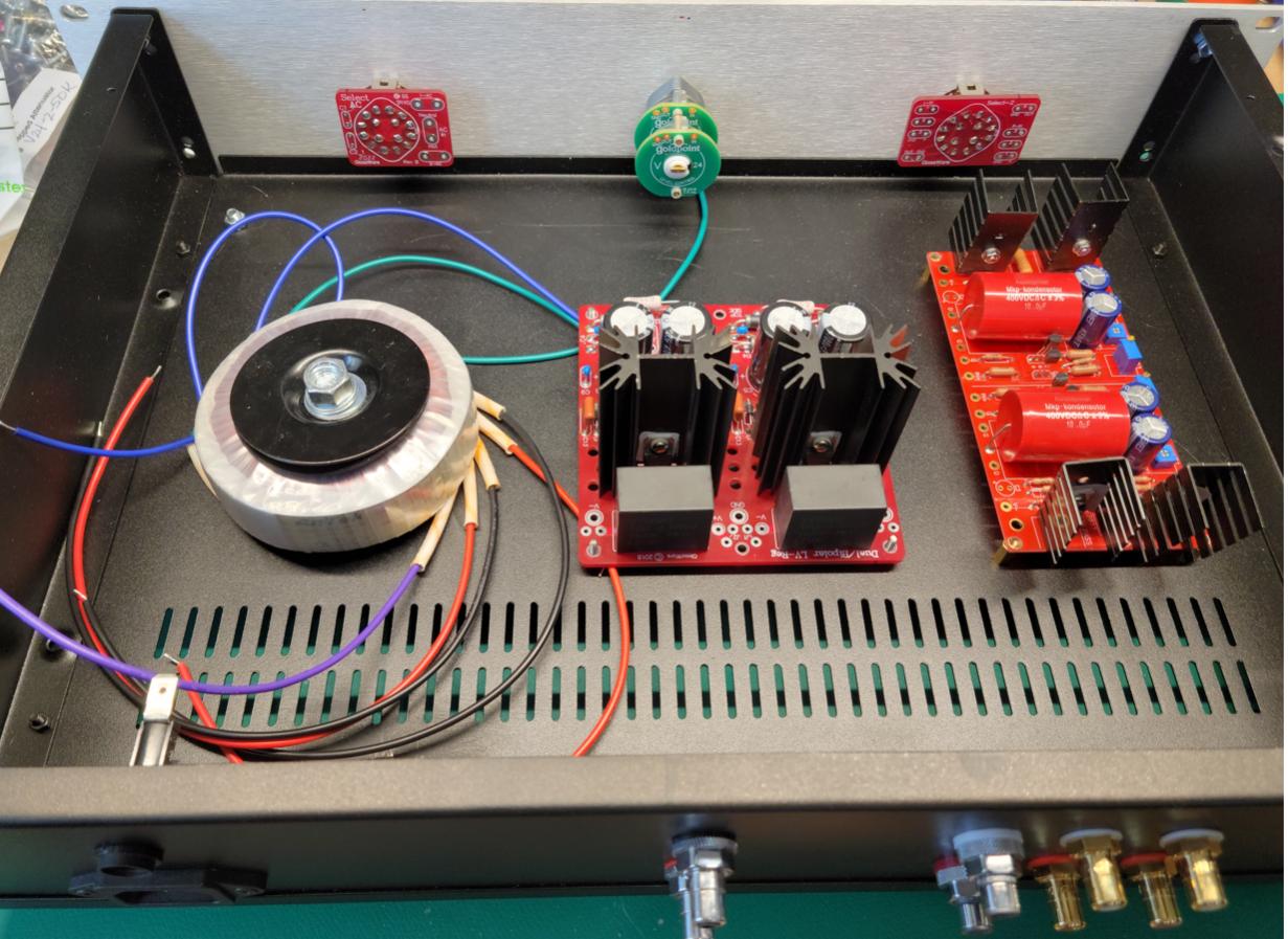

Here is an example that you are probably familiar with - the typical FW amplifier power supply, with fuse:
Yep. Now that I know what to look for, it makes perfect sense.

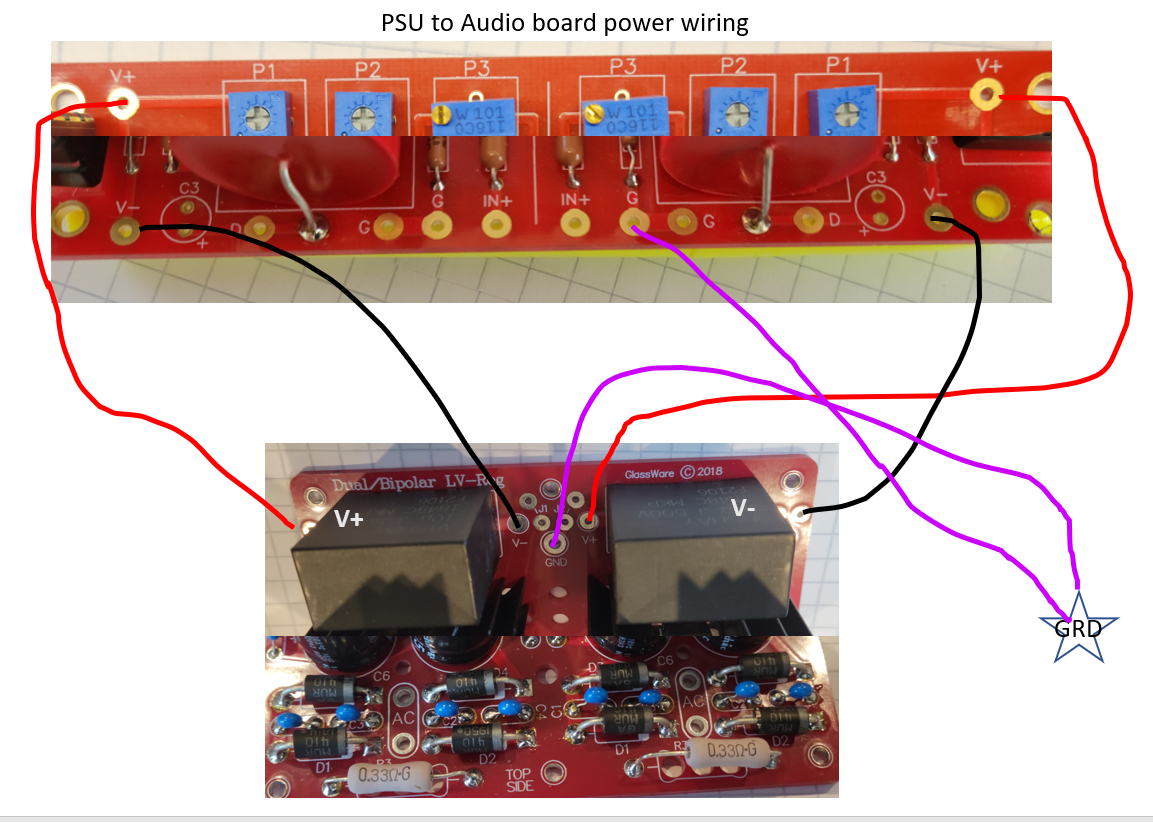

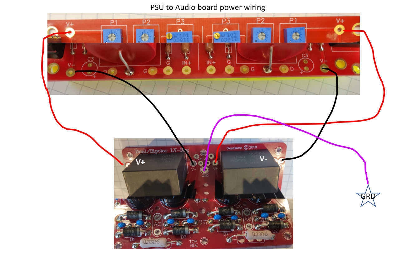

added chart which went missing when i tried to edit my comments

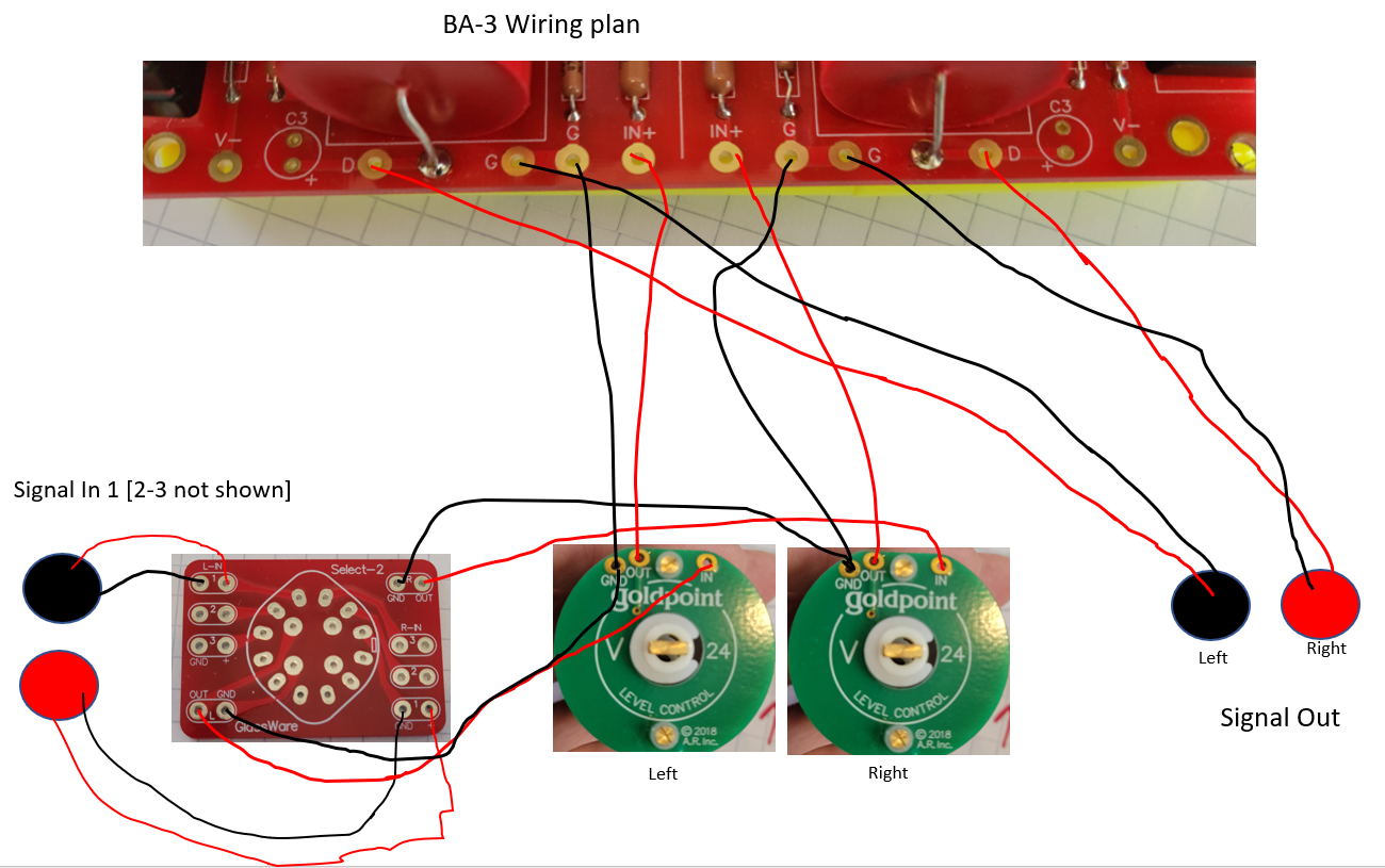

This is my final wiring map for all signal wiring.
Again, another set of eyes...thanks
