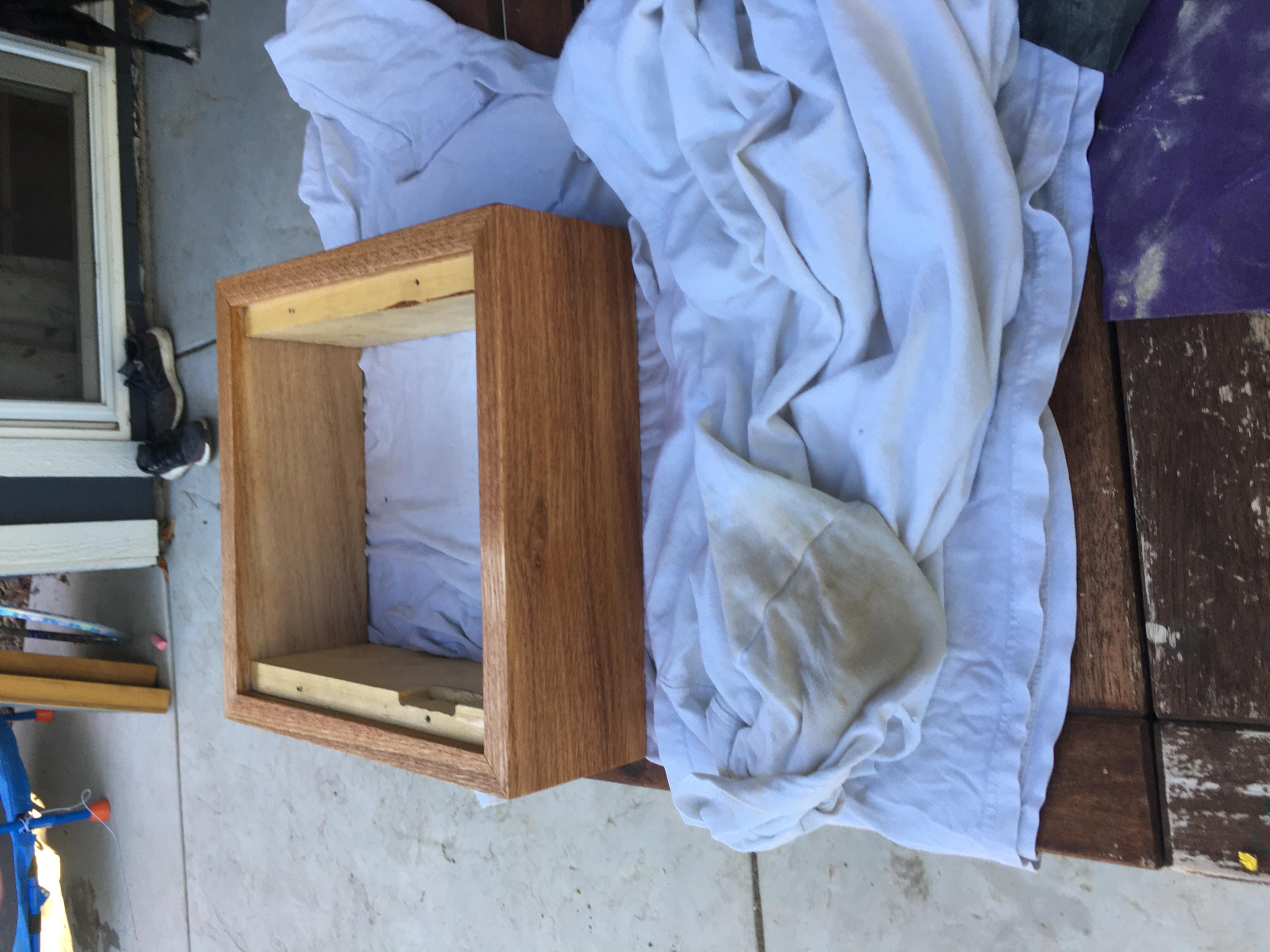

Looks great BRN, I really like the outcome. Reminds me that I have a Bottlehead S.E.X amp
That's been neglected...
Ventilation is a good call. The base does have feet to allow air to flow under it, but adding vent to the top will only help.
The caps are Panasonic EZP-E 10uF that I purchase for another build, but never used. So far they sound good, but at the moment my hearing is jacked up. I had a procedure on my left ear and can't heat s#!t out of it.
I am working on something similar. Just applied the first coat of tung oil. The hot air gets trapped without vent holes.

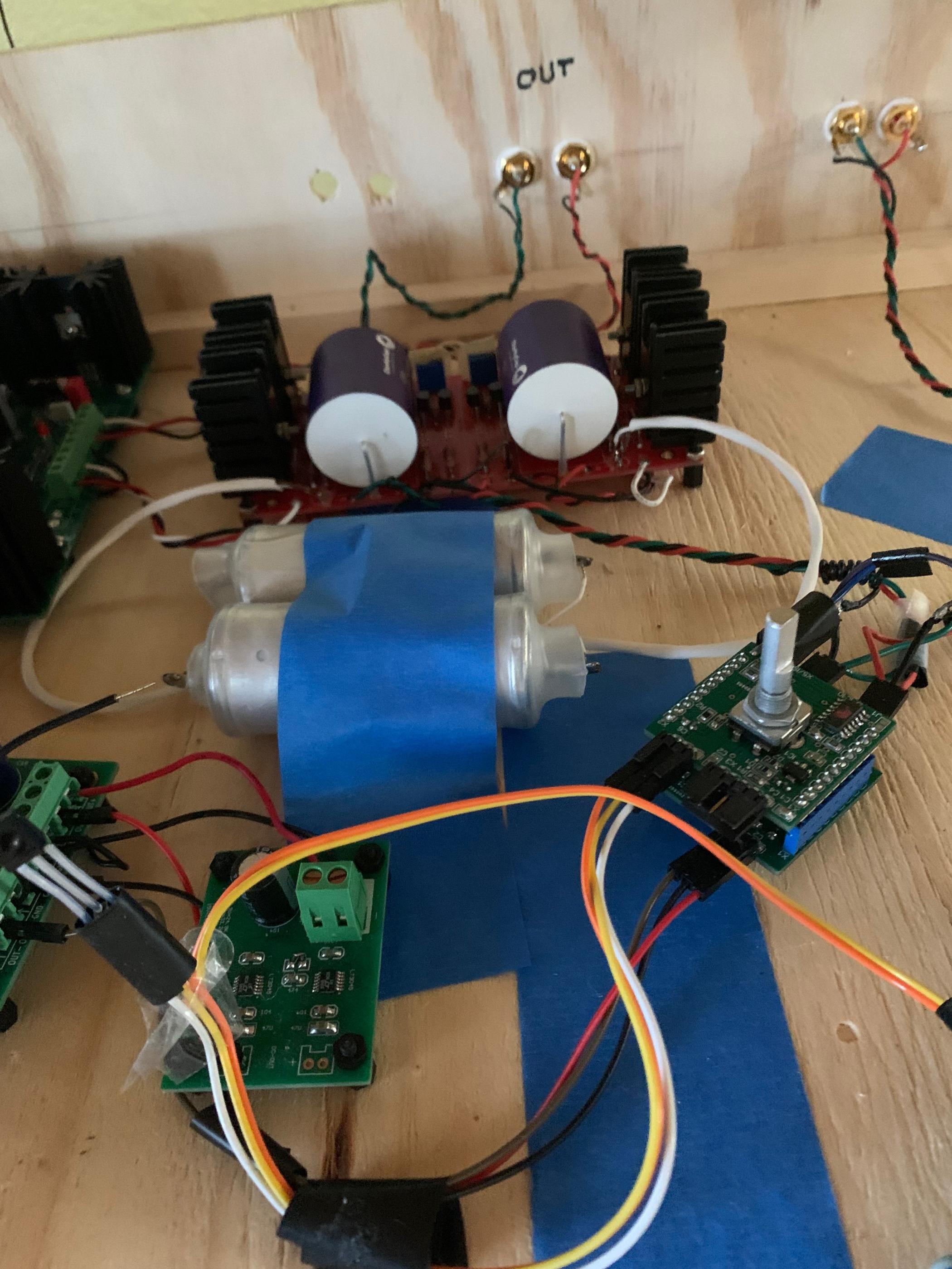

C3 fancy Mundorf caps...
Hi friends
I have one of those 🙄-questions...
I'll use some Mundorf EVO at C3, they're the white ones with red print on them.
They come with one leg short, the other long. Probably the long leg indicates the outer foil?
I know they're not polarized and could be placed either way. But is there a "more correct" way, like, long leg closer to the bypass-C3?

I got some of those Mundorfs measured and it seems to be consistently the short leg, that is connected to the outer foil. They also say so on der web page:
MCap SUPREME EVO Oil | Mundorf EB GmbH
Asked myself the same question and connected the outer foil towards the 332R shunt resistor (facing towards the trim pots). Wisdom has it that one should connect the outer foil to the lowest impedance to ground so noise can easier be shunted. Recently I slapped some FT-3 teflon bypass caps on mine and didn´t care much as those are in a metal housing.
Of course I could be wrong but that´s at least how I did it.

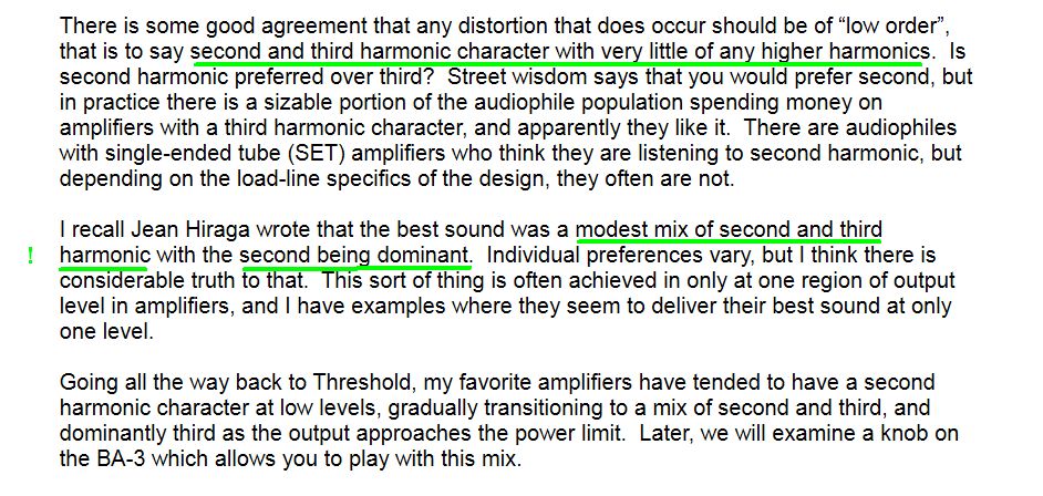

I beg to differ. I use FT-3 (0.22uF) to bypass, connected each to C3 close to the V-, and Bob is your uncle! Nice crisp sound for me.
I am convinced however that adjusting H2 and H3 has a profound influence to the tone and dynamics of the BA-3 FE than changing comparable type of the capacitors on the output.
I have a pair of FT-3 caps in 0.22uF and 0.1uF values, so may through them in and see what the effect on sound is.
Argh! A new riddle! I only had my toe in the H2/H3-waters (by way of the H2-jig of lately)! Do I have to re-read the docs or is it stated elsewhere?…adjusting H2 and H3 has a profound influence...
Discussion starting at post #2102 in The BA-3 as preamp build guide might help.
From what I learned, H2 for warmth and H3 for detail/dynamics.
In my case, I copied the spectrum for the ACP+ and used it as my starting point, then adjust to get +5dB on H3 (which in turn reduces H2). I like the sound so far and left it there but definitely a lot of combinations to try.

For sure those FT-3 are awesome bypass capacitors - I use them everywhere, where I can fit them. My comment was regarding the "polarity" meaning the orientation of inner and outer foil of the FT-3 cap not being that important, as they are shielded in a metal housing. I wanted to hint at those caps and the shielding topic.
