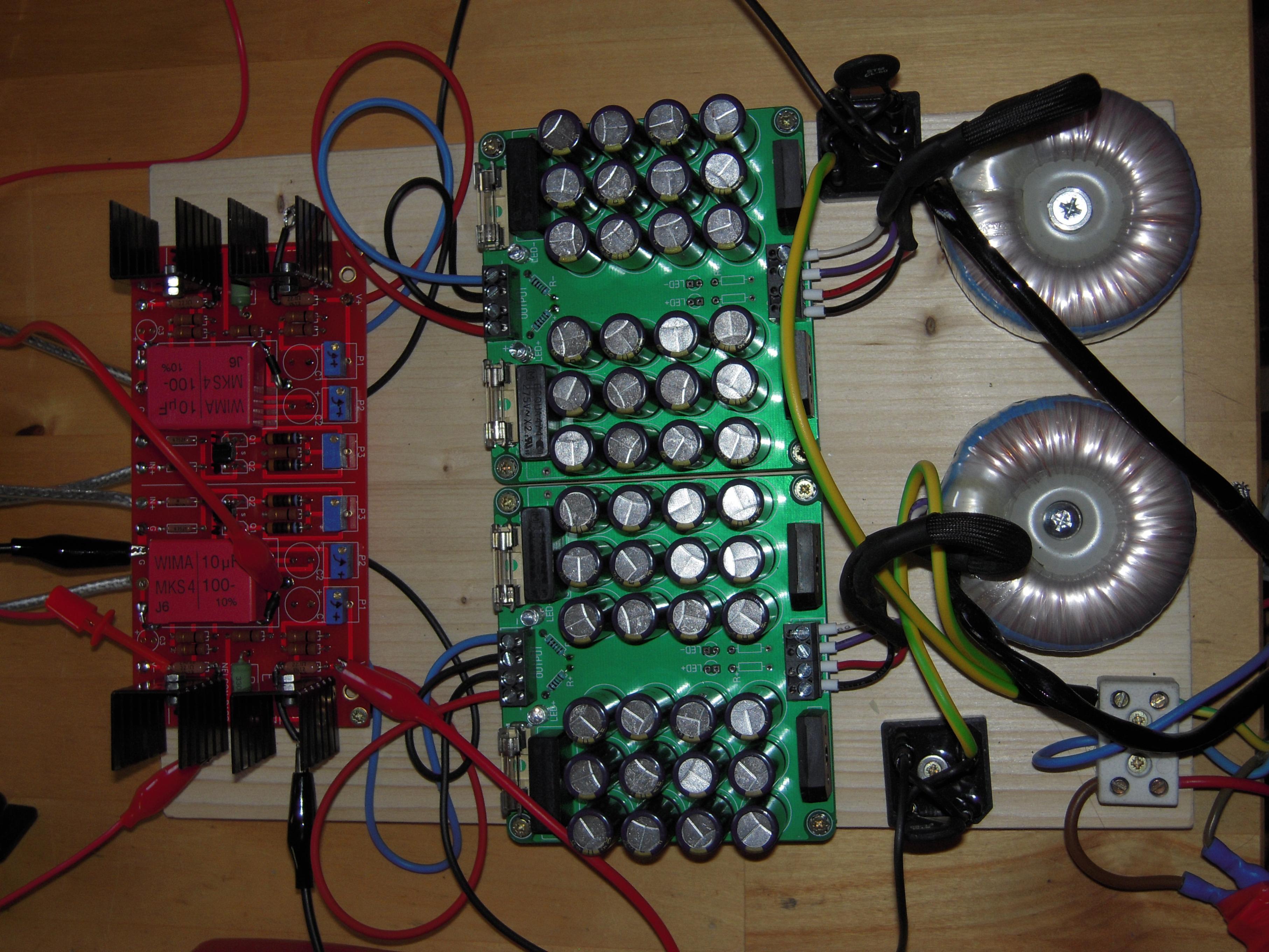

I just finished stuffing and soldering the second PSU board, and I'm now preparing to reconfigure the layout of my BA3FE in hopes of fitting the second toroid and PSU for dual mono operation. It's going to be a tight fit, but I think it'll work...
My question is about hooking up the mains. I initially built the preamp according to 6L6's build guide, so I have the IEC with fuse on the back panel, which runs to the power switch on the front panel. I'm thinking about rearranging it similar to how I built my dual mono Aleph J: IEC with big fuse > power switch > two small fuses (one for each toroid) > terminal block > transformer primaries. Will that work?
If that arrangement will work, should I use thermistors and safety caps on the terminal blocks like for the mains hookups in the FW amps? And, of course, if there's a better arrangement or approach for wiring the mains, I'm open to suggestions. Thanks!
Should work just fine.
I don't see the need for a soft start or the caps, assuming you're using reasonably-sized toroids.
Thanks, IAIMH. I'm using the Antek AS-0520s toroids - 50VA/20V. I figured it probably wouldn't make logical sense for the soft start and safety caps to be required for dual mono but not a single PSU. But, since "rudimentary" would be an overly generous description of my understanding of how all these circuits work, I greatly appreciate you confirming that I'm on the right track!
to spryor #2189
Hello spryor,
I have added a pic when I was playing around with the BA-3 FE as a preamp a few years ago (in 2018).
I used groundloopbreakers (CL-60 thermistors) . No CL-60 as inrush current limiter with those small toroids.
On the pic one test is shown (on the wooden test board): dual mono, one small toroid per channel and a symmetrical cap-bank per channel. I've got around + - 28.8 V on the rails. You can easily go up to +-32 V-rails.
I was also playing with different JFets (complementaries), outputcaps....
Later I build a seperated dual mono - PSU with toroids - CLC-filter - voltage-regulators. This BA-3-preamp is still running/sounding very nice! A lot of gain... Have fun building this great sounding preamp!
Cheers
Dirk 😀😀
